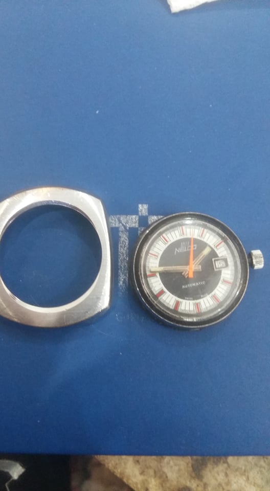

Hello.
I have this watch but it seems impossible to open the case.
Any help appreciatited.
Thank you

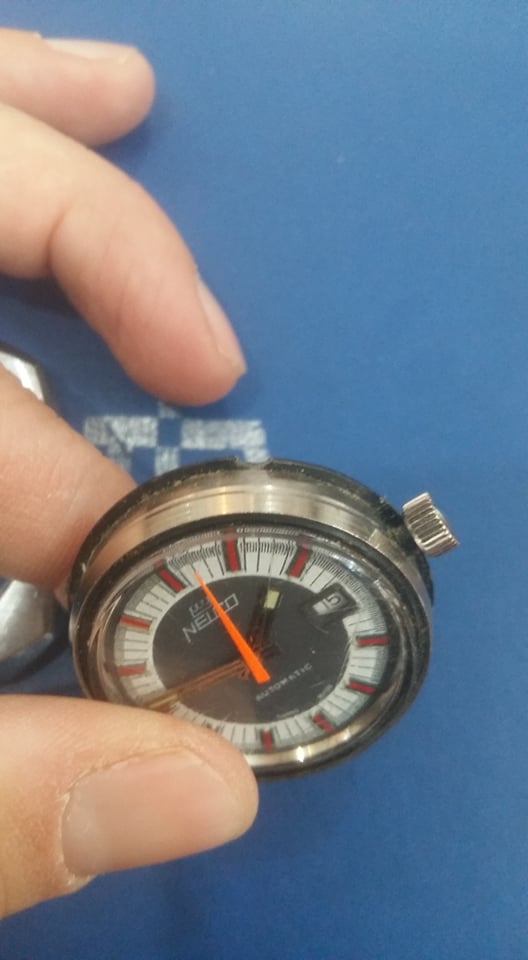

It seems the crown wont go out :/

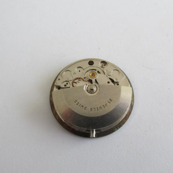

It should be a form of split stem, which requires certain (often uncomfortable) amount of force to pull out.
Attached are pictures from my NELCO movement (same watch). I am not at home now to send you better pics of the stem.
Some people remove the steel ring, crystal and then cut into the plastic to not pull stem on these, but don't do that... 😀
