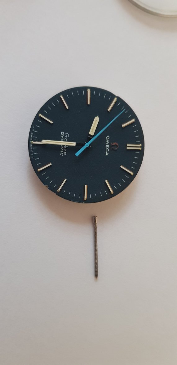

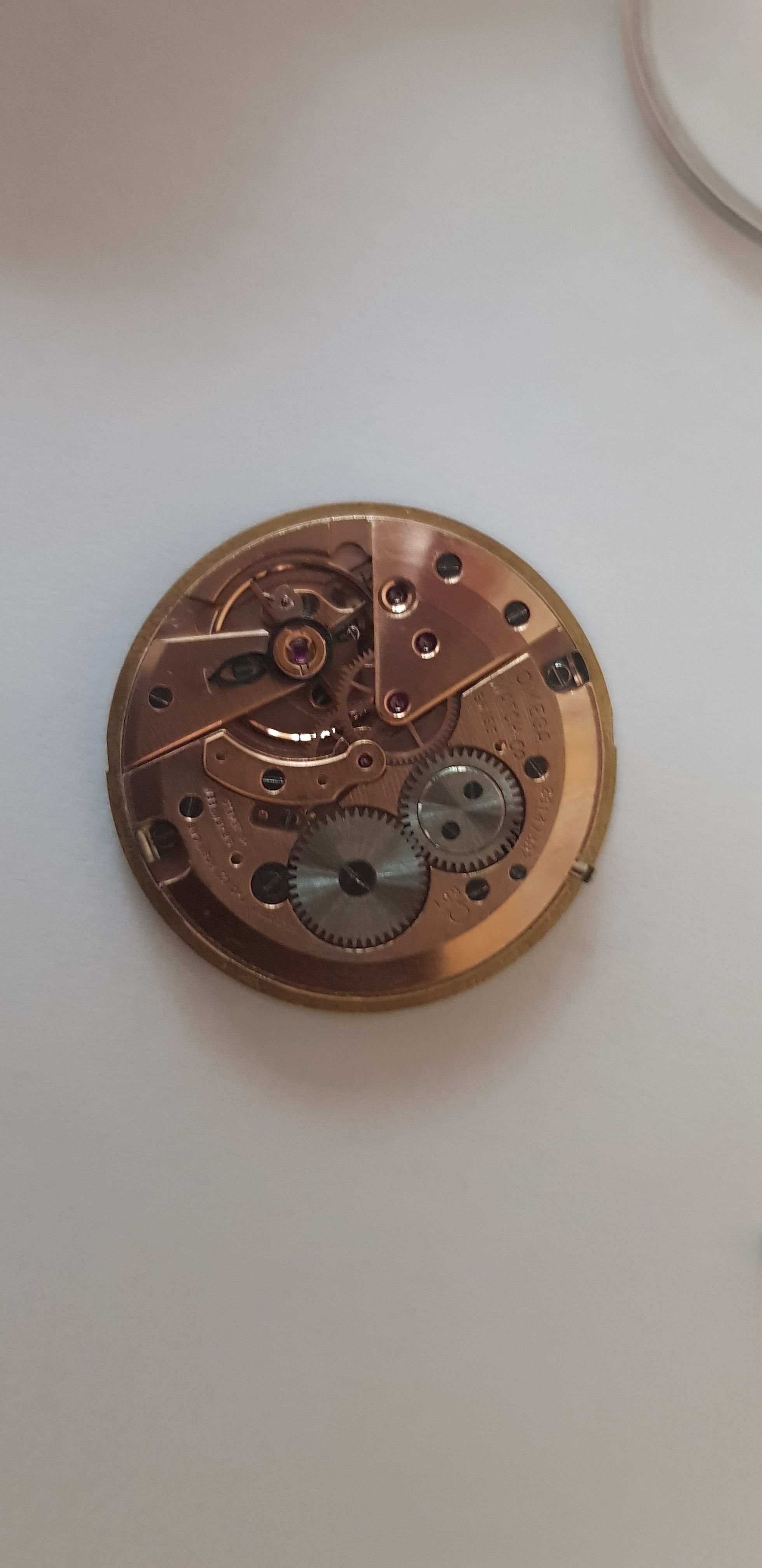

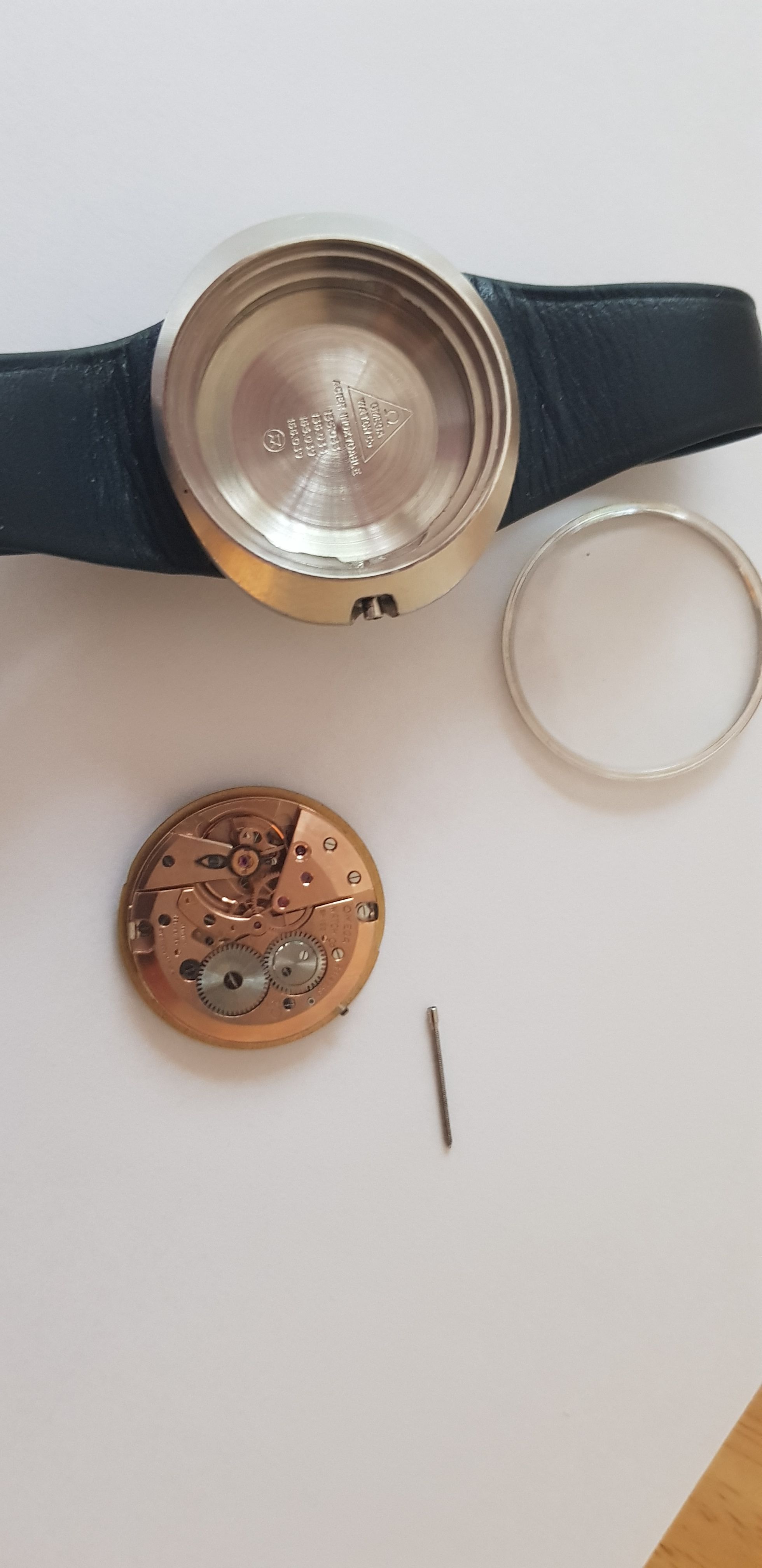

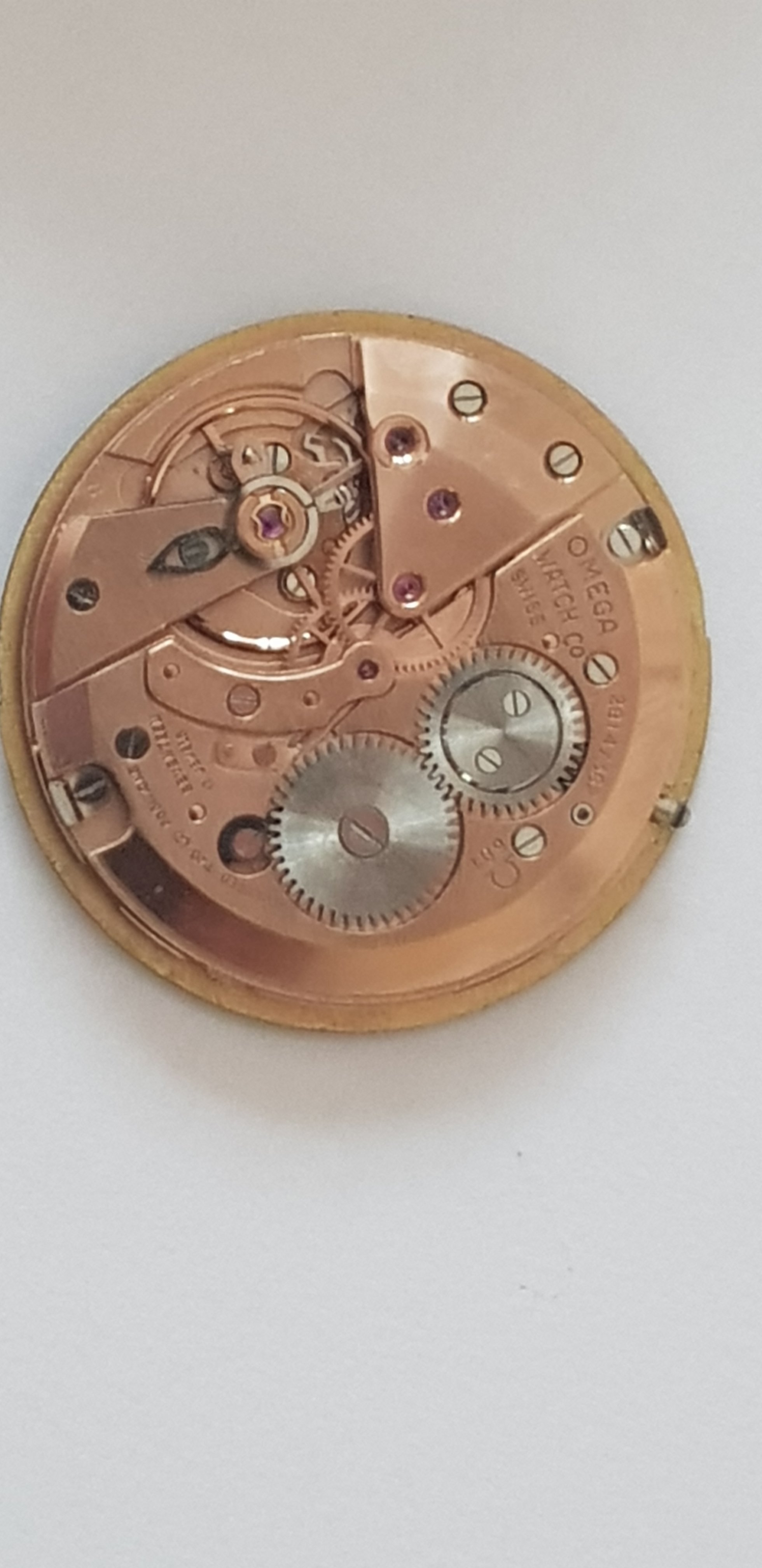

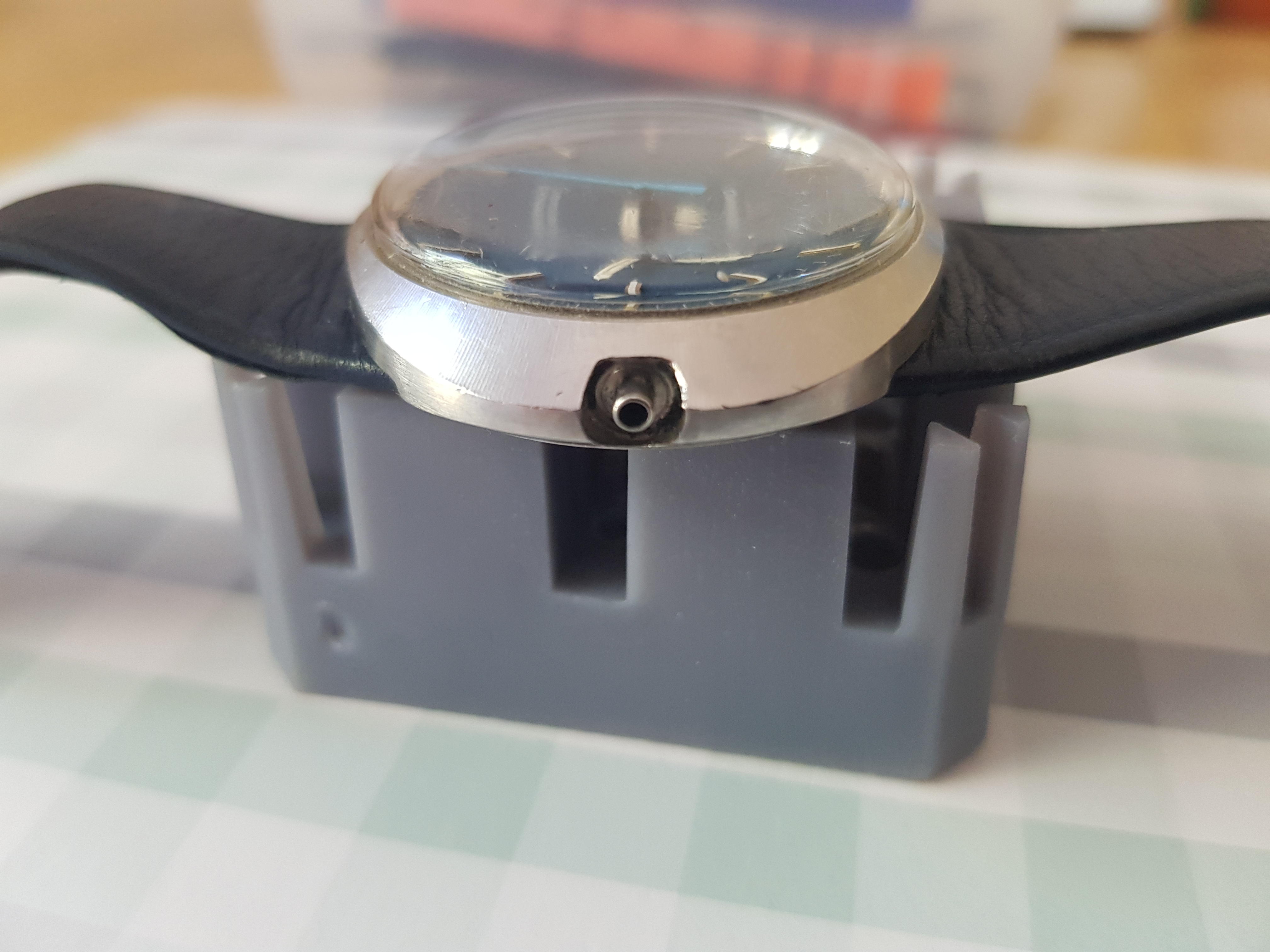

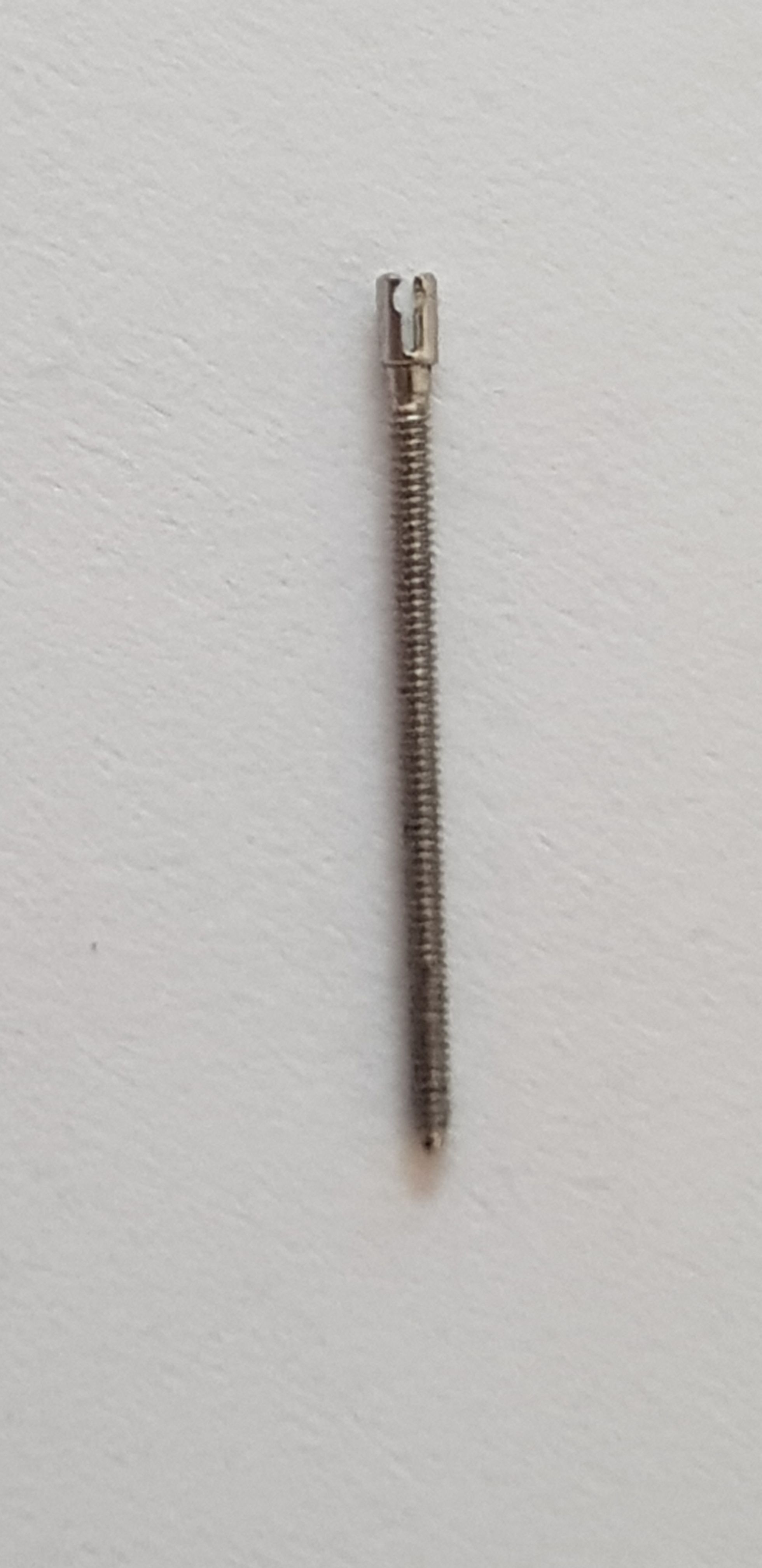

    Hi All, first time post and looking for some help please.
    I have had this watch in a drawer for twenty years,i am trying to find a crown to fit but cant find an answer on the web.
    The case number is 135.033 The movement is 601

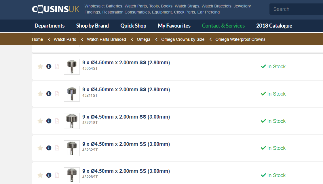

    I took a gamble and bought a pin from Cousins uk and it fits but im a bit worried about buying the wrong crown! and to add more confusion i have found a stem and crown that is one piece available from Cousins UK?
    I have added loads of pics and hope someone can help. 20180630_161036.jpg 20180630_161047.jpg 20180630_161100.jpg 20180630_191509.jpg 20180729_194852.jpg 20180729_194946.jpg 20180729_194958.jpg 20180729_195028.jpg 20180729_195044.jpg 20180729_195555.jpg crown 1.PNG

    When I search Cousins using your case reference it comes up with part no. 42528ST which is just a crown without stem. £21.45
    sd1968 likes this.
  3. sd1968 Jul 29, 2018
    4
    Thanks. when i put the case number in (135.033) it just comes up "Sorry, your search for '135.033' did not find any matches"
    weird???? Thanks again just don't want to order wrong one and get stuck with a crown i cant use!
  4. X350 XJR Vintage Omega Aficionado Jul 29, 2018
    12,627
    29,955
    This is not a DIY project. Take it to a watchmaker and have them find the crown and fit it. The stem you have looks OK but fitting it means cutting it fitting the crown and seeing if its the correct length then repeating until you get it right, oh, and if you accidentally cut it too short, start over with a new stem.

  6. Archer Omega Qualified Watchmaker Aug 1, 2018
    26,468
    65,614
    Correct crown is 069ST42528.
    Cheers, Al
