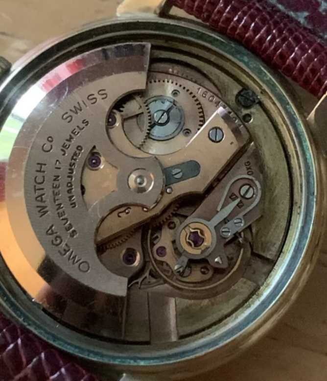

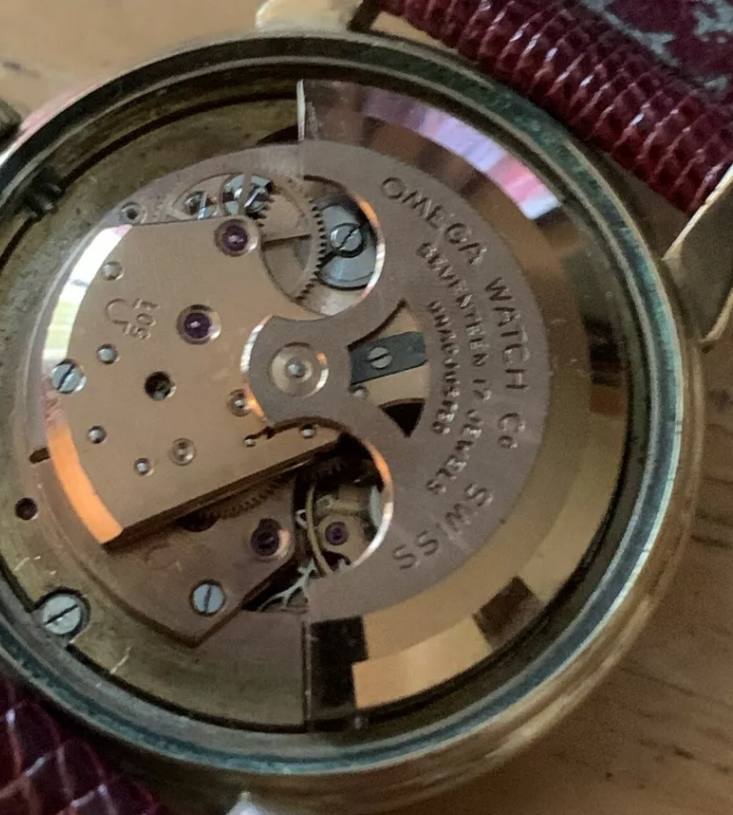

Hello gang,
I have a chance on purchasing an Omega Seamaster with a 501 movement. ...PICTURES INCLUDED.
DID it ever come in a 17-jewel version ?? I can't find info verifying a 17-jewel version in the 501.
All help, info, and advice is appreciated !!

The 500 (US version w OXG mark like yours) had 17j. The ROW 501 had 19 then 20j. I’d suggest yours has had some parts changed and is either a 17j 500 with a changed bridge or a 19/20j 501 with a swapped rotor and balance. In summary it’s mostly legit but not quite!

I believe they only came with 19 and 20 jewel variations. That looks like a rotor from a 490.

The rotor bushings on the entire cal. 49x/50x series were very weak. As a result, many watches have replacement rotor assemblies which don’t necessarily match what was originally there. Obviously this affects the value, but it is important to understand why this happened years ago.

A 47X rotor will not properly fit as the 47X is 25mm and the 50X is 28mm. 49X is also 28mm (sub seconds)
470-1400R is a fairly common part. So they must have been aware of this weakness. The bushing pinion presses out of the rotor. The sealed packages usually contain both. There is no need to swap the whole rotor, other than lasyness.
A little secret I learned. Many of the common 47x/50x parts are depleted stock and can fetch high prices on eBay. So a search for 490 will often find that variation. Especially with parted out second hand parts which are not in factory packaging. Care does have to be taken as the sub seconds train is slightly different than the sweep seconds one.
