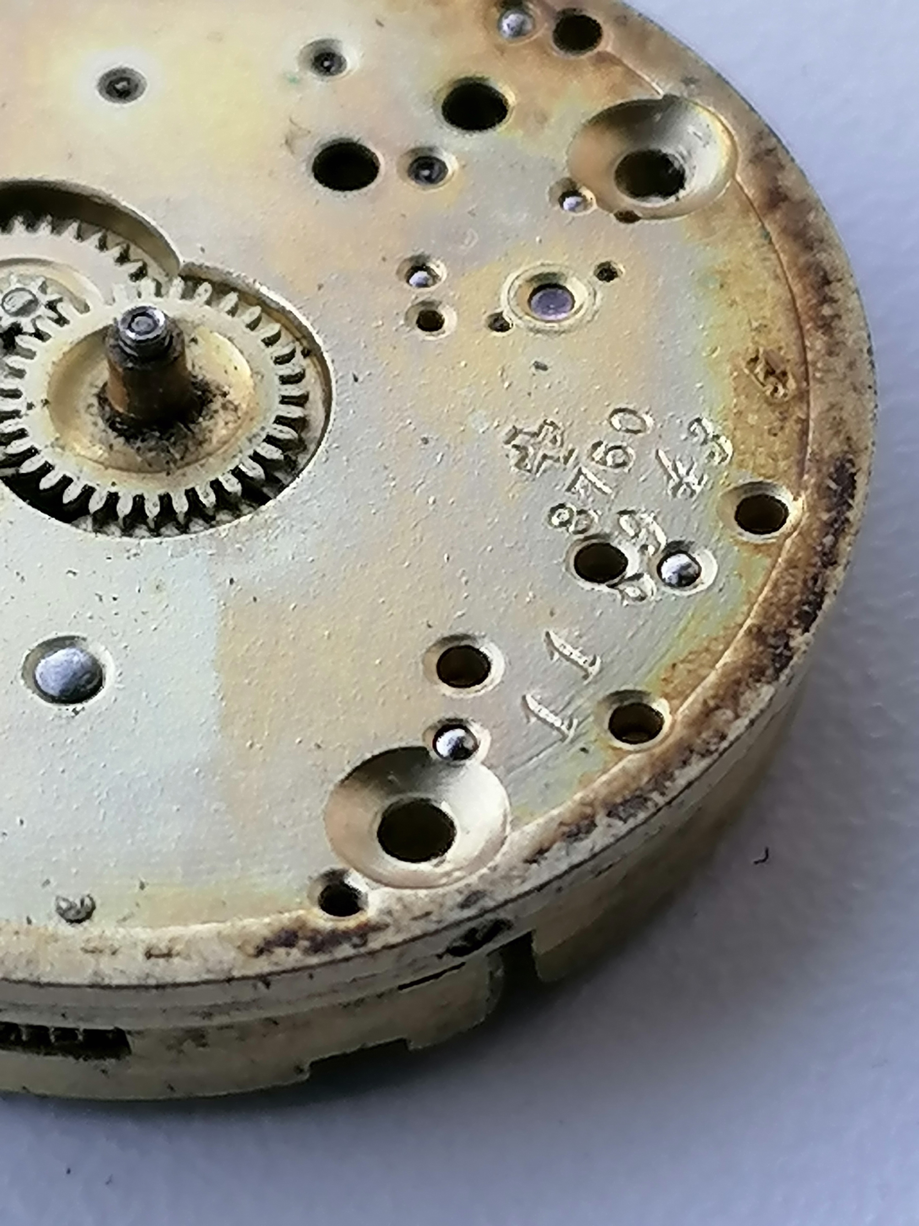

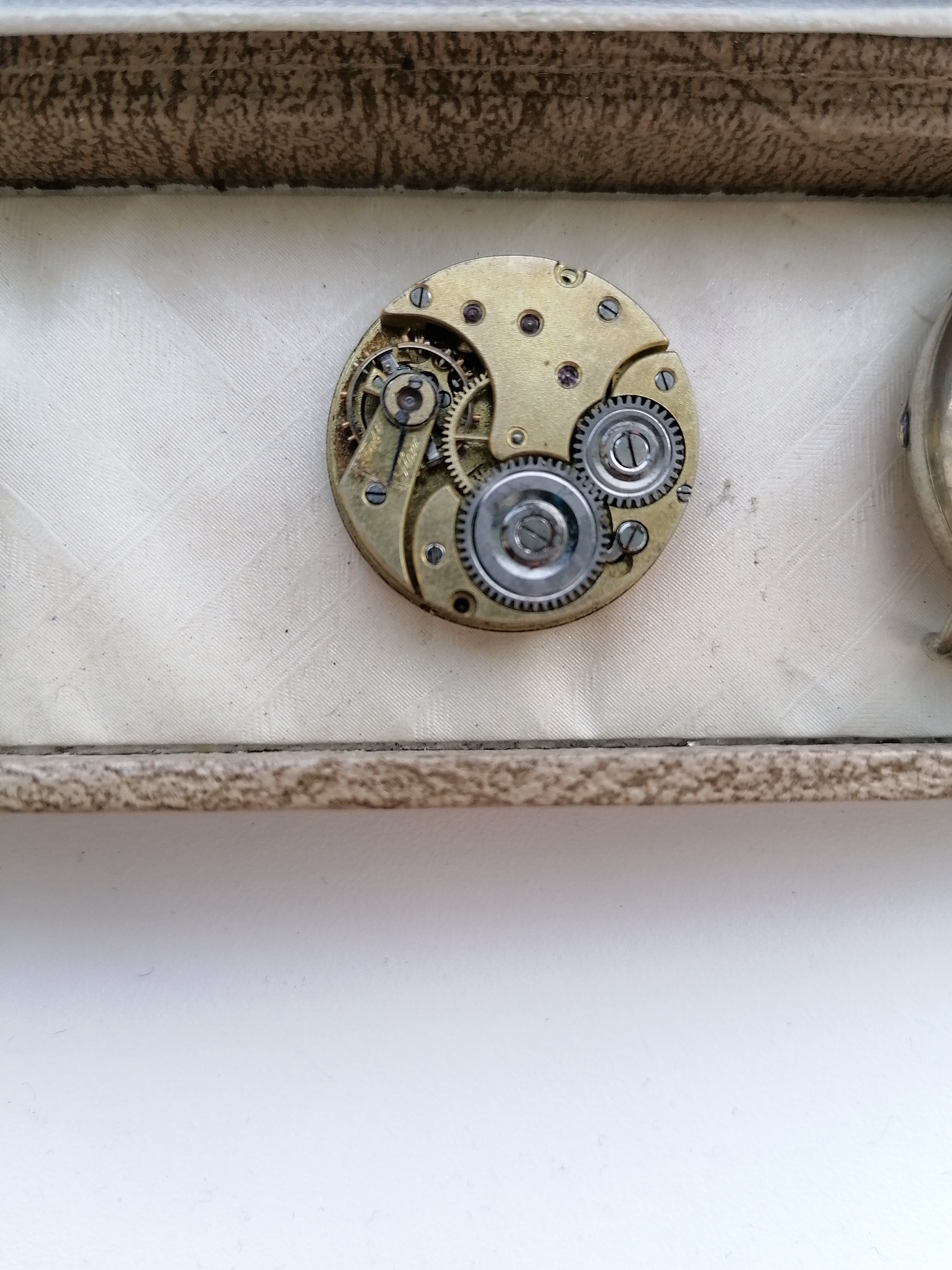

I think this may be an early Omega / Brandt Movement but can one with some experience identify this?

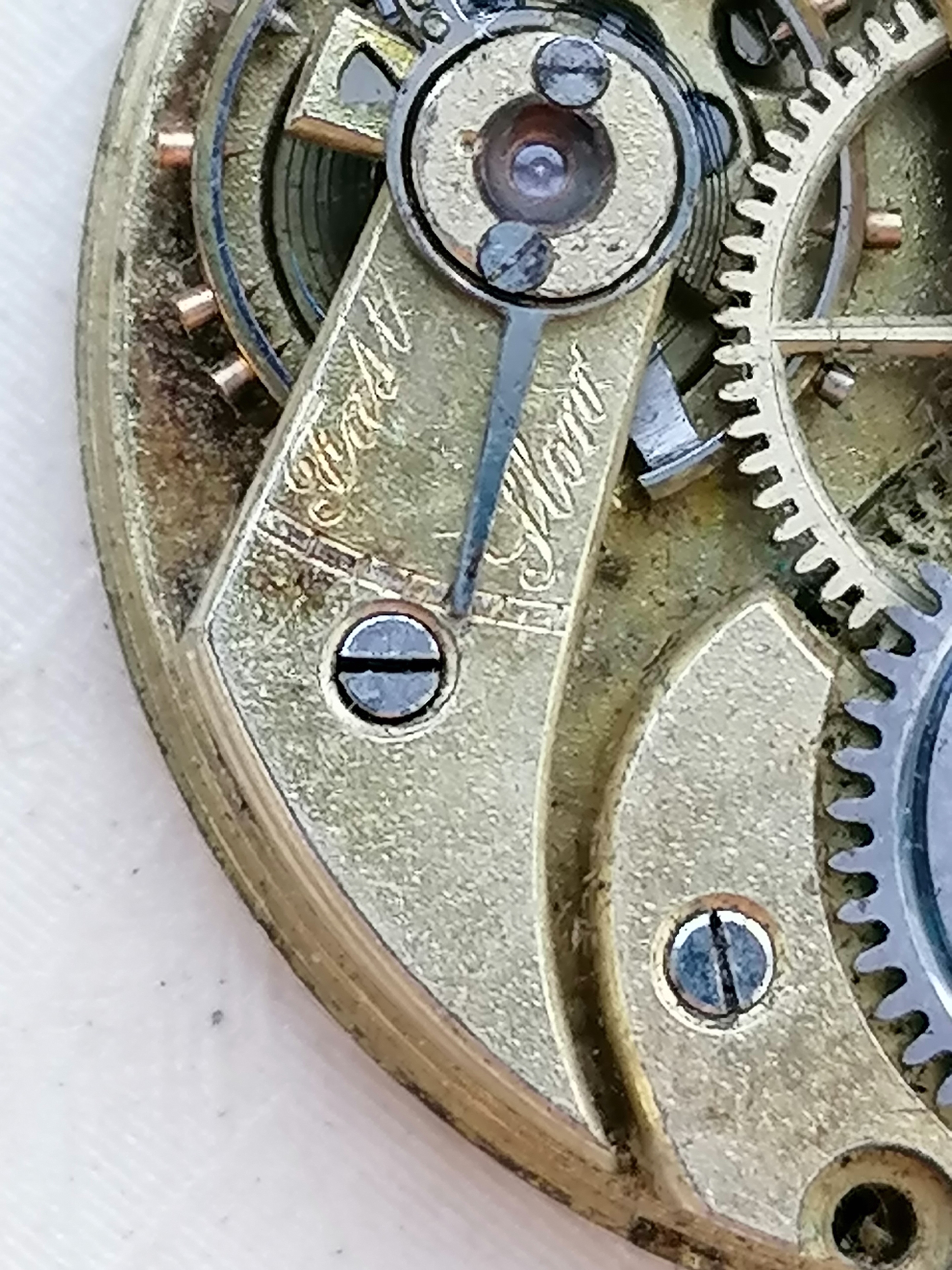

There are no identifying marks apart from what's on the balance regulator.
963
1,252
Movement number is sometimes under the balance cock, but this movement may be unnumbered.

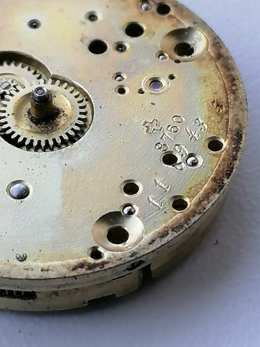

re: Swiss 8760, per this thread https://mb.nawcc.org/threads/omega-8760-calibre-help.168846/
Swiss Patent 8760:
stem setting mechanism with clutch wheel and rocker bar, prevents moving of hands when switching to winding position,
filed 08-01-1894, Louis Brandt & Frère, CH
8
Thanks.
Is the number under the 8760 not the movement number 11x09435 ?
8
you could be right, c1895-1902. may explain the absence of other markings
