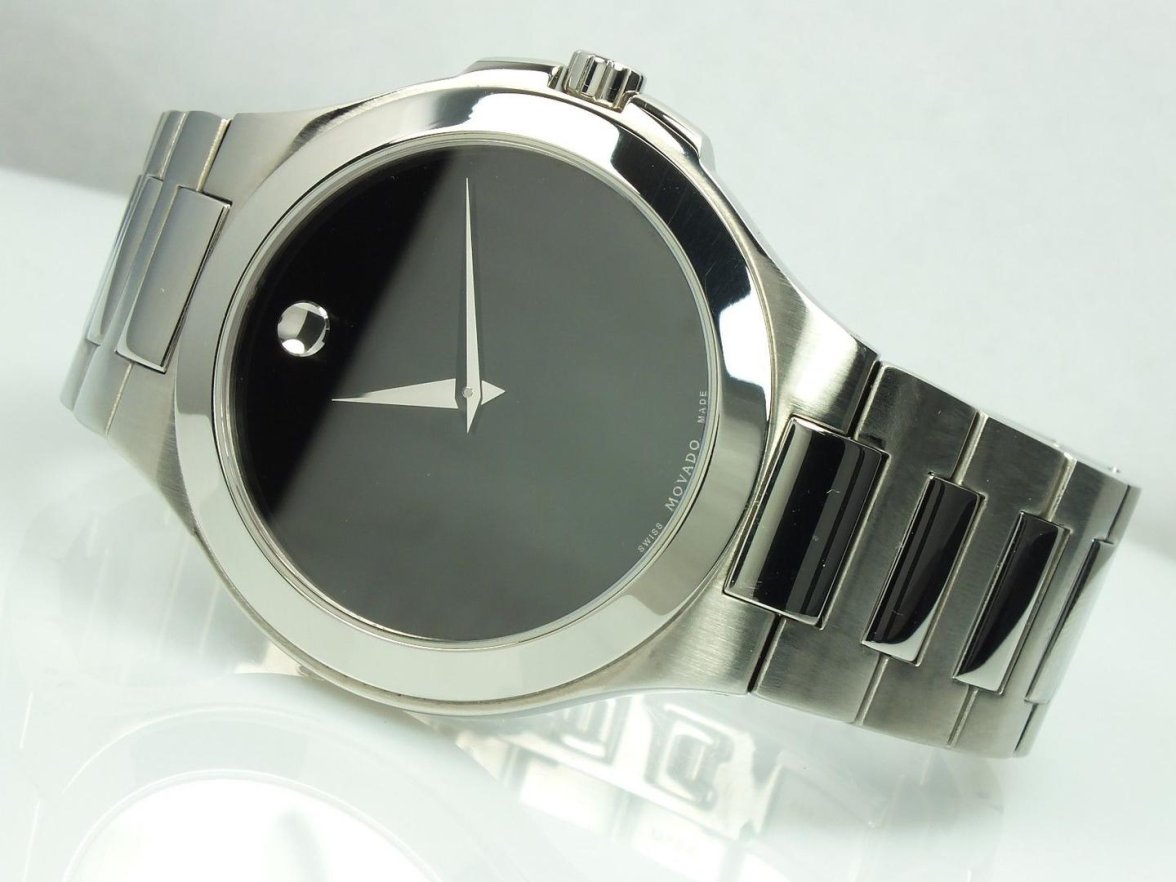

The first number the OP gave is the reference, which would correctly read out as 01.1.14.1032. I quickly searched google with that number and found the watch should look like this below
7,784
14,378
^^^ If that's the watch in question there is obviously no way that bracelet is going to be able to be swapped to another watch. It's an attractive watch and I would have no problem reading the time but the OP seems to find it difficult. There isn't much that can be done, it isn't going to be $$$ feasible to try to swap or alter the dial for something with indices.

Huh? It should be trivial to swap the dial. Case will be easy to open since it's quartz and designed for battery replacement. Probably snap-on. Movement is likely a Ronda, though it could be an ETA. In any case either release the stem screw or press the stem release lever and remove the crown and stem. That will allow the movement to slip out. Remove the hands and then the dial from the movement. Install the replacement dial. Reverse the process and you're done. I'm confident I could do it in five minutes, and I'm by no means a professional watchmaker. (Though, to be fair, I have built quite a few watches from parts.) I'd even do it for free for the OP, but he's probably better off finding a local watchmaker; they shouldn't charge more than $30 for the service.
The only slightly tricky part is finding a replacement dial with the correct diameter. Feet placement is not an issue since Dial Dots exist. OP just need to measure the current dial diameter and find a replacement he likes on eBay or Ali Express. No need to worry about movement compatibility since we're not using the dial feet. (Edited: Well technically he'd have to worry about hole size for the hour hand, but it's easy to enlarge a hole that's too small with a brooch, and a hole that's too large will be obscured by the hands.)
