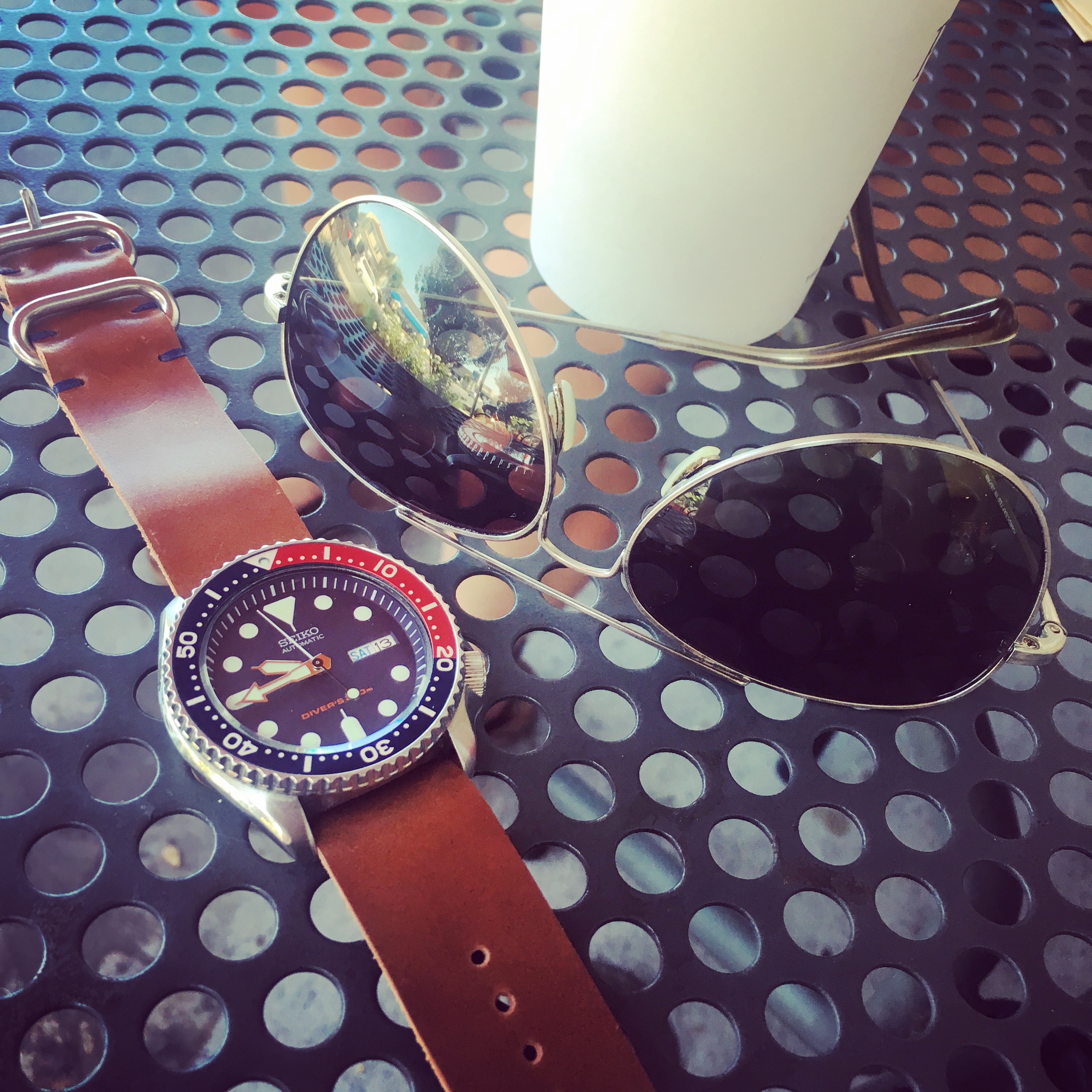

I love these watches. A little hard finding nice straps, Options are: NATO strap (looks a bit off), NATO style Perlon strap, Leather strap cut and glued to fit (that's what I did with mine).
The 26.5 is robust and reliable. Despite no shock protection I haven't had any issues.
why not just a custom leather single pass through? Like this?
