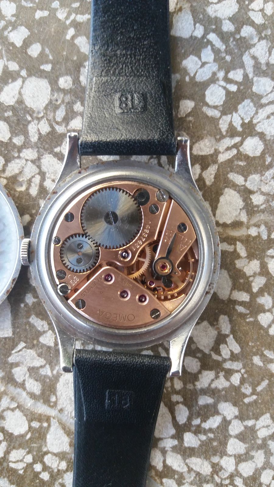

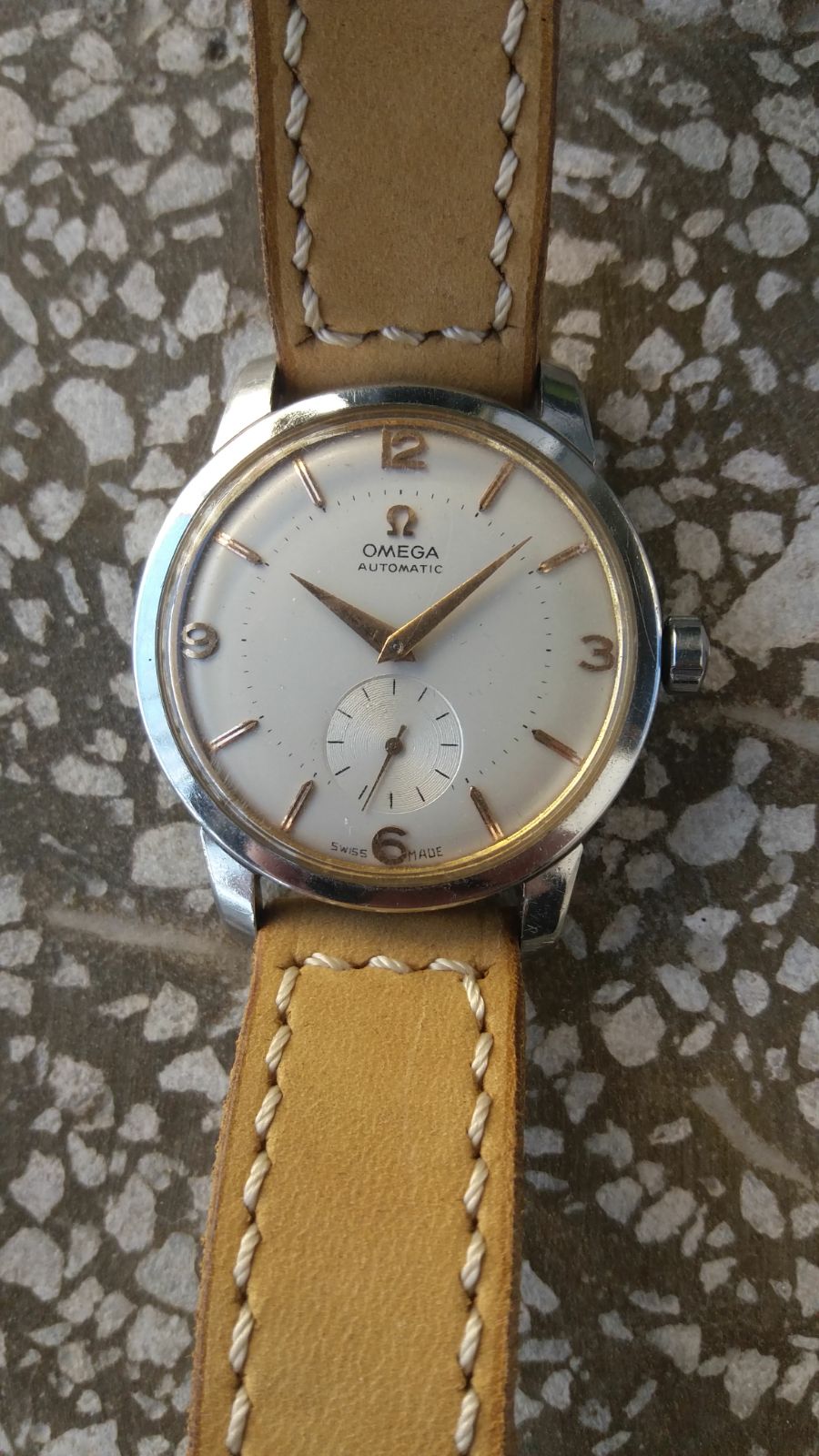

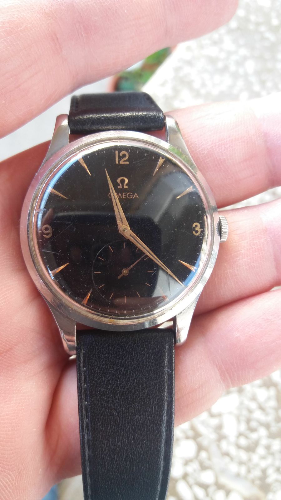

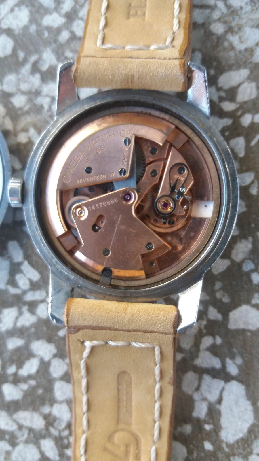

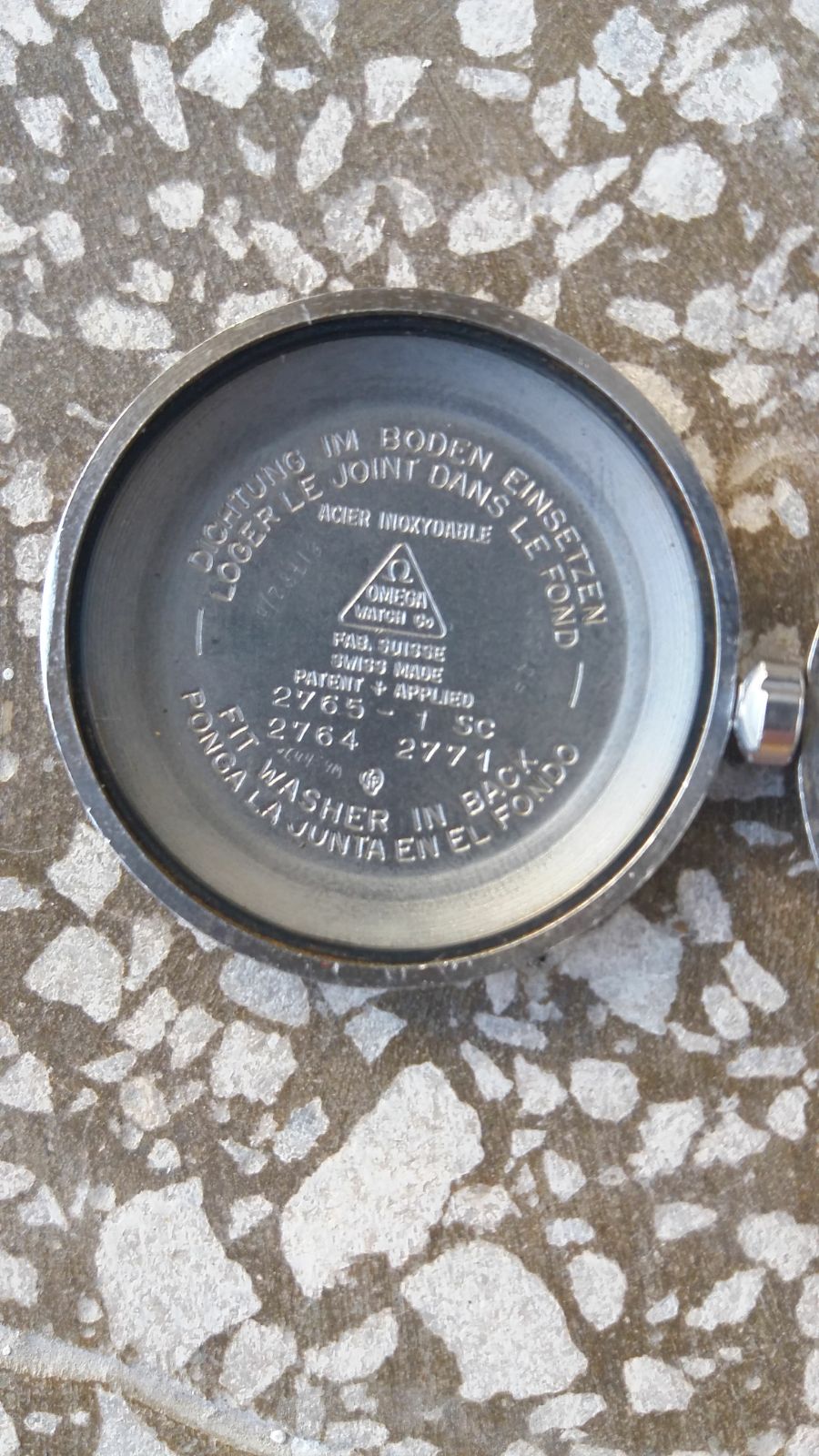

    I am posting here because I need help to chose between two Omega vintage pieces. I am looking to buy my first Omega and for my budget I found locally an Omega Automatic from 1954 (based on the serial number) and one with a 266 calibre from the same year. I like the Automatic better because it is also waterproof, which is good because I am planning to wear the watch daily. But I am afraid the dial might have been repainted for it looks to good for its age.
    What do you think based on the images attached? Which should I get? Does any of them look suspicious? Are they all original? Is neither of them?

    I think 1 is indeed a redial, the track isn’t fully aligned with the markers. Don’t presume you can make a watch that age waterproof, you can’t always.

    1. Watch: Redial
    - Look at the minute markers, especially the distance between the minute markers and the hour markers
    - small seconds hand too long
    - Look at the positioning of the seconds markers
    etc etc
    2. Watch: 99% a redial as well but better photos would help
