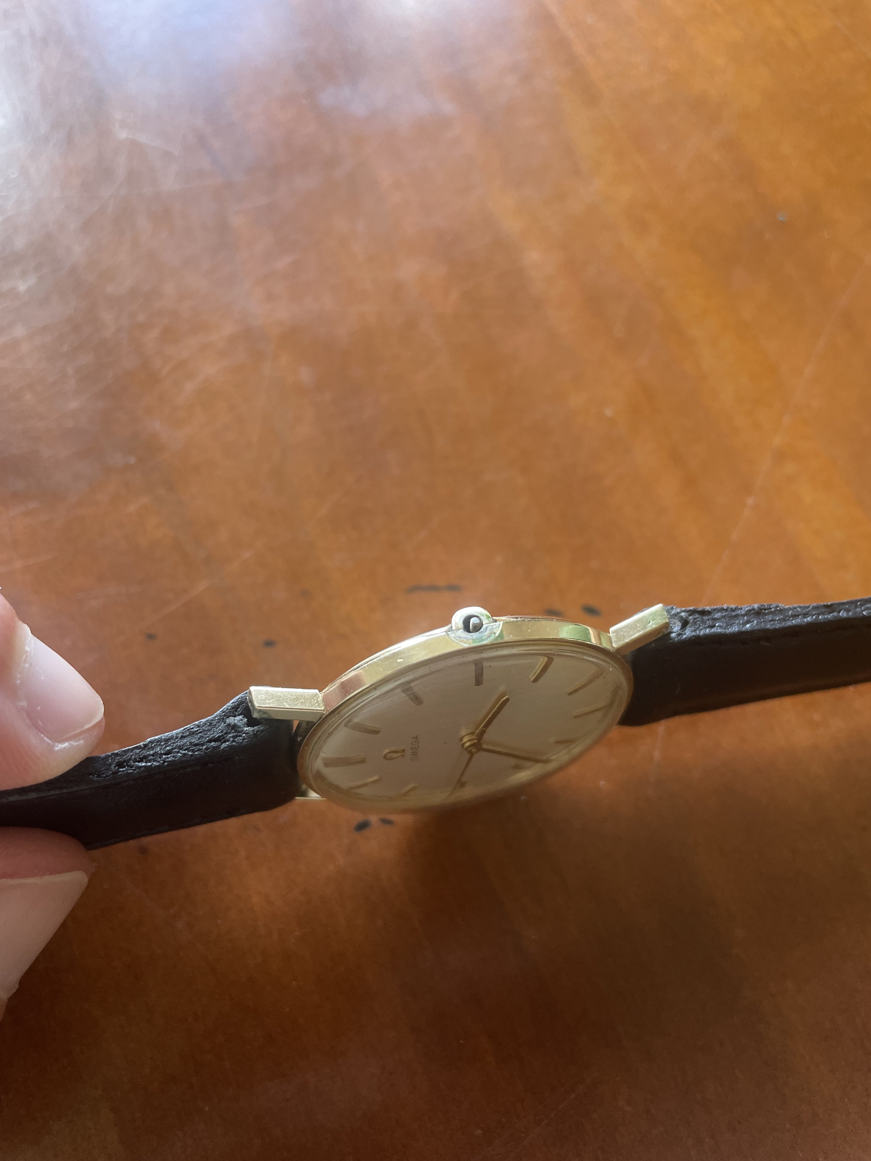

Hi all,
Recently lost the crown on my Omega cal. 601
Any one know the part number for the crown?
Thank you

The crown part number isn't related to the caliber, but to the case reference number.
Have your watchmaker remove the caseback and identify the watch by reference.
You can then try to find the crown part number on various reference sites and then trawl the internet for a replacement.
You cannot buy a crown from Omega.
Or you could just give it to an Omega Certified watchmaker who has access to Omega parts and can resove your problem.

Thanks for the lists, but still no luck,
The case number is P-6313 douldn't find it on the lists sadly..
Any guesses?
Any guesses?
I believe this is a case reference from a third-party manufacturer, probably easier to find a similar looking reference (e.g. 135.070) and buy that corresponding crown

Correct. The case was made by Belove & Arienti Watch Case Company (thus the B&A). B&A was part of D&A - DiVincenzo and Arienti who were casemakers for Norman Morris, the US agent for Omega at that time.
The US made cases don't have the same inventory data that the Swill ones do, so finding an actual part number will be problematic.
Just measure stem size/thread and the hole in the case and start the search.

Thanks, stem is 0.9 mm and diam. I'm thinking 4.2 diam.?
Maybe this
https://www.ebay.com/itm/256221216946
or
4.5mm?
maybe i didnt have the original crown already..
Whats making me hesitate is the angular Omega emblem seems a bit off on this crown?
