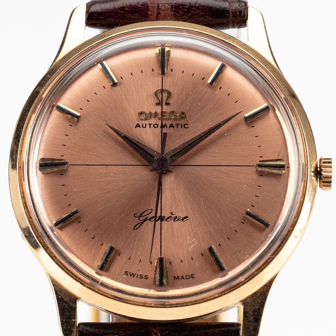

Help!!! I'm not sure is it a redial watch.
8

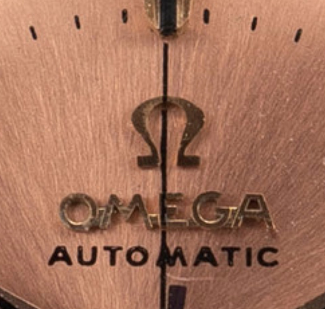

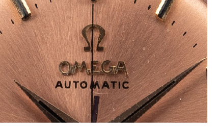

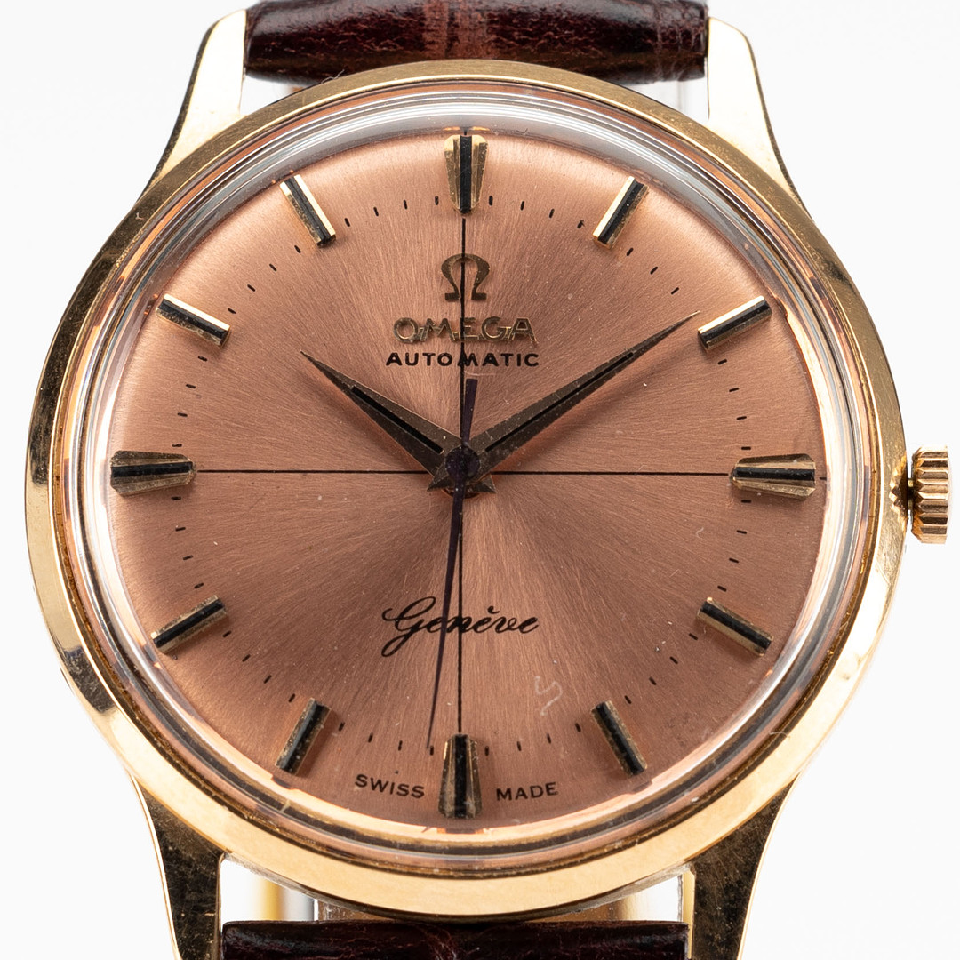

I noticed a Omega geneva with a beautiful dial.I am very interesting in it.But I didn't find the similar one on the internet. Could any experienced friend tell me if this is a redial watch. Appreciate. The automatic look like unnormal, not sure about my ability to discriminate.
3,819
16,171
Bent Omega logo and fuzzy markers on the right hand side...
poor variable weight on the Automatic font...
at least there’s no spelling errors.
1,719
7,388
Redial. @Fritz is right. Avoid.
236
180
Hmmm!
The MADE doesn't follow the contour of the case and the 9 batten is squint. Both could be down to crystal distortion though.
24,836
55,256
There is no need for speculation. Apart from the terrible printing, the vertical crosshair is actually drawn on top of the applied "E" and the Omega symbol? 😲
4,402
13,118
It's good you posted it here before buying. You dodged a bullet on this one.
