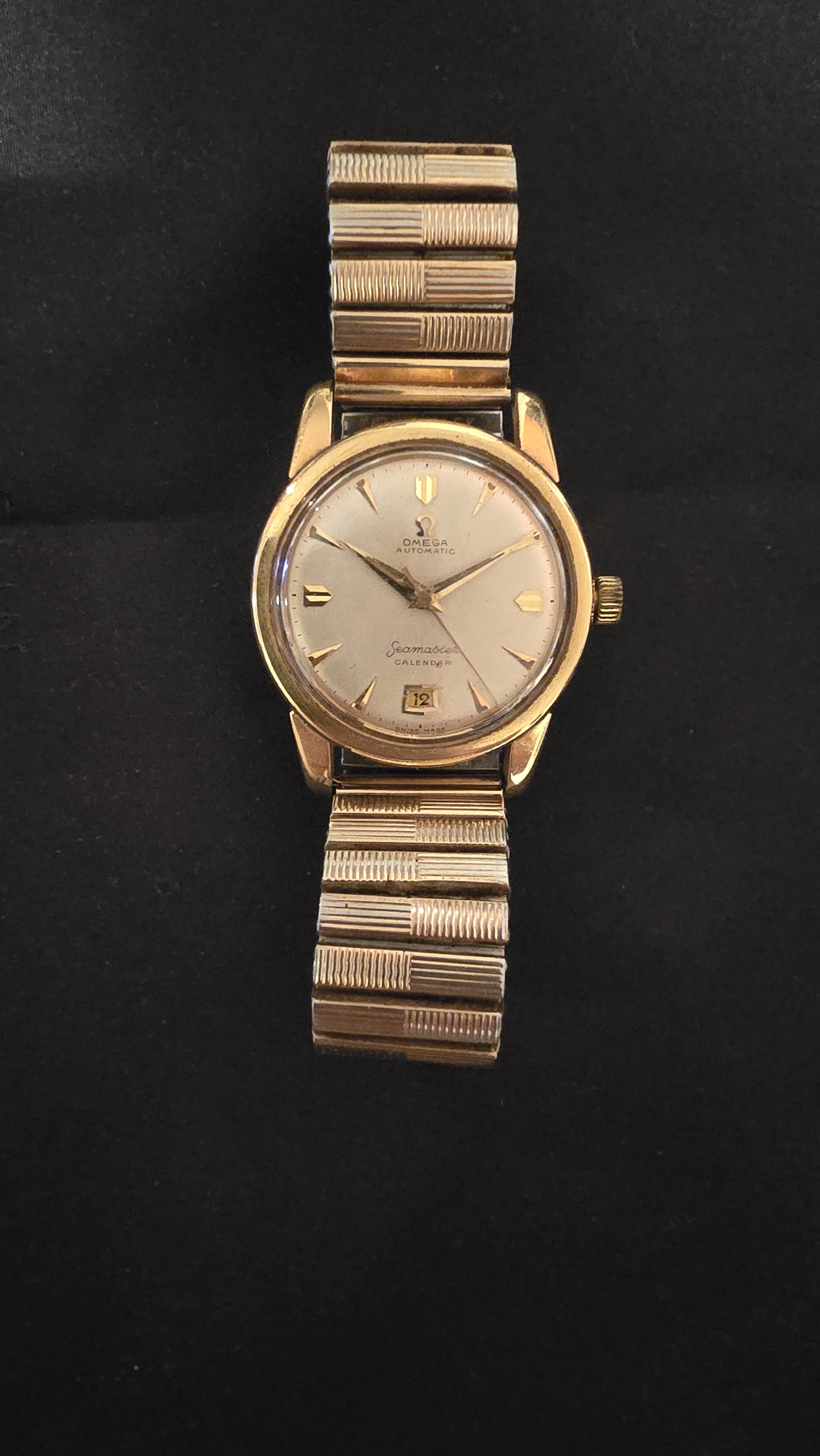

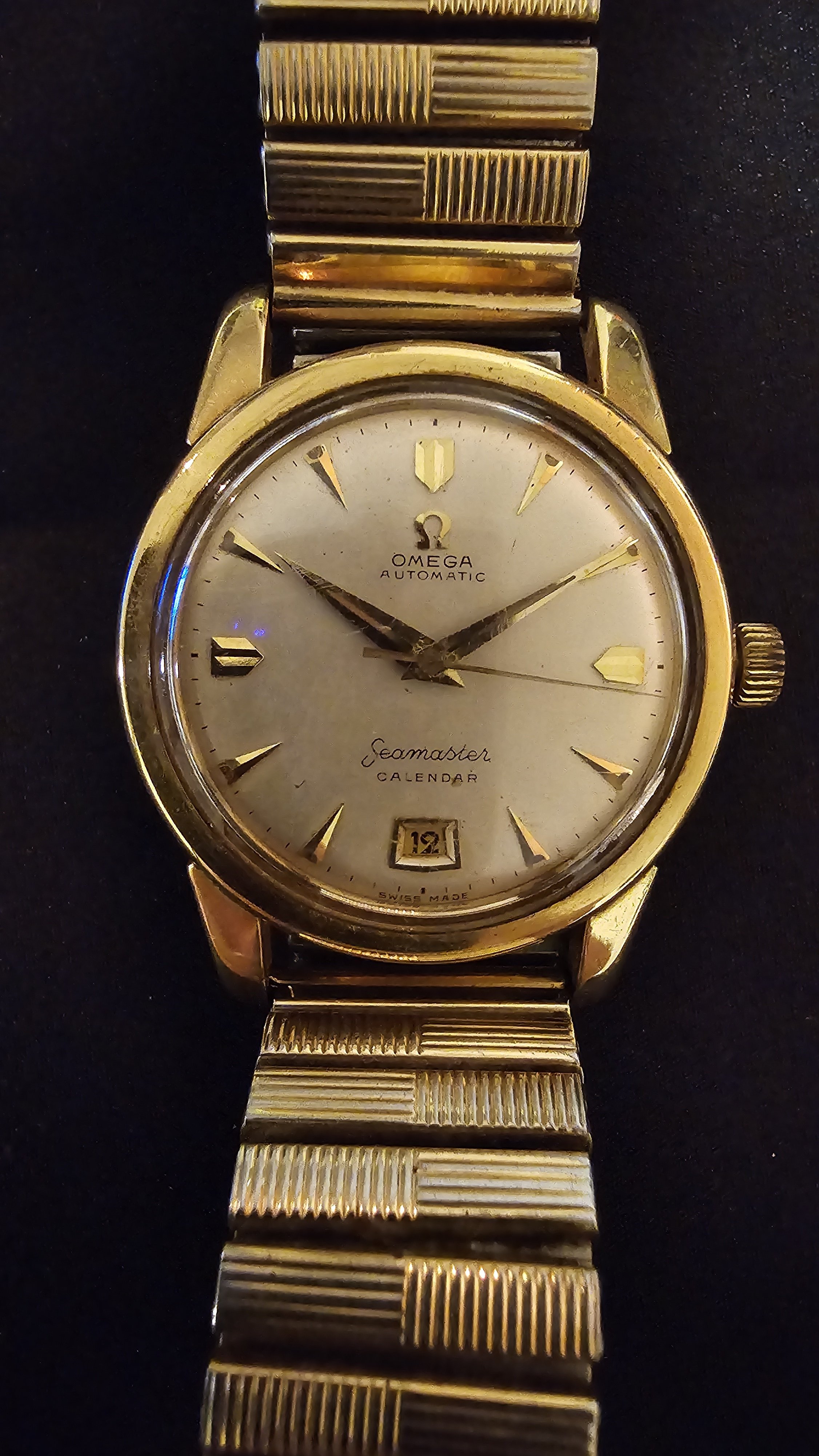

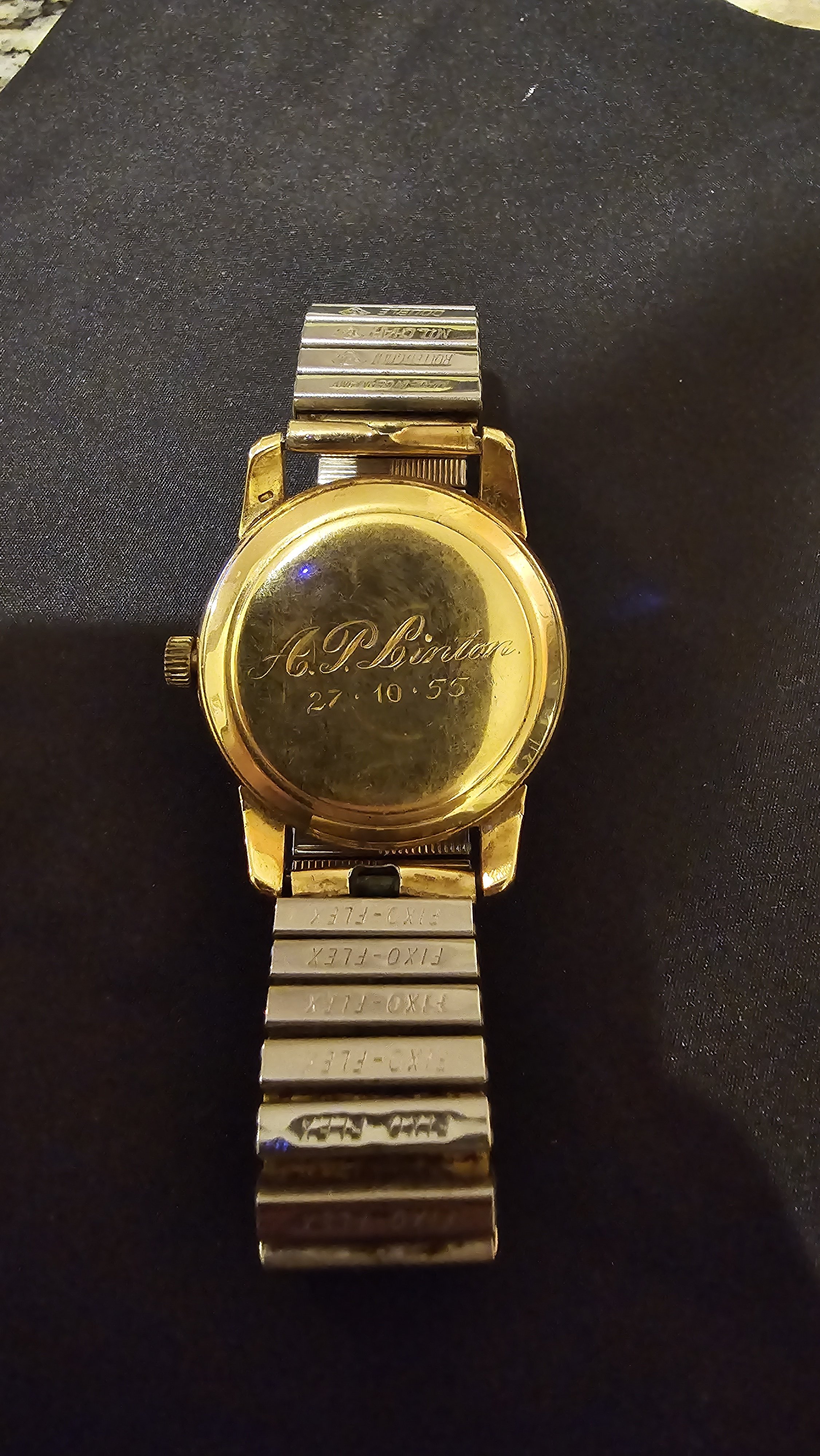

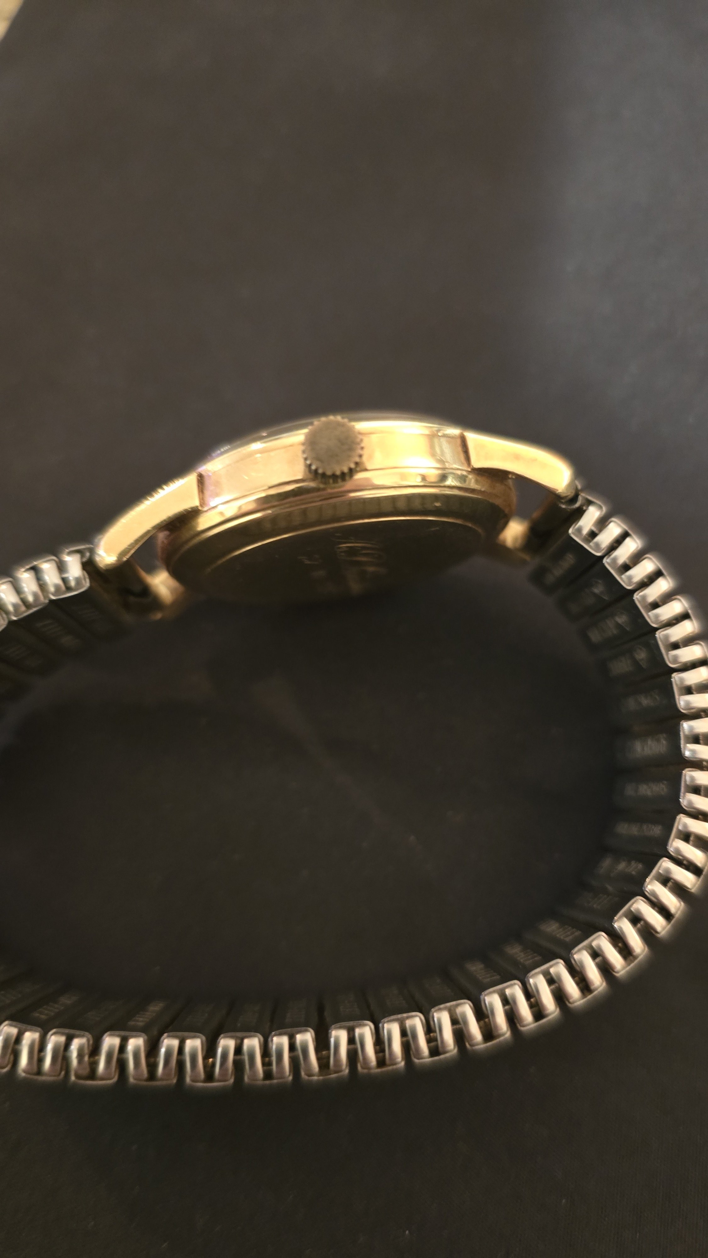

Hey everyone,
New to the thread. My dad gave me his father's watch and I'm trying to find out about the watch and restore it so I can give it back to him for his 70th birthday. I don't think the strap or the crown are original either unfortunately so I'd like to try get those sorted out as well. Is that even possible since the watch is so old?
I included some photos of the watch too hopefully help with identifying.
Really been enjoying reading through these forums these last couple days and would appreciate any input from those who know about the watch.
Thanks!

Very nice Omega Seamaster Calendar from the mid-1950s.
You are right about the crown and bracelet, both are after-market.
As this is a solid gold case, the bracelet should be removed. The steel end pieces can chew away at the softer gold of the lugs.
I think it'd look nice on a plain brown or black leather strap, which would be what it originally came with from Omega.
If you tell us your location then somebody may be able to recommend a suitable watchmaker to service the movement.
No further restoration should be attempted.

It’s a solid gold 2757 reference from ~1953.
I believe this crown should work for you, assuming you’re okay with a used crown that will not be remotely waterproof. This one is an original from the ‘50s, but newer replacement crowns are available as well.

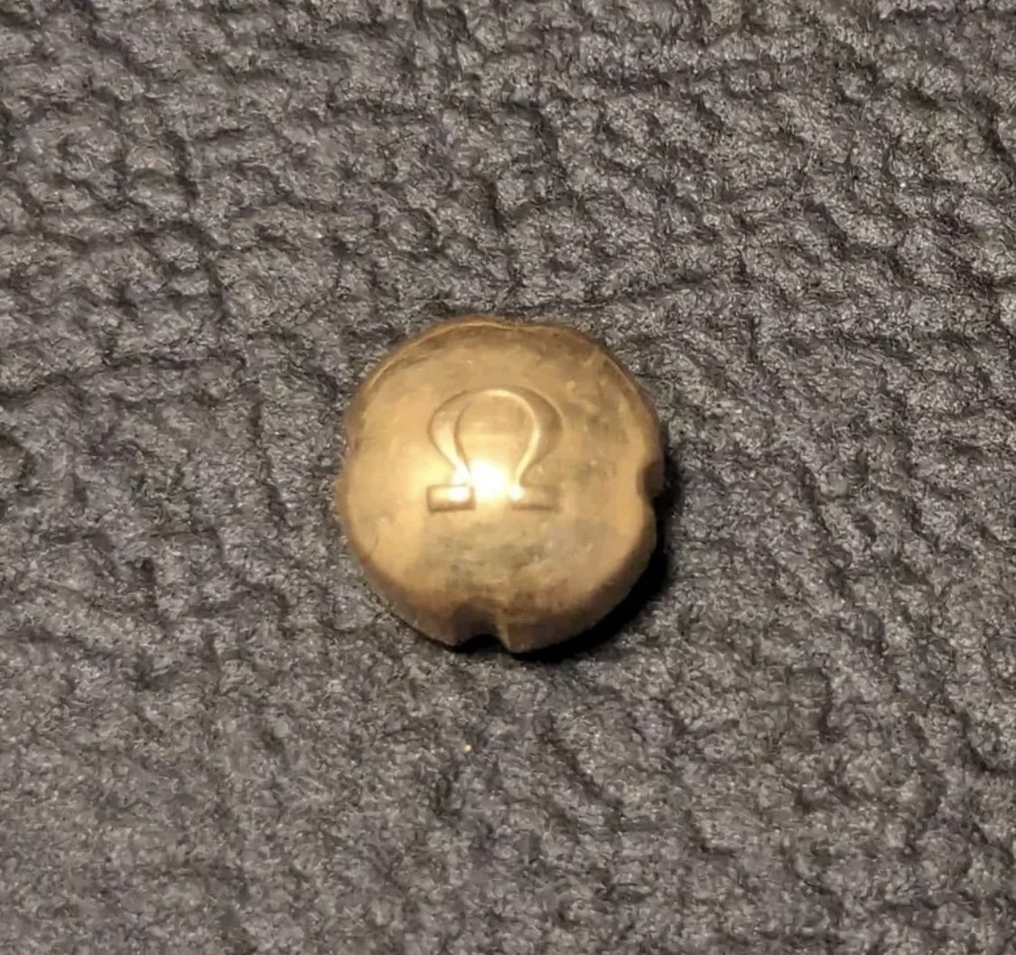

Thanks so much for the response!! I'm also sorry for such a late reply, I didn't see the notifications of the responses. I removed the band and ordered this one:
https://www.ebay.com/itm/405088201157
Is there anyway to get a crown that would be waterproof? And apologies for all the questions, but does anyone know what replacement crystal I would need? I would love to get the glass replaced as well.

3,597
7,816
Nice watch great family heirloom. If you want it to be water resistant (maybe proof) and wearable by your dad- your best bet is to take it to an independent Omega-certified watchmaker- and they will service it and replace the gaskets and crystal and install a service crown with proper seals- and you will have a wearable watch. They will do a pressure test to make sure its water resistant- it wont be for swimming but good for everyday wear. Dont have it polished dont replace hands. Dont have them touch the dial. Dont send to Omega it will be prohibitively expensive and they will replace too much and destroy the vintage appeal.
