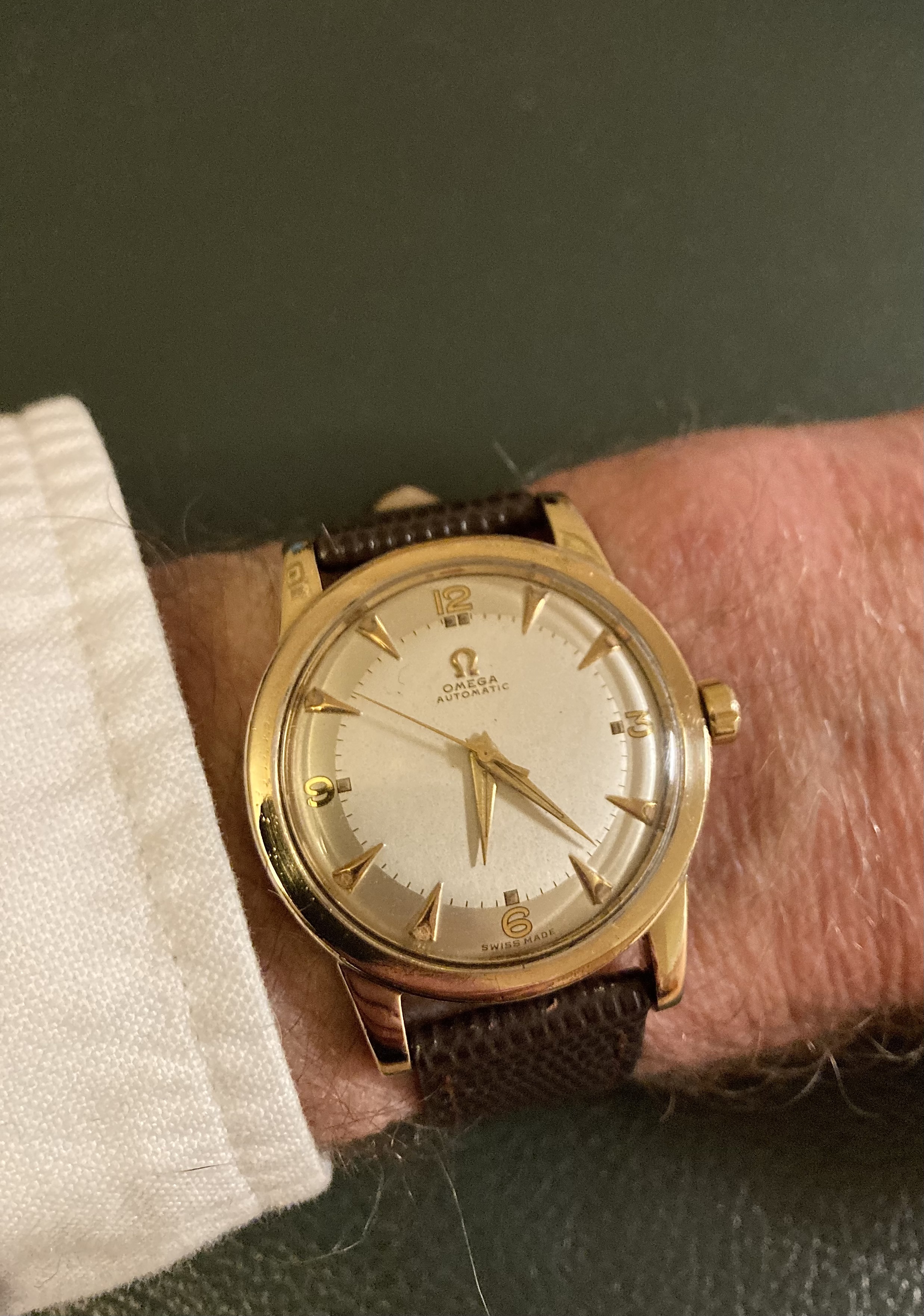

I just received a text from my wife with a pic of a watch her father (85yr old) just gave her because he knows I'm interested in such things. I won't physically have it for a few more days when she gets back. I've been searching around for another exact example online but no luck. I'm fairly sure its from the 40s-50s. Bumper movement maybe? This would be an older era then I usually go after. My thing is F300s and 60s Seamasters. So far this pic is all I have.
Just for fun, anybody want to give it a shot?

Unfortunately with its badly refinished dial you are unlikely to find another one just like it in that regard, however you're on the right track about what it generally is, 1950s bumper.

I thought that dial looked a bit sketchy. I'll open it up when I get and see if the rest is salvageable. Perhaps a replacement vintage dial could be found. I see it doesn't have the sub seconds dial. What movement number might that be? 351 ?

Going out on a shaky limb based on your photo, ref G6213, caliber 351/354.

Many of these were nationally cased, making them difficult to identify.

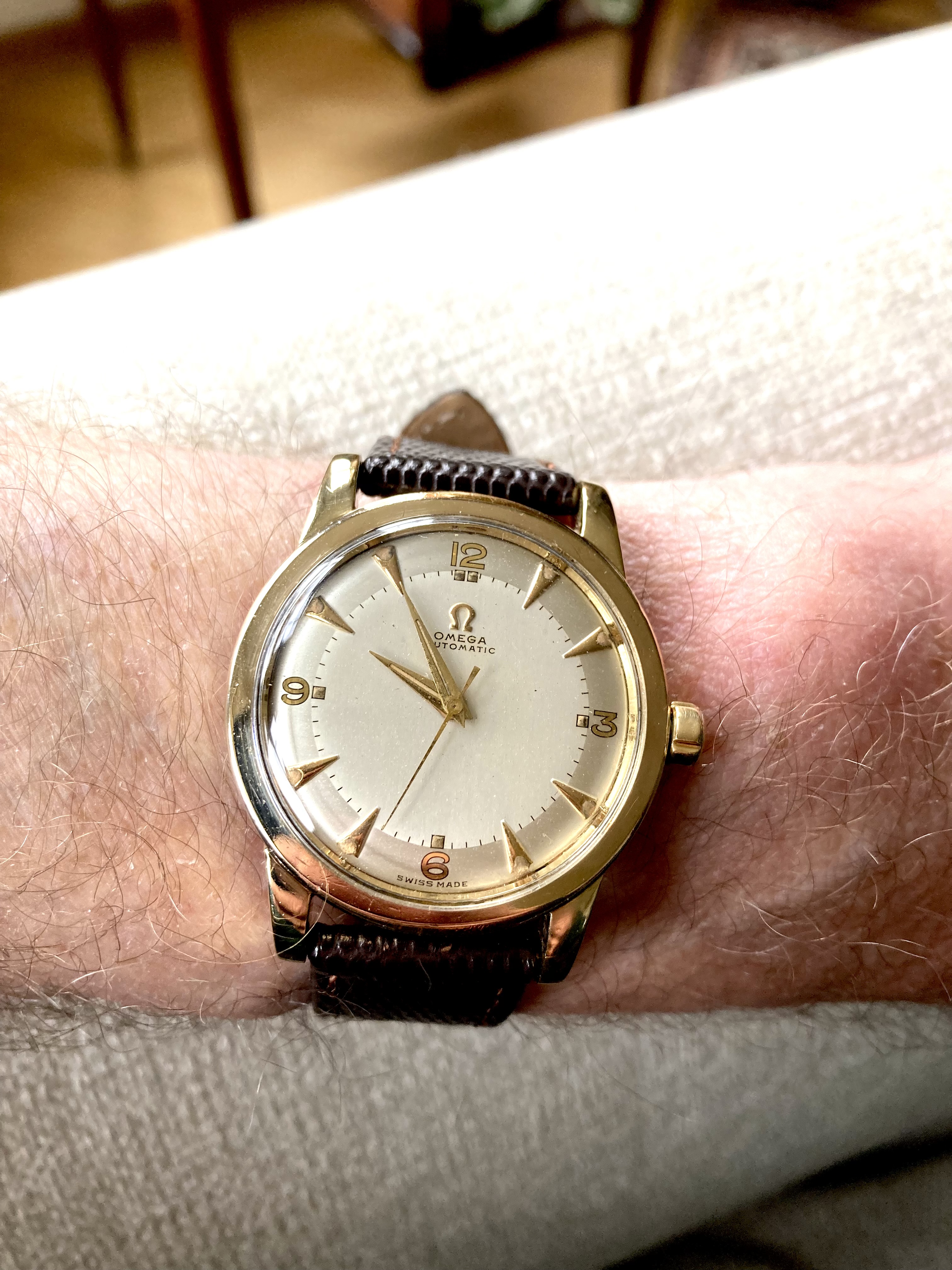

This is my 1950 cal 351

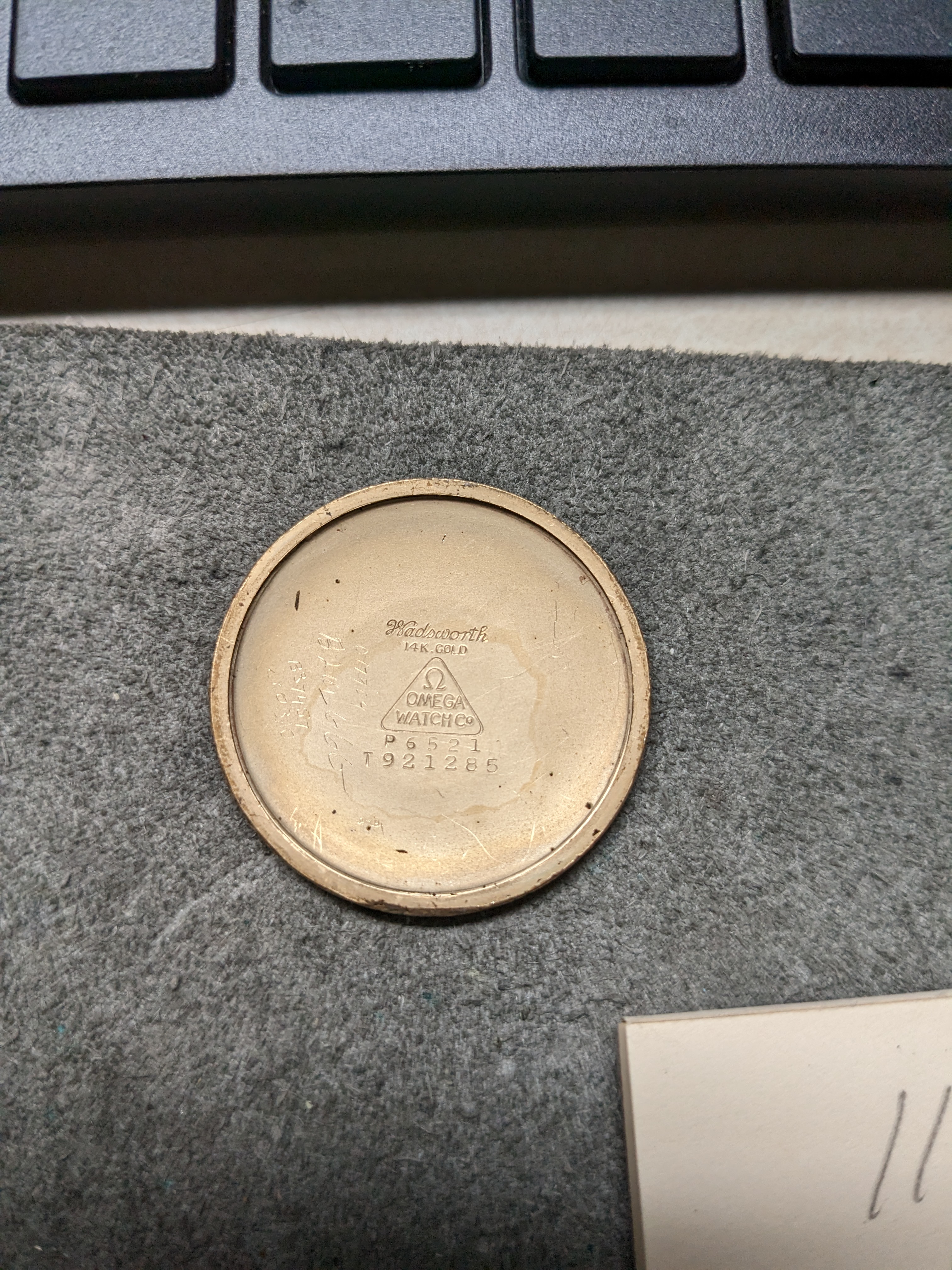

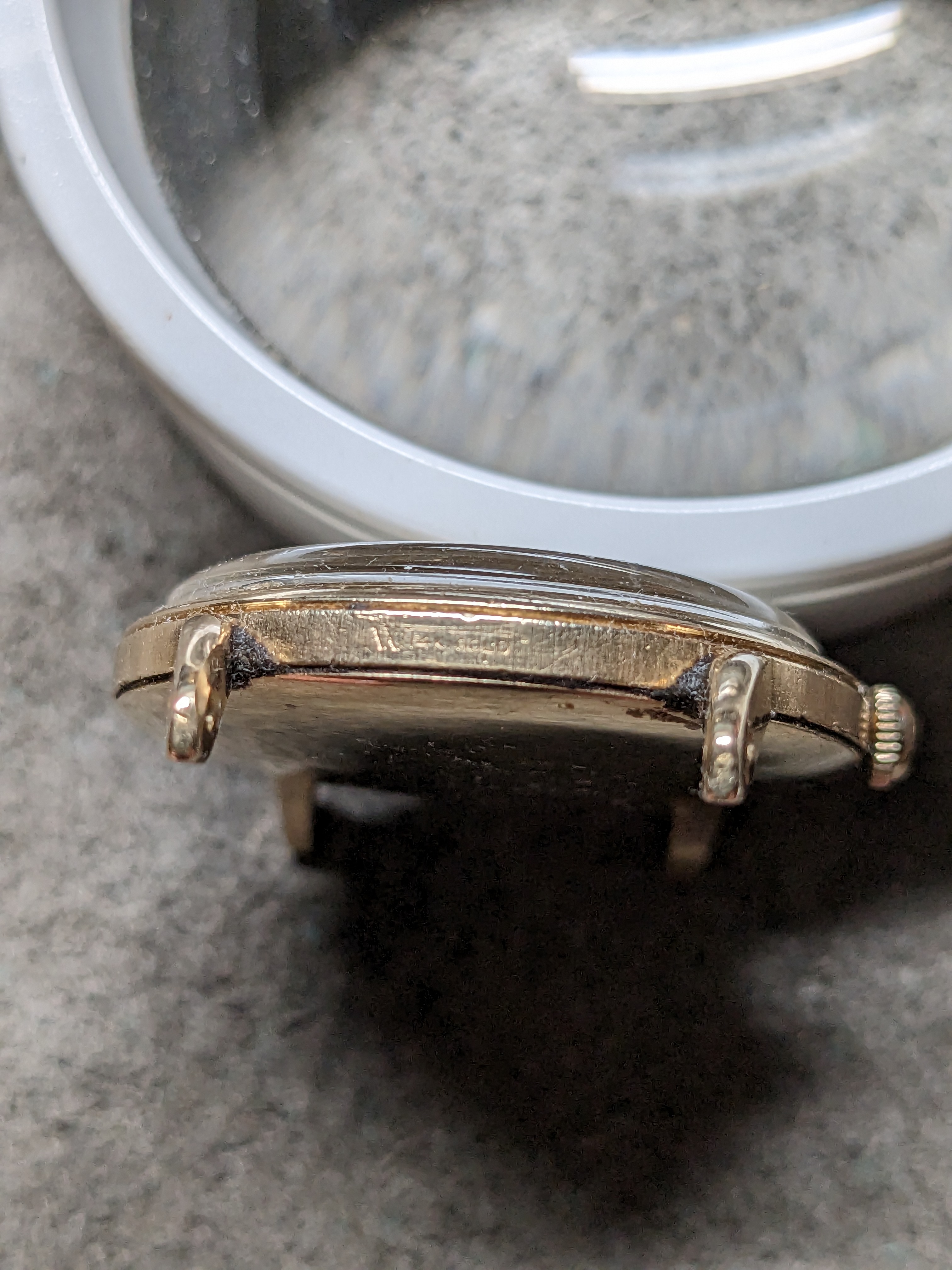

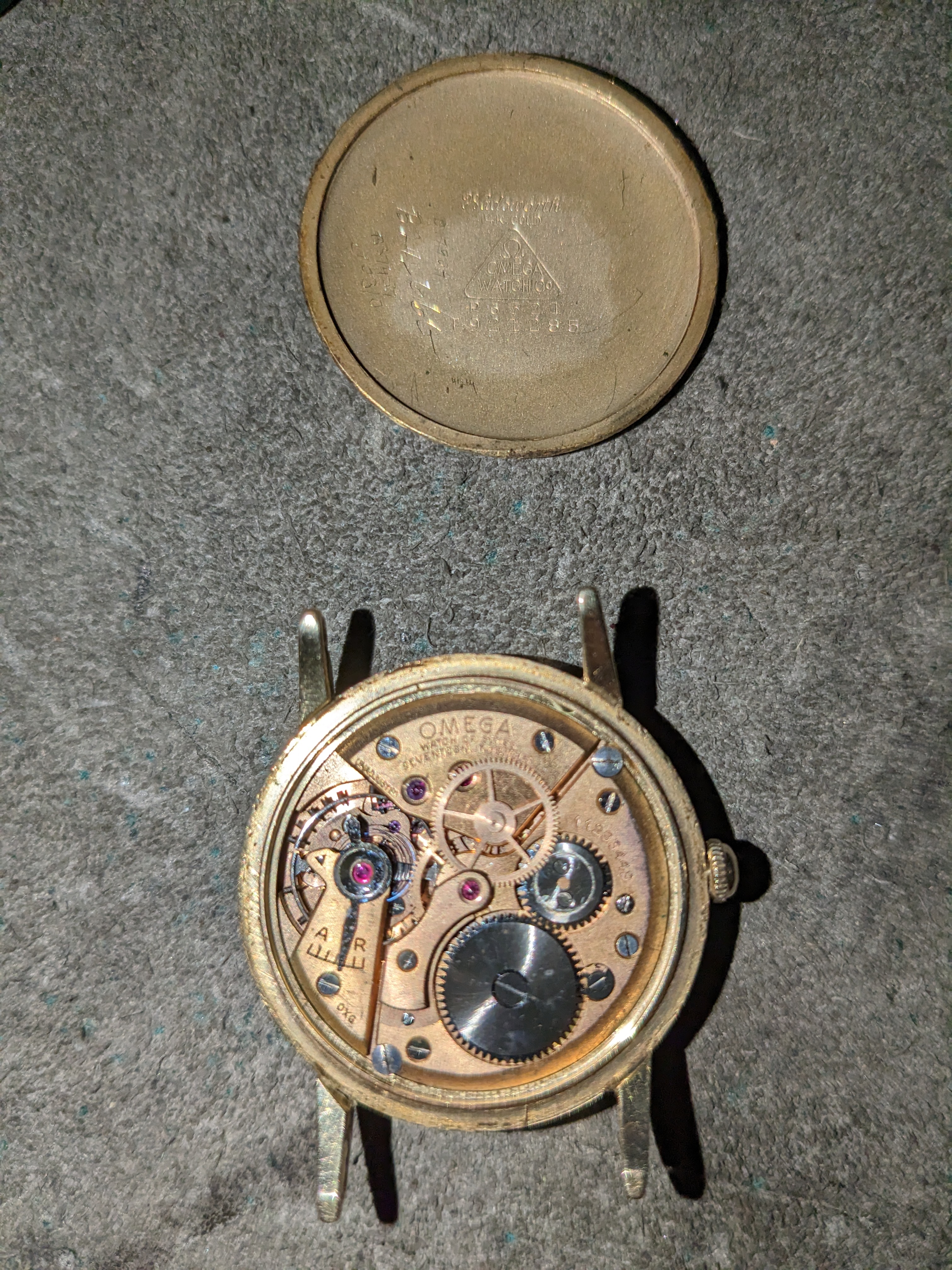

Got the watch, while cleaning it i discovered this between the lugs.
W brand and 14k , so it's solid 14k at least (I think). Running intermittently ,original crown, i think it's worth doing something with
Can't get back off safely.
24,836
55,255
IIRC, that W refers to a US case maker, Wadsworth? I think.

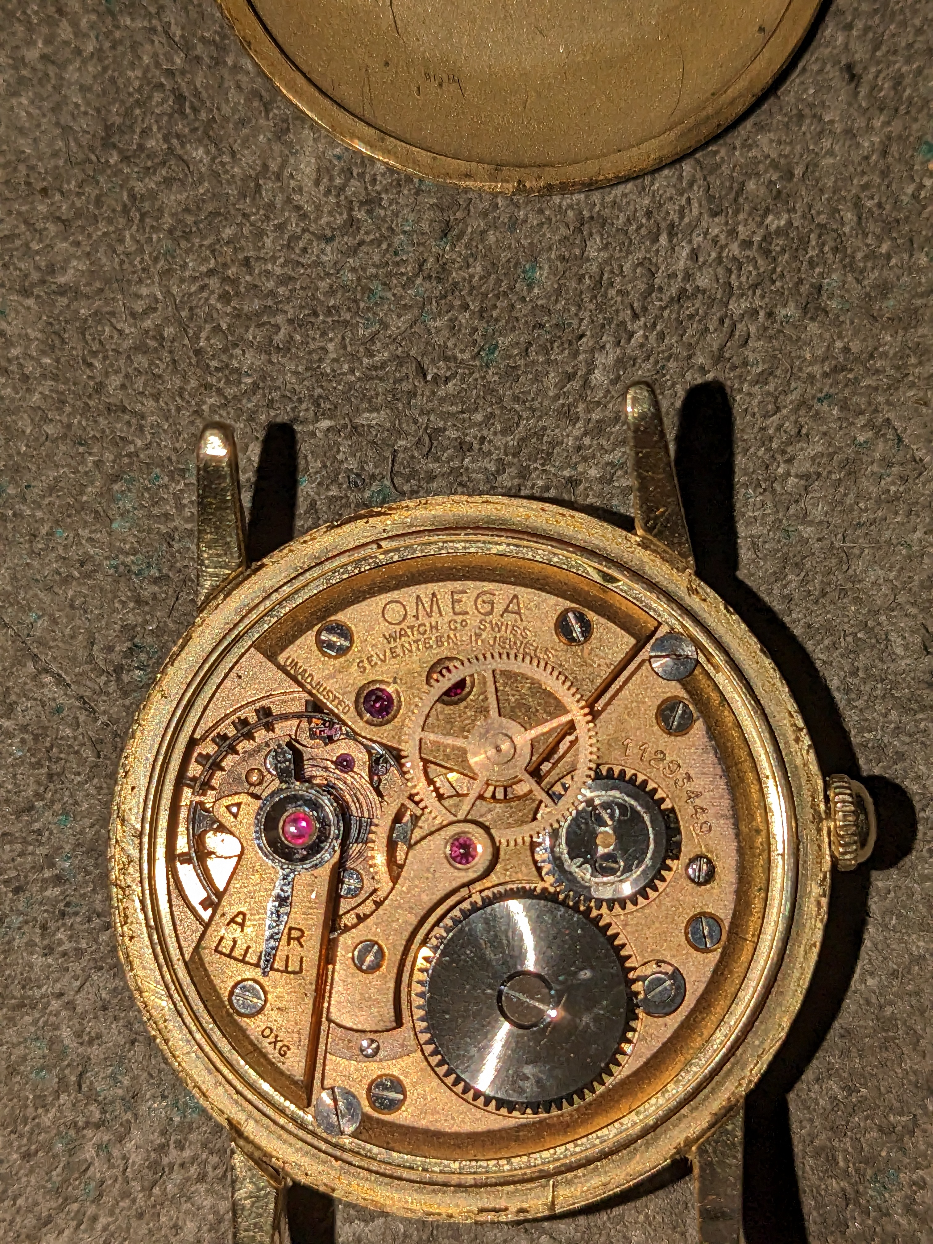

39
3
The plot thickens...

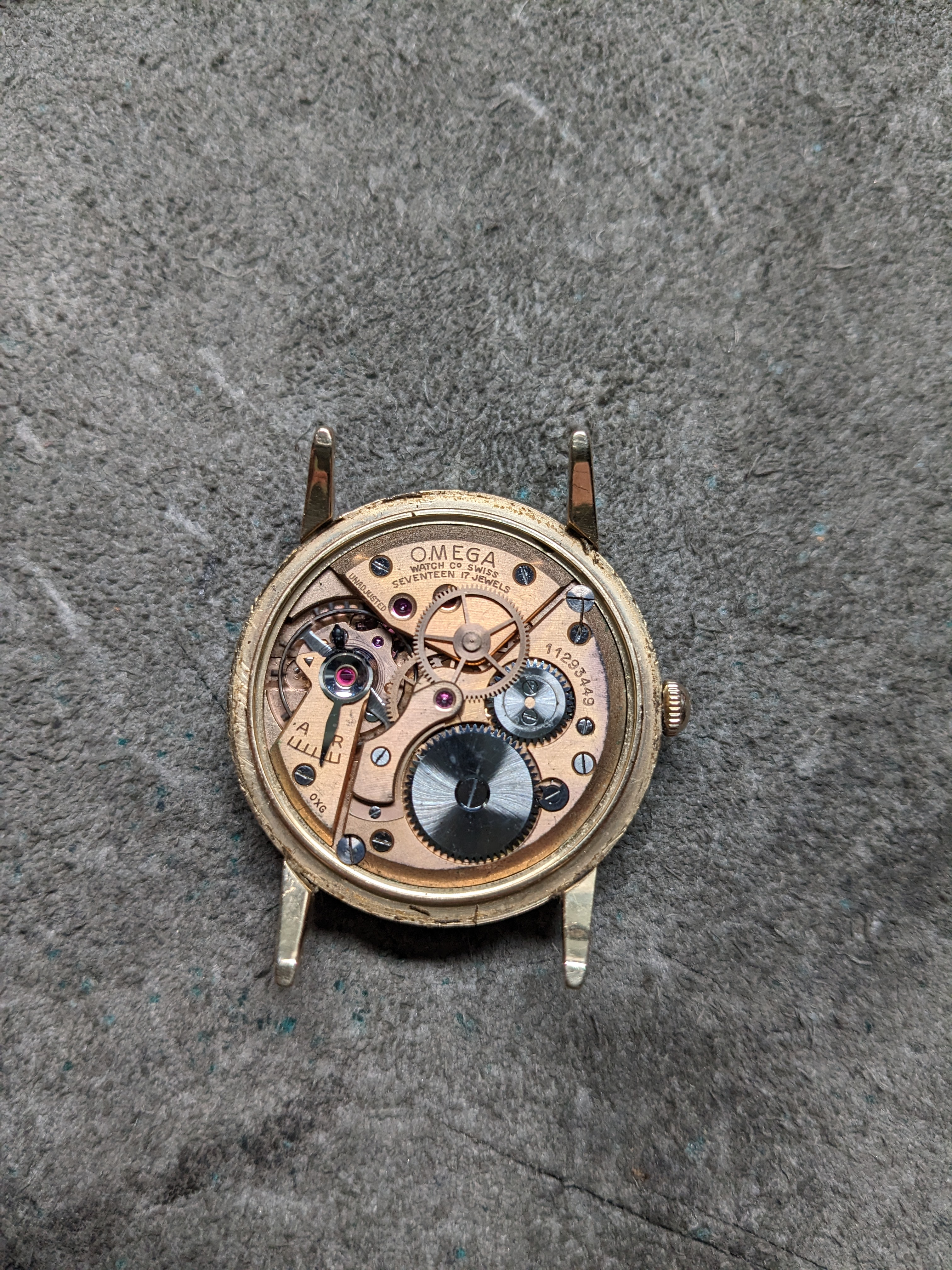

I succeeded in removing the back. Not even an automatic! Movement dates to 1947. But no caliper code in the later style, but there is one UNDER the balance, movement is a caliper 28.SC. Wadsworth case, T921285, ref p6521.
I think the balance was damaged in the drop. It restarted and then stopped. Thoughts?
24,836
55,255
Probably not much more to be said. US-cased watch with a repainted dial that says "AUTOMATIC." I guess someone found a dial they liked and just copied it verbatim. Kinda' funny if you think about it.
