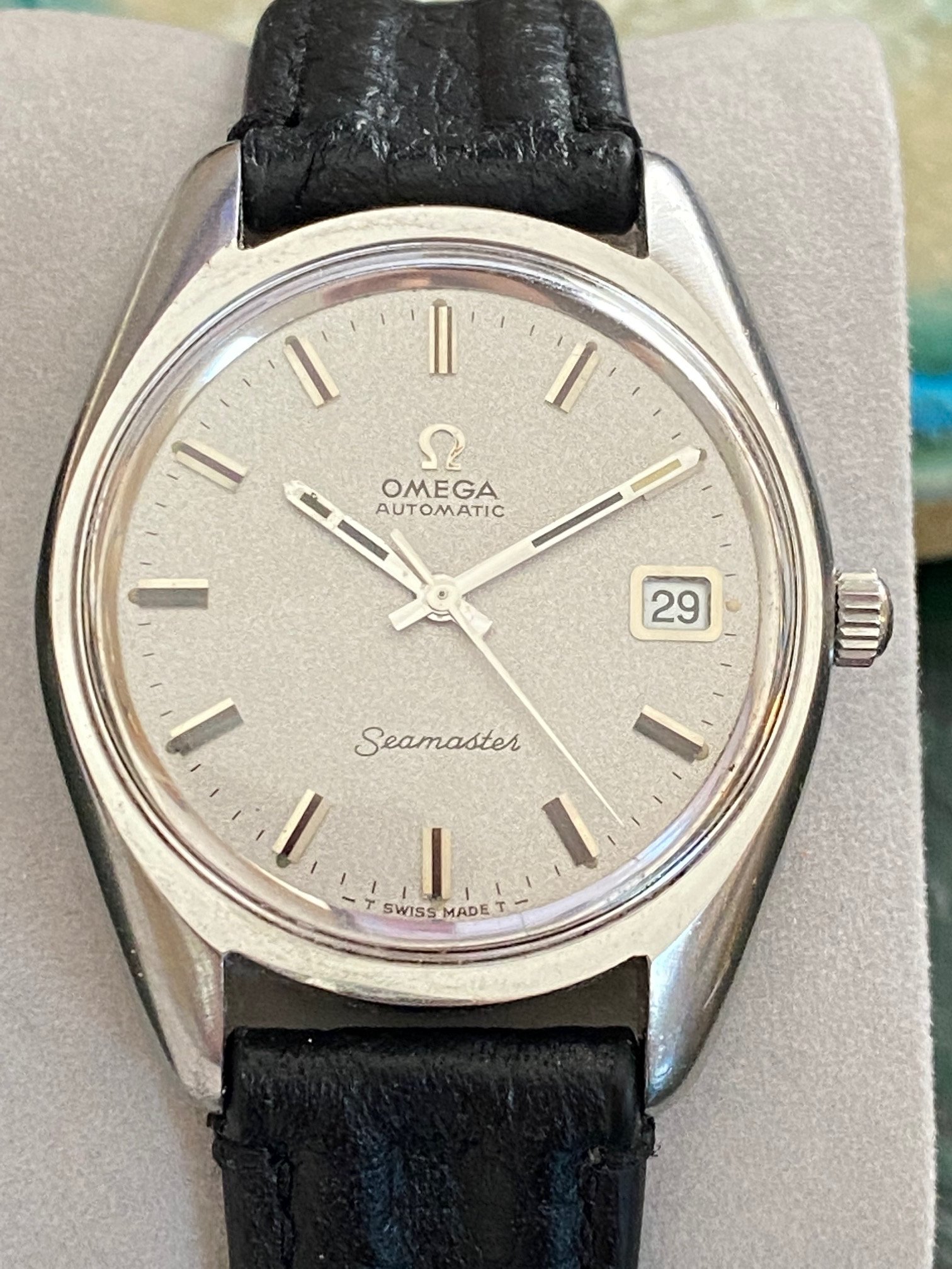

Hello,

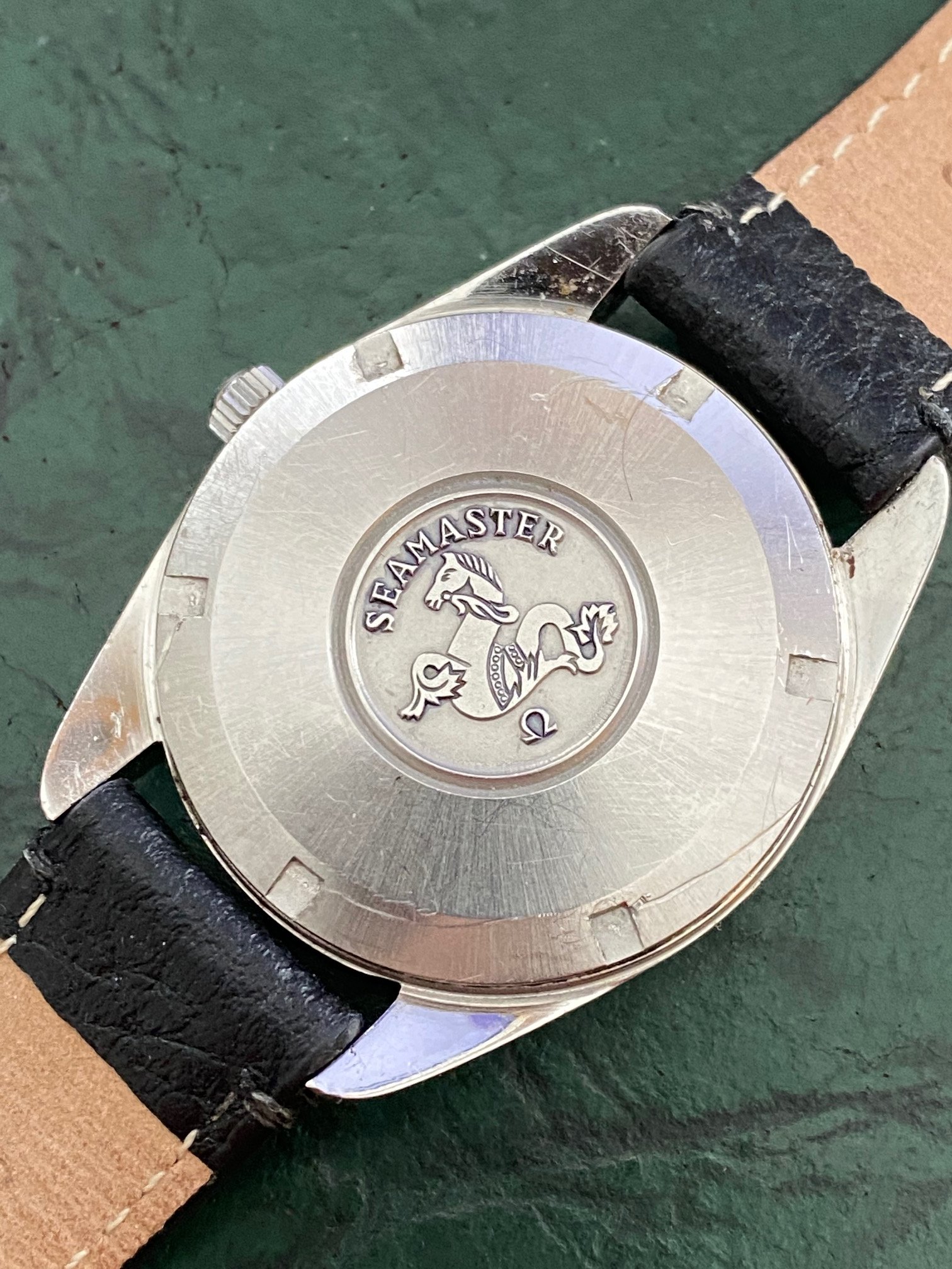

I have the Omega Seamaster Automatic watch in the photos. I am unable and unwilling to try harder to remove the back in order to determine the model and calibre. Does anyone recognize this watch? It has a slightly grayish sparkly dial and is 35mm in diameter with 18mm lug width. I am not responsible for the scratches on the back and I do not wish to add to them.

Perhaps a 166.067, which would generally have a cal 565. If you google vintage Omega Seamaster sparkle dial, you be able to identify it pretty quickly for yourself. Of course, without opening it up, who knows what strangeness one might find.

Your identification is doubtless correct, but I wouldn't use the phrase '166 series' personally. There is no such series unless you want to include every non chronometer rated Gents water resistant calendar equipped Omega since 1962. The first part of the case number indicates the basic watch spec, not the model or case shape. That tends to be indicated by the second part.
