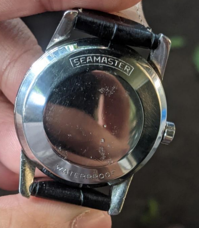

Anyone know the case code for this model? On a side note, is it a redial?

Hi mate.

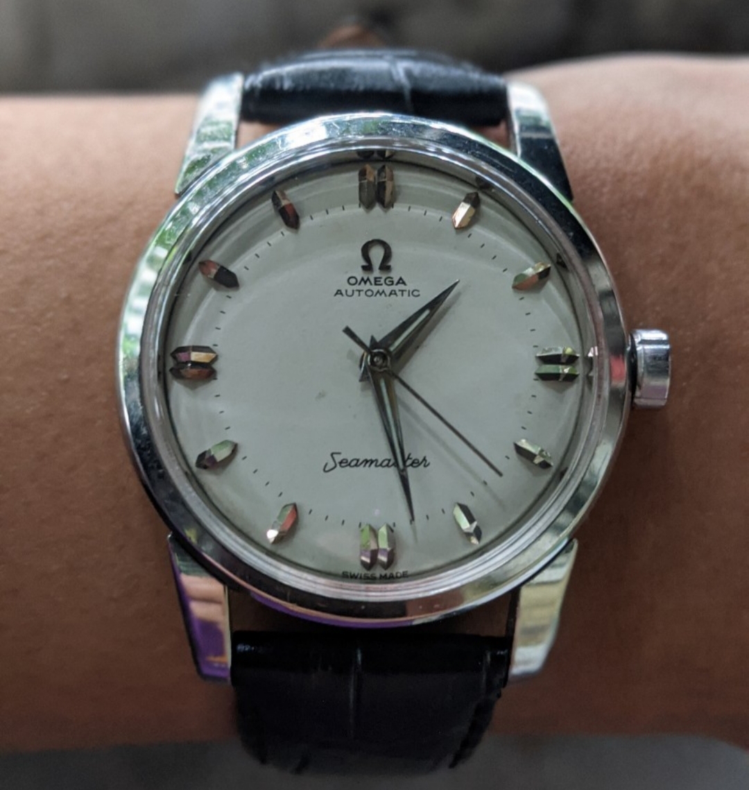

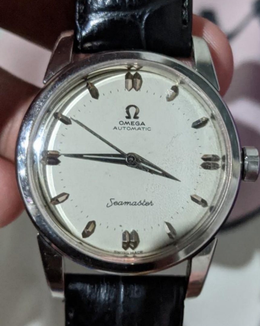

I would say that it is most likely a 2846 and I don't think it has been redialed, but it has at least been cleaned at some point and has had its minute and hour hands replaced (or they have lost their black inlay?).
9,588
27,706
The hand is incorrect?
They have stark white lume (which means they have been relumed), and this dial version did not feature lume to begin with, so the hands shouldn't either. I am uncertain whether or not they could have had black inlay to begin with, but I would expect solid hands on a watch like this.

Almost definitely 2846 ref as @ConElPueblo said.
Regarding the dial, I’ve seen these super white dials with the flat top S relatively often and I’ve wondered if maybe they’re service dials?

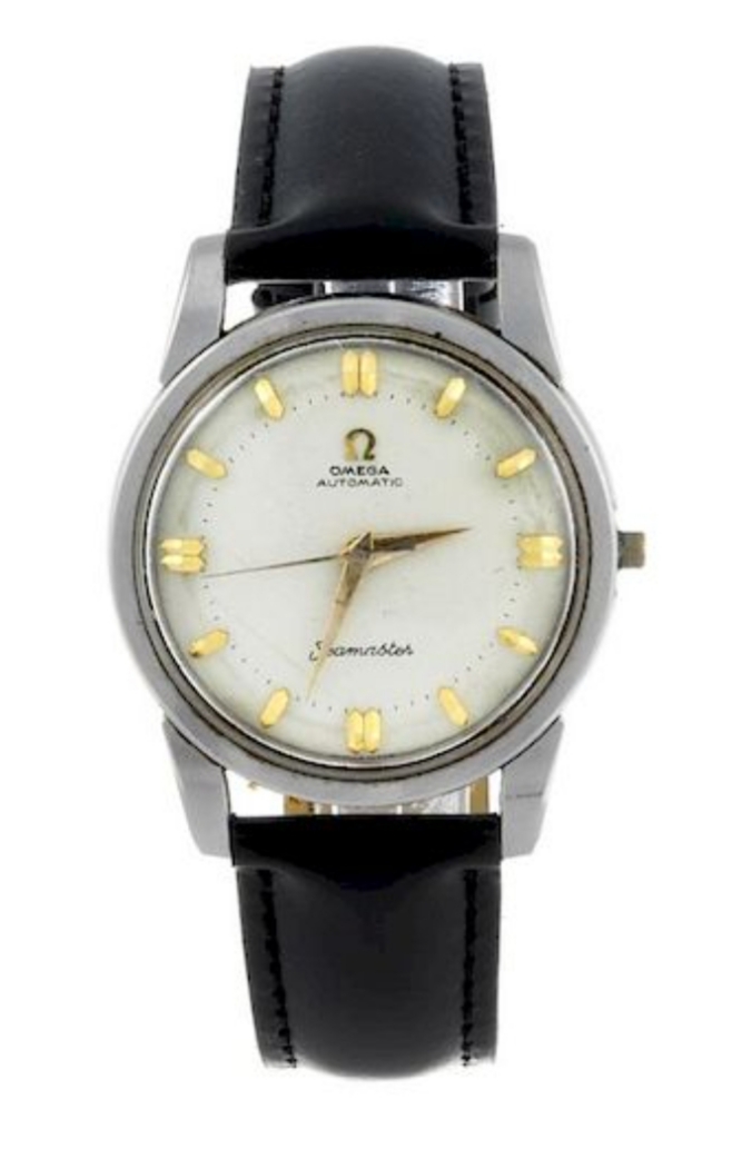

Thanks everyone for the inputs. The thing is, can't seem to find the exact dial design online. Well I actually found one at bidsquare but it would be better to find it in more reliable sites lol. @ConElPueblo thanks mate. Dead on on the 2846.
^bidsquare

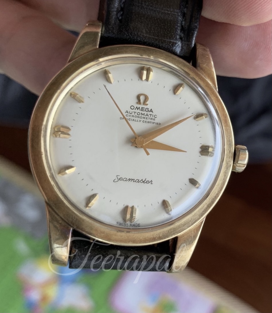

1,024
4,126
Mine jumbo version says hi.
