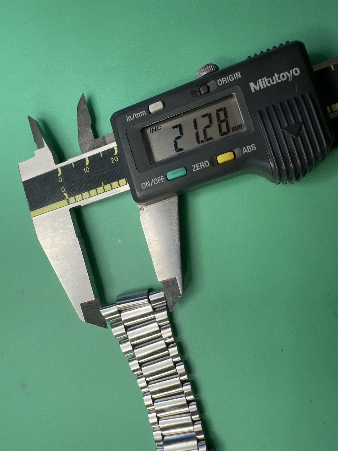

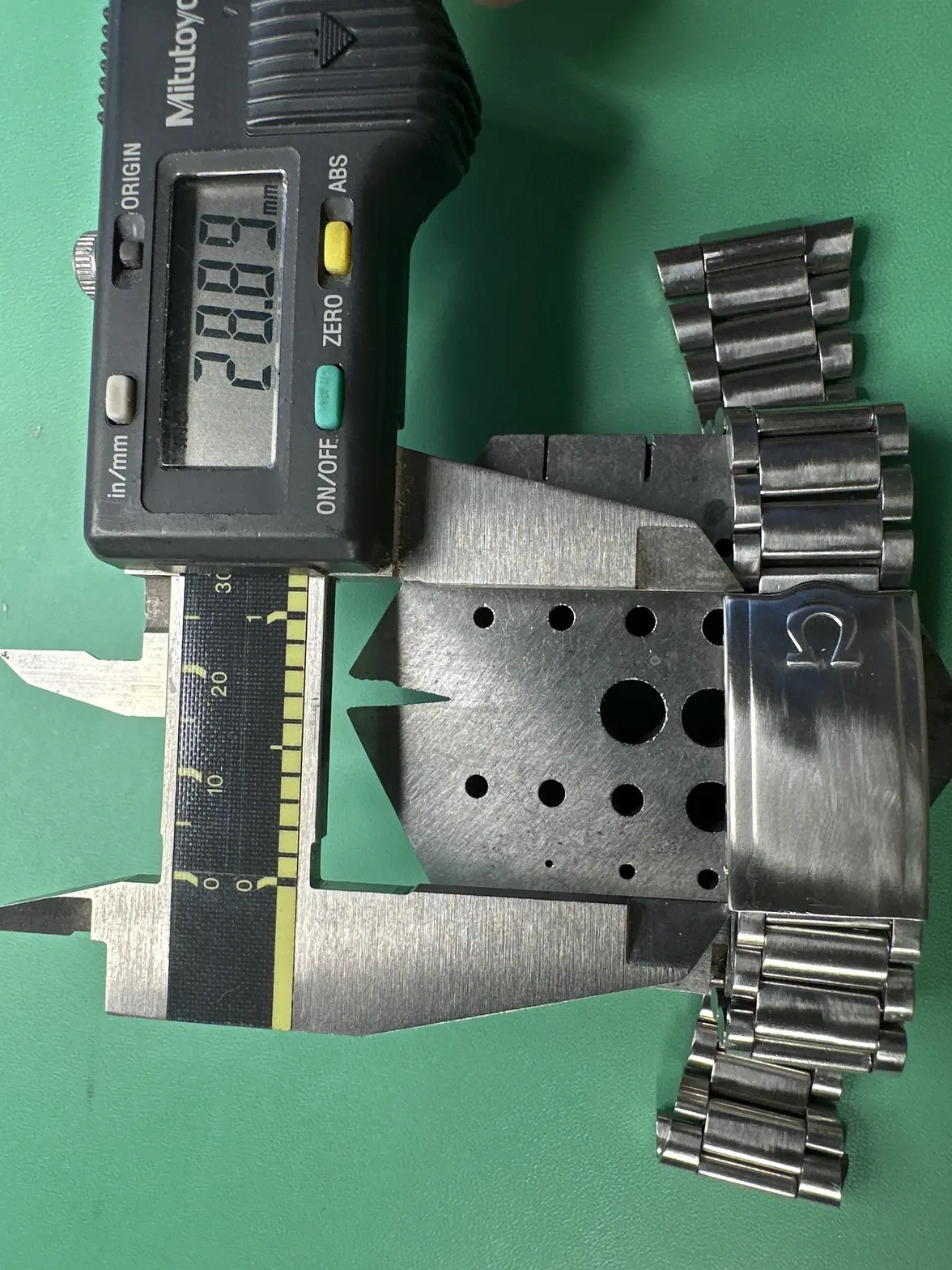

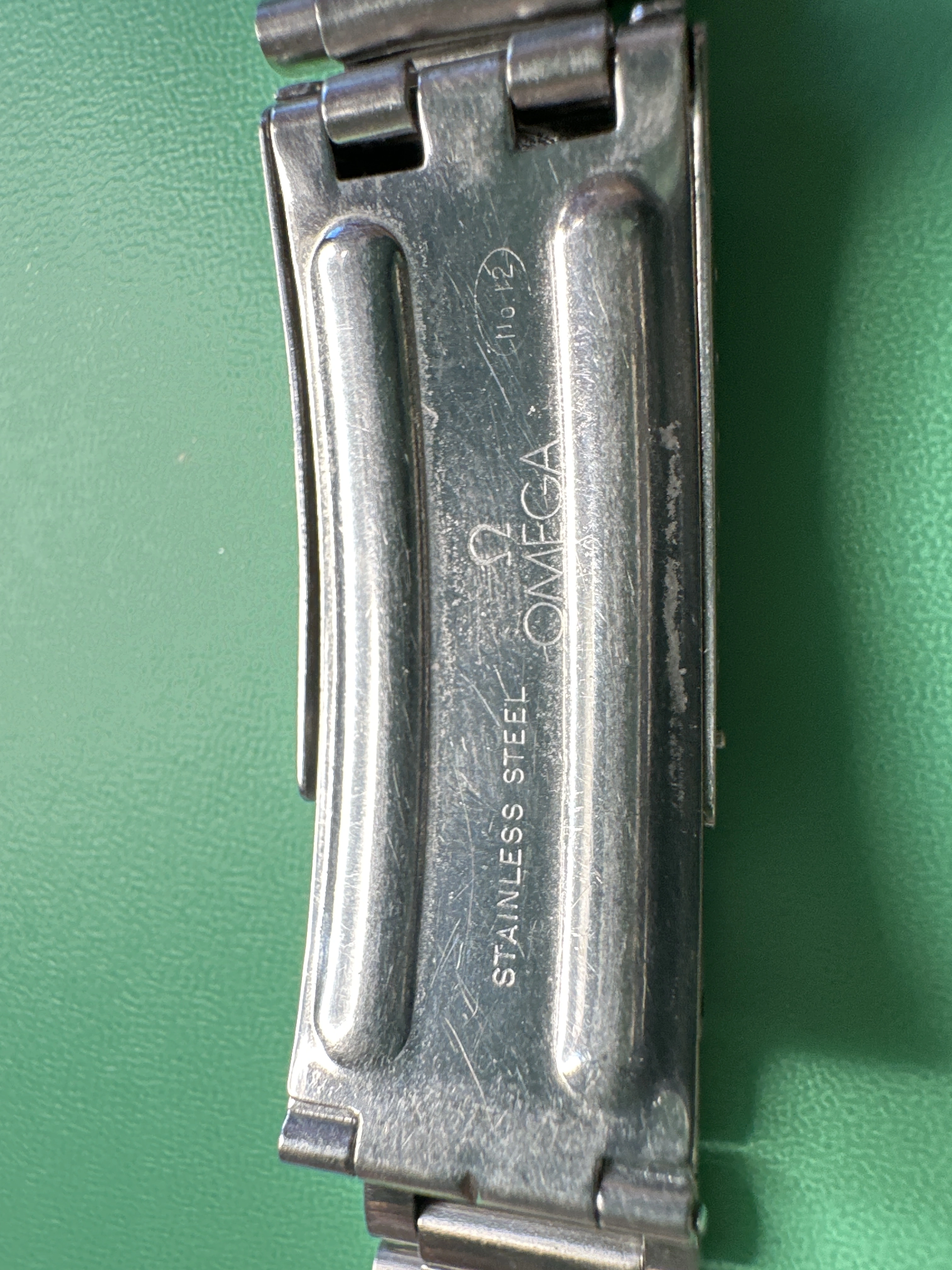

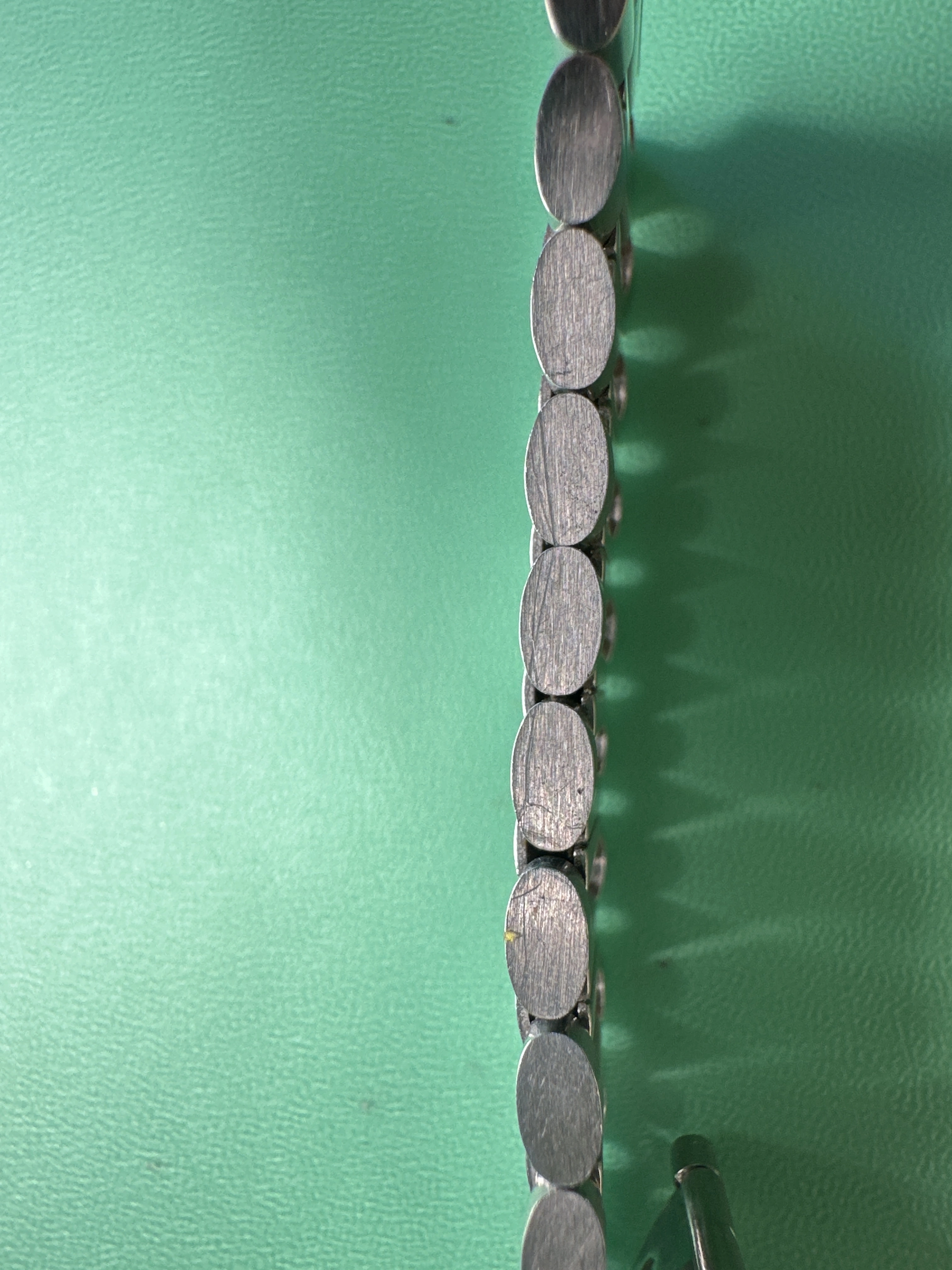

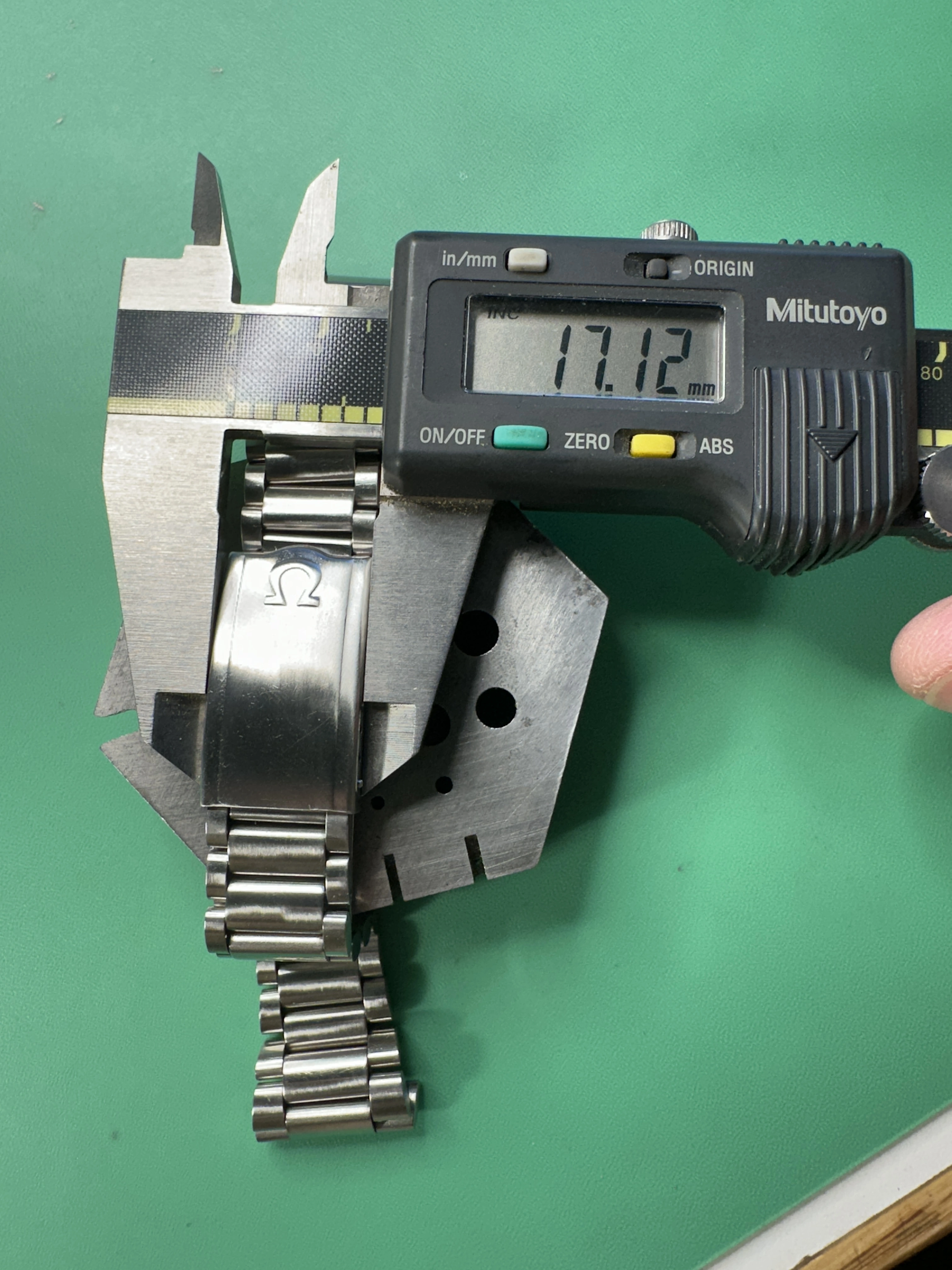

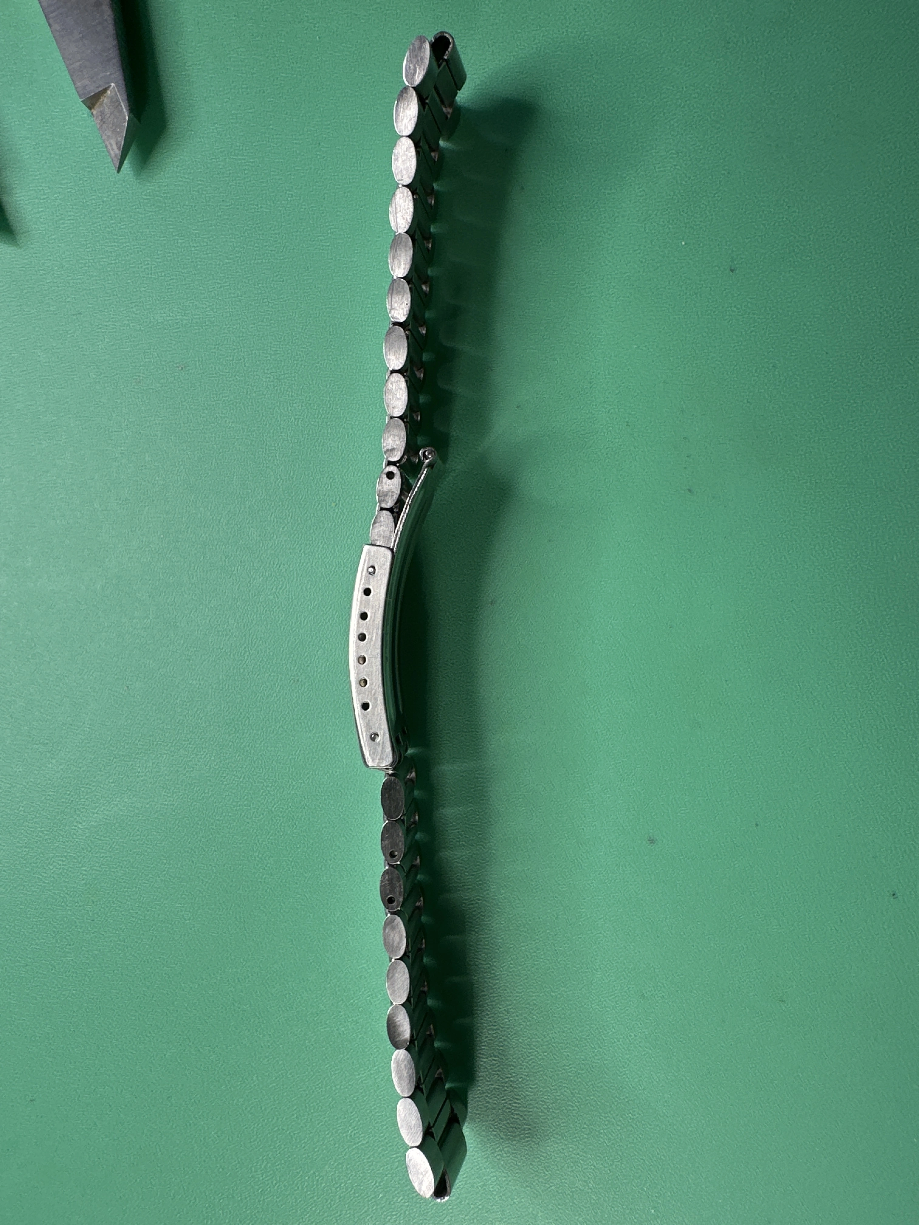

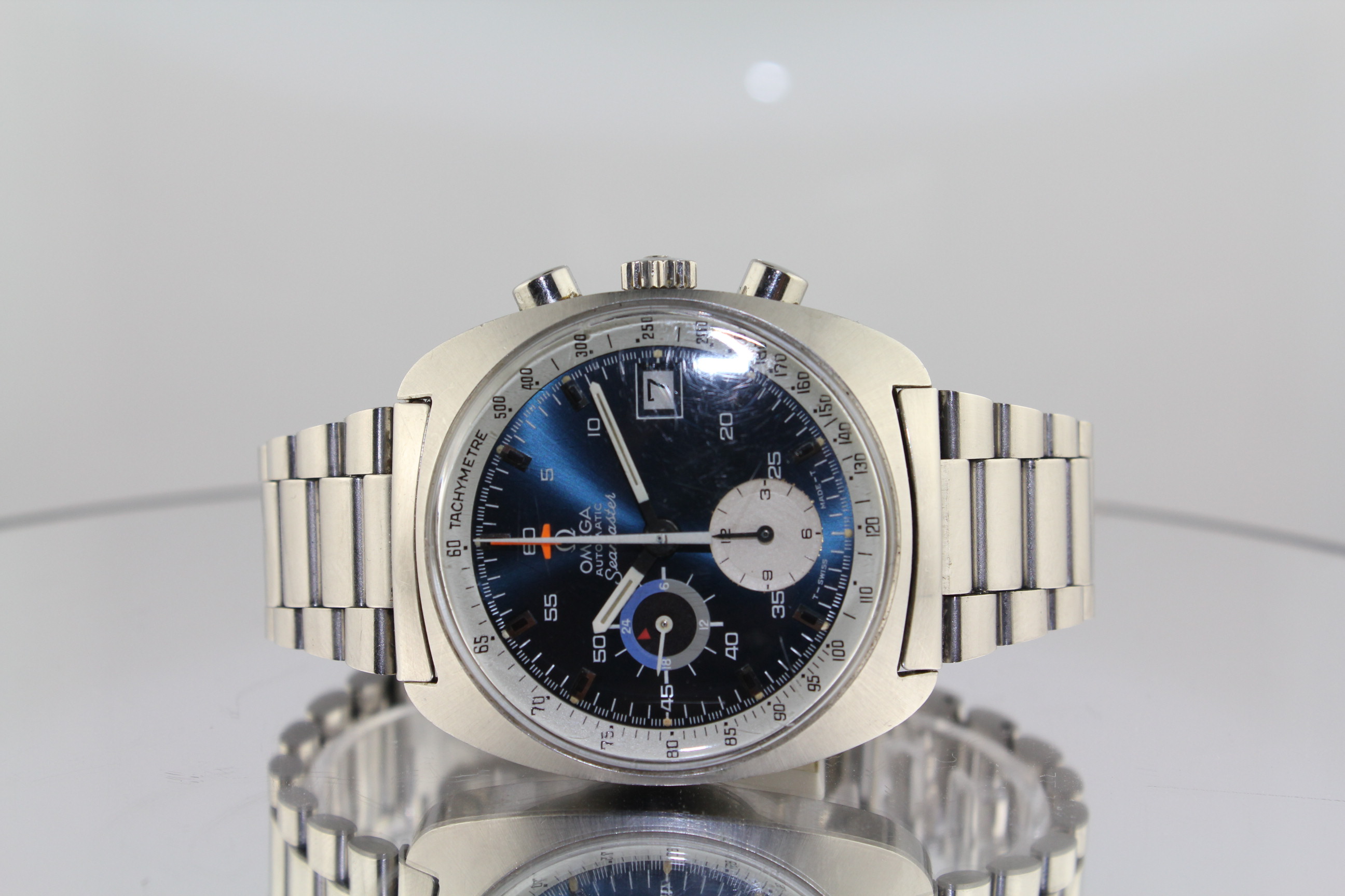

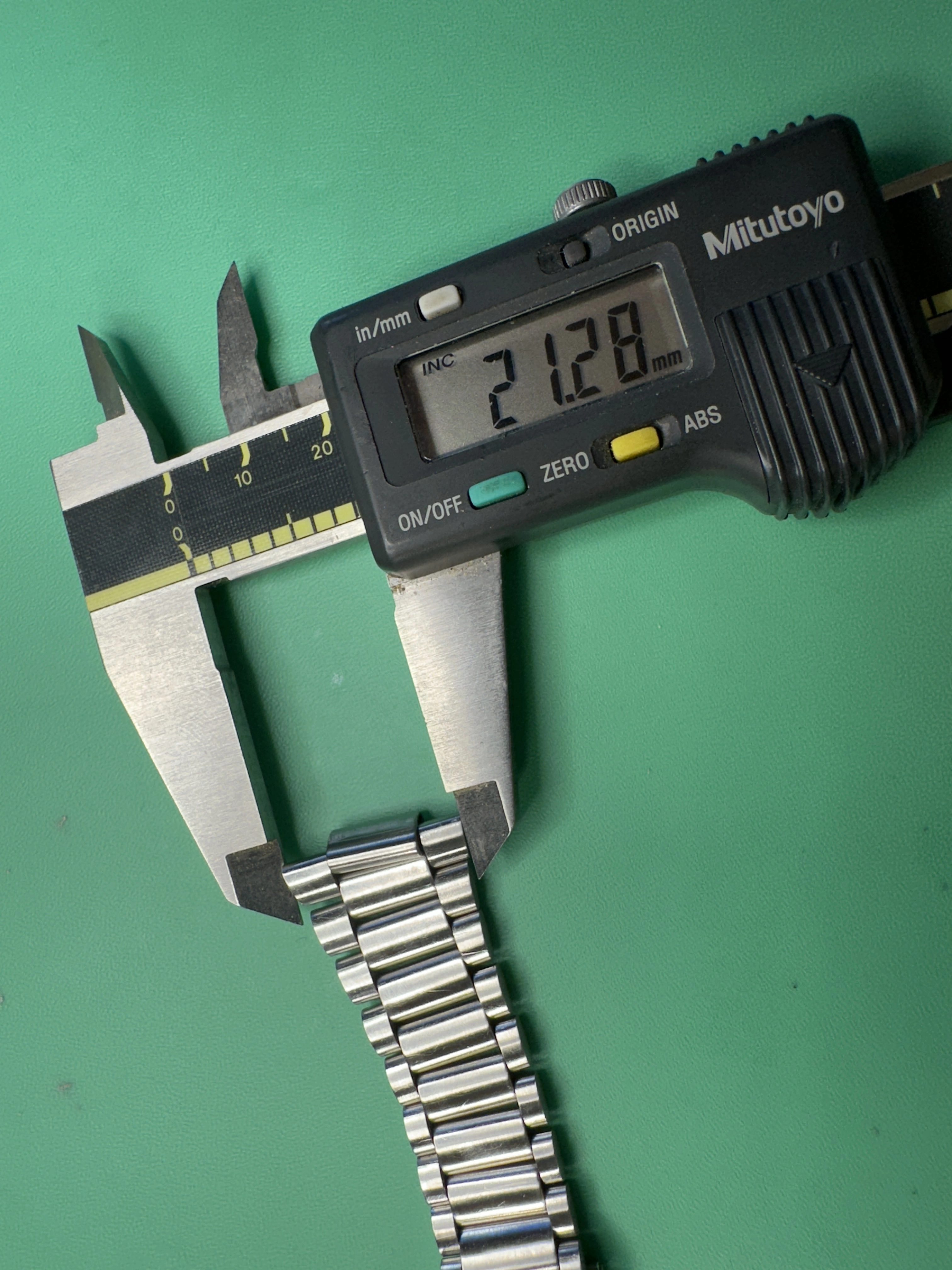

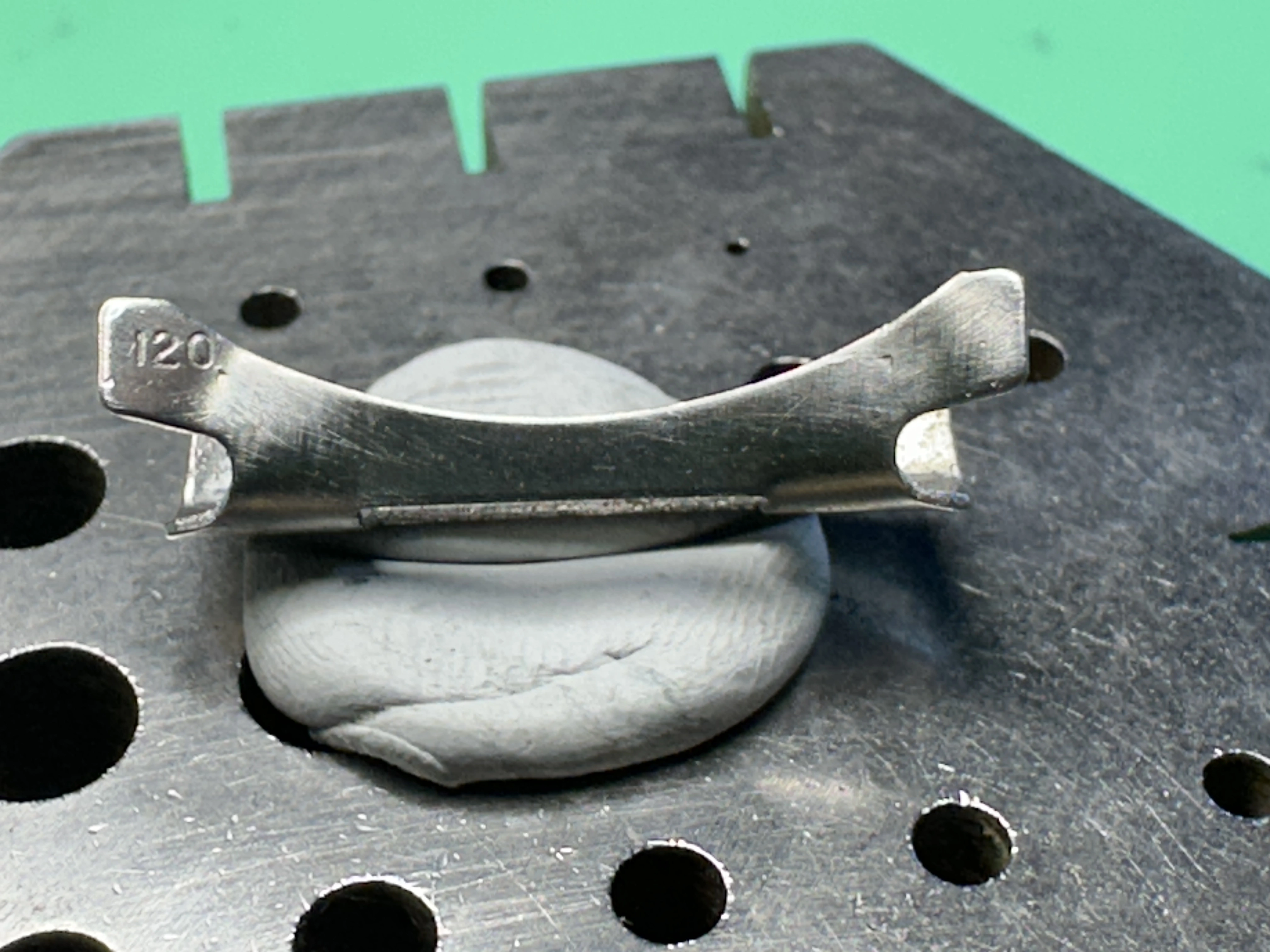

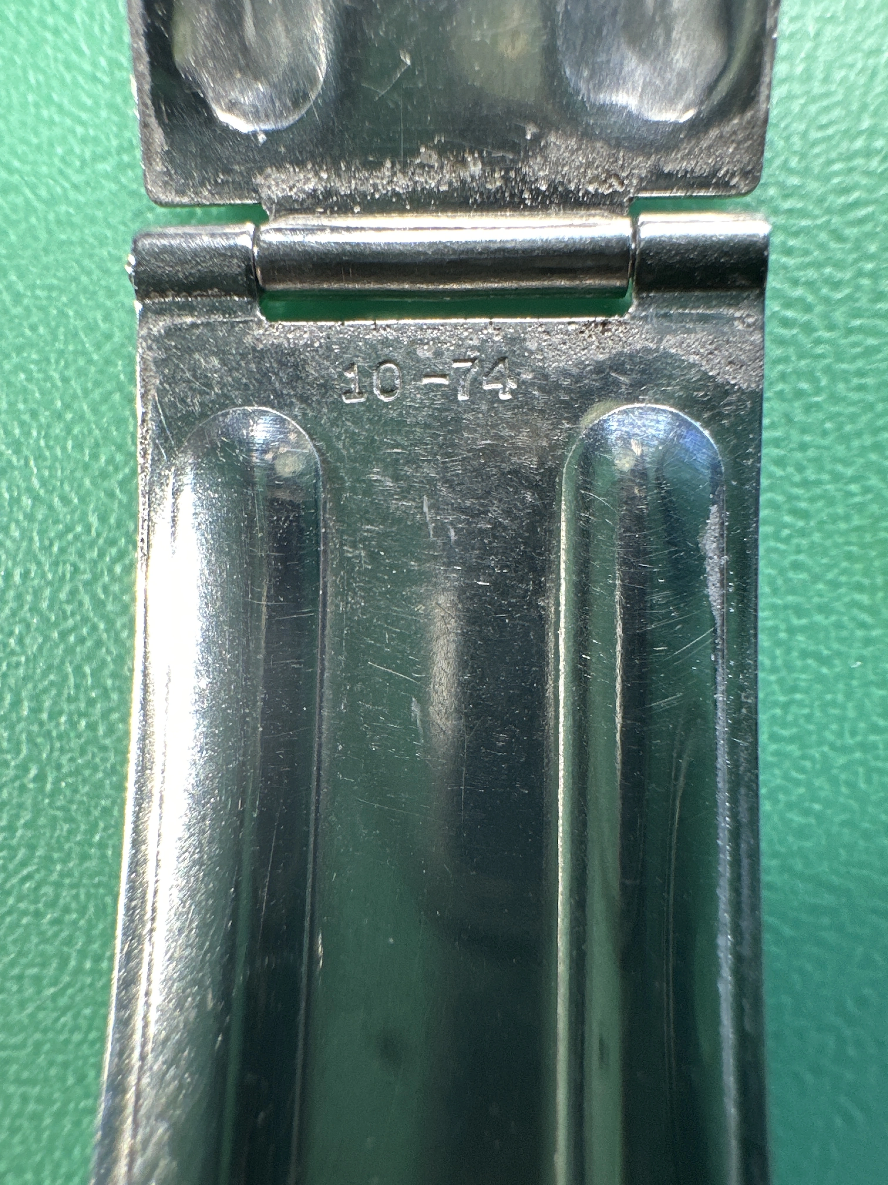

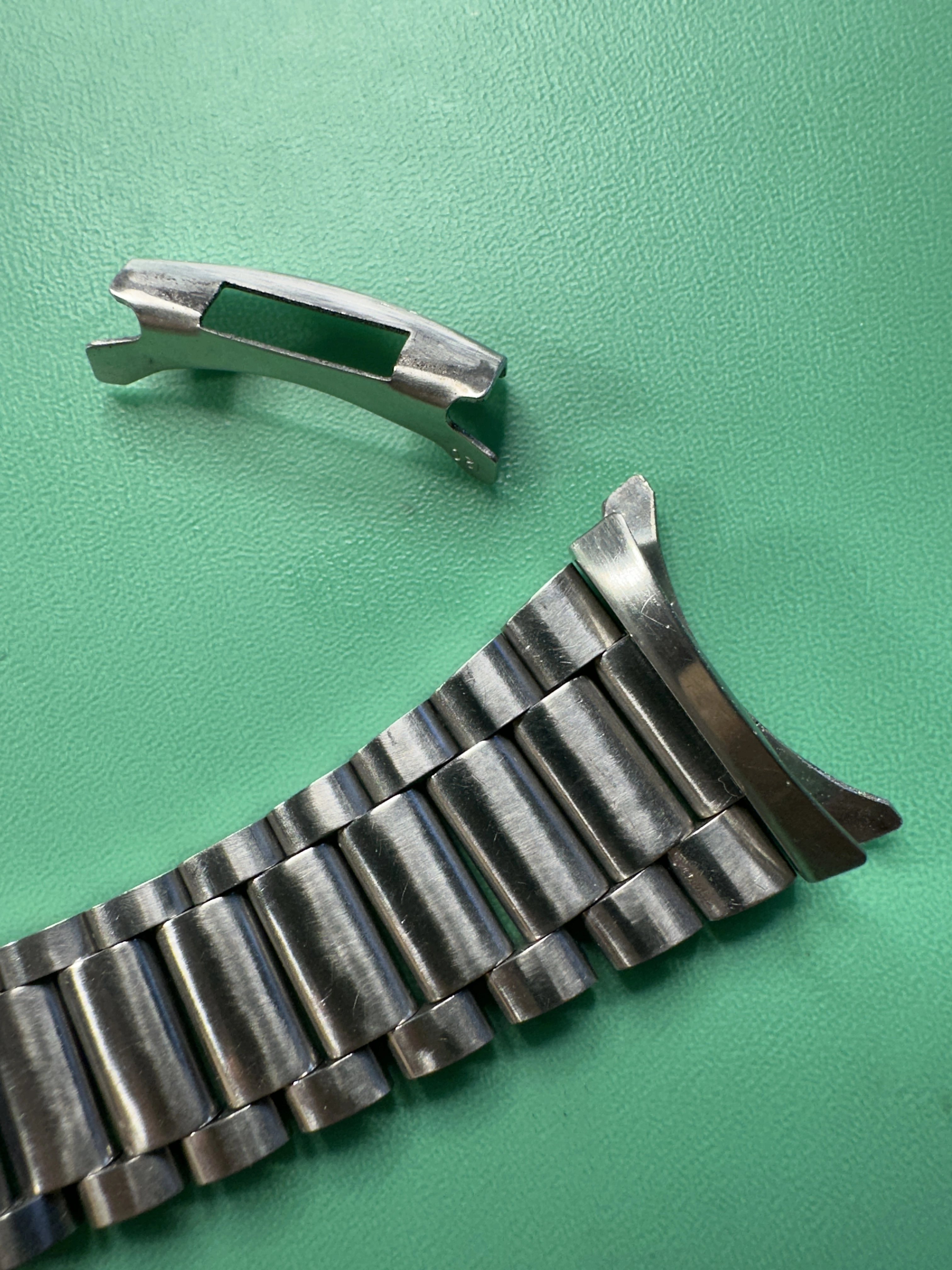

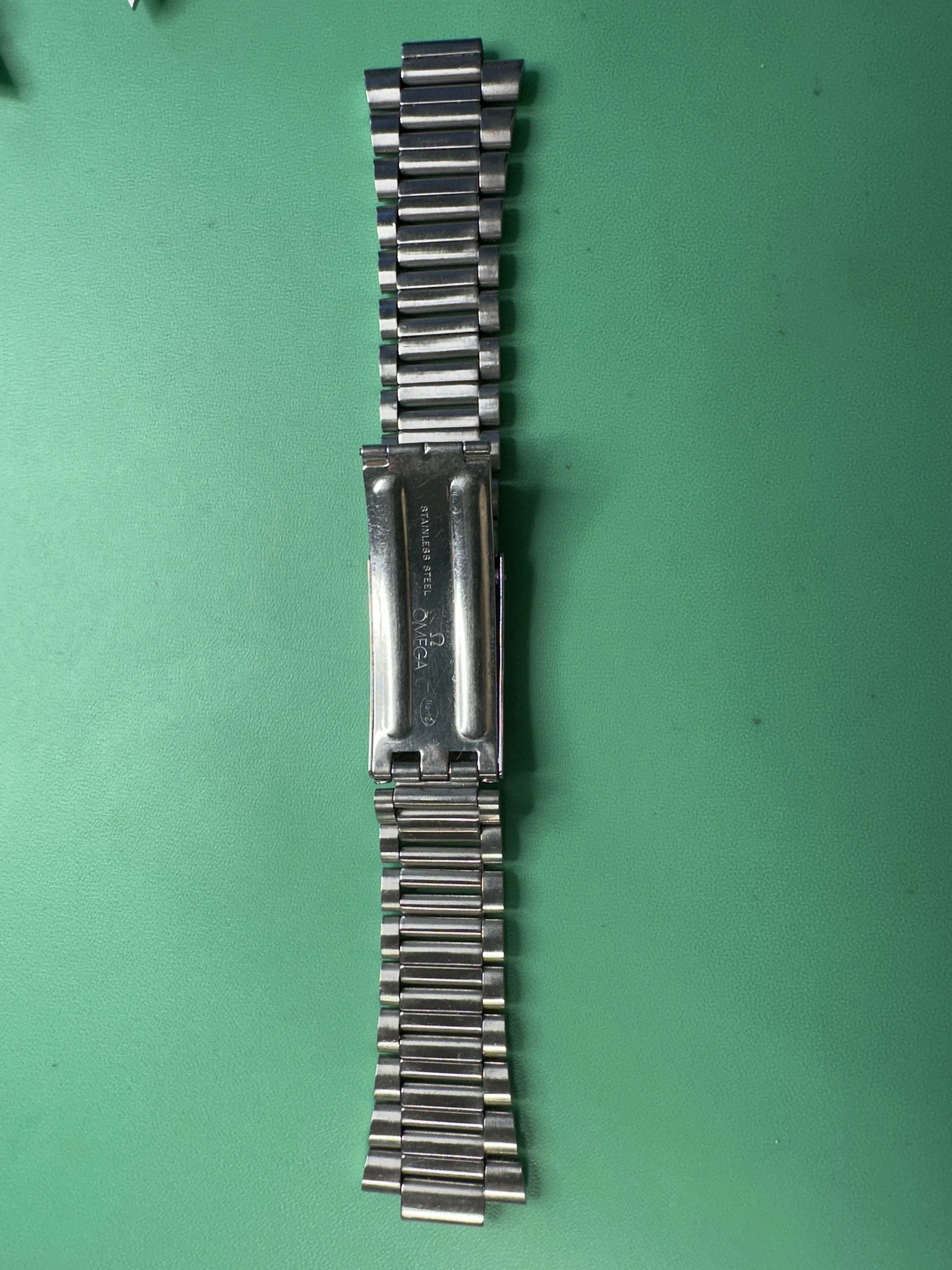

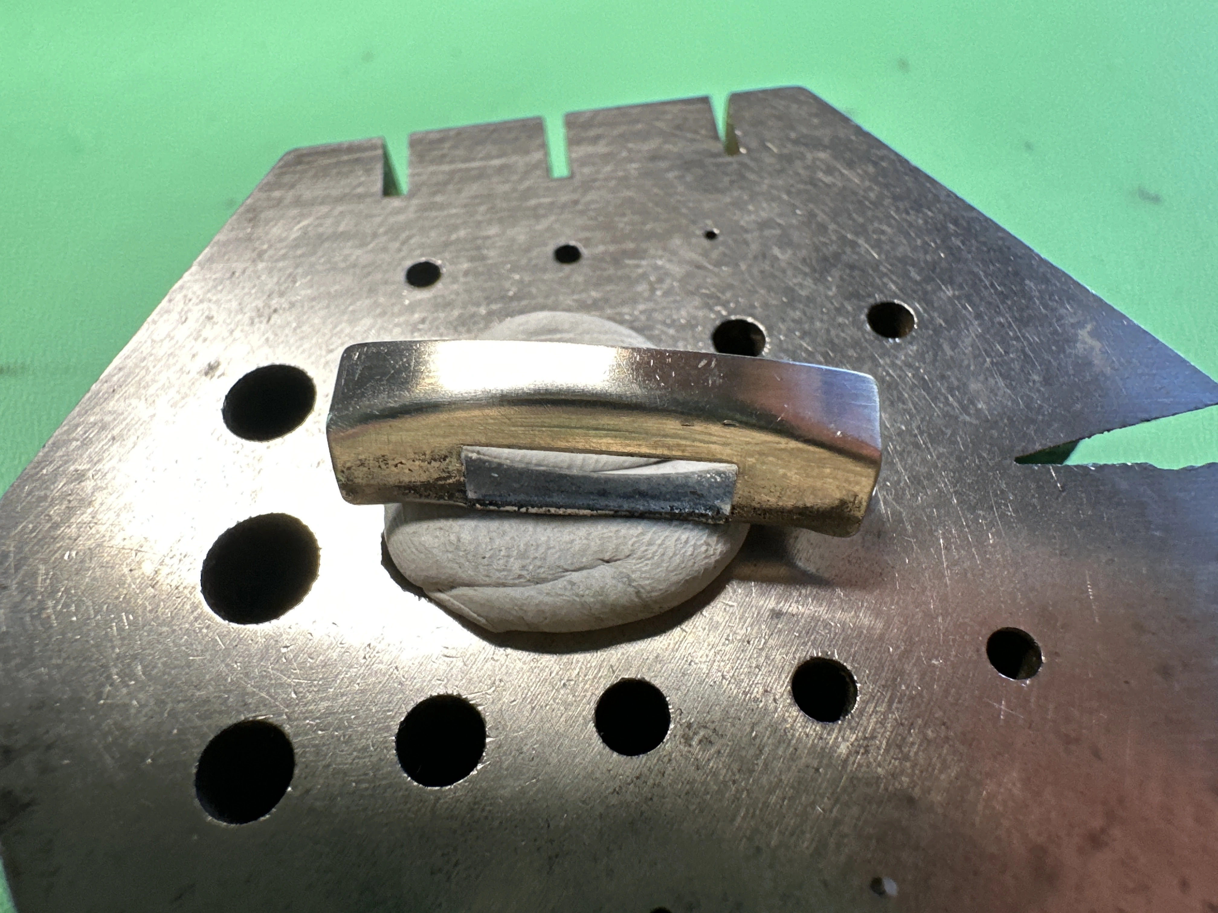

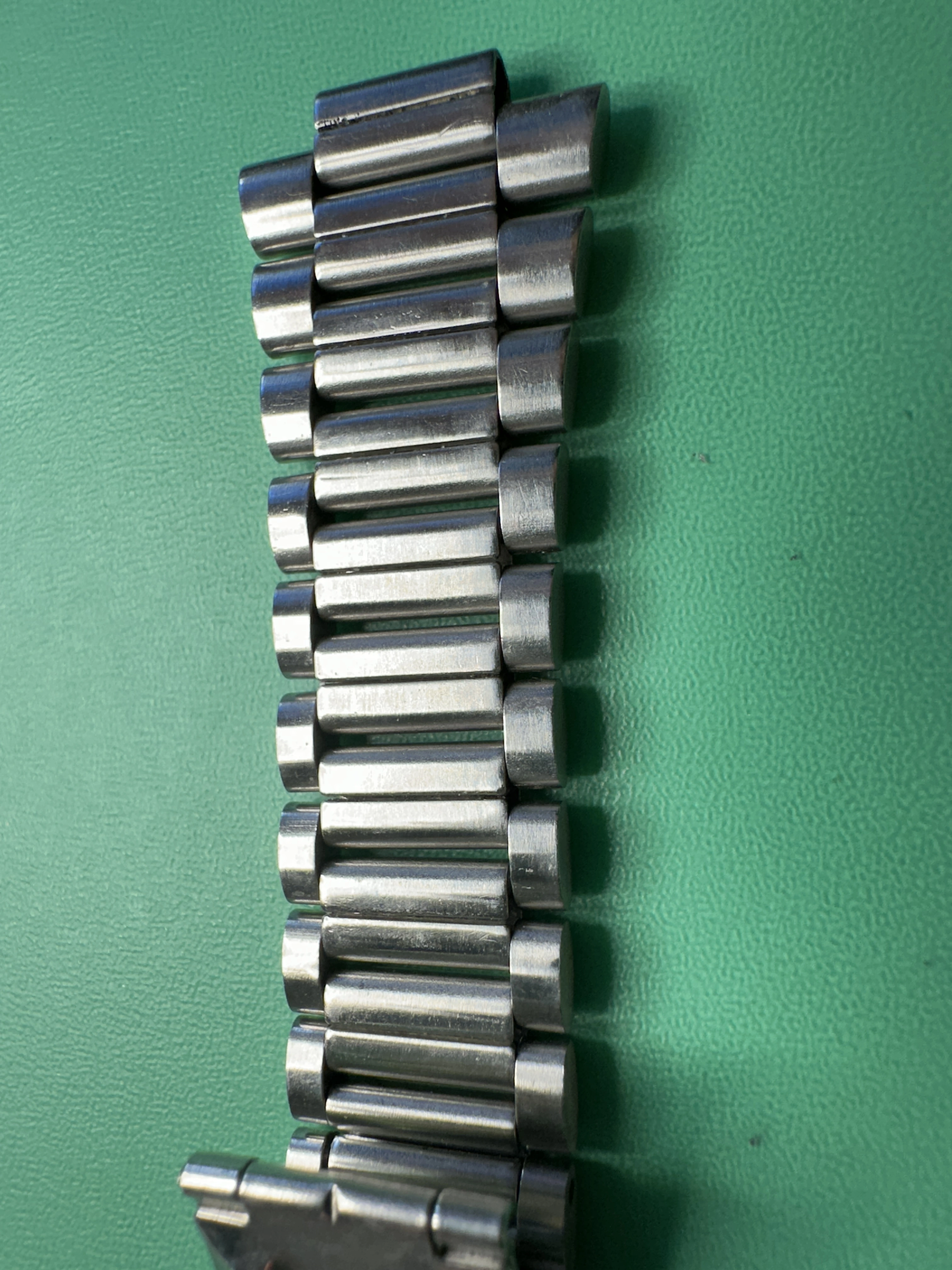

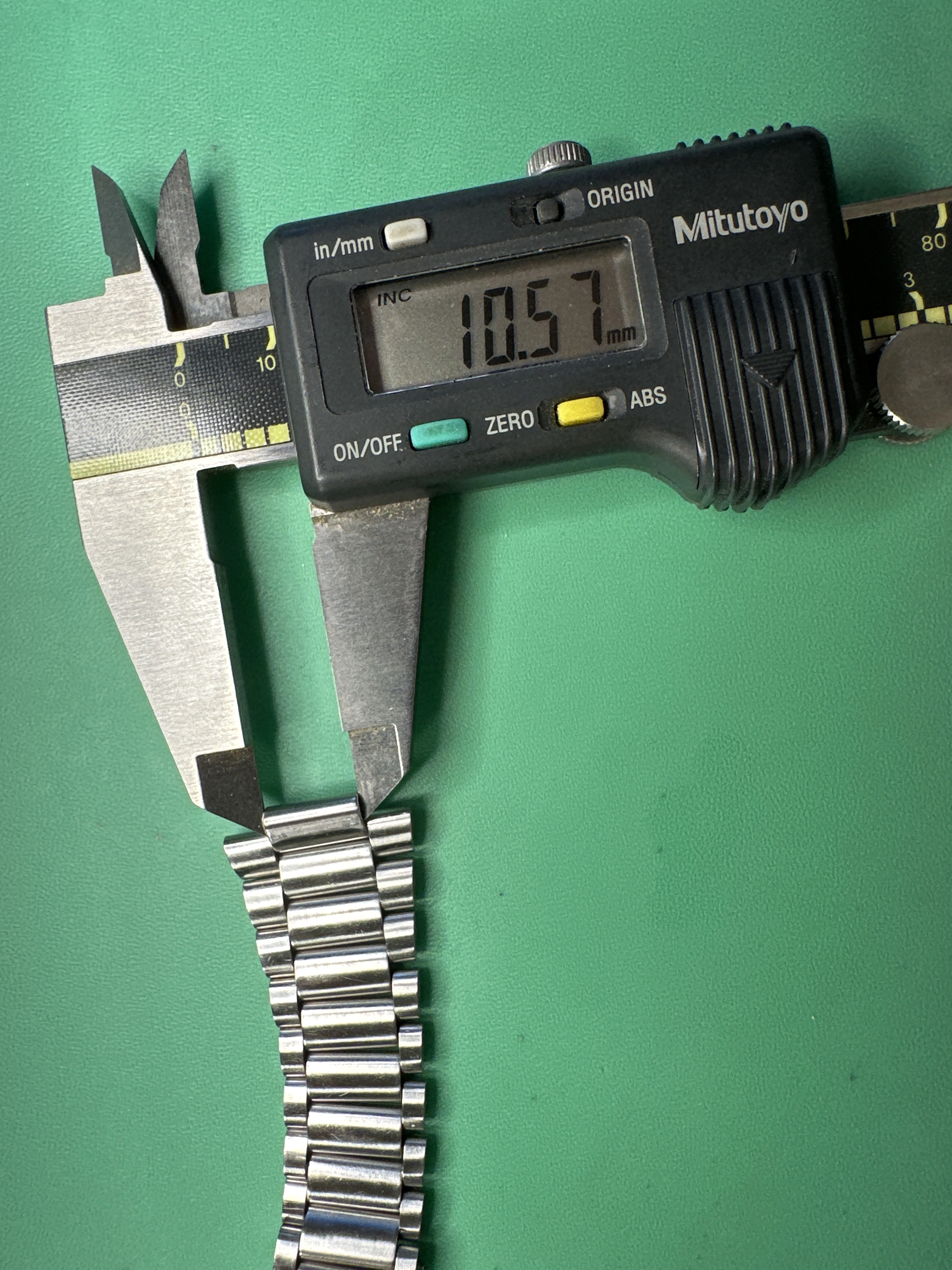

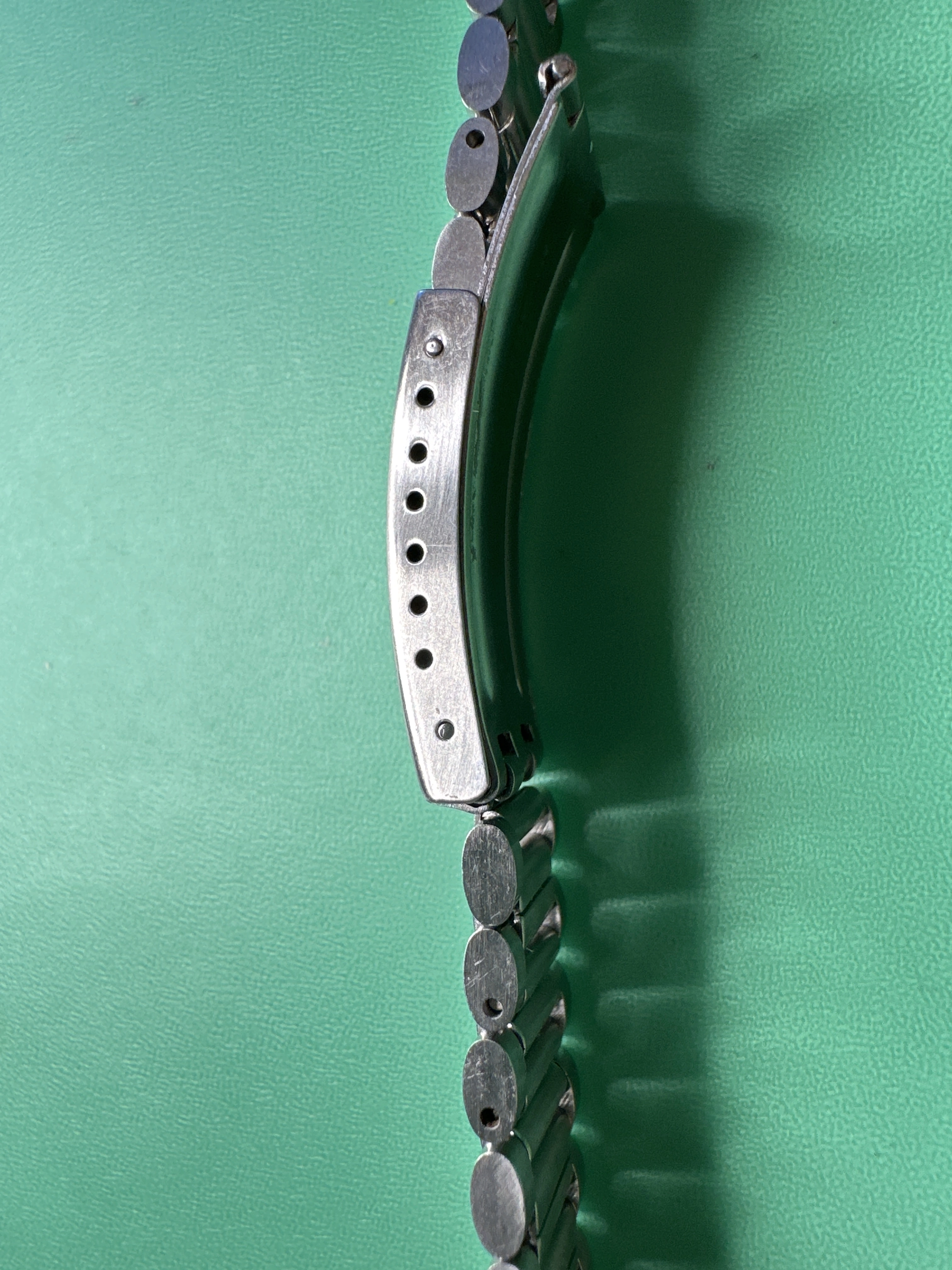

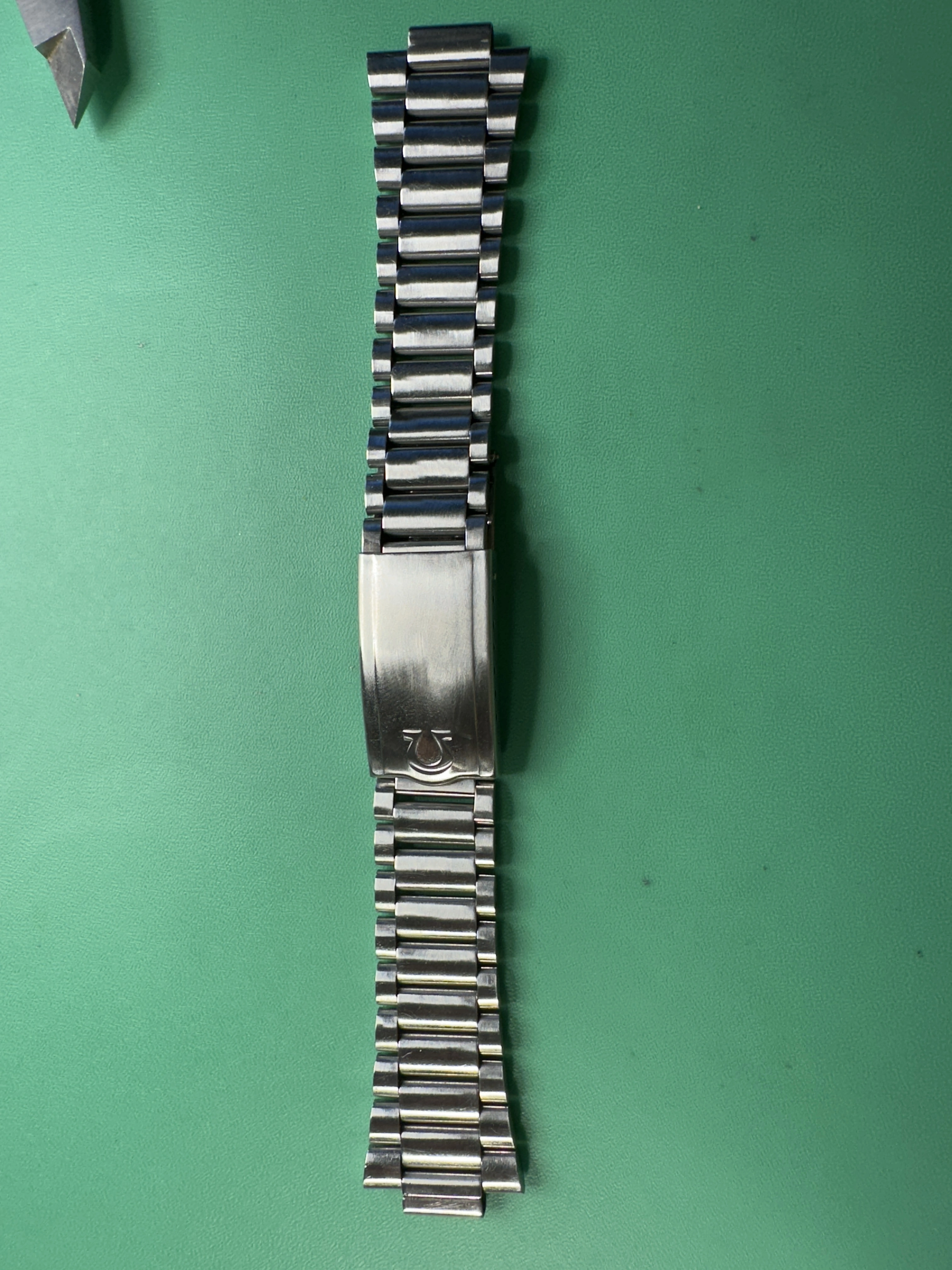

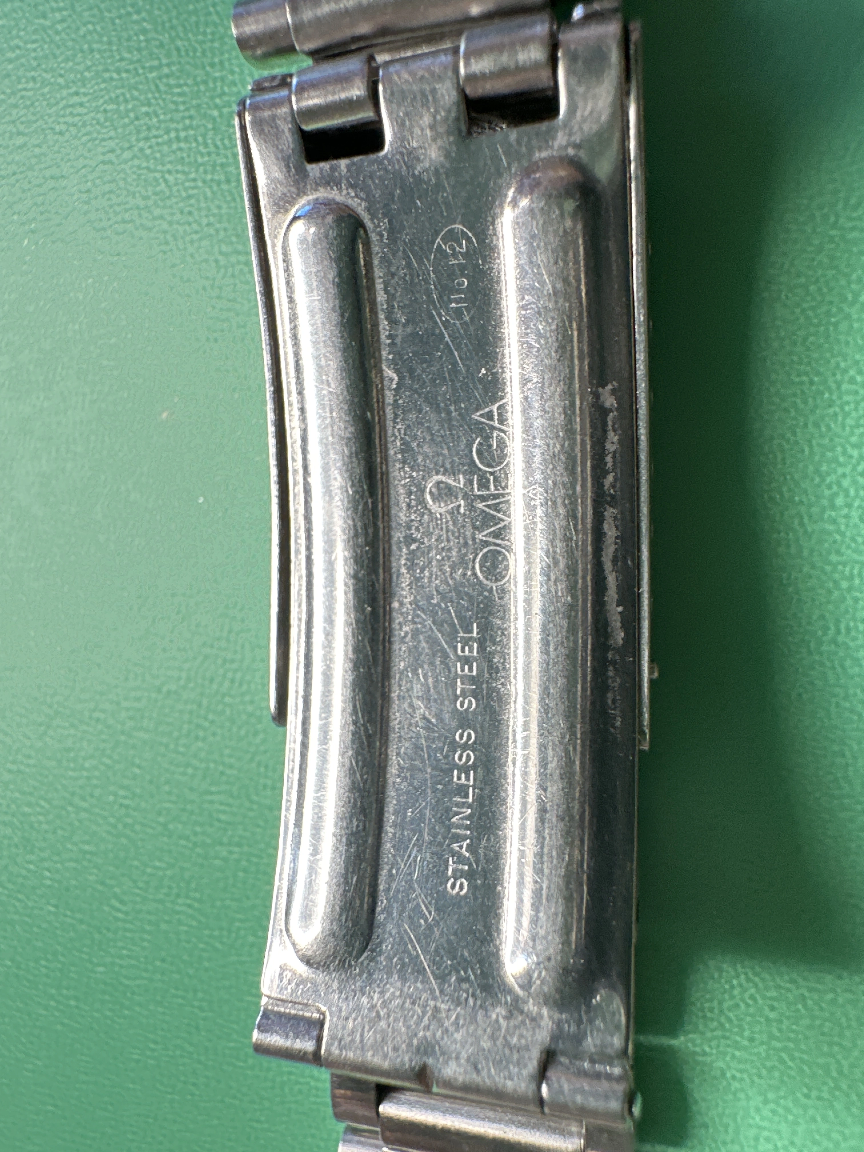

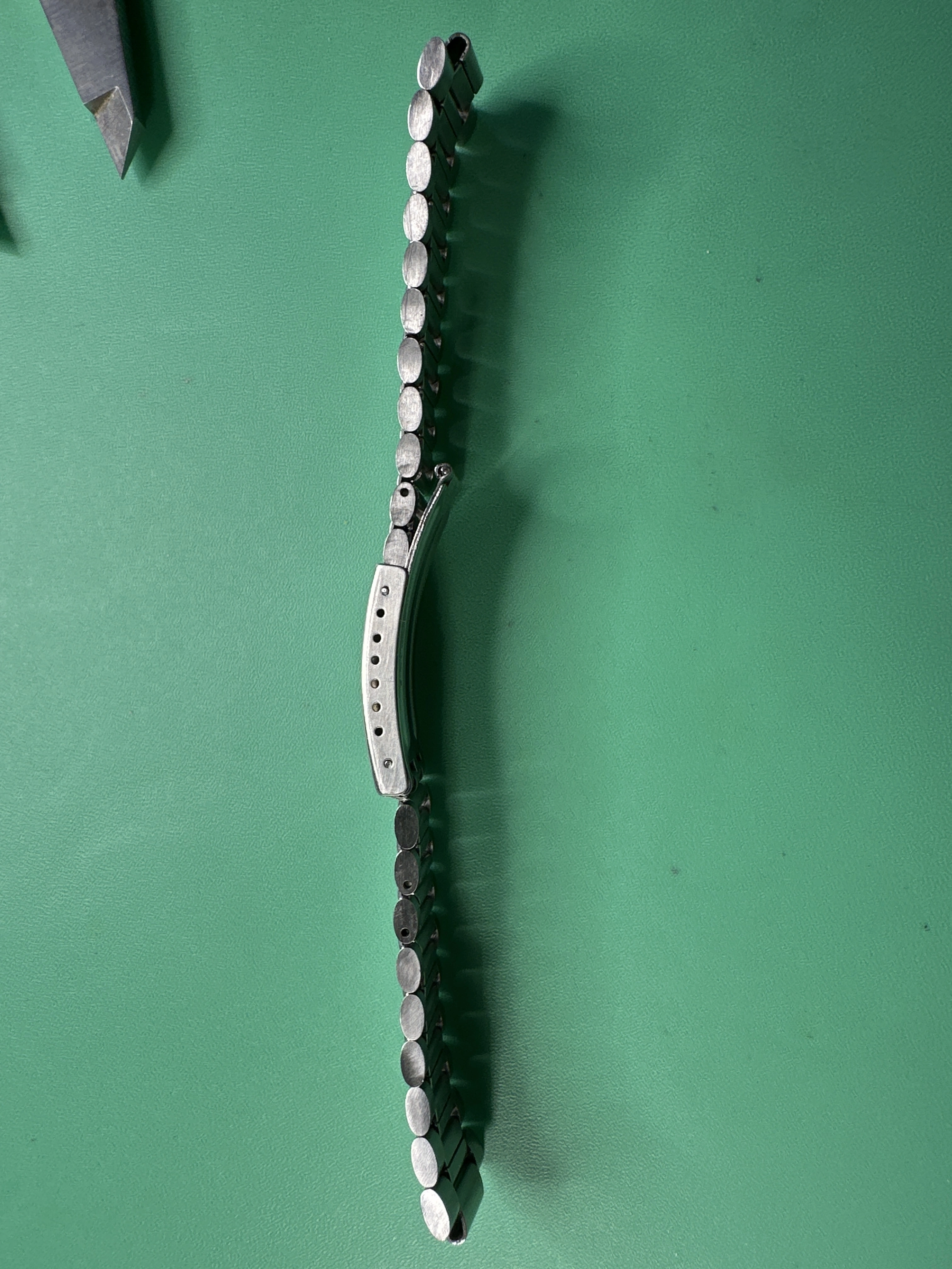

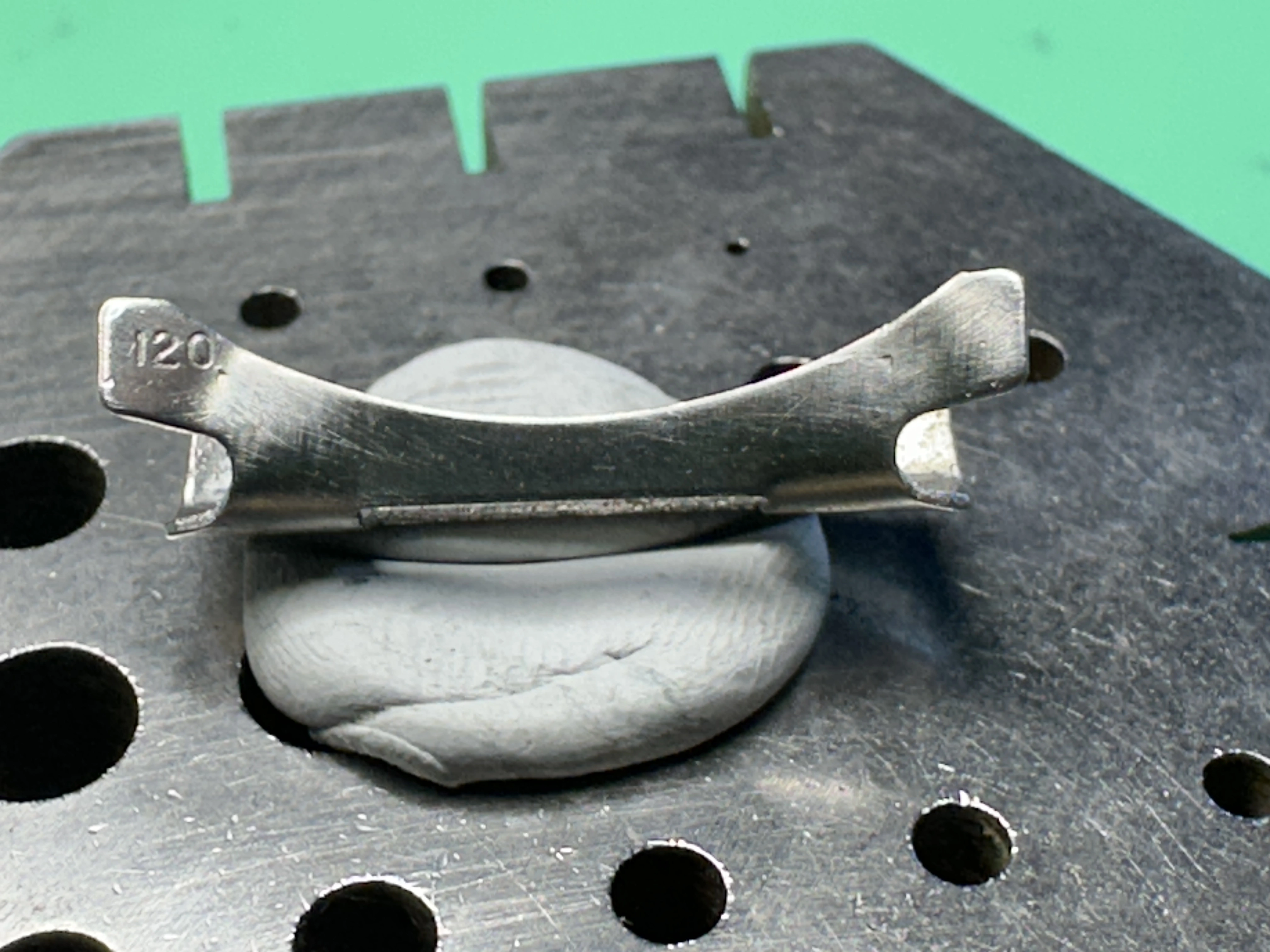

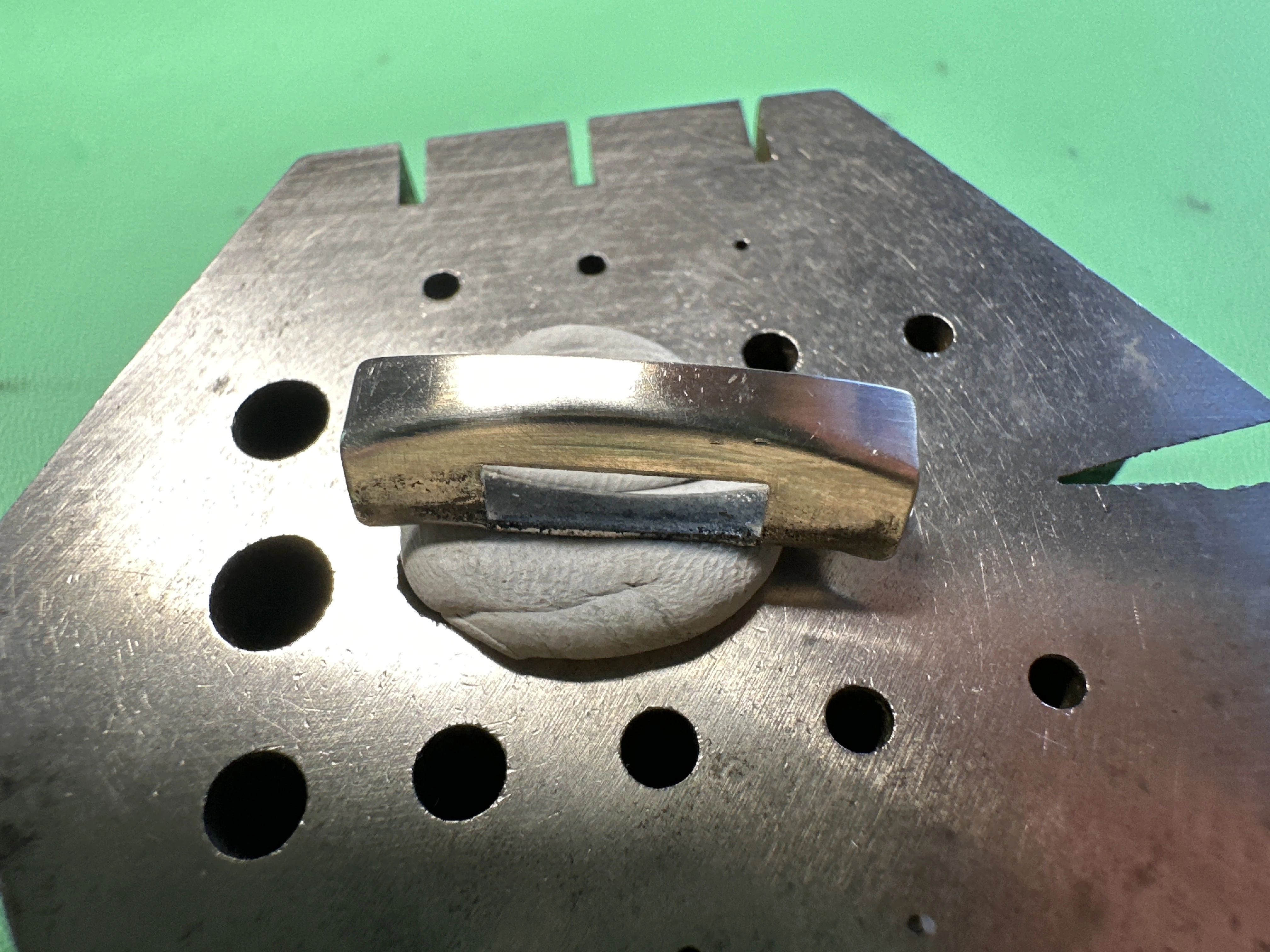

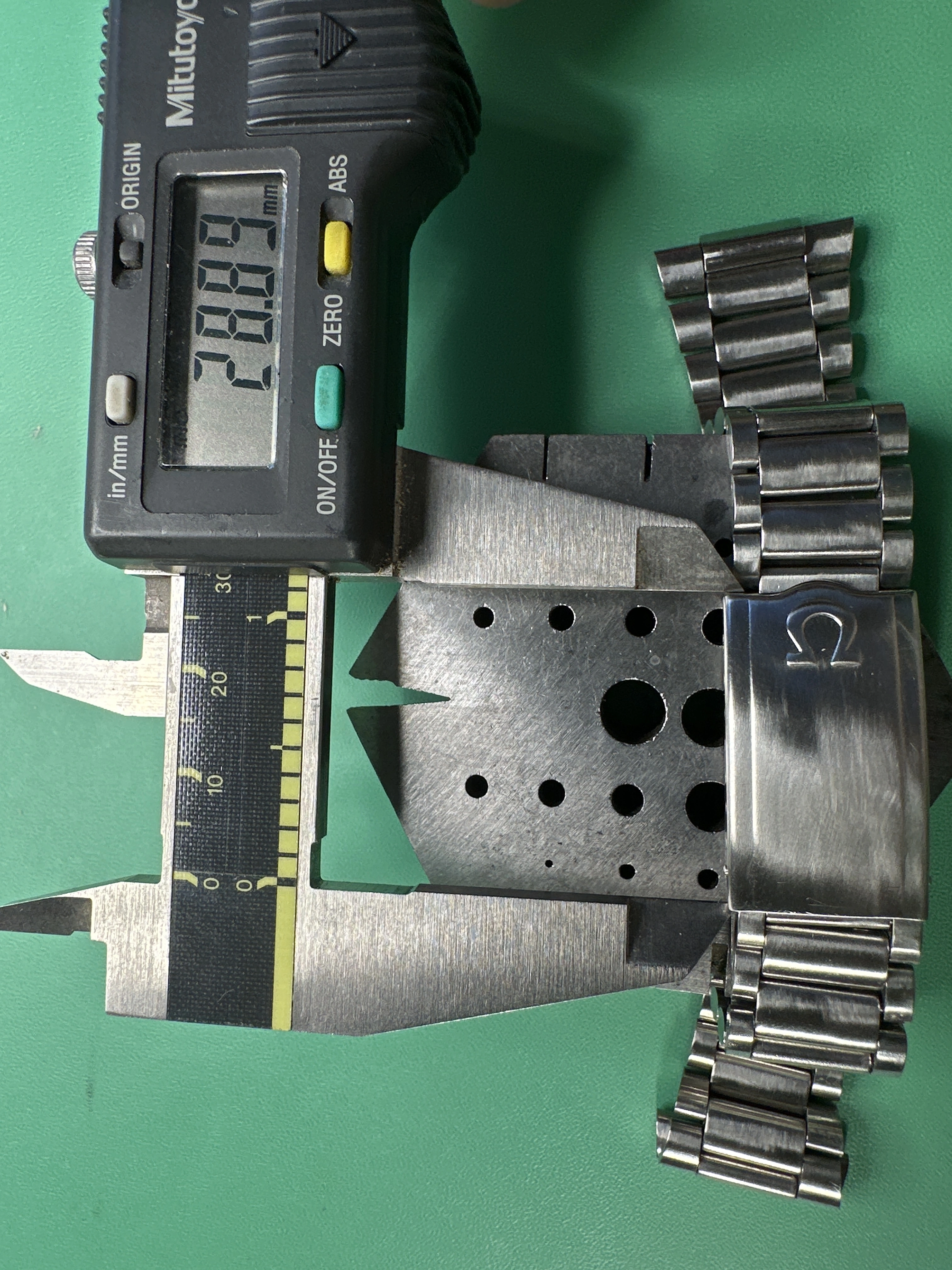

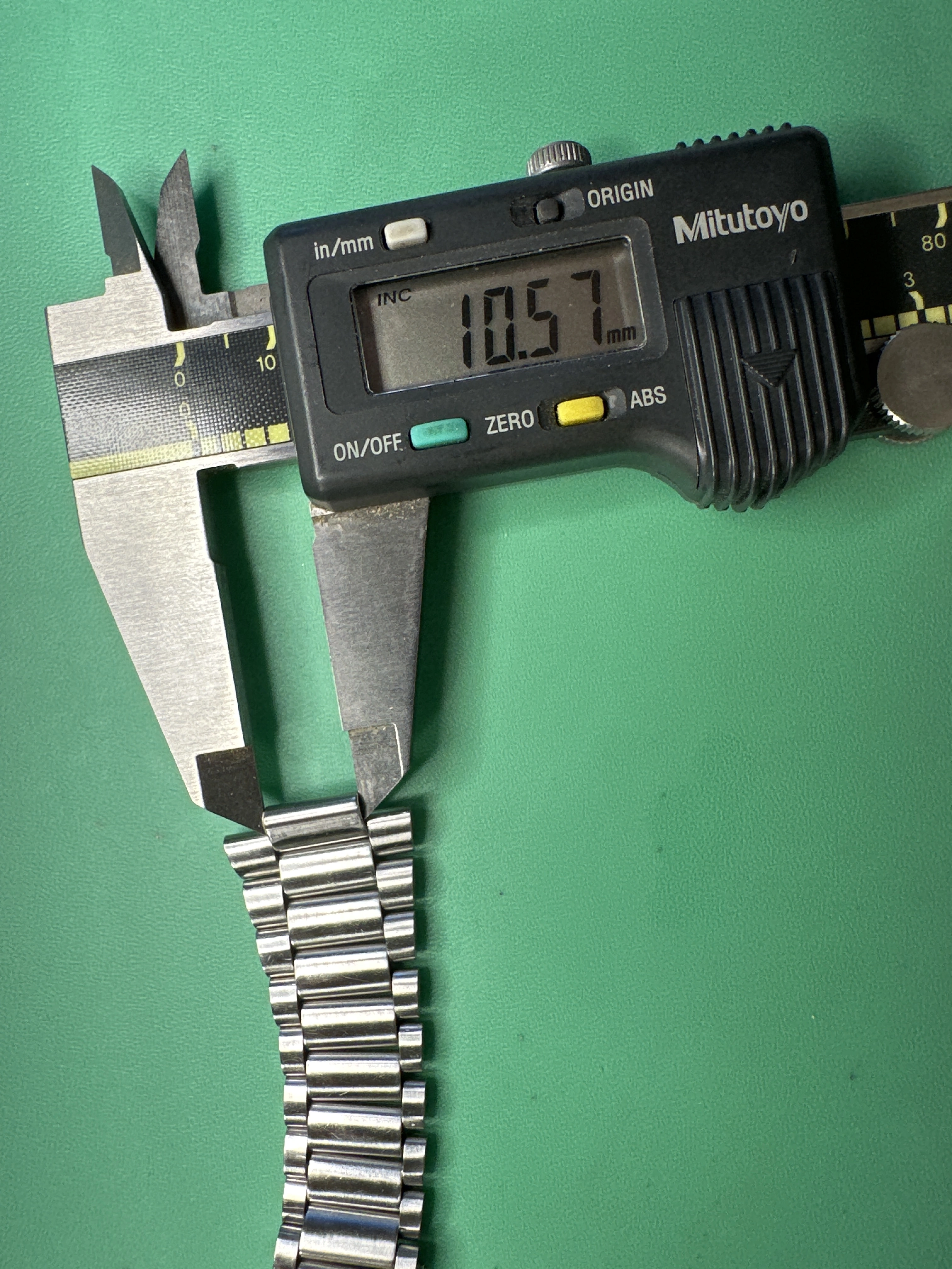

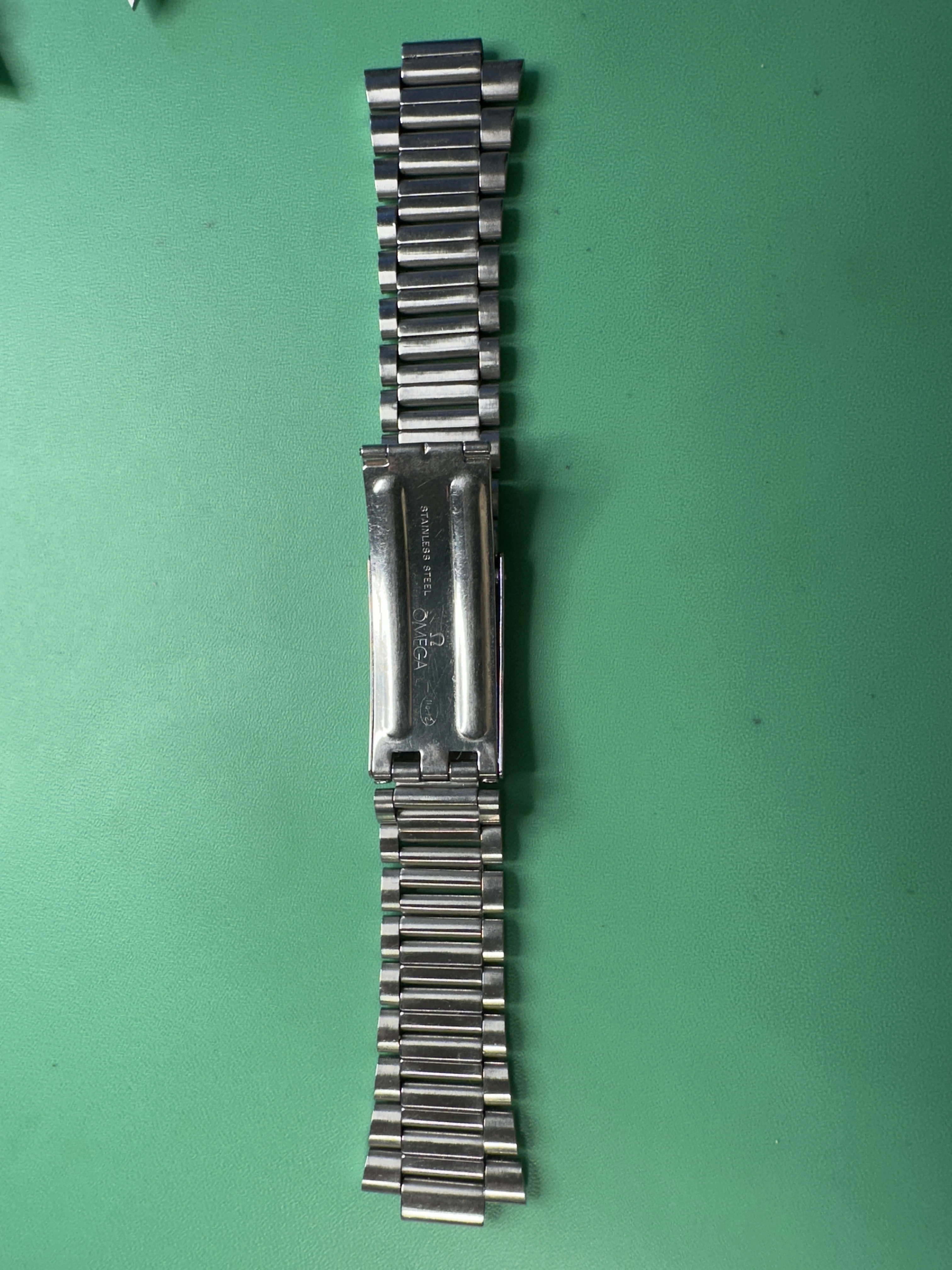

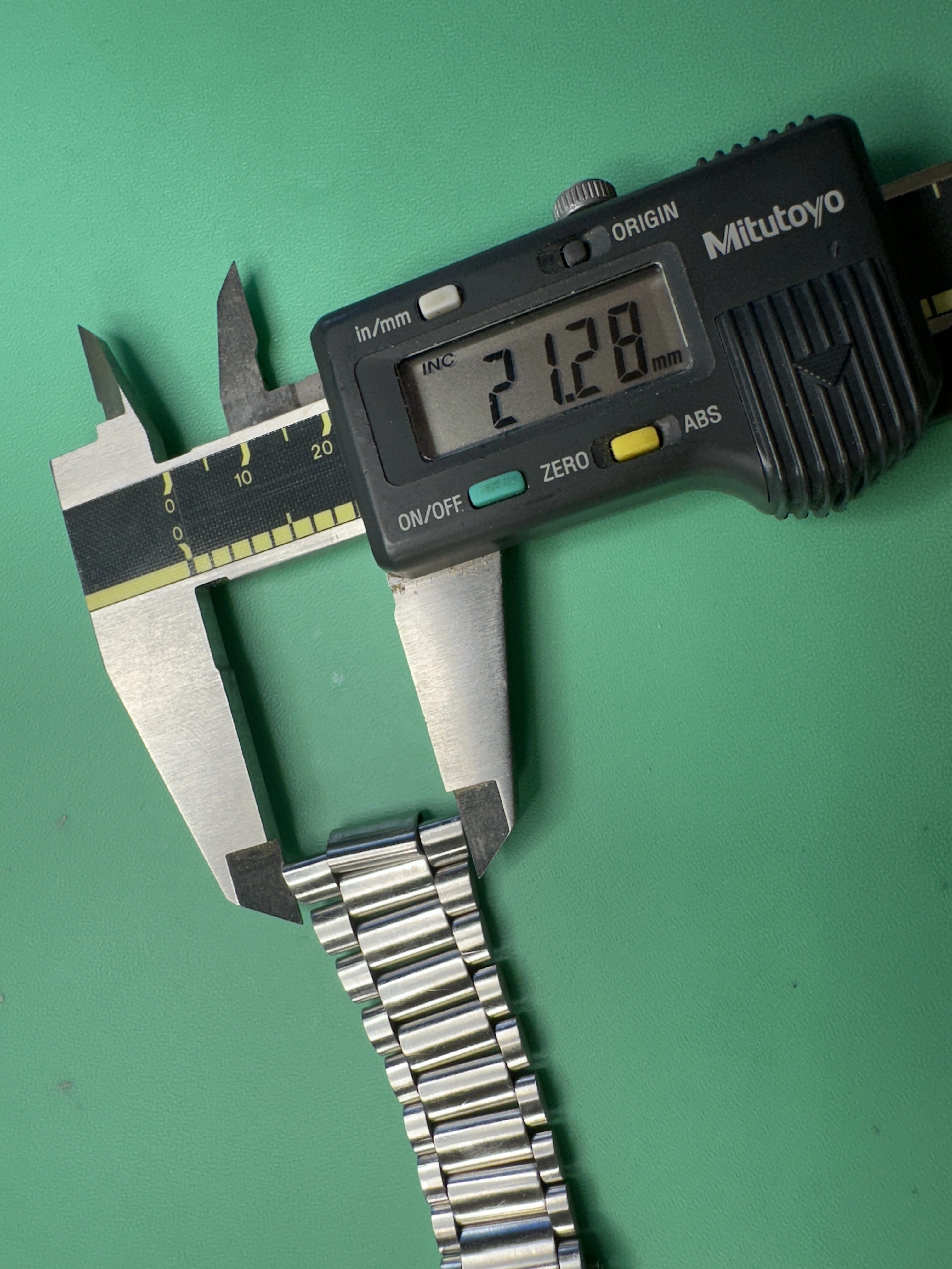

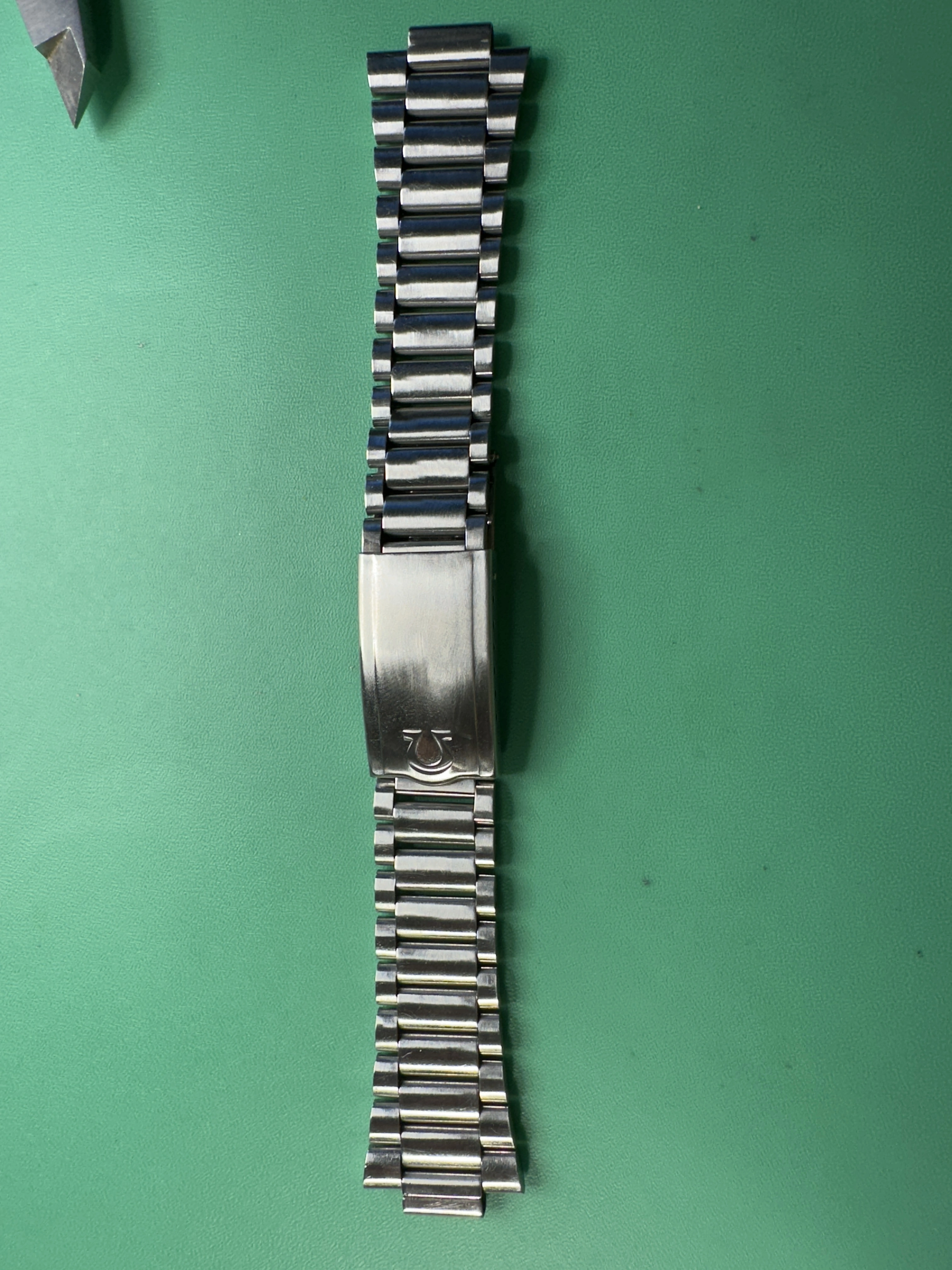

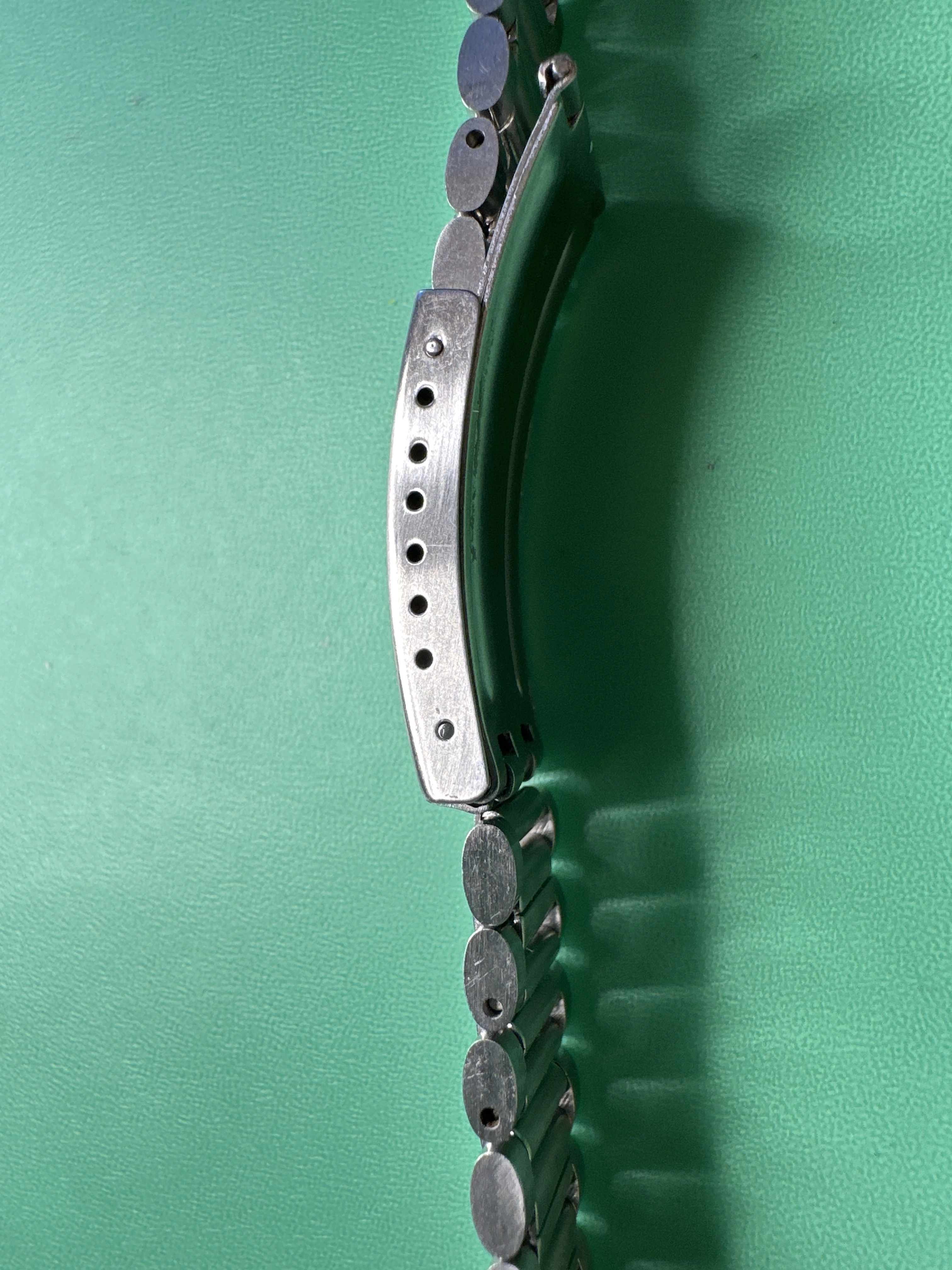

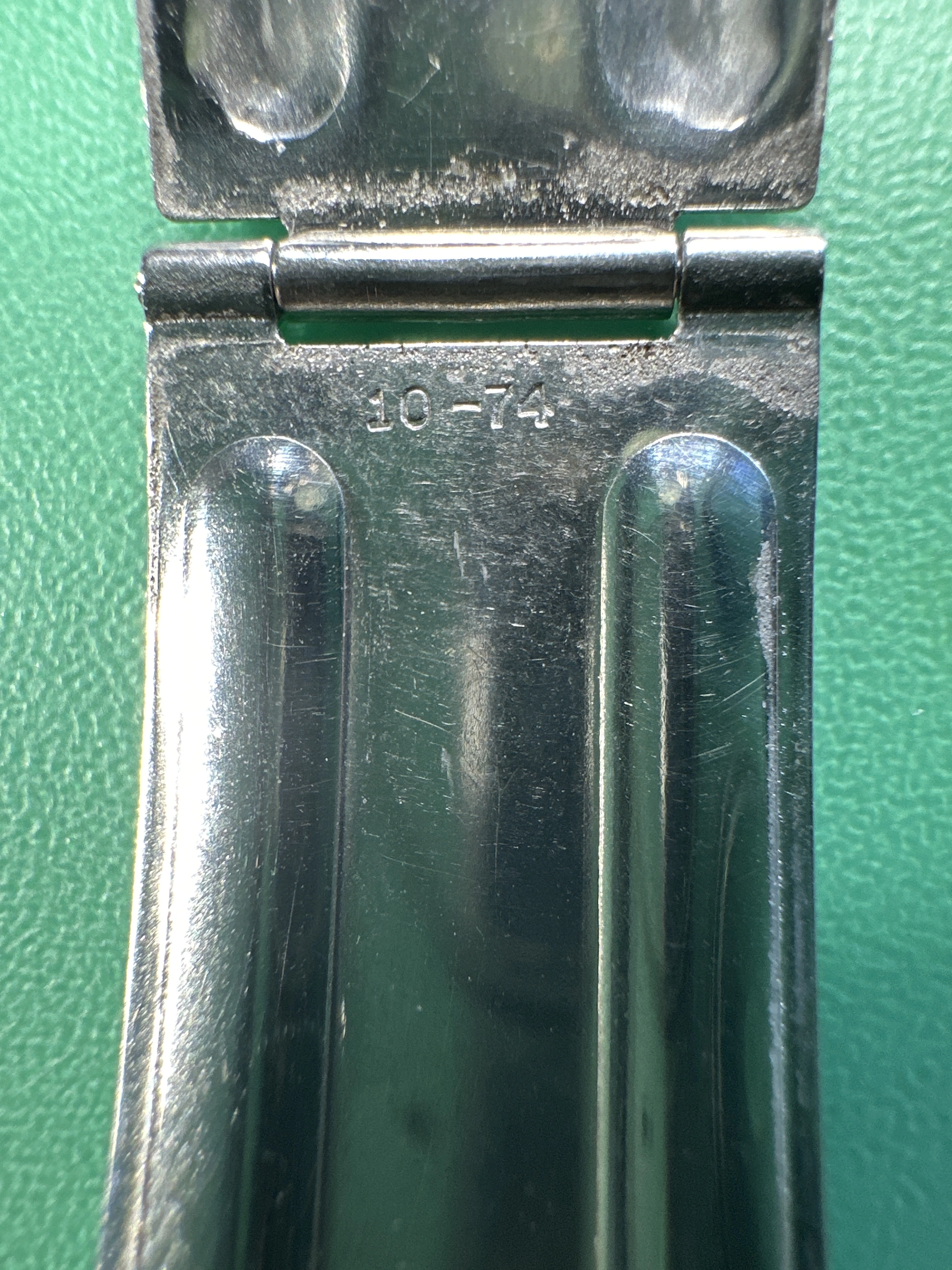

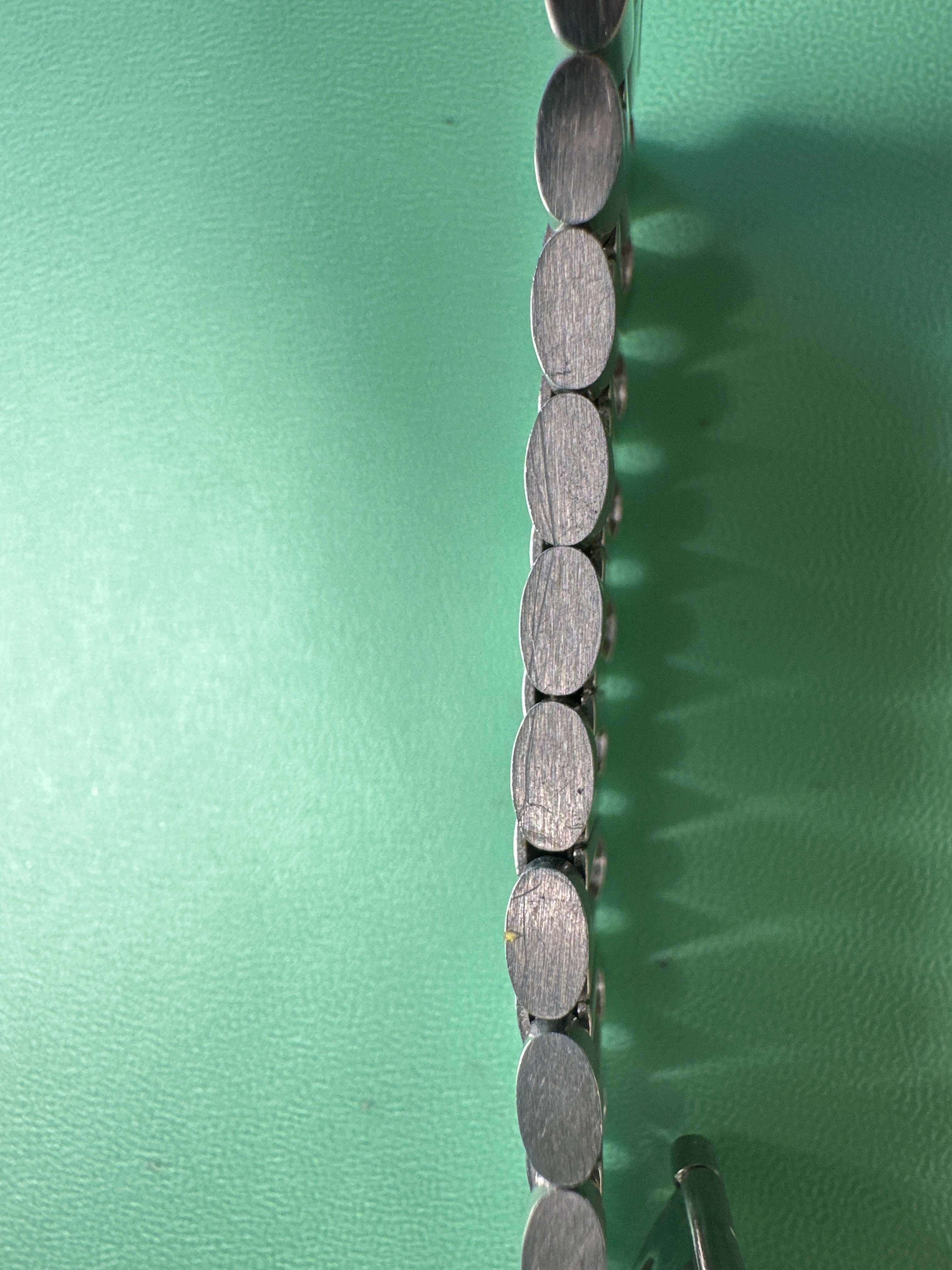

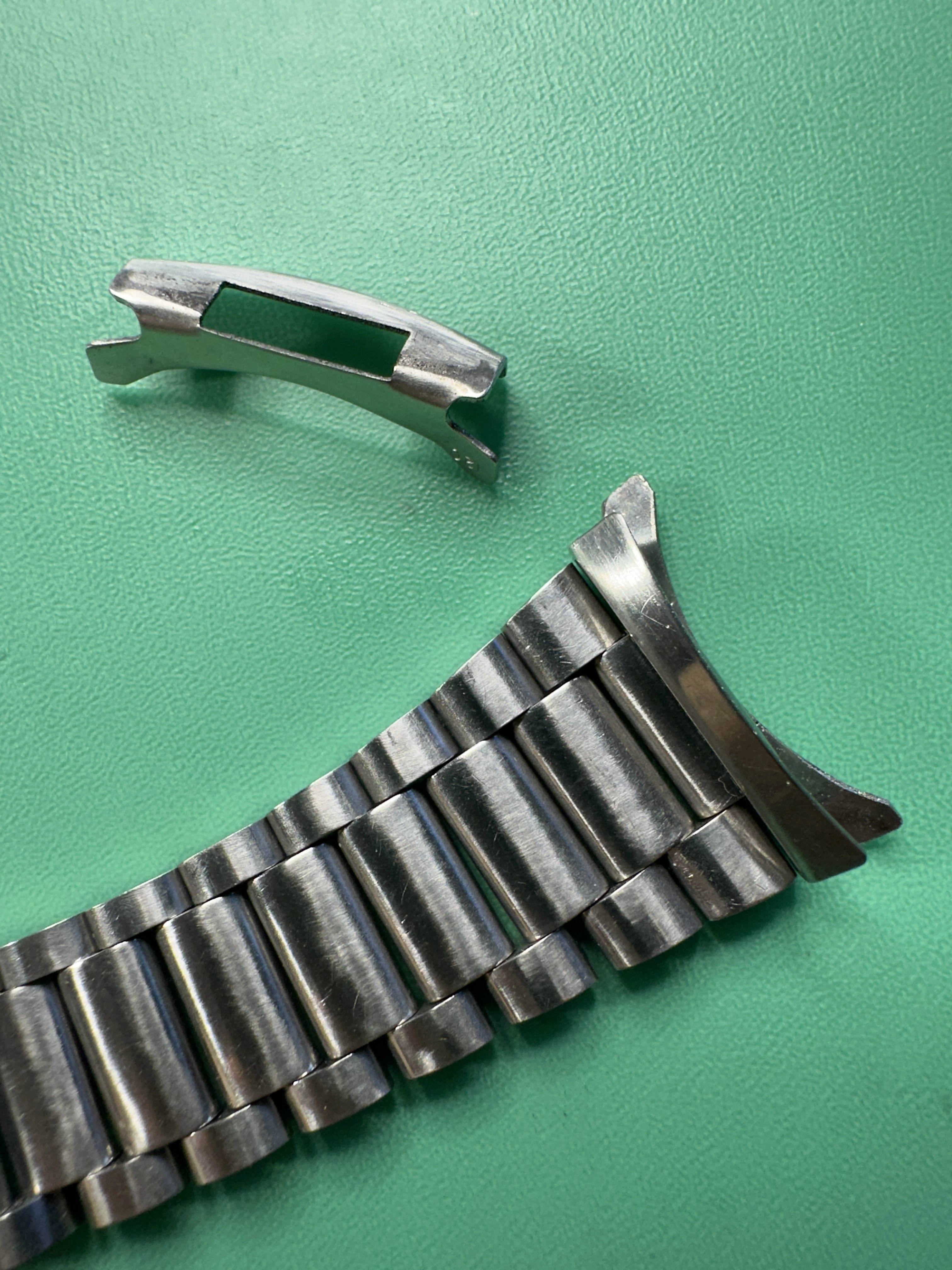

I have another mystery bracelet. This one is a 22mm model that arrived on a Seamaster 176.007. It looks like an 1170, but has an unmarked clasp and based on the discussion above I think the terminal link dimensions are wrong for an 1170. Also the expansion links on this bracelet have springbars in them where I believe the 1170 uses split pins. The kicker is the end links are 120's which fit the 176.007 pretty well and look right, but I cannot find any references to 120's anywhere. I would love to hear your thoughts on identifying this bracelet. My dilemma is I need another expansion link for this bracelet to be workable for me... but can't figure out what to shop for! Disclaimer: I'm totally new to Omega bracelet lore so forgive me if I got something wrong. Let me know if there are other views or measurements you would like to see.
35,748
40,033
The 120 end links are rather telling, normally a 1170 would have the 653 end links, but in this case I think it might be the much less common 1054 bracelet with 120 ends. There was a thread mentioning it here, and yours looks like the OP's watch in that:
Also:
1,126
1,731
This is a bracelet often observed in the US market. I had some, they are equivalent to 1170 and 1162 and can be Omega or JB champion

This bracelet indeed seems to match the descriptions of a 1054. Thank you both for the assist! I suspect finding an expansion link for this may be challenging since the bracelets seem to be unmarked. Wondering... could I possibly replace the clasp with a longer model? I really don't need much more room, just a tad so its not so tight.
