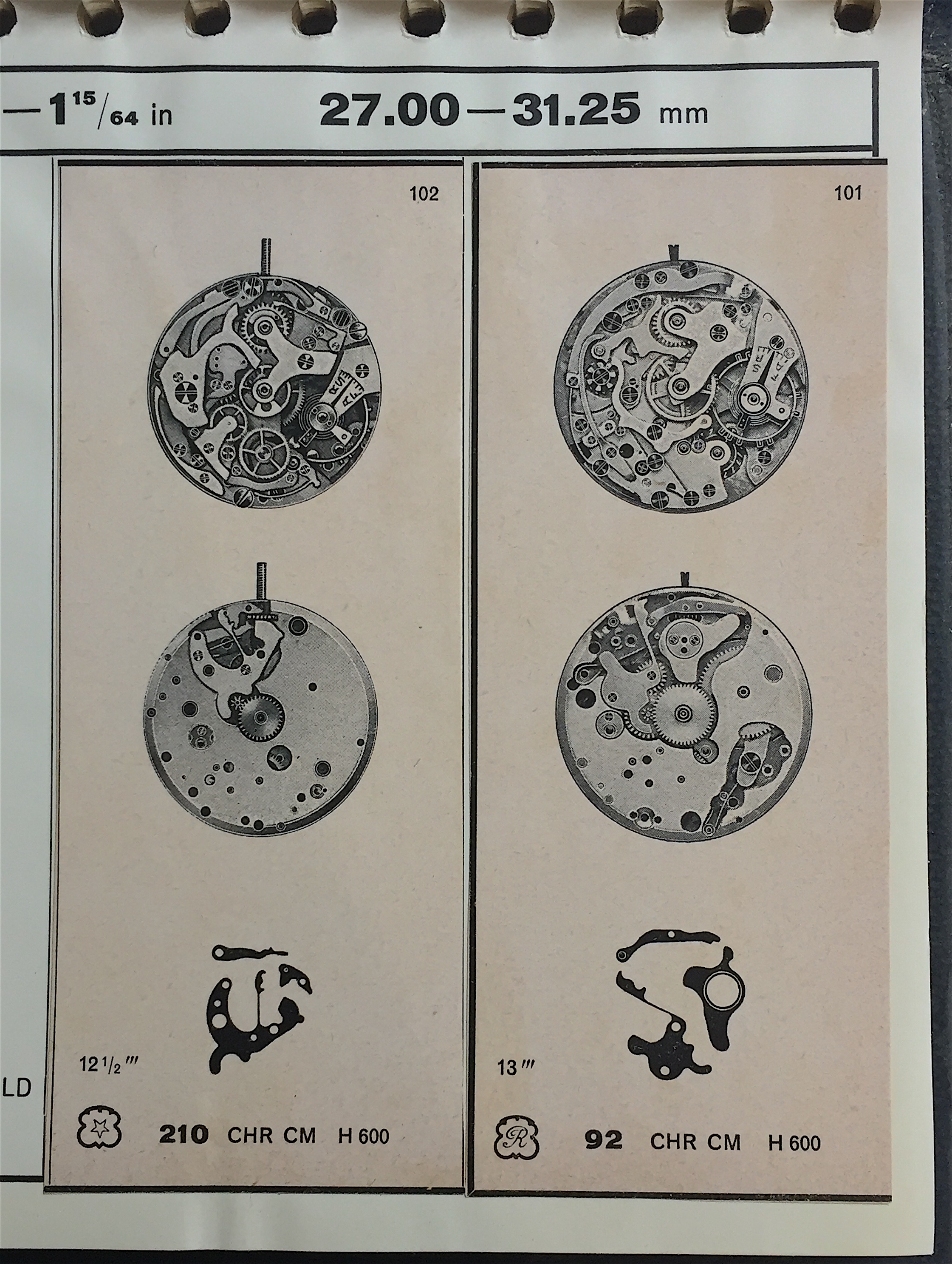

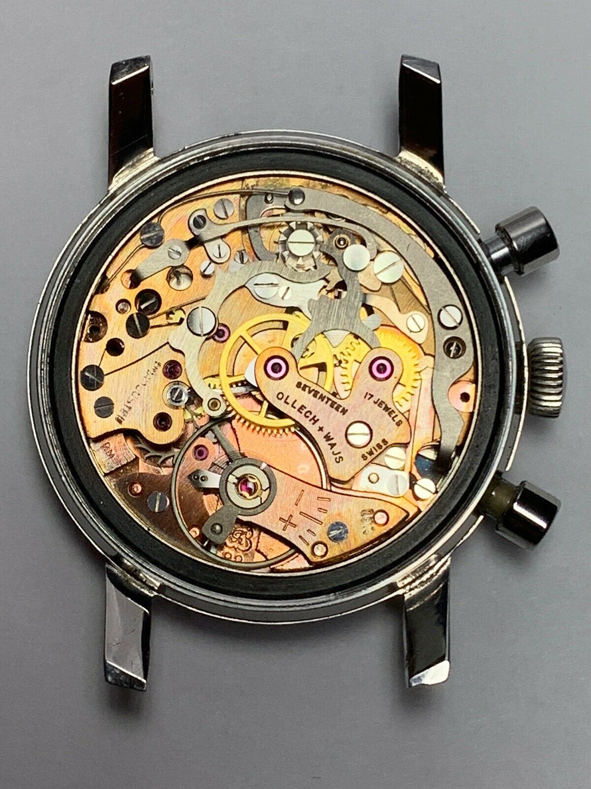

Valjoux? It's marked under the balance.
Ed: It's a Valjoux 92, 13'''.

Confirmation of Valjoux 92.
The Import code on the balance cock should be LBA for Ollech and Wajs, but I can't see it clearly
