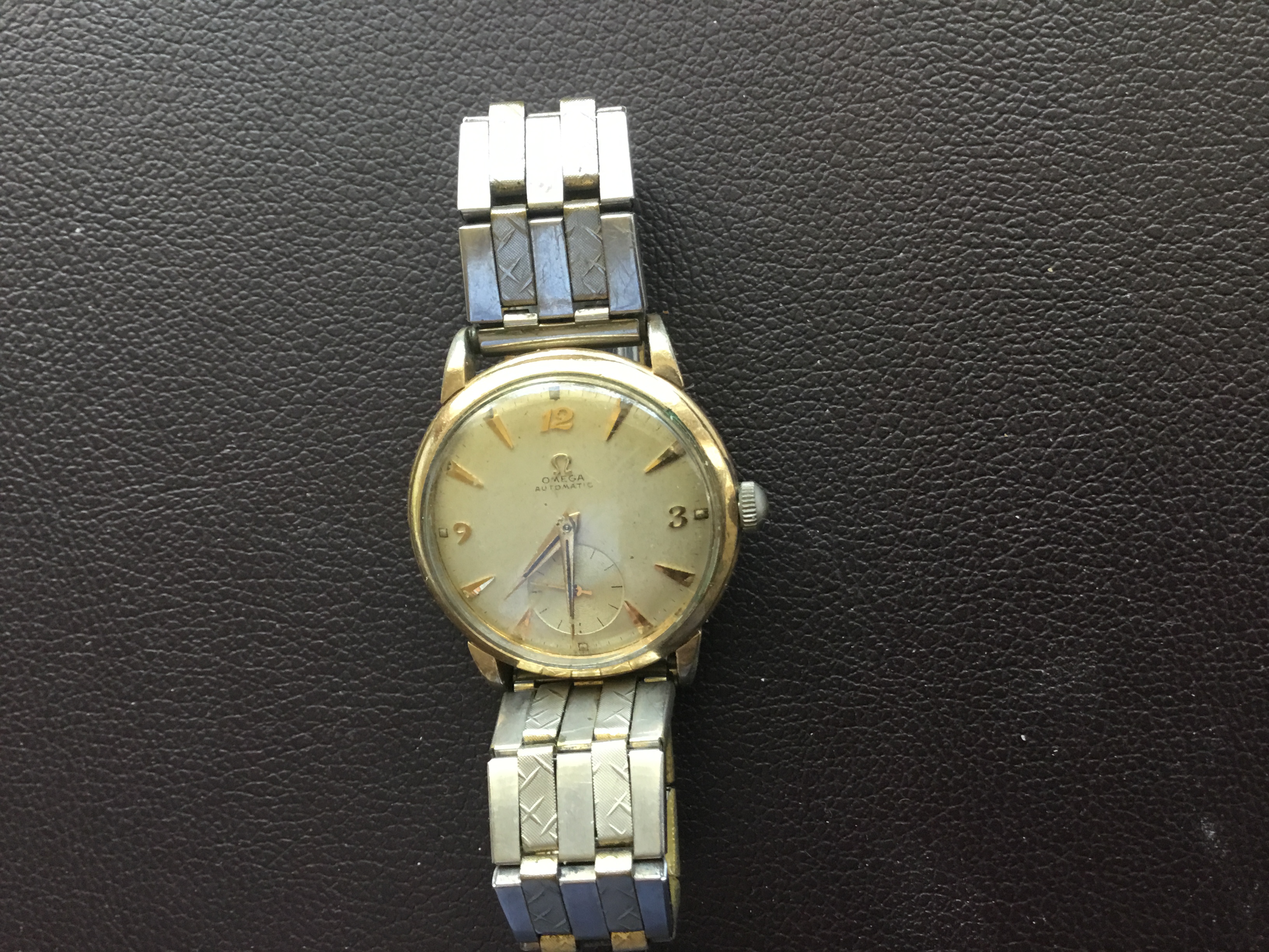

Hi everyone,
My Grandfather recently found his old Omega watch while cleaning out his office. My late Grandmother gave it to him on his wedding day in 1953...He hasn't worn it much, and said it needs to get serviced so I don't think it's working. He believes it's gold plated as well.
My question: Have you ever seen a bracelet like this? I can't find any photos of Omega watches with this bracelet, and since we're sheltering in place it's hard for him to send good photos/I can't go see it in person. Not sure if it's the original bracelet so that's why I'm here. Any help identifying the caliber and bracelet would be greatly appreciated!
Based on my research I know it's likely a bumper cal 344, but that's all I can find for now.
I'd like to get it serviced no matter the cost because it's a great family piece, so hopefully I can see it in person soon. I've asked for more photos but this is all I have for now.

Nice watch, a pre-Seamaster Seamaster in all likelyhood. Crown's gold might be worn off. Bracelet is almost assuredly aftermarket but no reason to not keep it if you like it.
Information is found inside the caseback with a case (or reference) number and the serial number can be roughly correlated to date. The movement number is also useful information.
If you can find a local watchmaker to take the back off, you can take pictures of inside of caseback and movement to share with the group.

Thanks! Once I can pick it up from him I plan to take it in to get checked out and so I can take photos of the interior. I was guessing the bracelet was after market but he said he didn't wear it much so maybe my grandmother purchased it with a different bracelet at the time.

STRONGLY advise you to find a competent local watchmaker who specializes in vintage watches.
Your average dude on the street corner who changes watch-batteries for a living might just as easily mess it up as improve anything. If you care to tell us your general location, we might be able to offer some suggestions. In addition to any repairs it's going to need a "general servicing" meaning, lubrication, cleaning and refurbishment of seals.
One option I'd recommend against would be sending it directly to Omega. They'll be happy enough to fix it but will also change original parts willy-nilly and it may come back unrecognizable.

Looks like a US cased watch, possibly a 342 or 344 inside.
I don’t think there’s anything ‘Seamaster’ about this watch. This model didn’t have a model name and I don’t recall ever seeing one branded as a Seamaster.
If you do a search, you will see examples of ads that identify a watch as Seamaster when it is unlabeled. I once thought as you did....

That was common for 2577/2576 or similar references, but I don’t recall seeing that for this reference.
I agree - I've been researching places here in the bay area. If anyone has suggestions I'd welcome them. I don't want it polished and would like to keep it as original as possible.
What he said. Also, as @Bumper says it looks a lot like a US production case. Snapback and gold filled is my guess 😀
