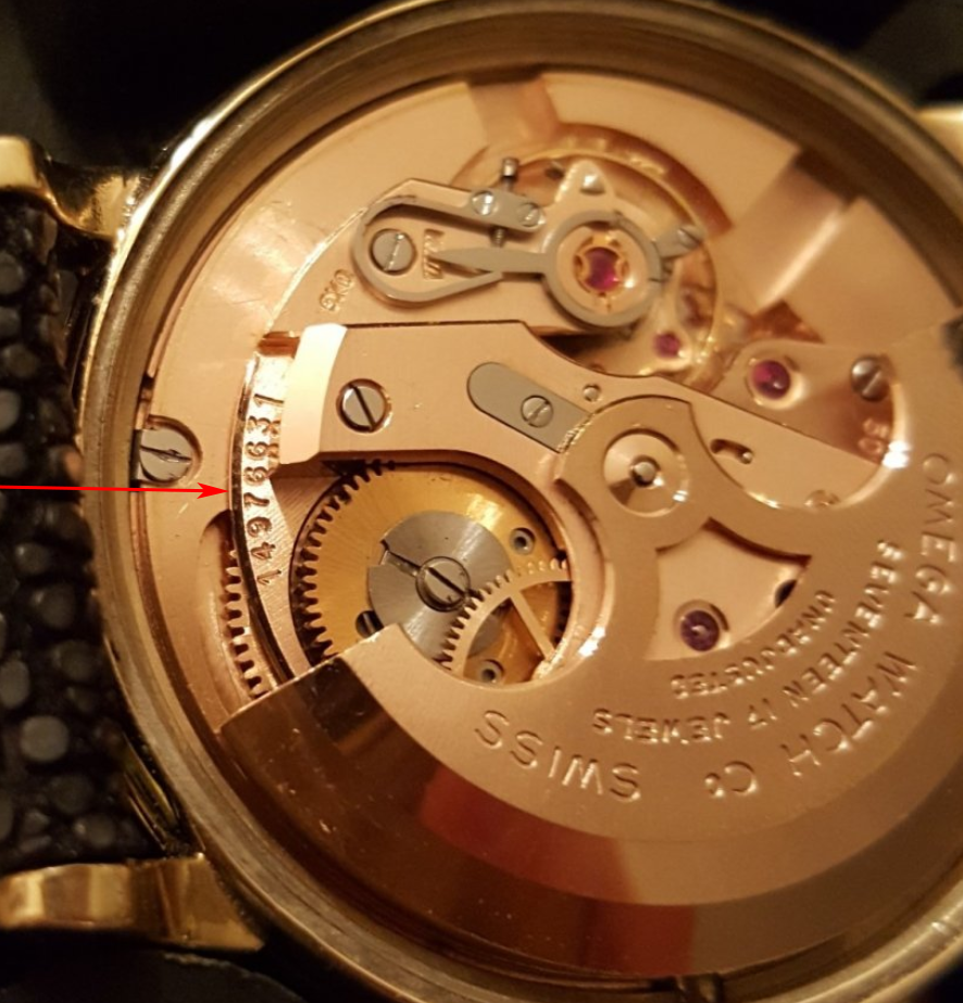

Ok! Managed to get the back off without destroying anything!
Model is a GX 6558
Other stamped marking is E21663
Movement is a caliber 500
Still not sure of exact year... didn't want to take it apart any further... where is the serial number on the movement? Or is there another way to verify?
13,492
31,811
Turn the rotor 180 deg and snap another shot.
