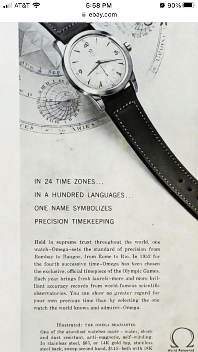

PS - Here is the same watch. Only difference is that I think this ad is older than 1952.

AJTT has three ads relating to the Helsinki Olympics, only one of them points to an "Olympic Edition" watch though.
The other two are just generic advertising.
