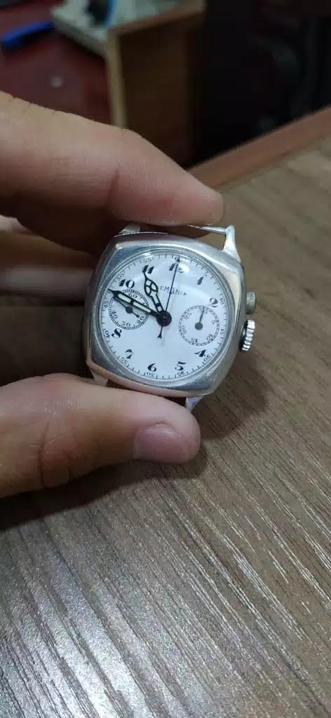

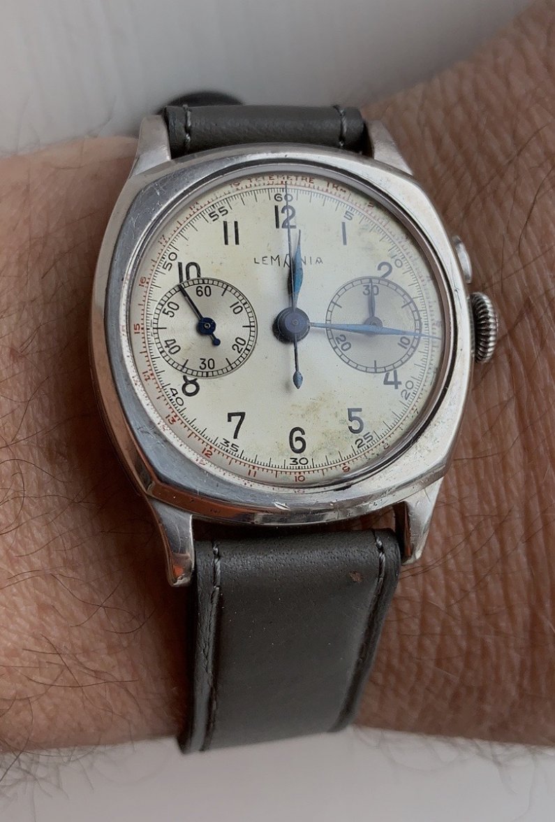

There are 2 chronographs. they are similar but different. why? military chronograph and civil?
A qualified guess would be that the top one was originally without lume (and has replaced hands) while the lower one had lumed indices and hands. Both look like they have been worked on, if nothing else then for removing lume on the lower one.

not so asked. Is it a military and civil chronograph? why were the numbers there with paint but not on the other?

I'm sorry?
I realise that you are communicating in a foreign language online, but please - when someone take their time to try and answer your question "not so asked" is not a very polite reply. Please consider this next time you write here.
But to answer your question: normally issued watches will be marked on the case back or elsewhere on the case; sometimes it will have a military designation written on the dial. I do not know of any issued Lemania chronograph without markings, so I will assume that these are civilian models. One probably had luminous paint on the numbers, which has been removed at some point.
Hope this helps 😀

thank you very much. Yes, you correctly said in a foreign language. I really wanted to offend, believe, I did not want. if it happened, please forgive! So if there is no marking, is it civil?
yes probably. Engravings might be on the caseback, or on the movement itself if it is military.

there could be tex on the back wall but there is nothing there. on the mechanism only the number and word Lemania

In that case it is most likely a civilian watch. In order to make a good case for it being issued, you would have to go the other way around - find out if any of this model were issued somewhere and what are the characteristics of that particular watch.
Very interesting watches, even without military background 😀

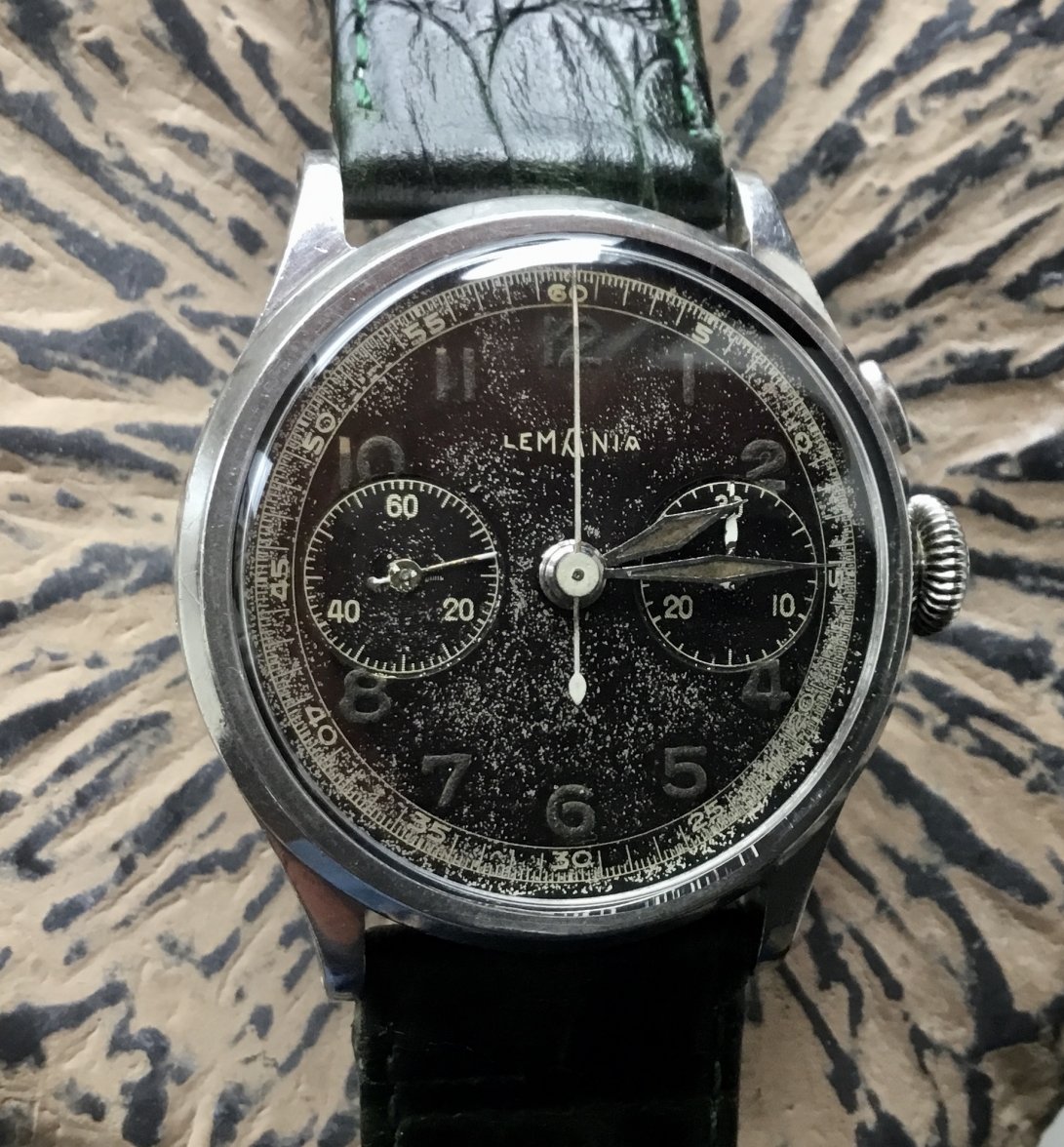

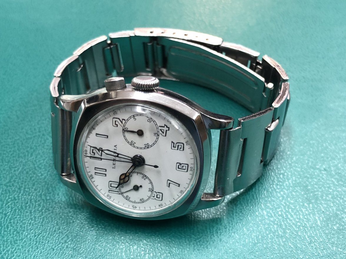

Both are highly likely civilian versions.
Early and fine versions using the 13CH movement.
Cases exists in various materials. Chrome plated, all stainless steel, solid gold and even solid silver.
Mostly produced during the 1930s.
Early ones has got ceramic dials.
My two below:
Stainless steel/black dial. The other one with a solid silver case.
