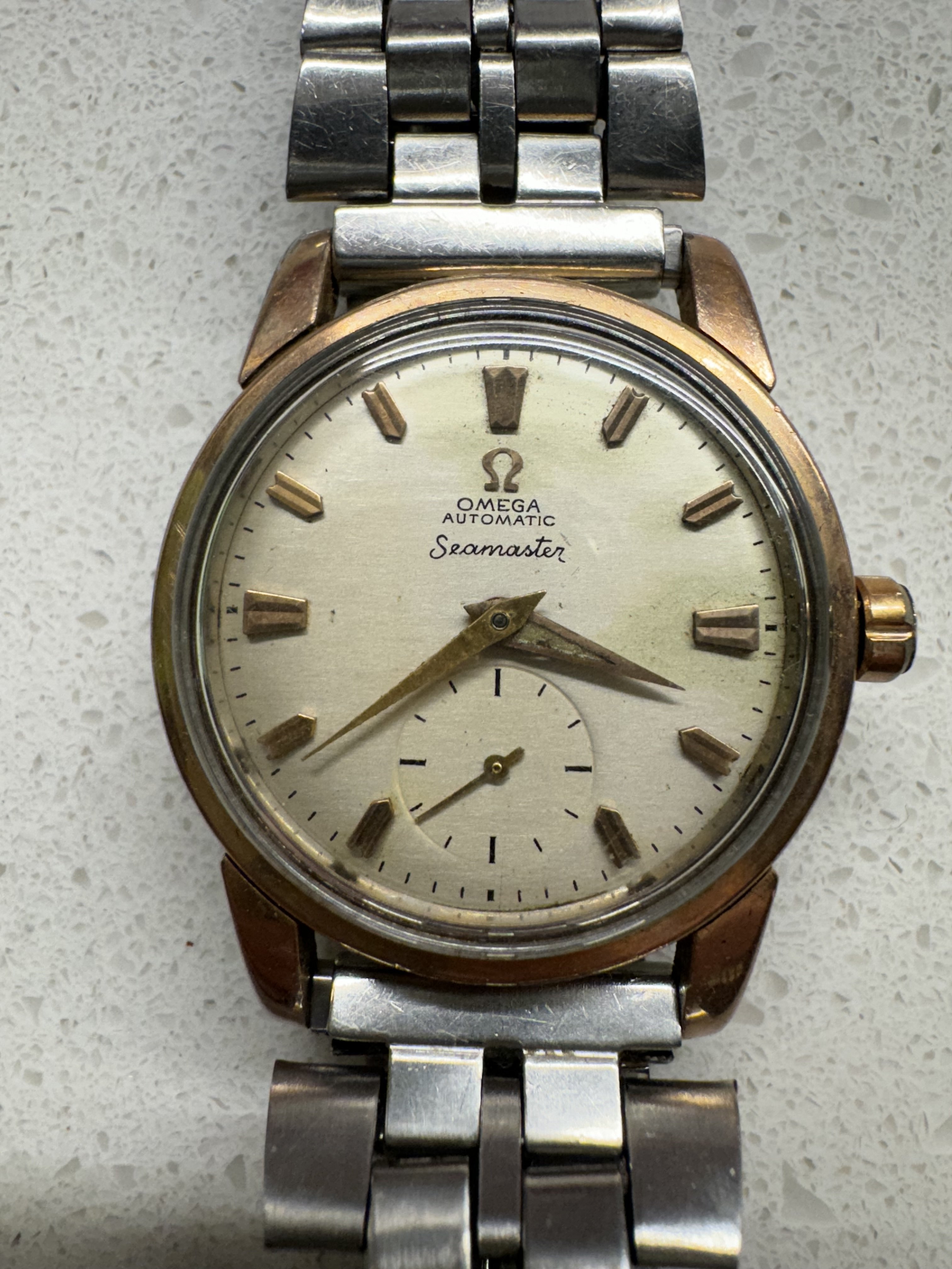

Hi y’all.
Can anyone date this seamaster please?
Had it since ages stuffed in a cabinet and “discovered” it again. What I find strange is that there is no “swiss made” inscription at the bottom.
Can it be a fake? That bracelet is of course not original to the Watch.
Appreciate all the help I can get.
Thanks

The dial has probably been reprinted. The lettering looks a little off.

Looks like it was very carefully hand drawn. Good for artwork, but not so good for watch dials.

Redialed for sure. Maybe a reference 2576. You should be able to date it using the serial number on the movement. Likely early to mid 1950’s.
