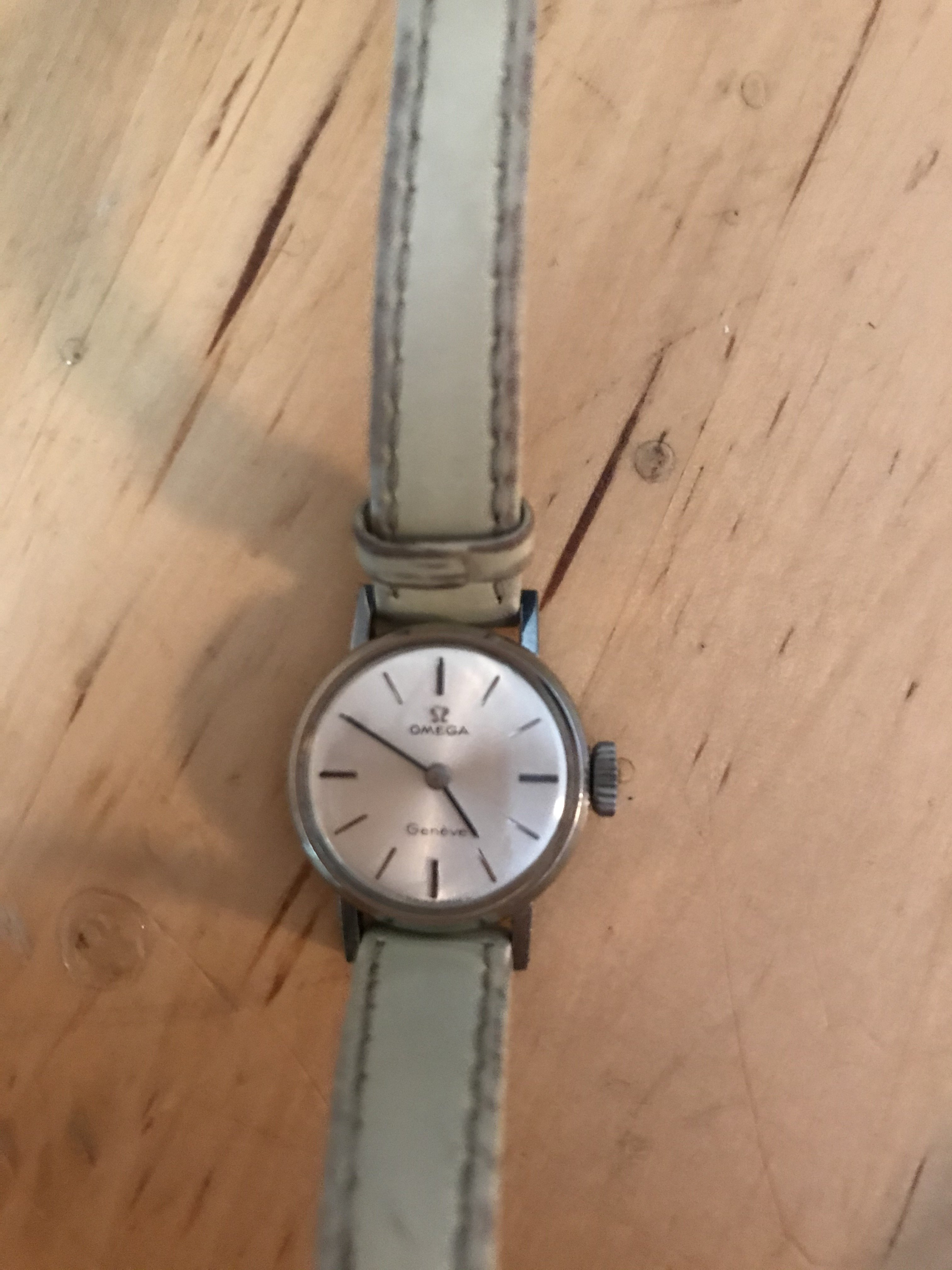

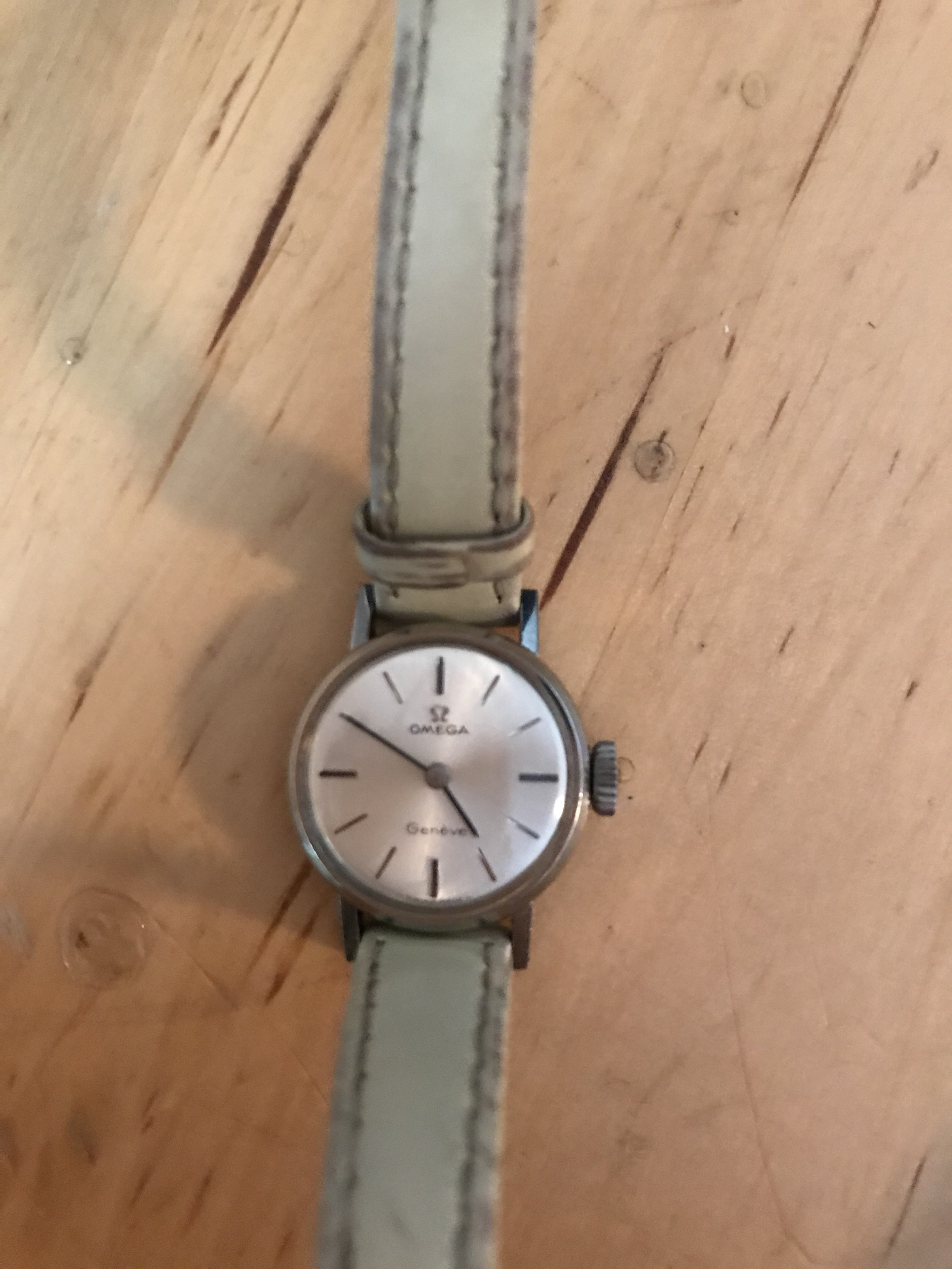

I have this vintage ladies Geneve (manual wind) which has just been serviced.
However, when I pull out the crown and try to set the time (anti-clockwise) it isn't catching. The crown actually screws off the watch. The hands do move though when I turn the crown clockwise and it does wind when crown is pushed in. Any suggestions on how to resolve this issue?
15,995
48,111
Just serviced, you say? Is there any answer other than to take it back to whoever serviced it? This is not a problem you can solve by yourself. The crown was not properly tightened onto the stem. That’s a warranty job.

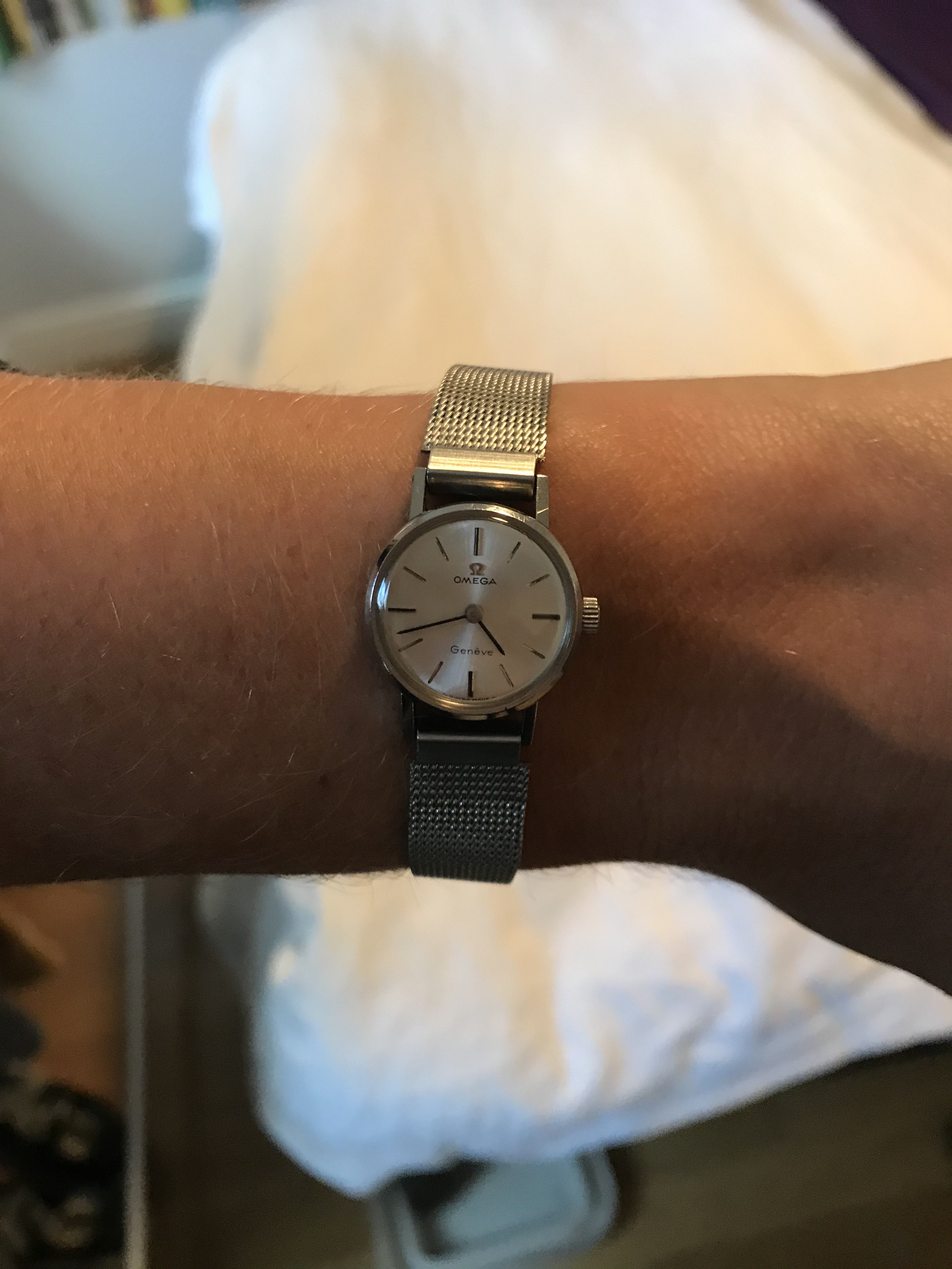

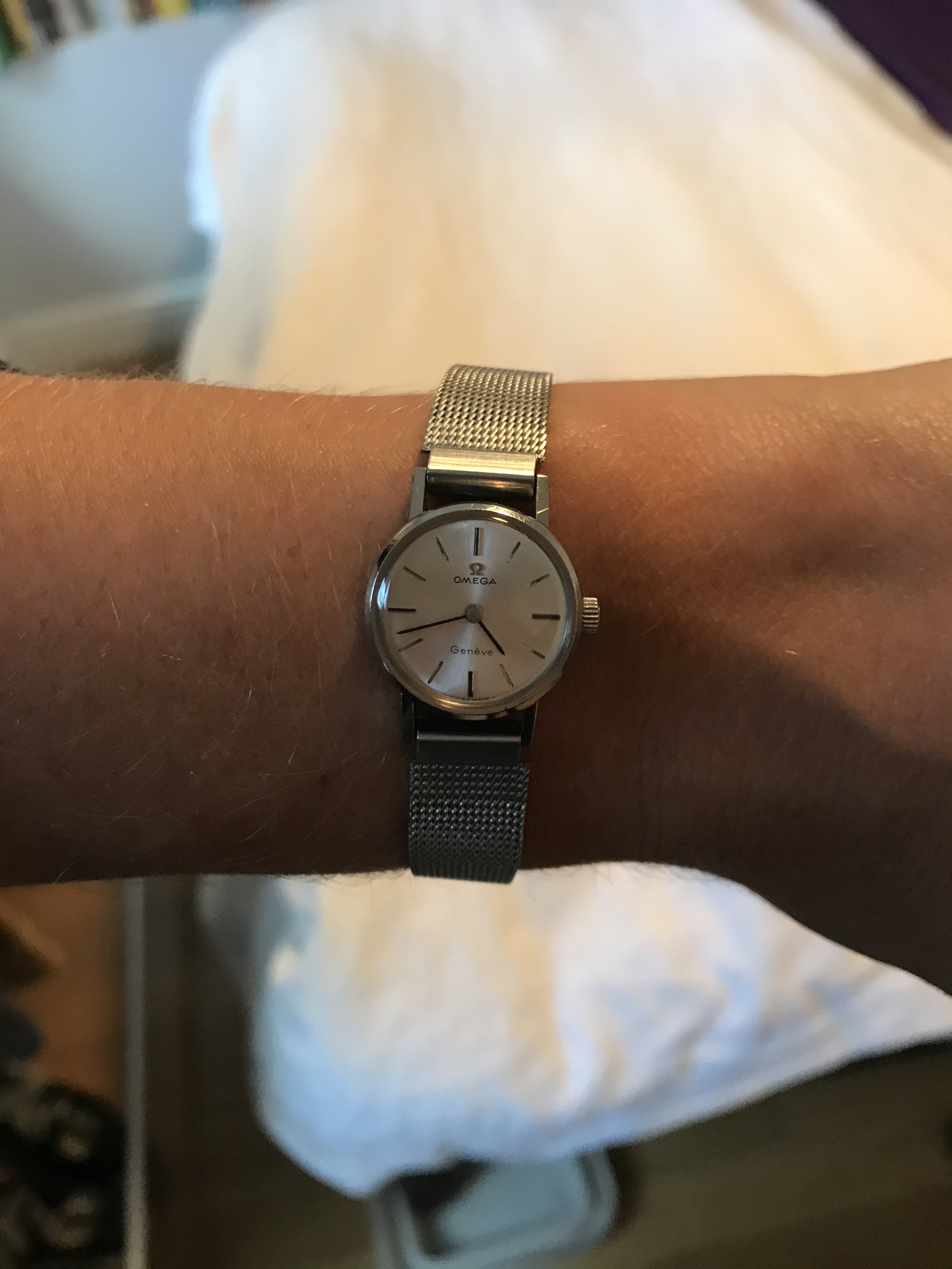

Just took to a watchmaker in Williamsburg, Brooklyn and he tightened it on the spot. All resolved. Bought this mesh bracelet as well whilst at it. Thanks for the help OF!
