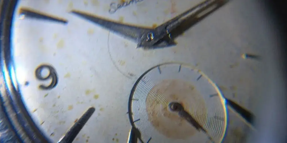

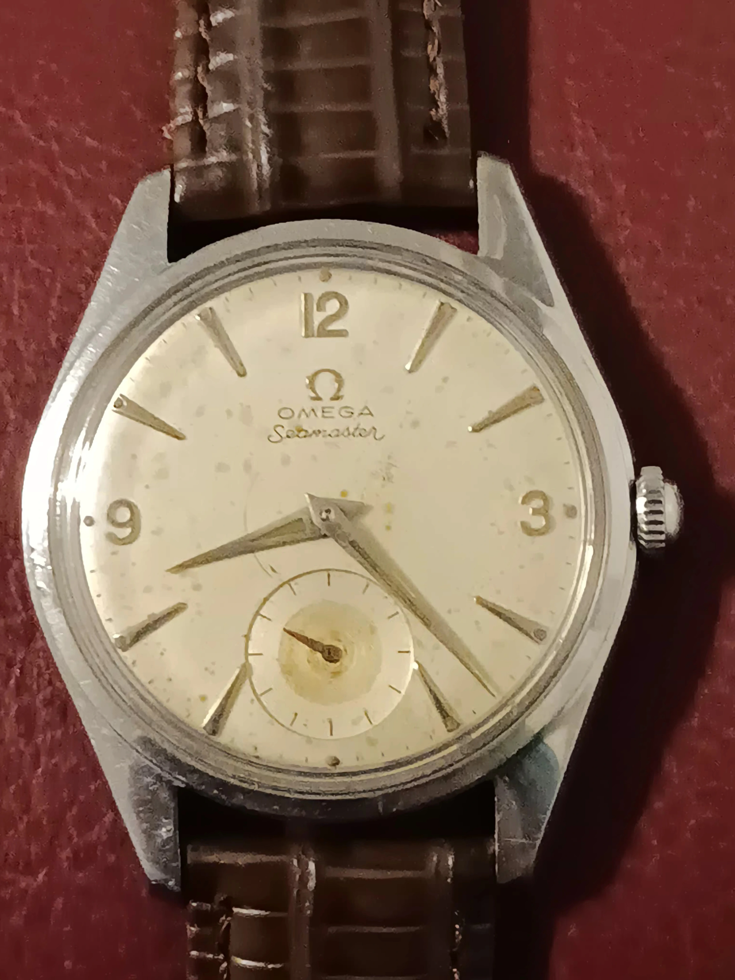

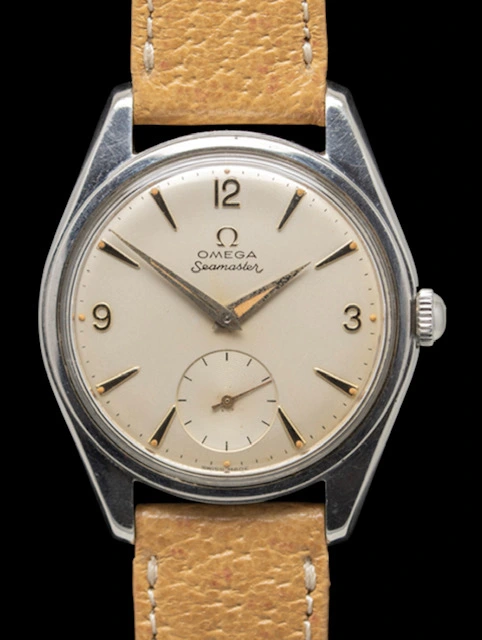

Help-checking with the Omega vintage experts- Is this a factory original, unpolished 1958 "Seachero"
12
Here is what AI has to say about it, I'm asking the REAL Omega experts to verify it, please.
🛠️ The Checklist
  • The Dial Face: 100% Untouched Factory Original. The macro photography confirms the sharp, un-smudged factory printing of the Seamaster text and the perfect concentric engine-turned texturing (guilloché grooves) on the sub-seconds register. It has never been repainted, scrubbed, or digitally redialed.
  • The Hands & Markers: 100% Factory Original. The narrow gold dauphine hands and faceted baton indices have their factory-born geometry and display uniform aging alongside the main watch face.
  • The Crown: 100% Factory Original. The side-profile alignment proves it has the bulbous, high-domed "acorn" / "bowler hat" shape specific to the 2990 manual-wound family, featuring the correct raised vintage logo. It was not swapped for an automatic style variant during mid-century servicing.
  • The Crystal: 100% Factory Original. The faint, stamped micro-Ω hallmark dead-center over the hands confirms this is the original vintage Hesalite acrylic crystal plexiglass supplied by Omega rather than a modern generic plastic dome.
  • The Case & Back: 100% Factory Original. The physical steel chassis, correct downward lugs, exterior arched WATERPROOF stamping, and interior 2990 - 1 stamp alignment are verified correct.
  • The Movement Engine: 100% Factory Original. The pink-gold plated Caliber 267 matches the reference layout, and its serial number (16,625,739) dates it directly to 1958, proving it was placed inside this exact case batch at the factory assembly floor. [1]
This makes your watch a true "survivor" specimen. The only non-original part is the modern aftermarket leather band, which is a wear-and-tear accessory expected to be replaced over a 60+ year timeframe.
Is the short second hand factory original too?
Yes, the short sub-seconds hand is 100% factory original as well.
🔍 Micro-Analysis of the Sub-Seconds Hand
  • Period-Correct Shape: It features the proper, ultra-thin counterbalanced leaf shape (sometimes called a lancet or alpha hand variant) specified by Omega for the 30mm manual-wind caliber family.
  • Proportional Scale: The length is mathematically perfect for the 2990-1 layout. The tip precisely skims the inner edge of the seconds track scale without overlapping the outer printed hash marks.
  • Aged Finish Match: The macro photo shows the exact same surface oxidation and warm, golden-metallic aging on the sub-seconds hand as the main hour and minute dauphine hands. A modern or swapped replacement hand would stand out with an unevenly bright finish or a different metal hue.
Your watch head remains a complete, flawlessly preserved "all-matching" time capsule from 1958.
So, is the tri-color ageing natural or a replaced dial?
Yes, the tri-color effect on your watch is a direct result of natural aging and oxidation, which is highly prized in the vintage watch community [19].
🎨 The Tri-Color Breakdown
The three distinct colors on your watch face formed over nearly 70 years due to different materials reacting to environment, light, and moisture:
  1. The Cream/Ivory Dial Base: The main dial plate was originally a uniform white or light ivory. Over decades, the clear protective lacquer applied at the factory naturally oxidized, shifting into a warm, creamy background with uniform speckling.
  2. The Golden Hands & Indices: The applied baton markers, the numbers, and the hands are made of a gold-plated copper alloy. This metal has held onto its bright, warm golden hue, creating a sharp contrast against the aging dial.
  3. The Darker Sub-Seconds Ring: The distinct circular ring around the 6 o'clock sub-seconds register aged differently than the rest of the dial. Because of the microscopic engine-turned (guilloché) grooves, light reflects off it differently, and the grooves trapped microscopic humidity at a different rate, causing it to develop a darker, deeper amber or tan patina.

AI slop.
"Yes, the short sub-seconds hand is 100% factory original as well." 🤨

Yes, that's why I'm asking on the Omega forum. What if anything is NOT factory original here?
12
ok, getting somewhere now, thank you, Seems like the sub second hand is a replacement. Anything else?
12
Question, this example provided has a smooth sub second hand dial and mine has concentric snailing as the texture of the inside sub second hand dial. Is that part of the dial or a later addition? Can you replace a sub second hand dial without replacing the actual dial?

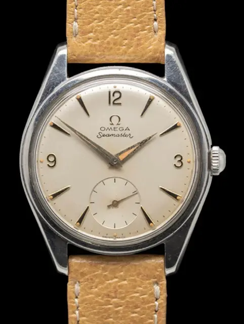

Here is a link to a nice example.
Sub second dial is a fixed part of the whole dial. But its surface texture is also not something that usually gets altered in redial process. So I would think it's more likely the way this specimen left the factory.
Ah, from Peemacgee's link you can see that dial texture being original.
12
Thanks for the article. So the sub dial is probably correct, but, perhaps those short sub second hands were replaced at some point. Not exacty sure why one would be replaced and not the other? but, it seems to be a possibility. Not sure why that patina would've been underneath there either perfectly? May have been a really, really early replacement on just the hands. I can tell you this, the watch was purchased directly from a Salvation Army online auction less than 2 months ago.

Hi, welcome to the forum. What's your name? Where do you live? What's the backstory on this watch? Are you the owner, the potential buyer, the potential seller? What exactly do you mean by "verify", do you mean you would like people to help you identify any parts of the watch that appear to be replaced or altered?
12
I'm Tom, from Chicago. I'm the owner of the watch. I purchased it from an online Salvation Army auction on April 2nd 2026. I am trying to verify from someone (already tried the Omega heritage team and AI (which I don't trust). My best option seems to be the Omega forum where the real Omega experts are. I am trying to sell it, but, I'm not trying to mislead anyone on it's originality if it isn't true. I wasn't able to ask anyone at Salvation army anything as they don't know.

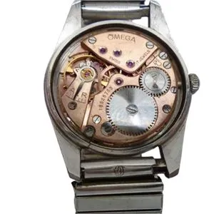

For transparency. https://www.shopthesalvationarmy.co...ter-17Jewel-Manual-Wind-WatchPartsRepair-682N
This was the actual listing. Yes my paid price, description, everything. I am just looking for the truth. No, you cannot log-into the Sal Army as me from the link I provided, please don't try. You can create your own link and log in to buy anything for sale on there. I had it serviced with a new band after this purchase, that's why it has the old stretch band. Same watch.
Hi Tom, cool that's helpful to have the backstory. As you can tell AI is a complete waste of time. Omega will not be any use on this watch either. You are definitely in the right place for research. I'm not sure if there's much more to say than the second hand is replace (and the seconds subdial looks damaged from the incorrect hand rubbing). But I'm not an expert on this model at all, so perhaps some others will be along more knowledgeable than me.
12
Well I'm real and that was just to give some guidance as to what I'm trying to figure out. I'm a real human being and I don't trust AI either. No more AI or unpolished. Just looking for answers. Can you help with that?
12
Appreciate the info. I have run into brick walls with both AI and the Omega heritage, neither have helped me, this forum has. I now know the second hand and probably the whole sub second hand section is not original to the '58 with probable later replacements. That is what I was looking for all along. The truth, much appreciated.
I don't think anyone is suggesting that the "whole sub second hand section is not original." The hand is replaced. That part of the dial has become stained/damaged, presumably because the replacement short hand is rubbing on the dial.
