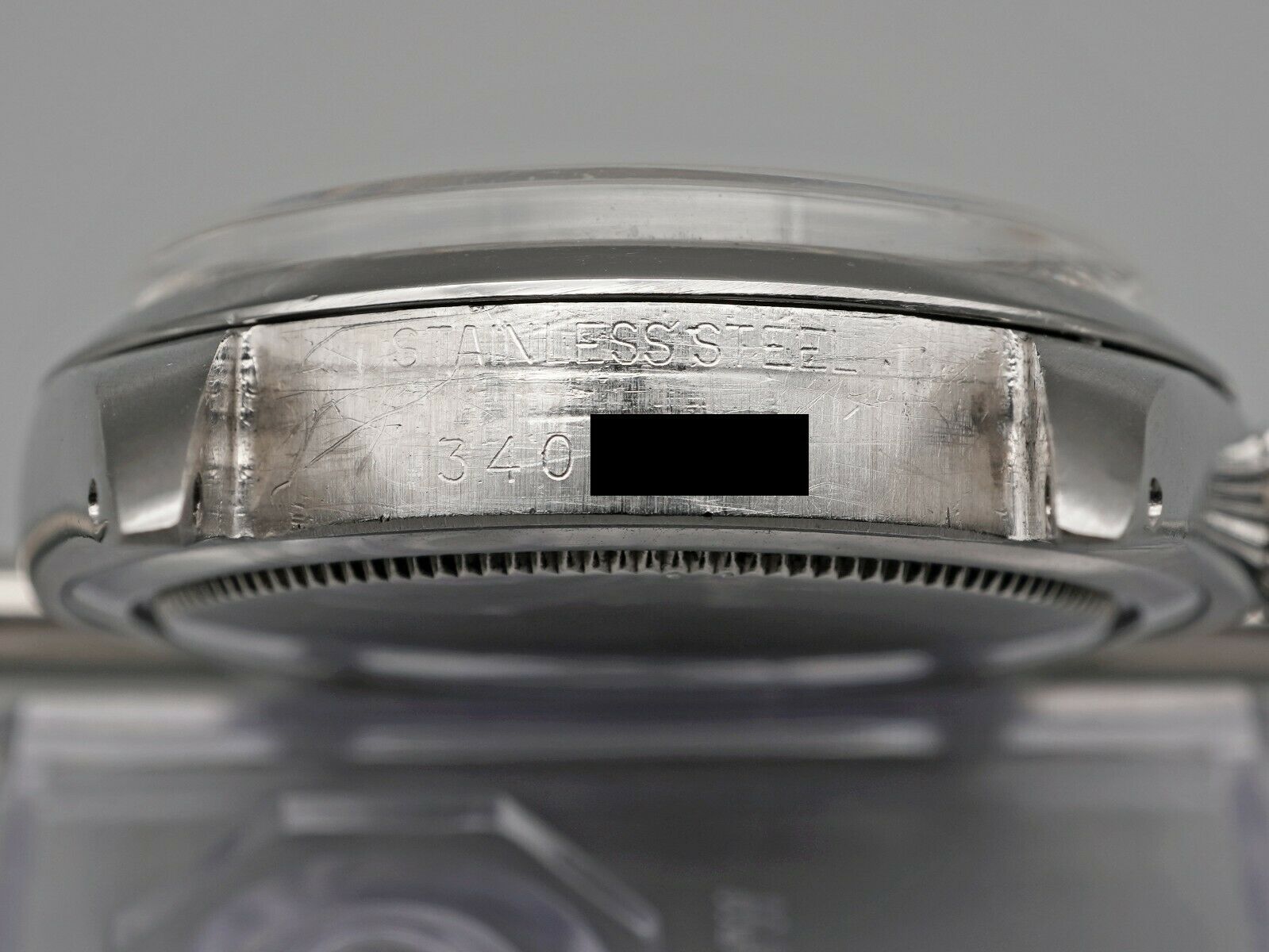

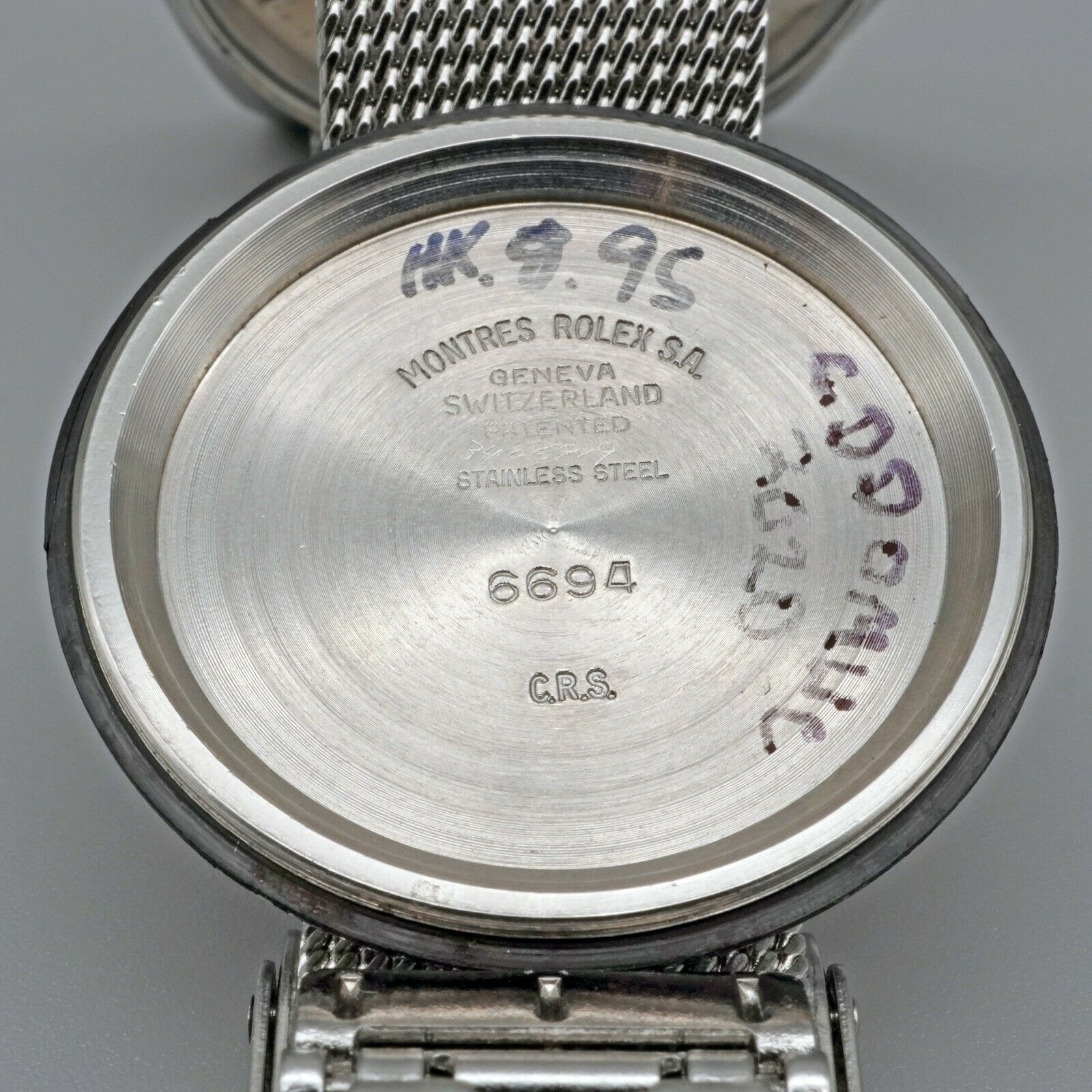

As you probably know, CRS just refers to one of the companies that made cases for Rolex and Tudor. Try googling the following and see if you find other examples of this particular reference.
"crs" rolex 6694
BTW, if you ever intend to buy anything from sellers on the forum, this might be a good time to change your username. 馃槈

Just searched HQ Milton sales for this reference
no CRS cases to be seen, and werent Rolex still date stamping case backs at this time?
so could it be a later service case back?

Yes it is fine. I think Rolex stopped stamping the case backs in the early 1970's
Here is an example from HQ Milton showing a 1973 6694 with no date stamped on inside of case back
https://www.hqmilton.com/timepieces/rom28m0k/1973-rolex-oysterdate-6694-silver-dial-A2840
Nobody was faking 6694s, that was one of the lowest priced Rolexes on the market. A manual wind watch with a crown needing to be screwed and unscrewed to wind is not really sought after now ether. Most sell for $1200-$2000. I paid under $1000 for my 6694

Yep, i saw that thanks - but my point was i couldnt find a CRS stamped case back for the ref 6694 for any time period - 1969 to 1980s
hence i wondered if its a later service case back?
Did you try google, or just HQM?
https://www.laurentfinewatches.com/watch-expo/expo-vintage/Rolex-Oyster-6694-Vu-02-12-2018.html

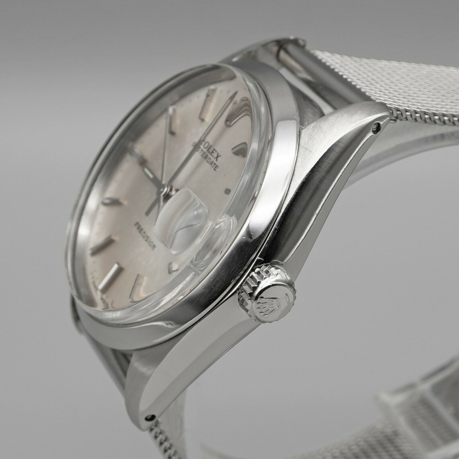

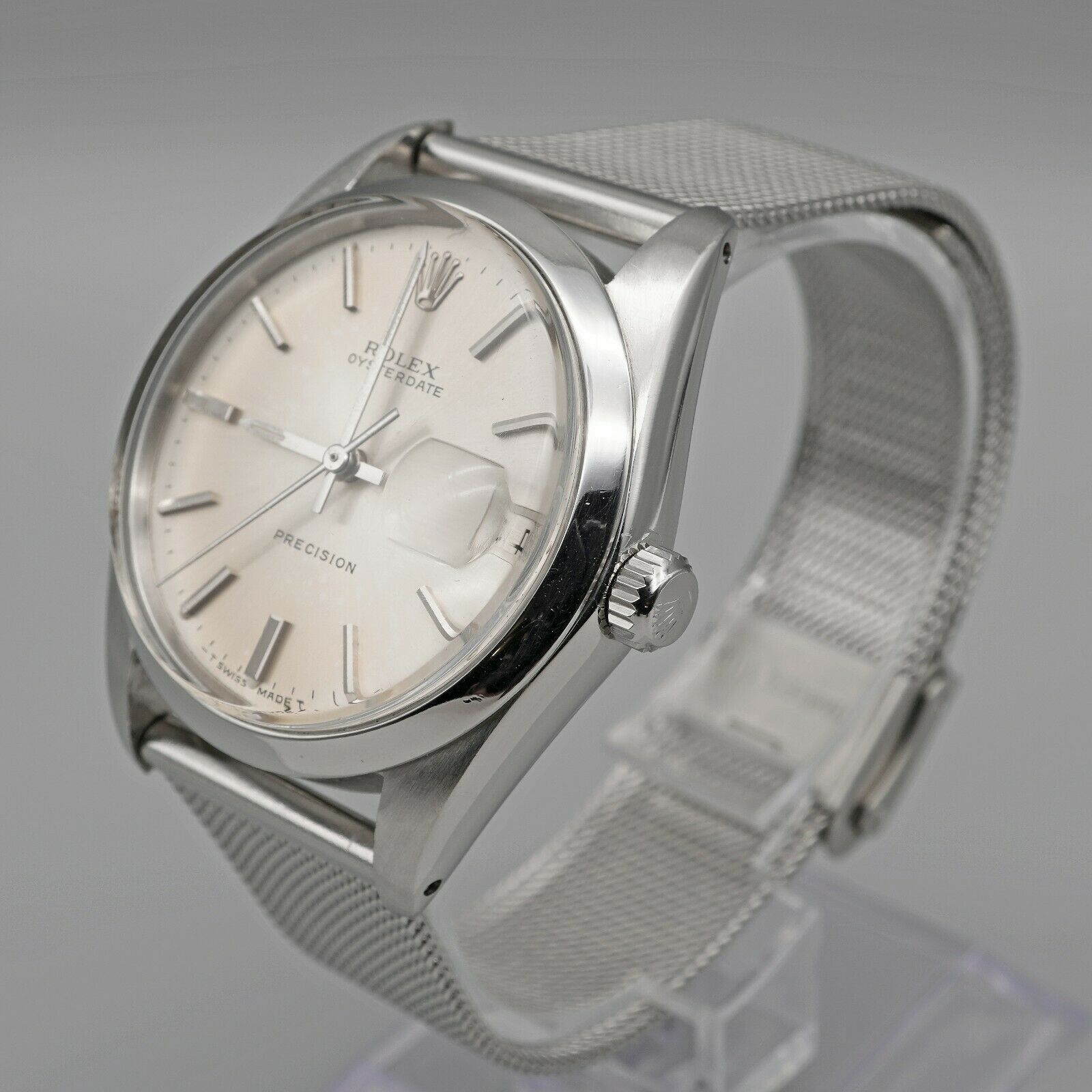

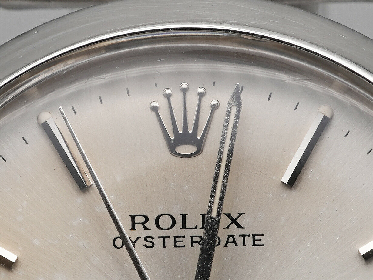

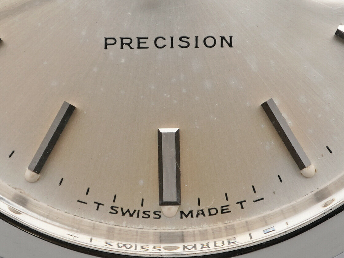

Serial is from 1973 which I believe should have a dial signed "T Swiss T" and not "T Swiss Made T". The latter signature is found on dials from the 80s/90s. So, an authentic Rolex dial but in my opinion not original to the watch.
13,522
23,461
I also think DJ鈥檚 and 6694鈥檚 from this period should just be stamped T Swiss T so it looks like a later service dial, possibly lending credence to the likelihood a service caseback.
