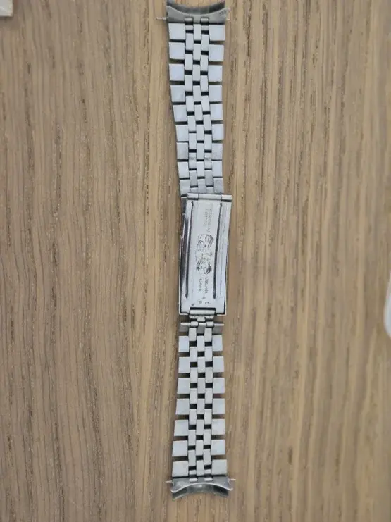

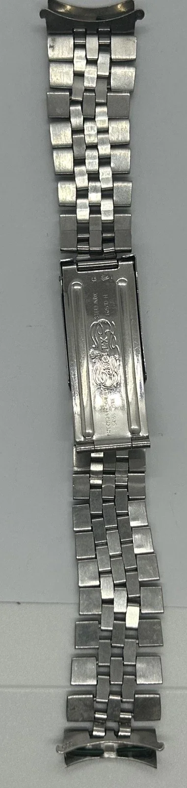

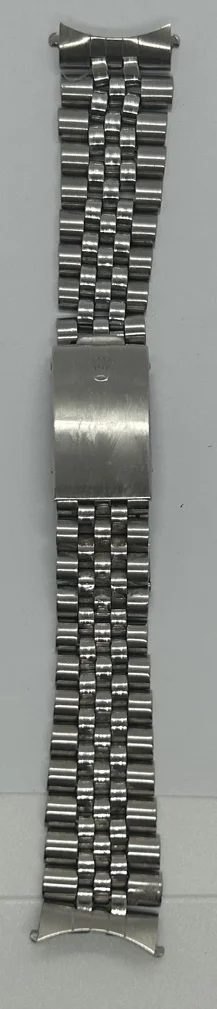

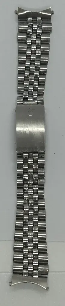

Hi all,
I recently purchased a watch-only Rolex Datejust 16000 and I’m now trying to find an authentic bracelet to pair with it (namely a Jubilee 62510H with 555 endlinks). I have very little experience evaluating Rolex bracelets, so I’d really appreciate any thoughts from members who know these better than I do.
I’m currently considering the two bracelet options shown below. Both are priced in the region of €600–700.

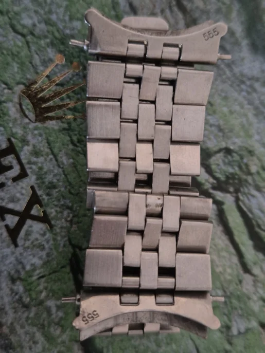

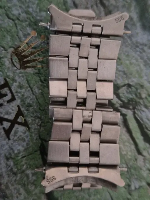

Option 1:

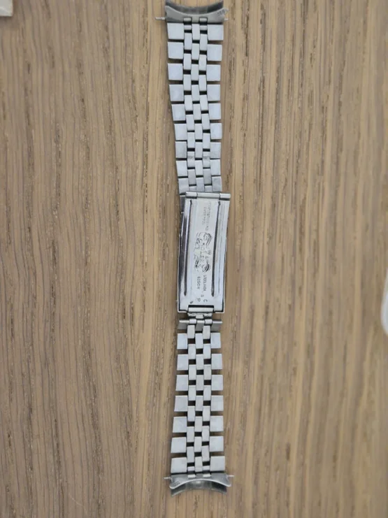

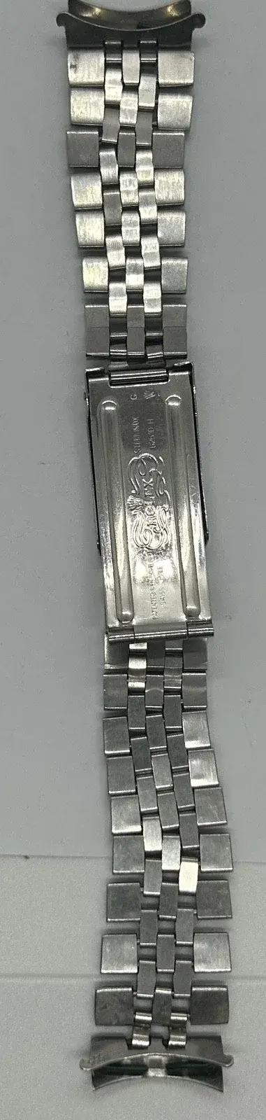

Option 2:
My initial impression is that both look to be in somewhat rough condition, but I’m not confident enough to judge whether the wear is acceptable, whether the pricing is fair, or whether there are any more serious concerns.
I’d be very grateful for thoughts on:
  • Overall condition and stretch (or what you'd recommend I'd need to assess this)
  • Whether the clasp, links, end links, engravings/stamps, etc. look correct
  • Any serious red flags that would make you avoid either one
  • Whether €600-700 feels reasonable for either option given the condition
I know authentication from photos is always tough, but any guidance would be very helpful before I proceed. I’m still learning when it comes to Rolex bracelets, so please feel free to point out anything obvious that I may be missing.
Thanks in advance.
24,566
54,550
To assess the stretch, have the seller curve it into an arc, as far as it will go.
For authentication, we would need much better photos of the clasp and blades and endlinks, clearly showing the engravings, scrolling, coronet, etc.
My gut feeling from the poor photos is that the first option is very far gone, and would really not be wearable without restoration. The second doesn't look great either, but might still have some life left in it. 600-700 Euro seems like a lot to pay, if you are going to have to shell out another $600 USD for restoration.
13,256
23,036
They aren’t great. I agree with Dan that the first looks pretty poor and the seller has pushed the links together to minimise the appearance of the stretch.
You can get a bang average bracelet for around €300-400 with a bit of patience.
€700 should get you a good one.
767
1,409
If you end up buying either of these two options, get an ultrasonic. I’m sure there is plenty of dirt and dna in those.
1,384
850
I also agree with Dan, they look deliberately bunched up to avoid an honest display of its stretch
