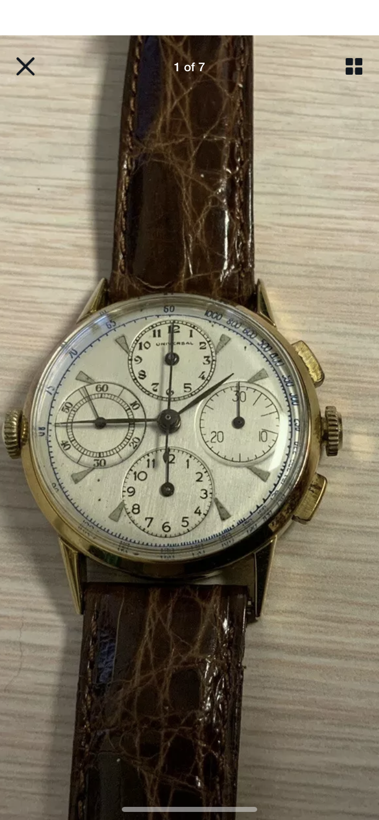

If we are talking about this one (from a thread at WUS) I suggest you return it. VERY poor redial....

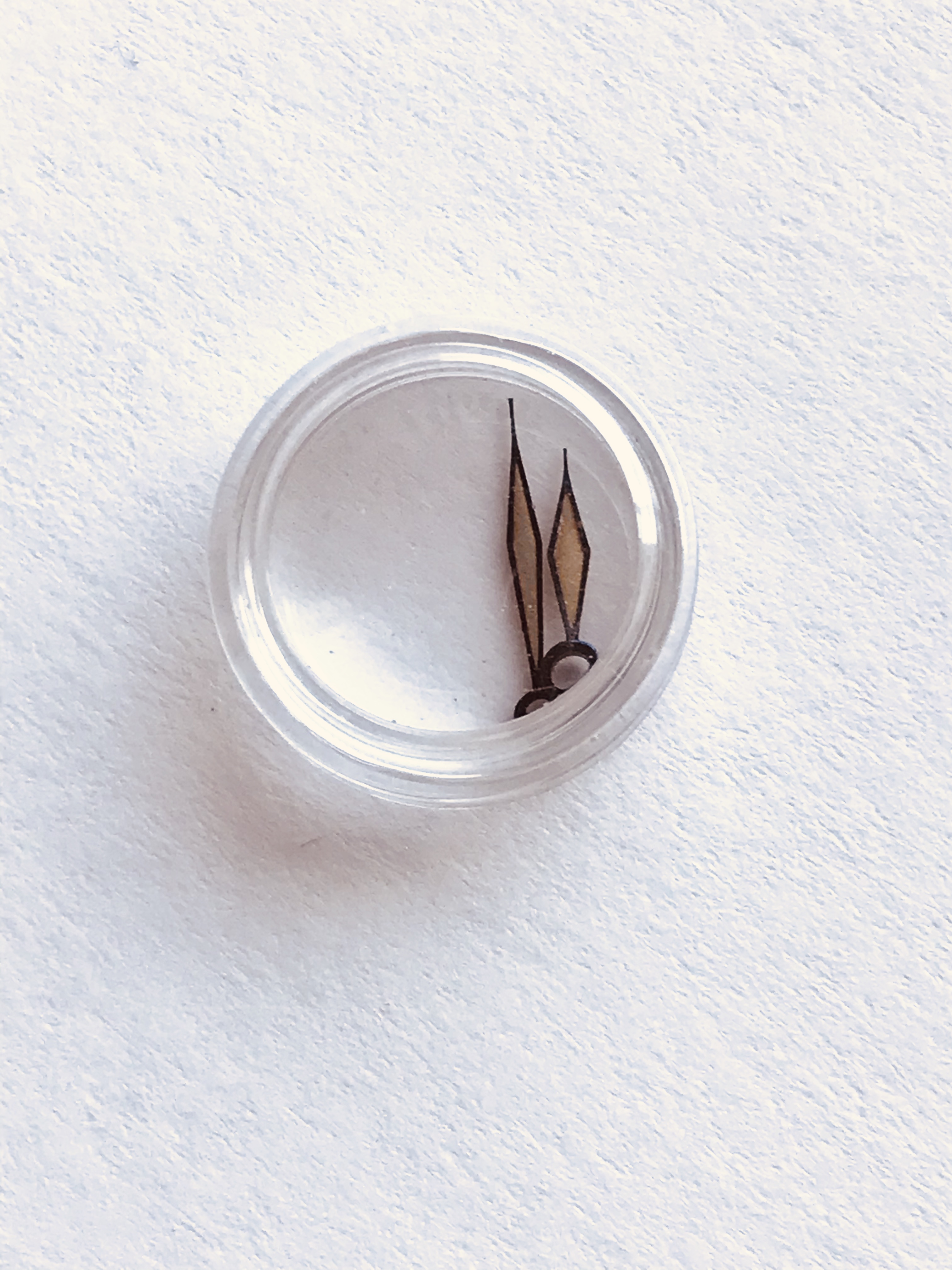

Here’s the hands. Perfect gingerbread radium. Bought them a while ago but never used.

The watches movement is a cal 287 I don’t think they would work. The correct hands I believe are gold and needle like I think..

What's the size of the watch - are these what you're looking for?
Edit: it's a cal 283
Edit 2.0: Forget it - Ranfft says they are different sizes.

That is the style of hands I need but mine’s cal 287 an it’s a 37mm watch. And to be 100% correct I’d need a gold dotted dial and gild leaf hands if I’m correct.

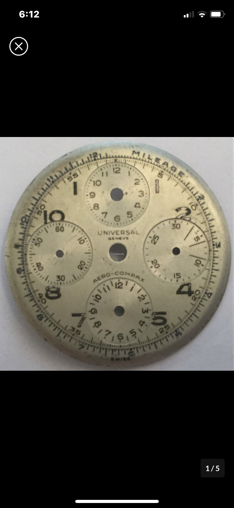

This is the dial I got off Chrono24 and these are the hands that are on the watch currently. I think the style of hand you have would be the correct hands for this dial.. I think. I want to replace all the hands as you can see the seconds hand is way to small for this watch.
3,677
8,482
that's a lumed dial, so it would not look right with anything but lumed hands. It would definitely not look right with gold color leaf hands.
Do you know the dial will fit? Even if it's from a cal 287 doesn't necessarily mean it will work. You might want to check that first before worrying about hands.
Anyhow getting a complete set of hands is not easy and not cheap. Do you have both hands on the momento dial, I cannot tell ?
Once/If you know the dial will work, then my suggestion would be to get lumed H/M hands, use all the rest of the existing blue hands, and just replace the one (thin) running seconds hand.
The chances of getting all the hands you want for a cal 287 are low. A good watchmaker should be able to broach the holes up a size, to go from the smaller calibers up to the 287, and also if necessary to adjust the tube sizing on the running seconds hand, etc

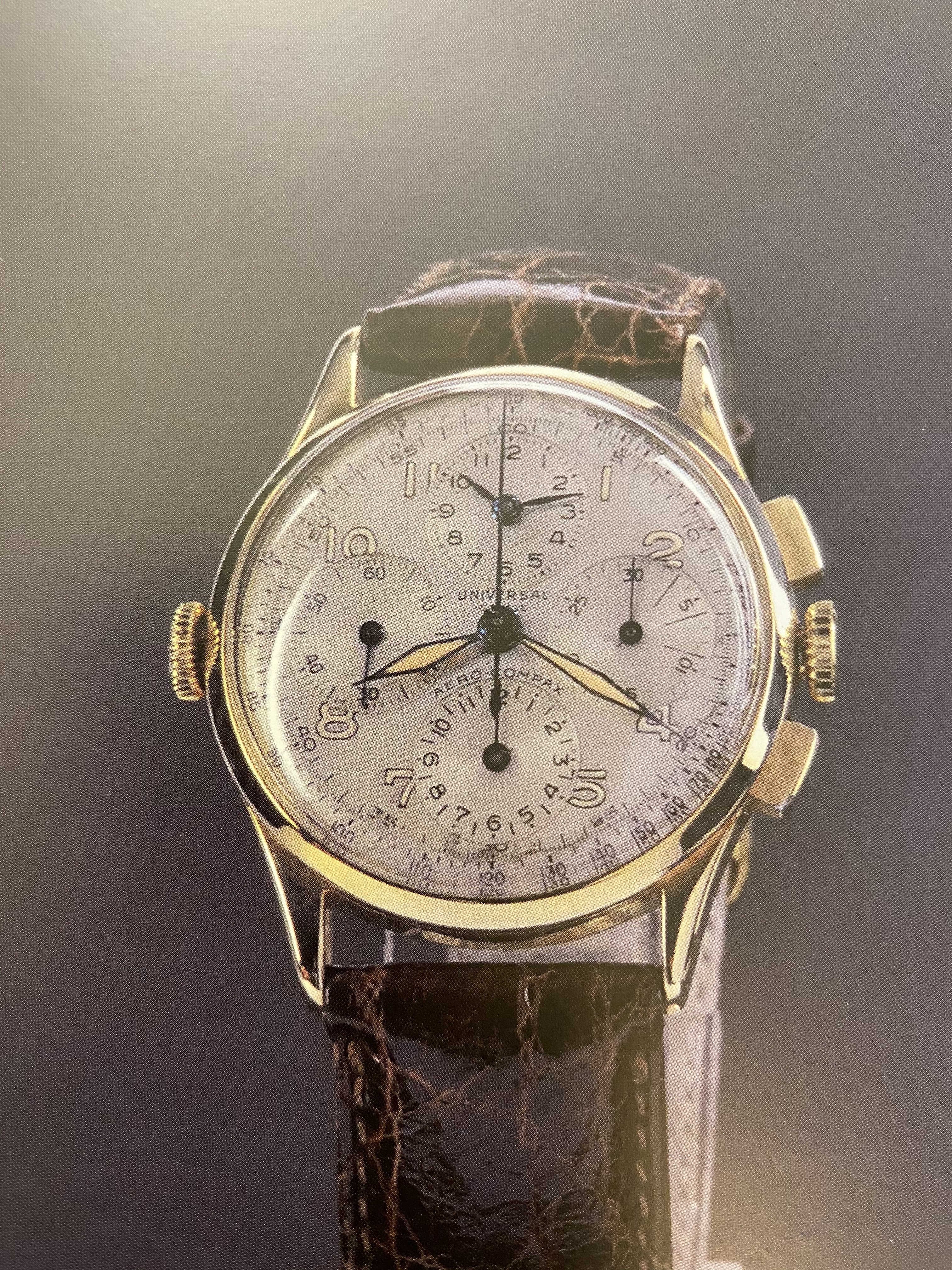

In closing here's a shot of a gold (14K) cased Aero from Sala with a similarish dial as your proposed swap (hands and dial look relumed in this example).

The dial you bought is for a 281 calibre.
The watch you have has a 285 inside.
This dial will not fit the movement, unless you broke dial feets and paste it on the movement with some glue. That should be illegal in every country of the civilized world! But it would be anyway too small for the case.
To find a proper original Aero-Compax spare dial is a pretty difficult thing. Sometimes it's smarter to buy a nice watch and enjoy it! 😀

Case reference remebered me about 285 movement. Then probably I am wrong but 285/287 use same dials, as well as 281/283. So in the end things are the same. But anyway that dial is not good for your watch 😀 That dial is a dial for a 22289/22290 reference watch.
