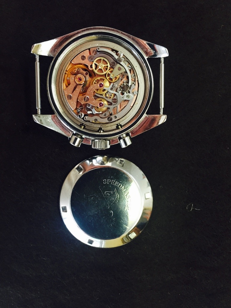

Is it possible to see the inside of your caseback?
that would provide a lot of info.
Pictures of the movement can give some clues for US delivered watches also.

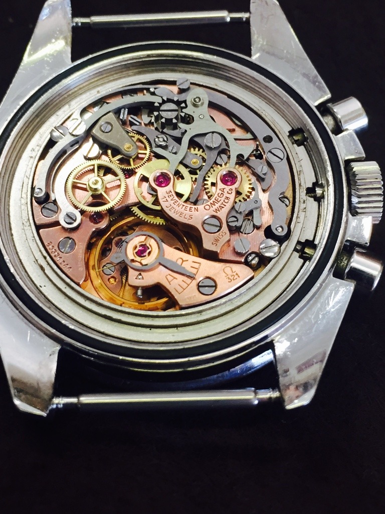

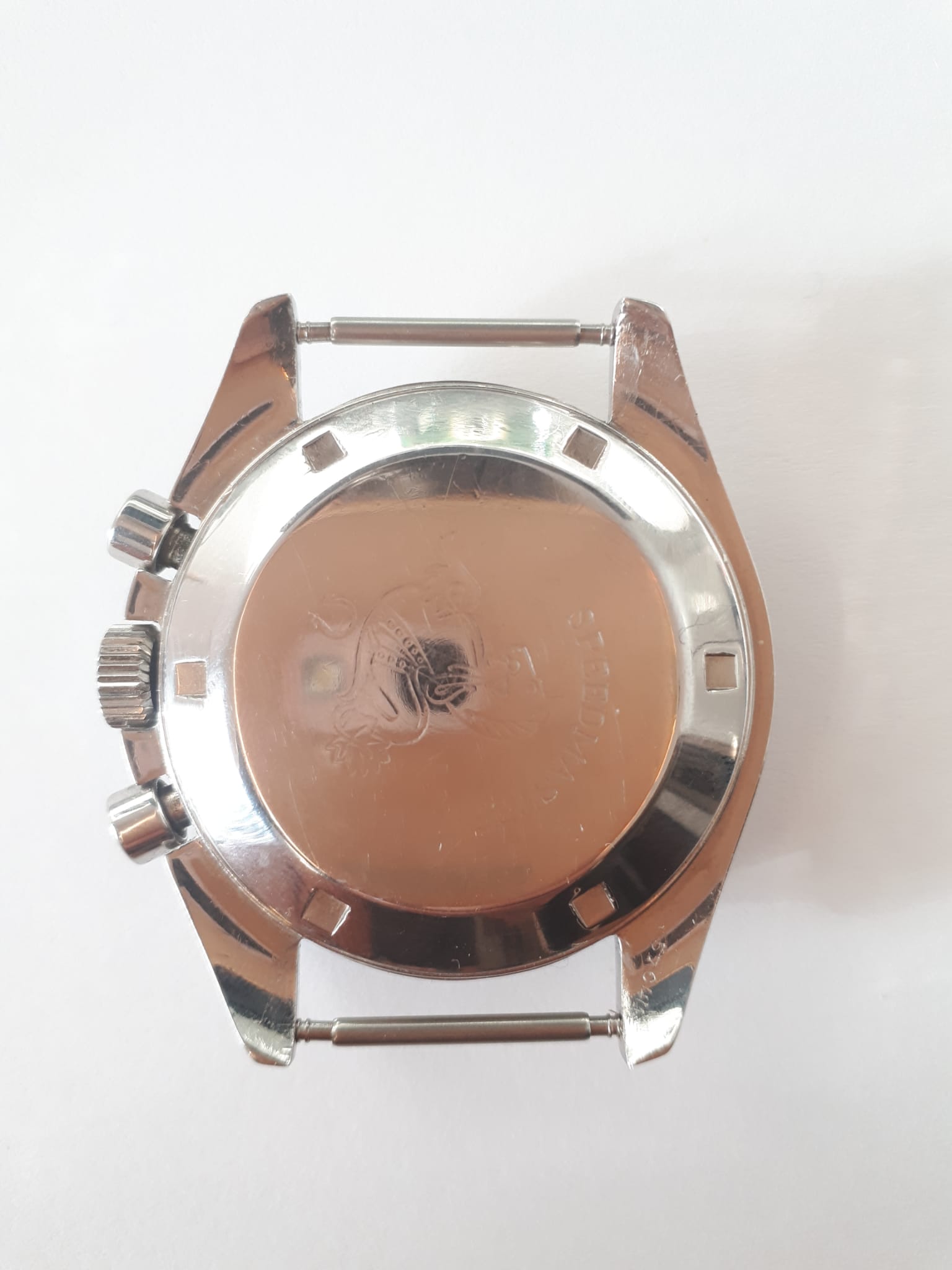

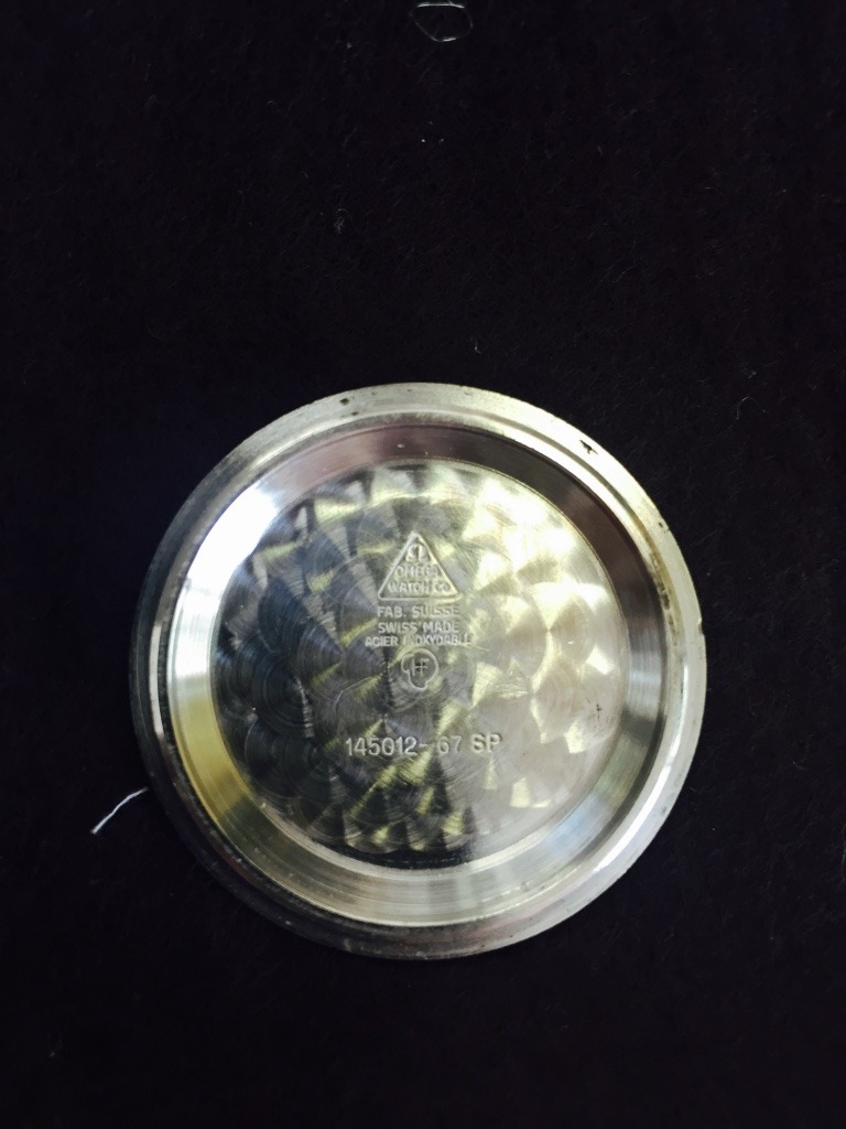

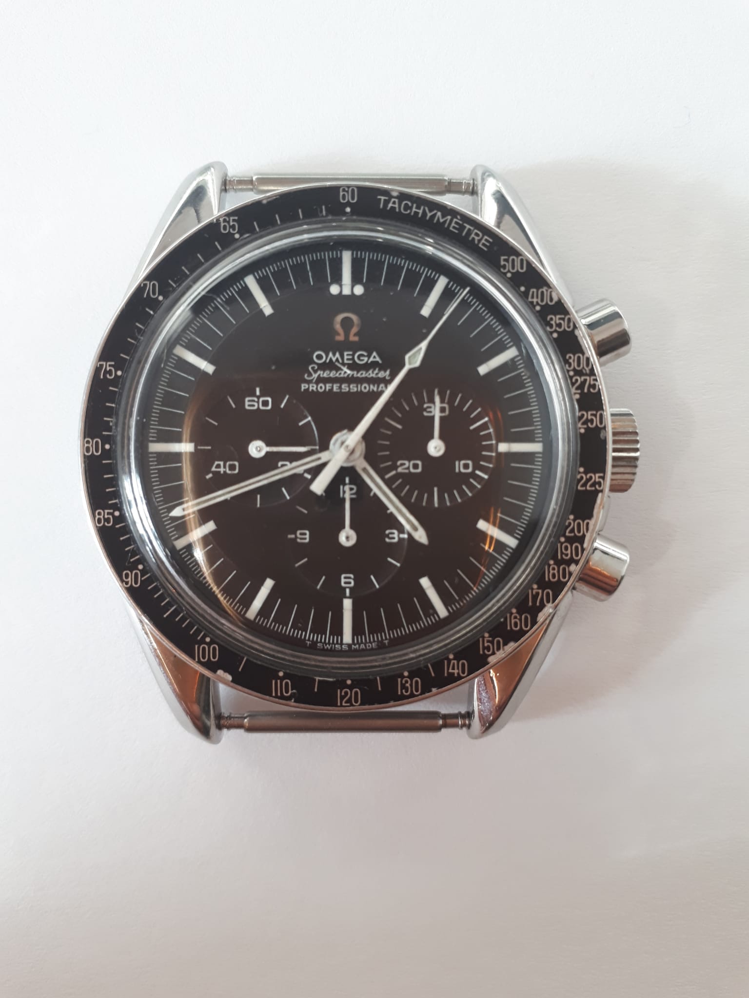

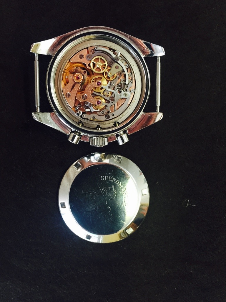

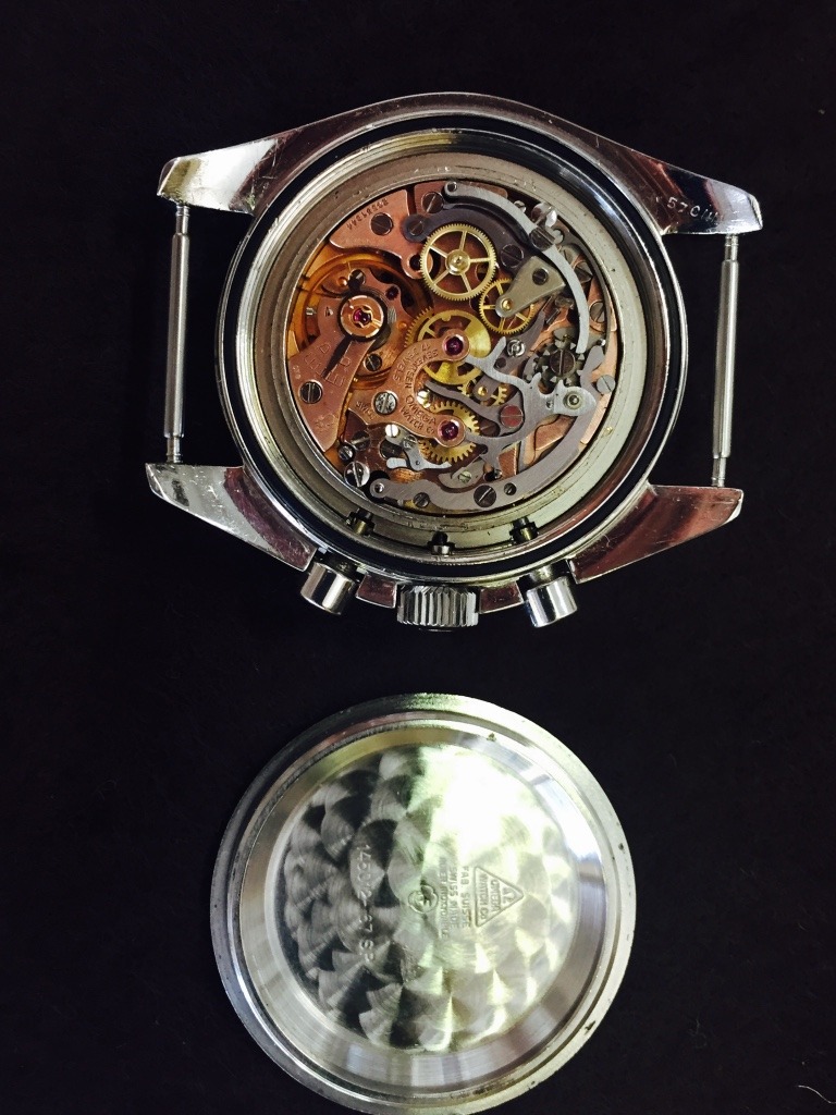

thanks everyone for your support and reply, I hope these pics could be more useful to understand better.
18,326
27,695
So that’s an HF case, they are made in Switzerland. There was a small batch of speedmasters with American made cases by star watch co. Generally these should not be in the hands of the public as they where made for NASA to comply with American parts sourcing laws for NASA.
So the wording is weird. They know the movement was sent to the US... but was that because you told them the movement was marked with OXG? OXG was the import code as required by law for Omega watches sent to the US. Other mfg’s had different codes.
So how did they determine it was sent to the US and why do they not have other data?
it’s entirely possible they just have partial records. They also might know it was a service movement sent to the US. But normally service movements I thought had other signs.
they did not appear to say the movement was supposed to be in another watch, which we have seen in the past.
you might want to reach out to them and find out how exactly they came to the conclusion they did.
4,901
24,972

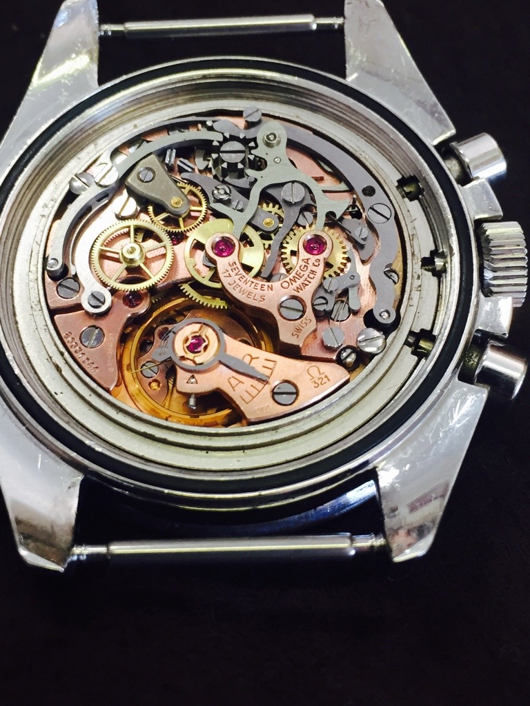

Is the 321 stamped with OXG? I know it is easy to find on my 550 (Seamaster), but I don't know where to look on a 321...and I couldn't find it in those pictures.
EDIT: NVM. I googled it and it looks like I can see it in the OP's picture.

Thanks Foo for the info, I asked Omega for more info but they didn't answer to me. They refunded me for the extract request by sending me the aforementioned answer. I would like to understand what kind of moonwatch is in my hand because it looks like an assembled one but I don't think it is based on Omega's answer.
I can't say to have a 145.012 but.....
18,326
27,695

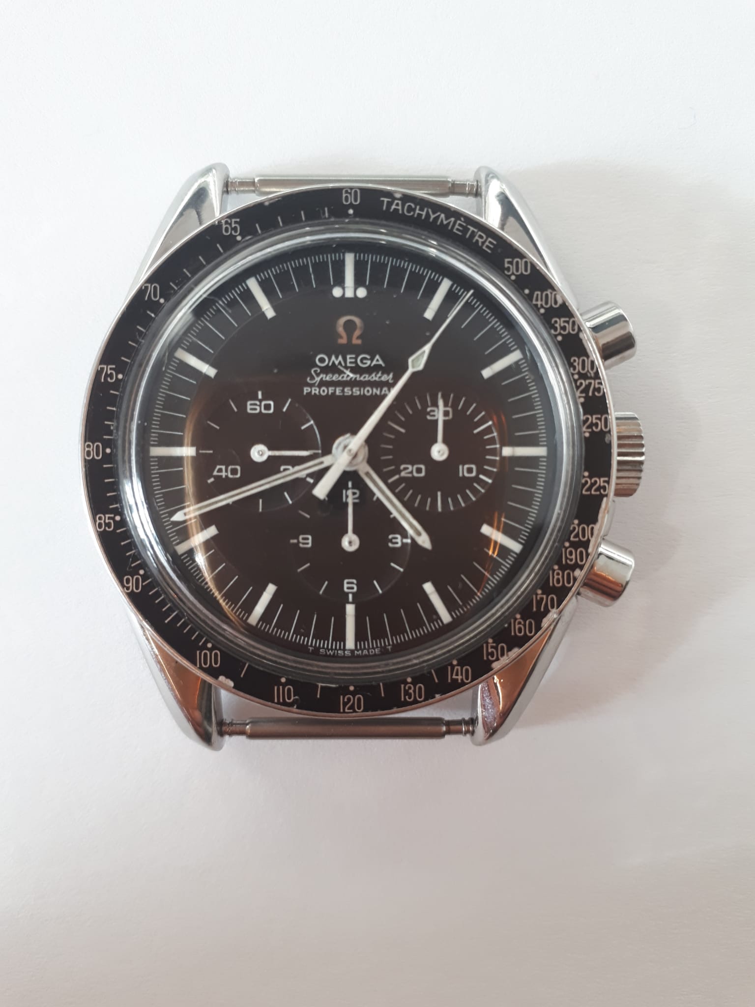

Parts appear correct for a 145.002... the chrono hand looks replaced with a lumionova hand. I can't tell the lume state on the dial. DON bezel is in decent shape. The serial seems slightly early... but that is not exclusionary.
18,326
27,695
Is the serial in range at 23M?
I edited it.

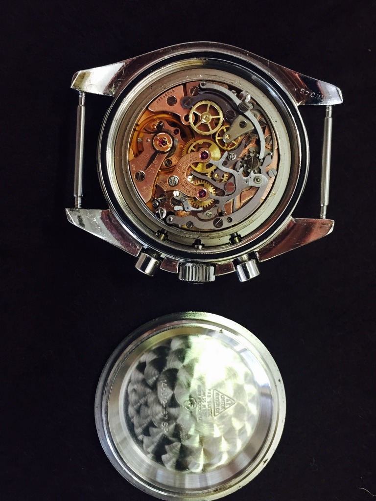

Foo do you have any idea about the hand-made engraving with the wording "57CMM"?
I would sell this moonwatch but I don't have any idea about the value for a mix of parts, not clear history and the doubt of Omega they said case made in usa.

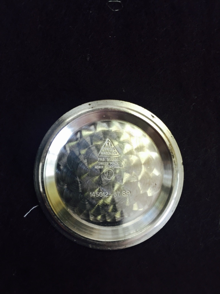

Well, the OXG code does appear to be on the movement, which means it was a movement for export.
However that caseback is an HF caseback, which is Swiss.
Your serial number points to a 105.012 (or 145.003?), but your caseback clearly says 145.012.

Sure seems like it could be pieced together. Hard to tell about the dial lume in the photo -- is it there? Is the movement potentially from a Seamaster? No service marks on inside of caseback, but it looks like the movement has been serviced at some point. Whoever manned the polishing wheel and destroyed the case should be hung up in the air and given the same treatment...

I'm sorry just to understand how can understand an HF case?
HF is the code for a swiss case maker who produced Speedmaster cases for Omega.
So what you have:
1) case made in Switzerland
2) movement exported to the USA - there it was most probably cased into a Seamaster or the like
Somebody might have transplanted the movement into this case maybe to replace a heavily damaged movement (think water damage, rusted,...).
