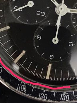

Help a newbie out. Can anyone give me any thoughts on this watch?

Incorrect rehaut? Is it silver?
It's appears too large. Could be the photo angle but I can't remember seeing a proper Ed White where only the very top of the T Swiss Made T is visible. Common on SM300s but not on a 105.003. Just sayin.
Edit: probably the rehaut is ok. The photo angle plus curve of the crystal can cause this distortion. NEED MORE PICS!

This "all original" Ed White appears to have an incorrect rehaut and crown.
I don't even know what "rehaut" is. What is rehaut? Thank you
The ring that sits under the crystal

When you say "this watch", are you saying you own this watch and want to know more about it, or it is a watch you have seen and are thinking of buying?
I'm thinking about buying it.
