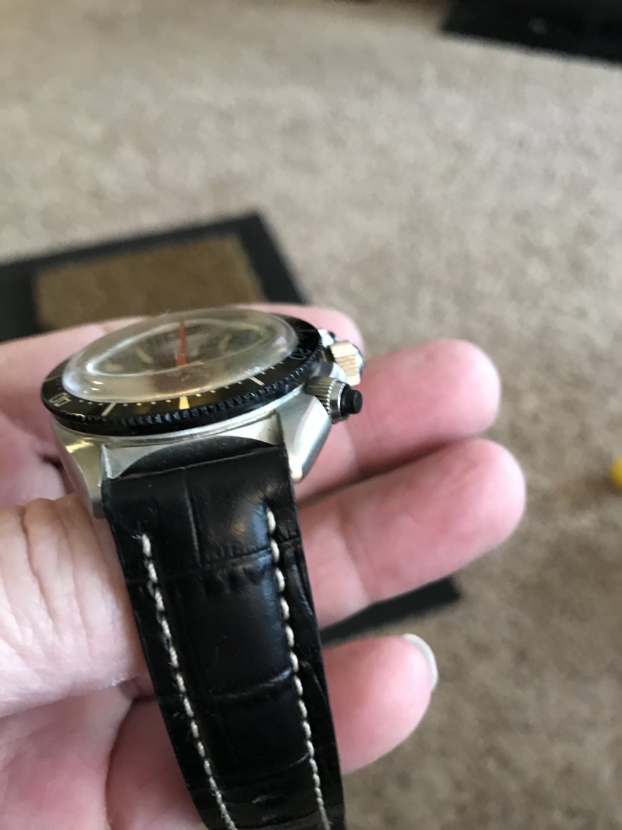

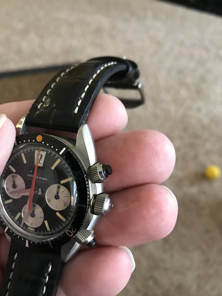

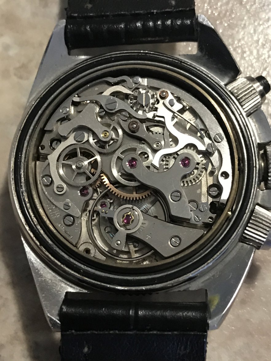

    The bridge is unsigned, is the movement original to the watch?
    something doesn't look right with the crown either.

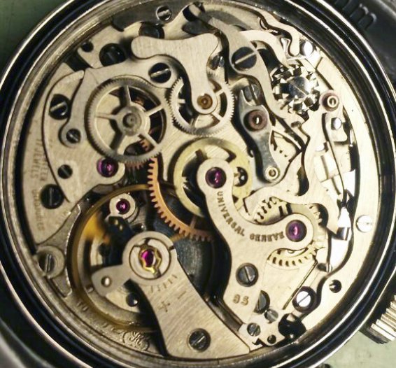

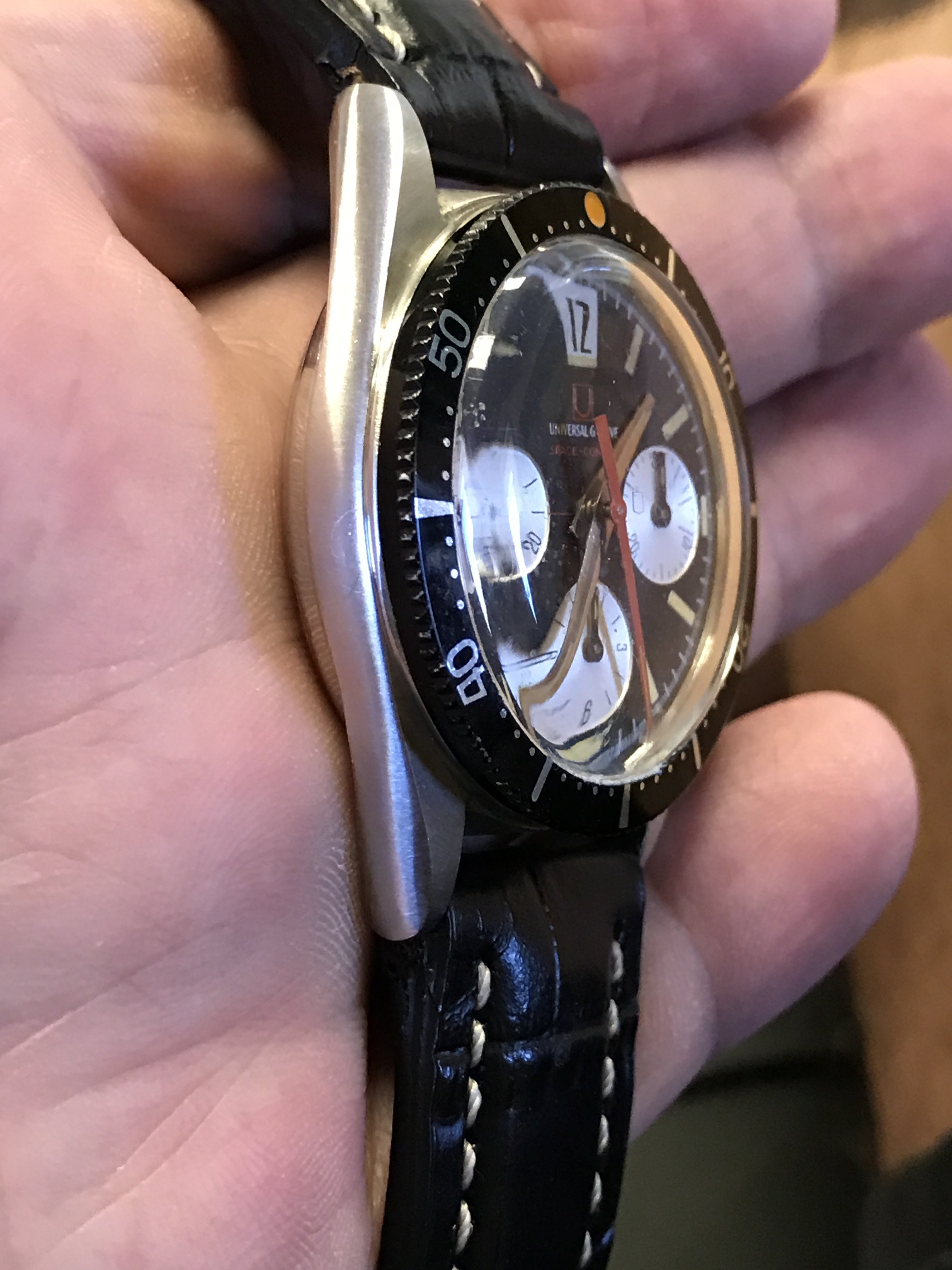

    Agree. That may not be an original UG caliber 85 movement and there are some differences ...
    caliber 85
    Apart from that important point and the fact that the crown (looks like) does not screw in and the case looks like it has been polished, it is nice. I see you have the original crystal which is a big bonus. Pity about the movement ! What is the serial and reference numbers on the case back ?

    Yeah, lack of a signed bridge jumped out to me right away. I haven't ever seen a UG Valjoux 72 that wasn't signed with the internal caliber at the base (85, in this case) and "Universal Geneve" across the top of the bridge.
