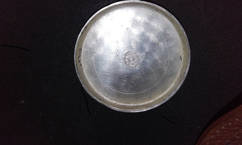

No serial number which is odd. The consensus is that it utilises an Omega pocket watch movement dating from around 1915. The maker of the case is unknown; "Omega- Swiss Made- Fabrication Suisse" appears on the inside of the caseback.
As I said before, I am an enthusiast rather than an expert. I love this watch for its patina, size, and age. It would not surprise me at all to find that it is a bitsa of the first order, and my love would not be diminished if I did. You really do have to see it in the flesh to appreciate its presence.

The case style speaks to me of the 1940s, maybe a bit earlier so my suggestion is that this was a pocket watch movement converted to a wristwatch, either by the original owner or done to order. The caseback is also marked with an Omega symbol, unless we can get a good clear picture it's only conjecture that it's a genuine Omega case or one made by a proper casemaker.

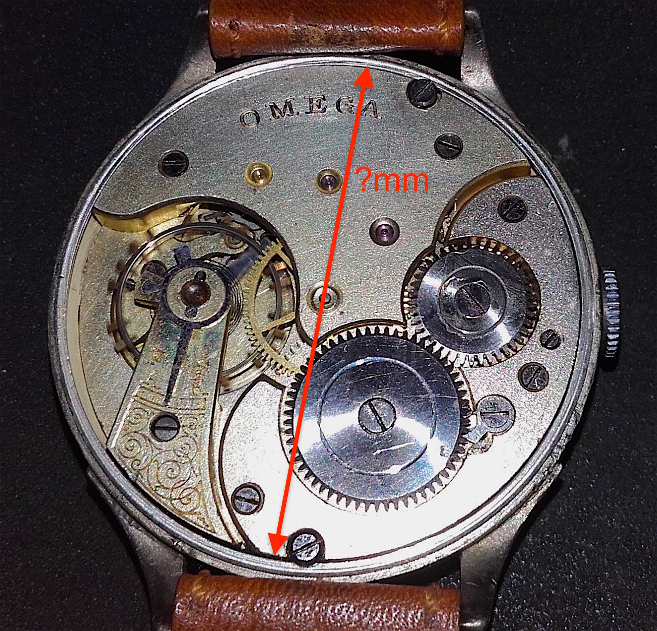

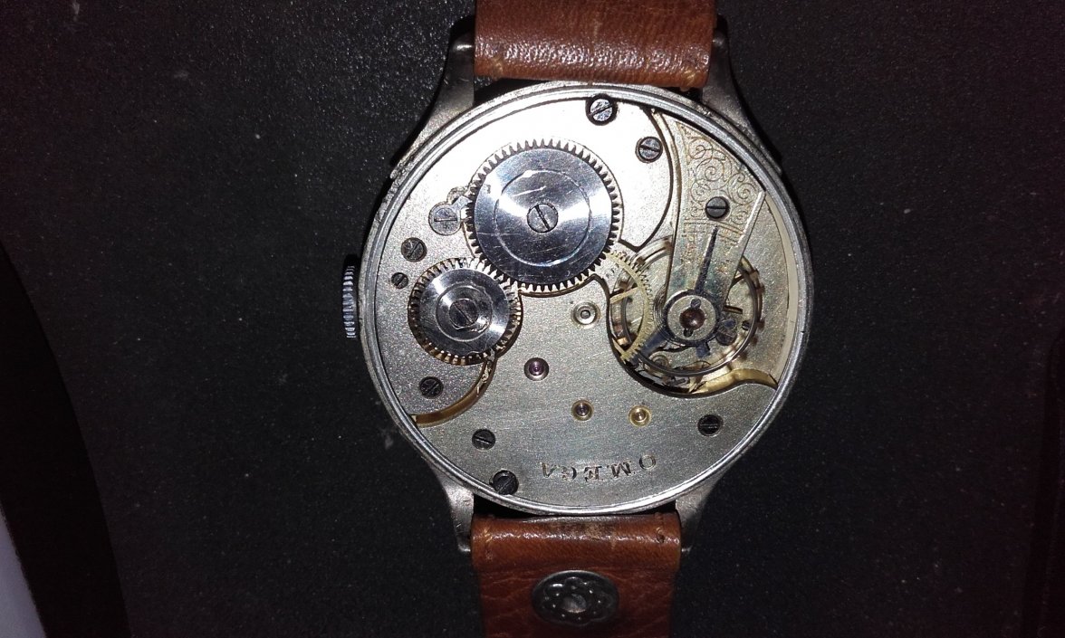

As to the movement, I think it's a Caliber 15''' S 7P :
15''' meaning a diameter of 15 lignes (34.6mm).
S meaning Savonette, the stem is at 3, unlike a Lépine, where the stem is at 12.
7P meaning 7 Pierres (stones) or 7 Jewels.
The movement may date from the late 1890s or so. As no serial number is visible on the movement, it will probably be on the plate under the dial.
As to the dial, I think that has been re-finished but is original to the watch, as are the Omega "Empire" style blued steel hands.

PS: What is the diameter of the movement?

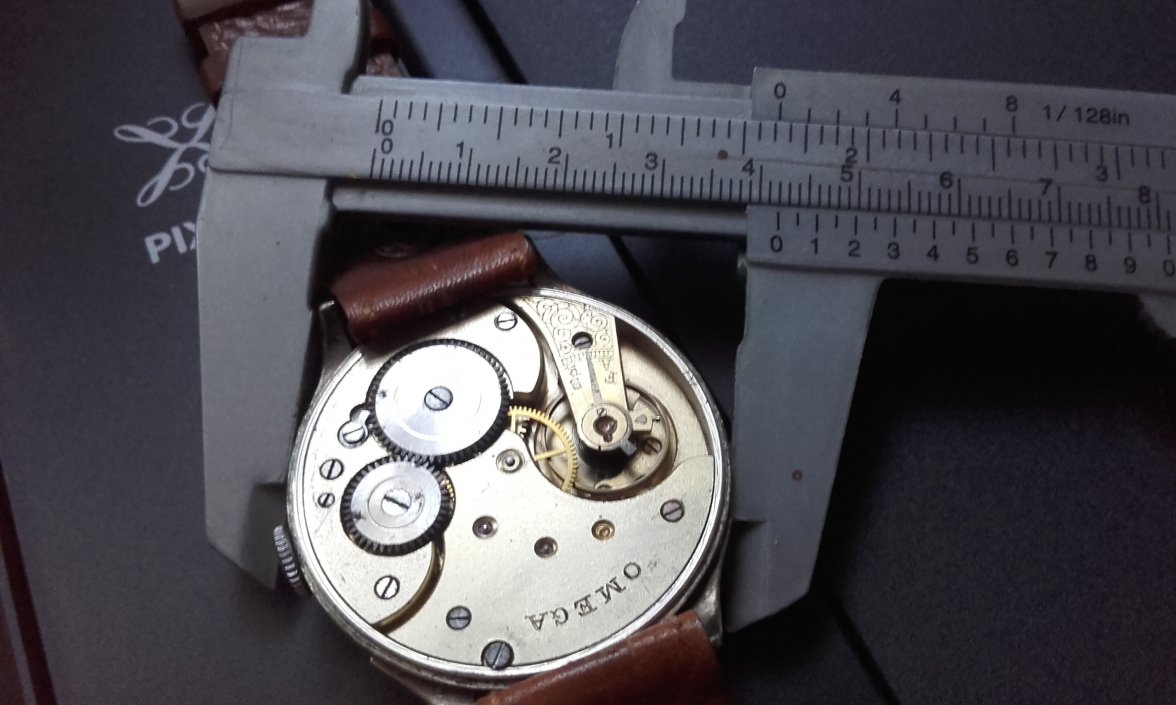

I would love to learn more about this little beauty. I agree with your estimate of case age; I deal with car instruments of similar construction, and have a feeling this is pre-WWII at the newest. It is not stainless steel; silver plate is my best guess, or maybe nickel plate.
Best I can do with your requests; the size should be spot-on at 38mmish (37.5?) as the callipers were almost a pound!

A suitably experienced watchmaker is helping me with a forensic strip service and repair.
The serial number was found lurking under the dial; it is 3213991, which he thinks dates it to 1906.
