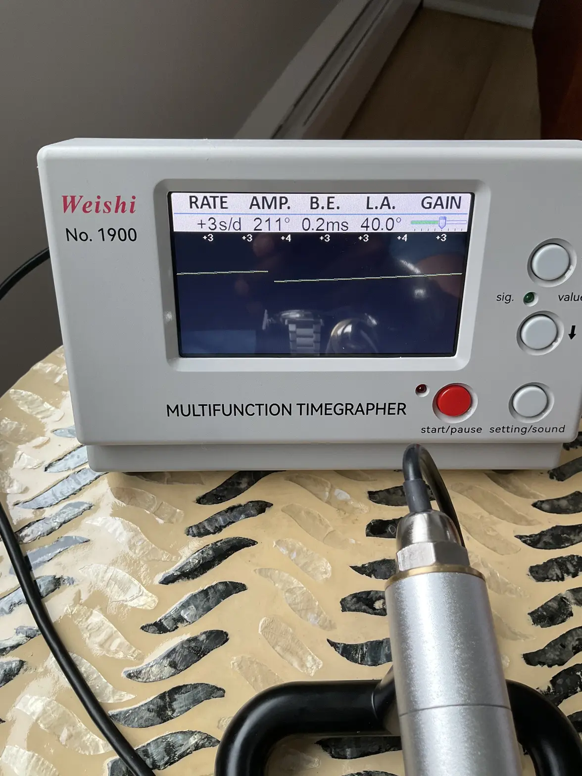

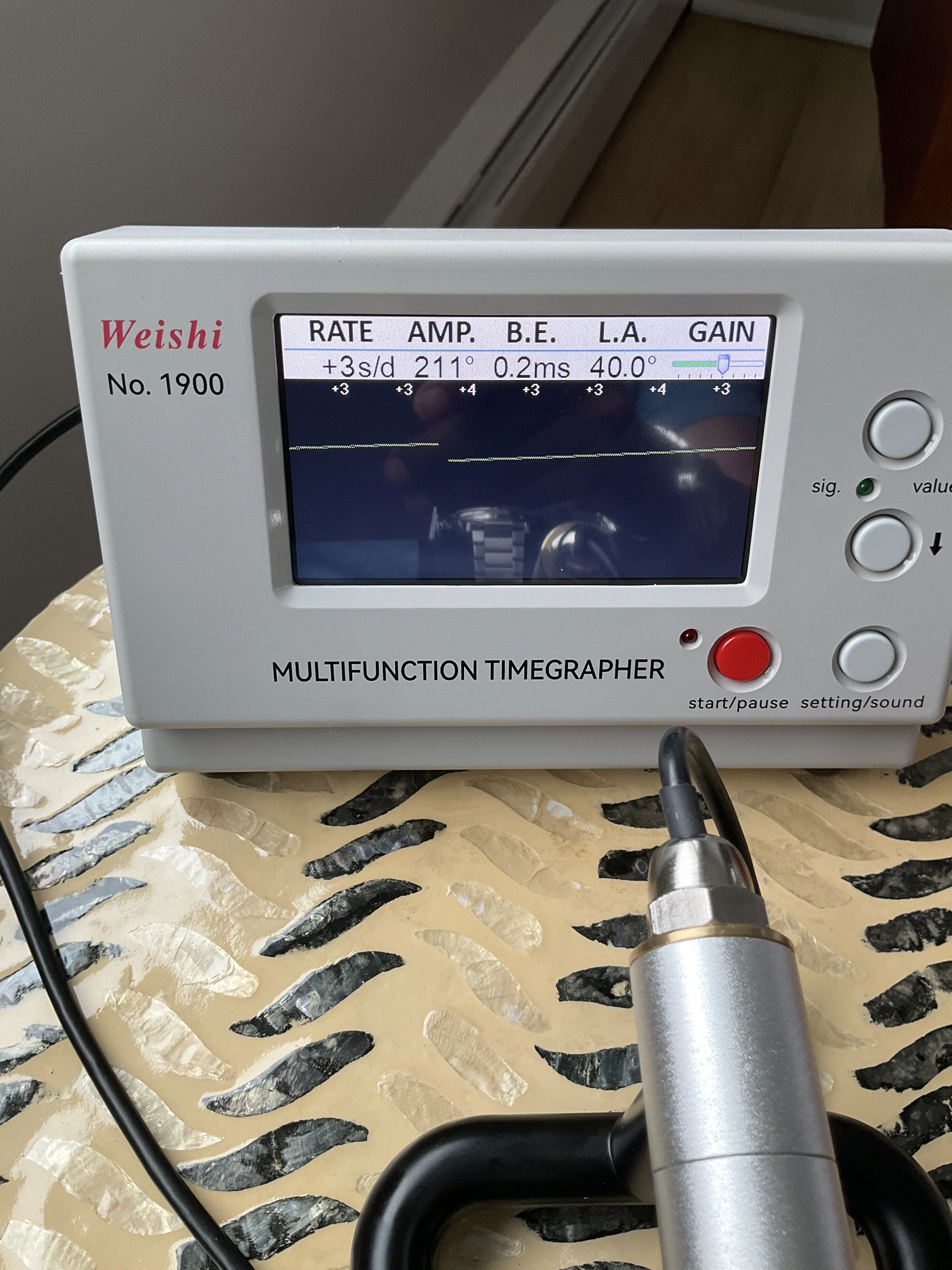

I am using my Weishi 1900 timegrapher and I noticed that the amplitudes for both watches fully wound hover around 210 degrees. Is this normal? Can the Weishi calculate a coaxial movement properly? I read that the amplitudes for both are in the 240 to 260 degree range fully wound without the chronograph running. I am using a 40 degree lift angle for my Ed White and a 36 degree lift angle for my Silver Snoopy. Beat error and +/- seconds are running within specs. Do I need to go to the OB for repair consideration?

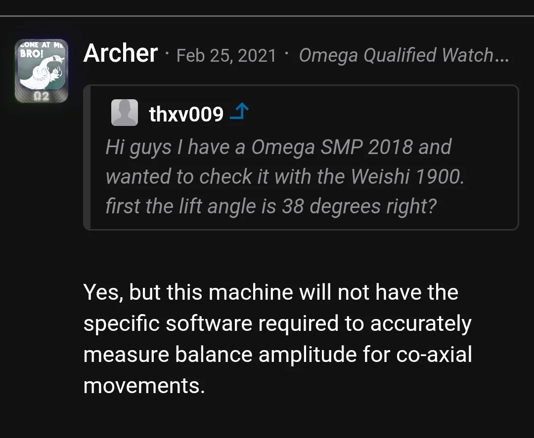

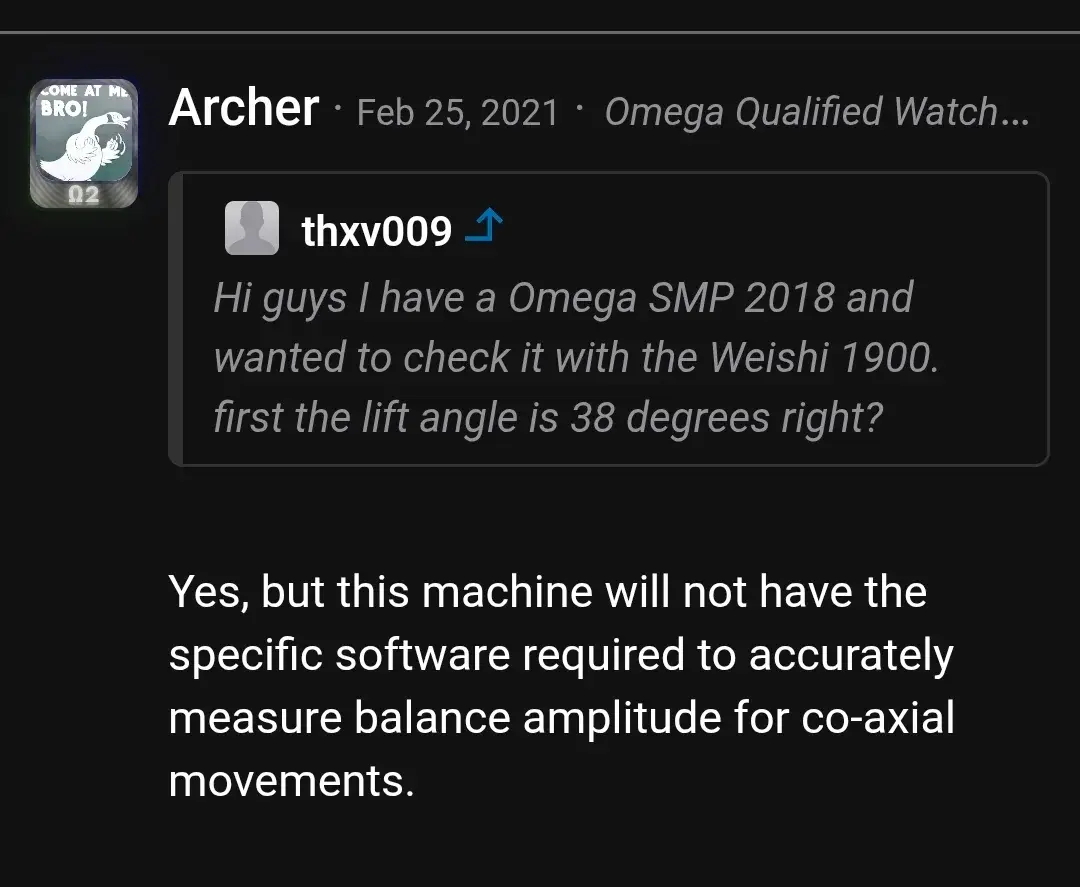

For the Snoopy the W1900 can not correctly measure the amplitude:

Hi:

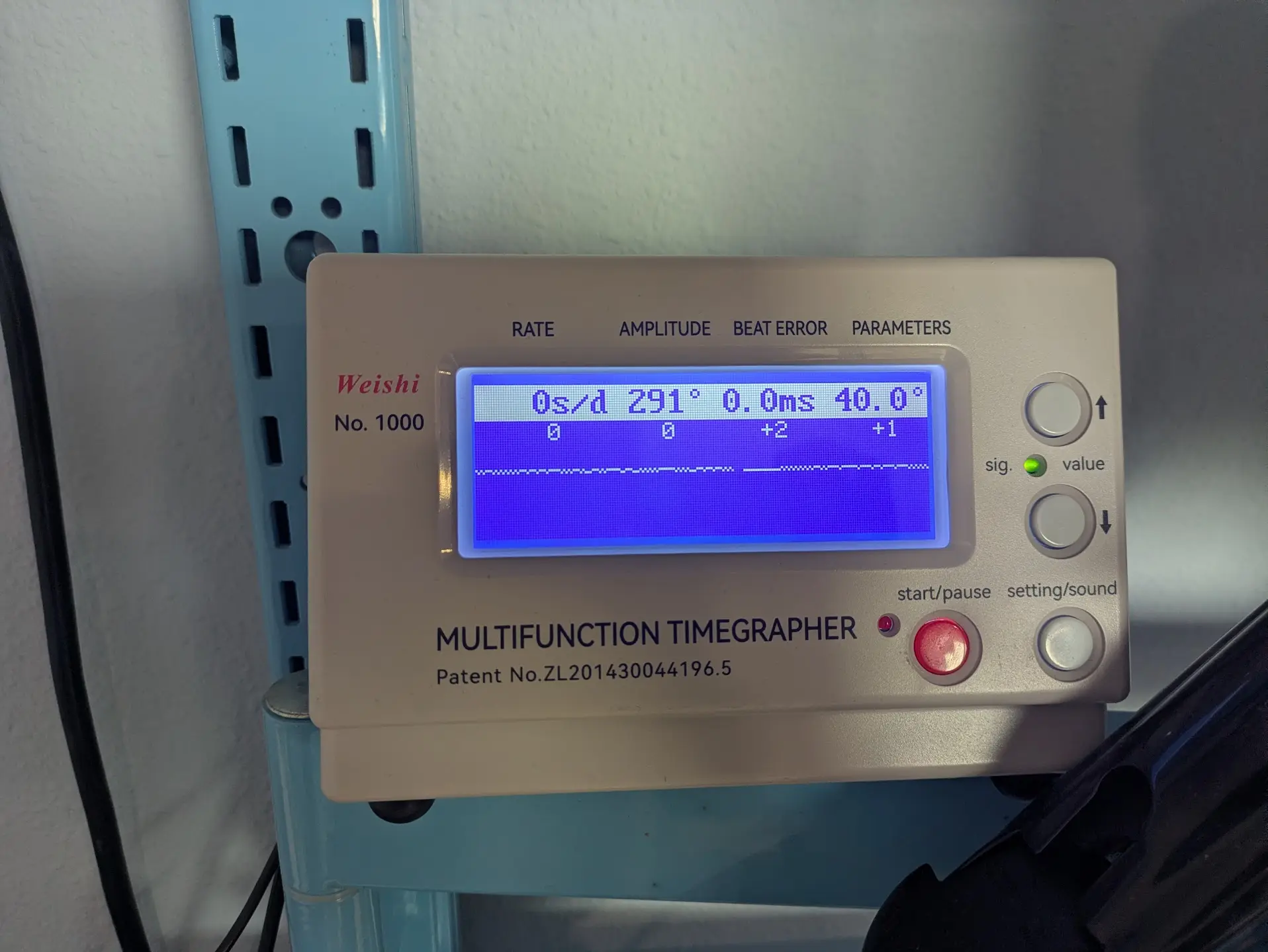

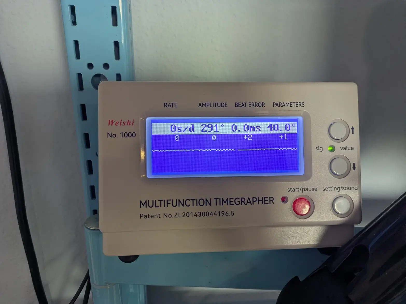

Here is my Ed White (modern) with a few winds, so not nearly full wind. Maybe 15 or so winds? Amp was ~280-290 for a few minutes.

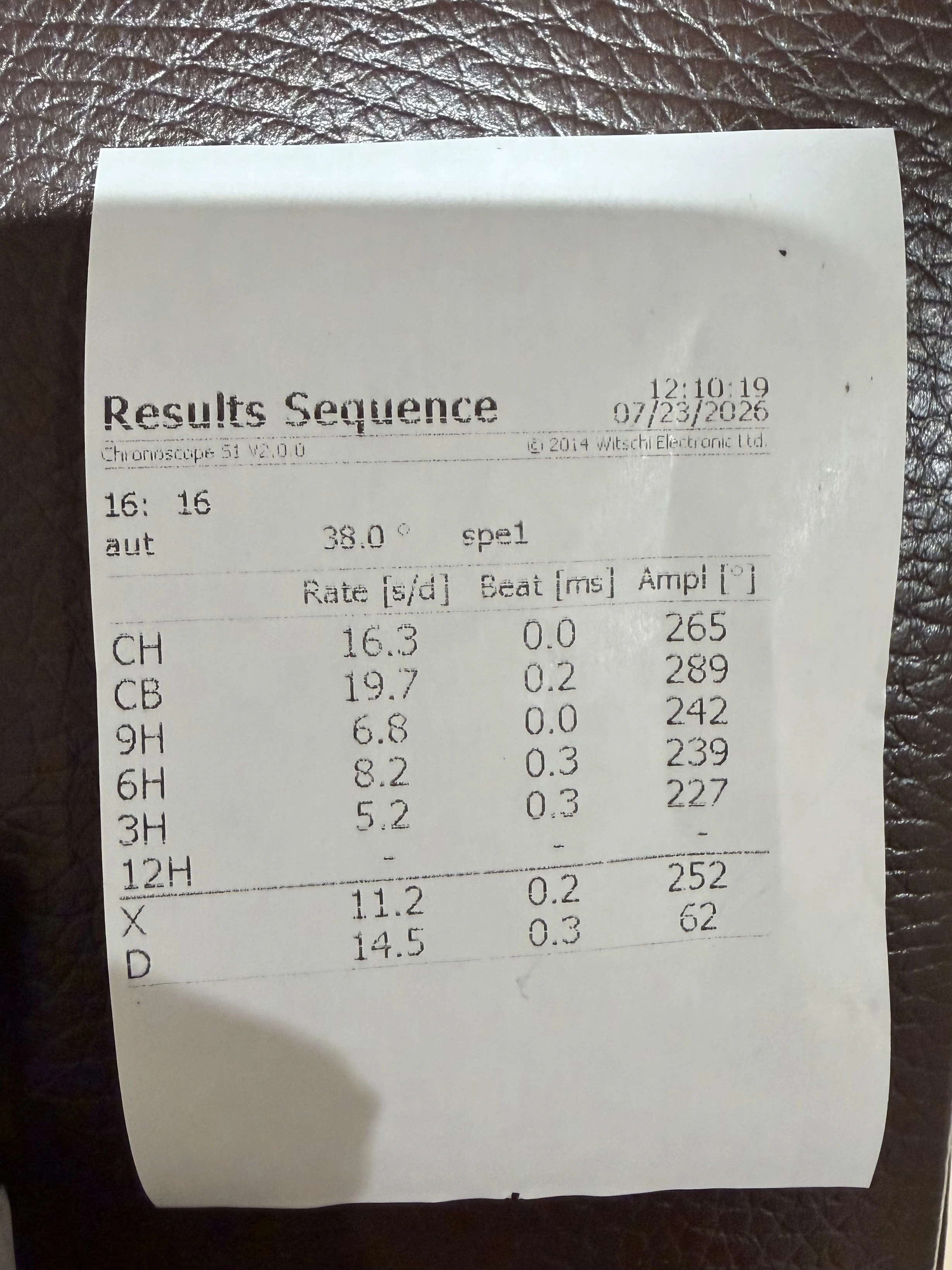

Here are my results after a full wind. I purchased my Ed White from an OB in March 2026.
I will go to my local OB for a prognosis.
However, think I may have to send it back to Bienne/Biel for adjustment.
I personally would bring that in for a service too, particularly only a 4 month old one. I'm not sure what they'll tell you at the OB (a GOOD OB would trust you/look at the pic/send it in), but I'm sure the Omega watchmaker who gets it would be equally discomforted by that number/fix it for you.
When mine went back, it was ~3 months or so, so expect to live without it for a while. Hope you have plenty of others to keep you company 😁

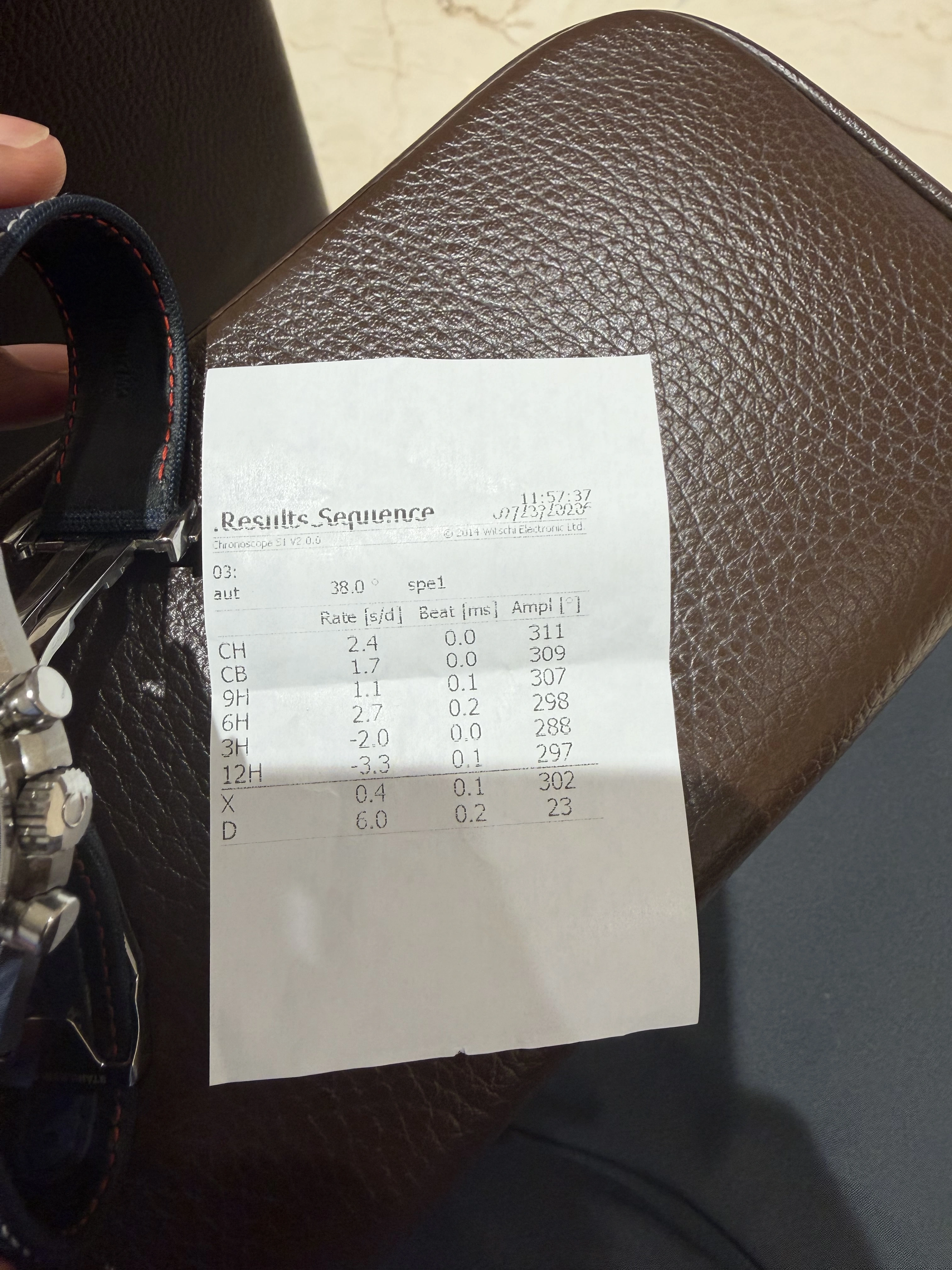

Thanks for the confirmation. It looks like I will have to go to the OB and have it shipped out to Bielle tomorrow. Sad day, I'll be without the Ed White and possibly the Silver Snoopy for a few months.

Are you using a 40 degree lift angle? Thanks for the help. Do you use a Weishi 1000 or 1900 Timegrapher?
Yes, 40 degree lift angle, Weishi 1900. Amplitude just over 290 after settled in for twenty minutes or so after a full wind.
210 amplitude does seem a little low, as you’ve mentioned it is worthwhile taking it in to OB.

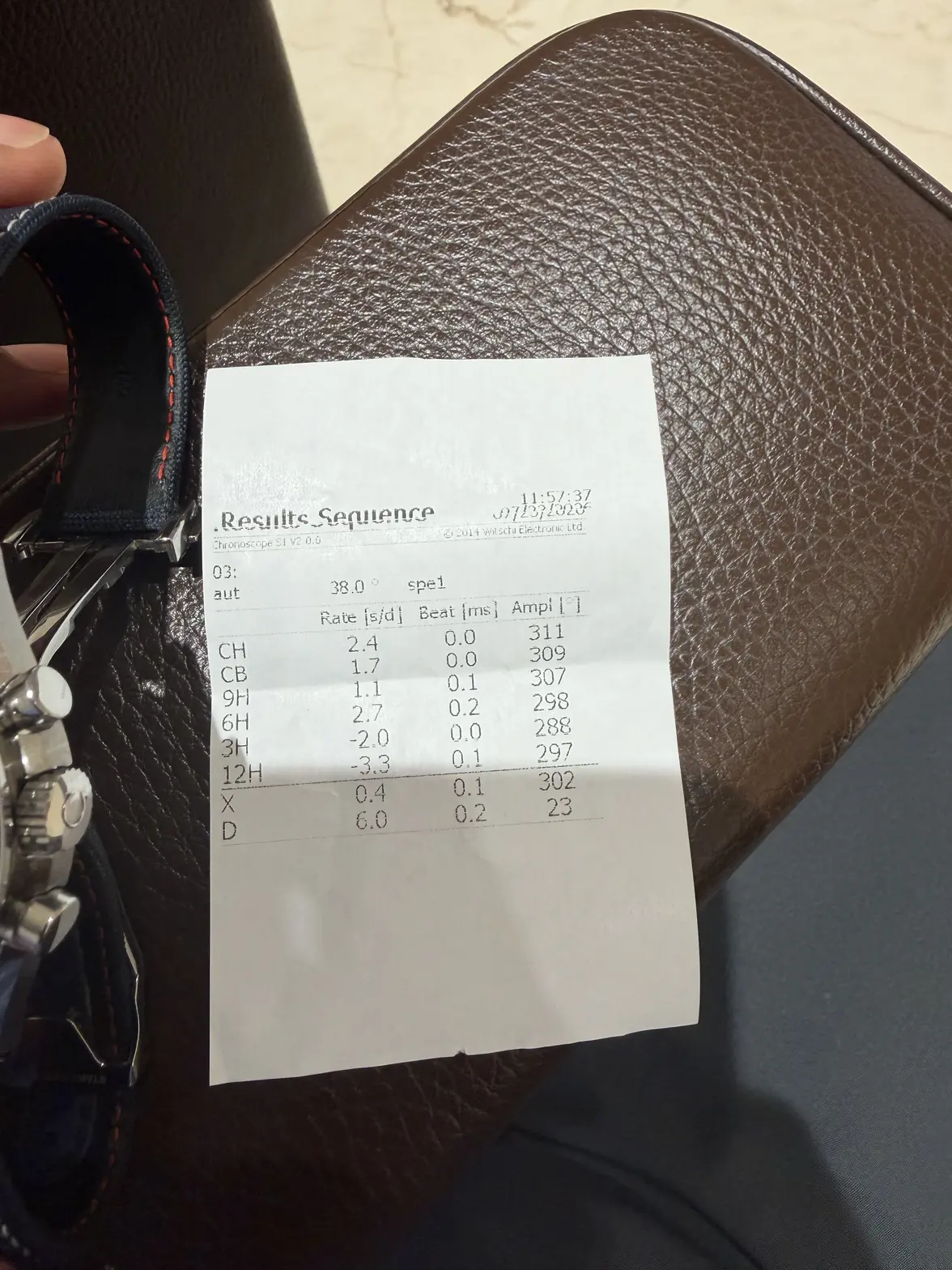

Here are the results for my Ed White. Apart from the incorrect lift angle which should be 40 degrees instead of 38. Degrees, it seems like it should be sent back to Biel. However Omega NY on Fifth Avenue said it was oaky. What do you think? Like a medical prognosis should I get a 2nd opinion.

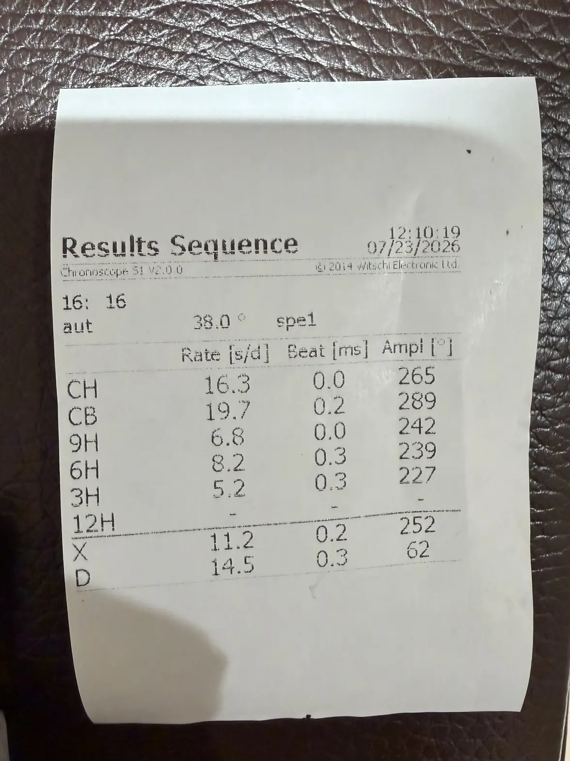

Here are my results for the Silver Snoopy. The lift angle is wrong again, should be 36 degrees instead of 38 degrees. Is the 2 degree difference okay or should I get another opinion.

Others will chime in who know much more about the nuances here than I. But from a general perspective: the 321 results, to my eye, are close enough to beg the question as to whether it’s worth it to tear into the watch for a minor improvement. Just a thought…
