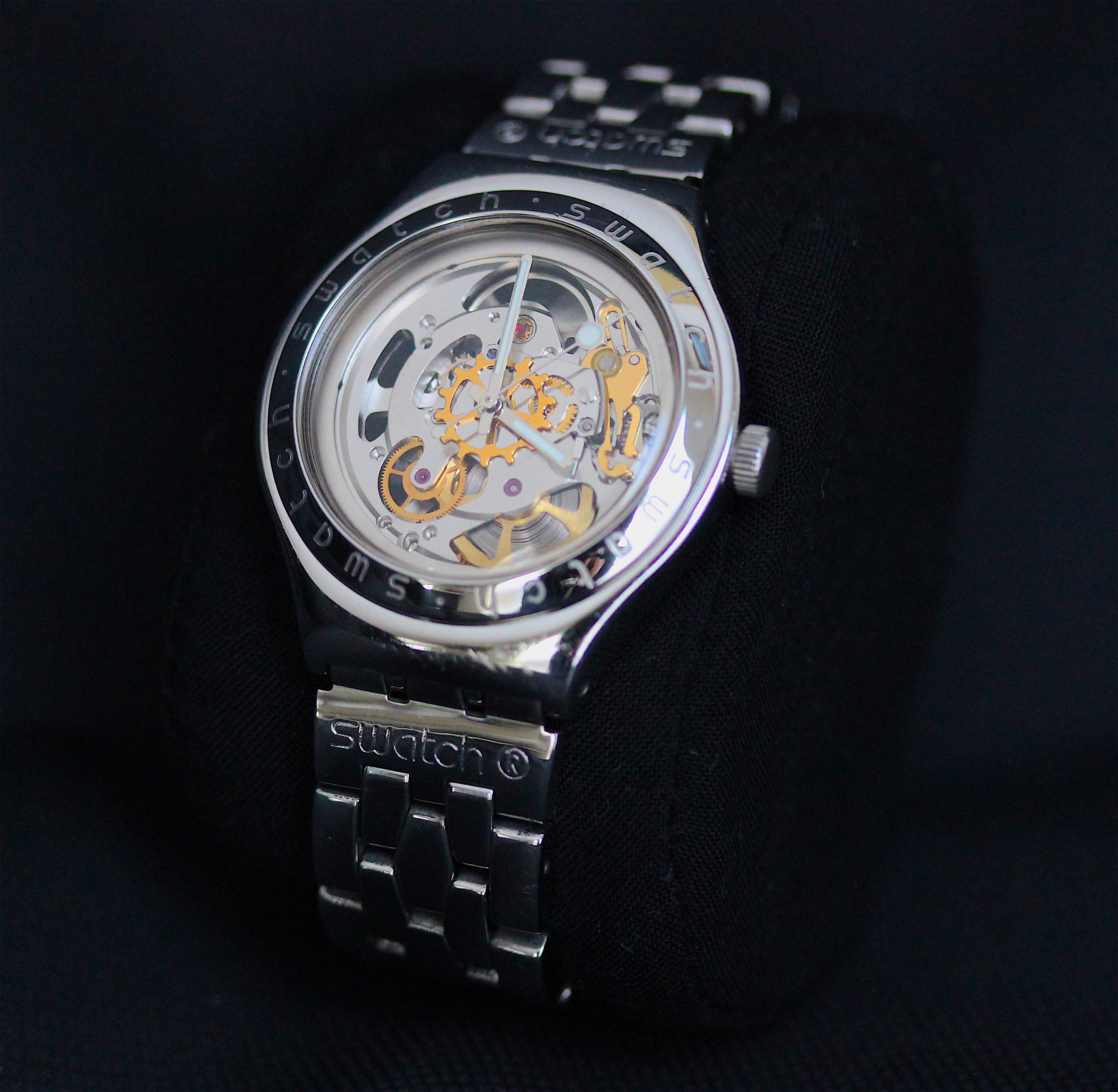

The Swatch Irony Body and Soul has been in production for nearly 10 years now - the ETA 2841 is (or certainly was) a Swatch internal specific variant of the 2824-2 - Heavily modified and made at very low cost.

Plastic components in an otherwise unrepairable watch such as the subject Swatch, or a Tissot System 51 model, are only one of many reasons such watches are not repairable. It seems manufacturers of these kinds of products are only concerned that the item last for the period of the warranty, but such items seemingly are designed to self-destruct any time thereafter. And I suspect that any of such watches as might go back with a warranty problem, would be replaced rather than repaired. When I think of it, this is not a recent phenomenon. It pre-dates plastic escapements. Progress!

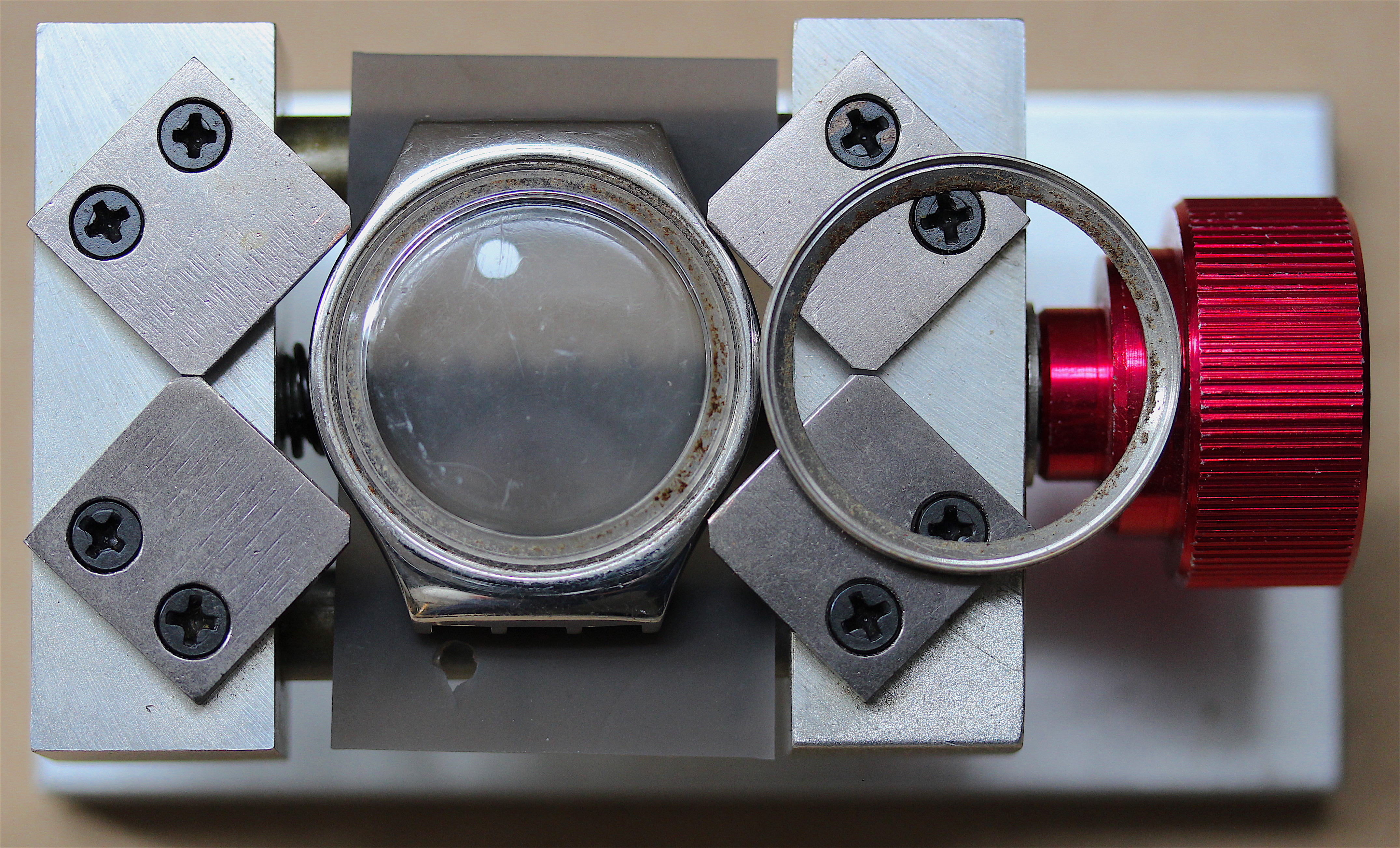

My neighbour Sean bought one of them across to me the other day as it had stopped working. He'd taken it to a local jeweller and was told it's a non-serviceable watch as the case is sealed at the factory and trying to open it would damage the watch. He also did some internet investigation and concluded the same thing so he gave it to me and said I could have it if it was any use.
On inspecting the clear caseback, I could see that there was an edge above the case where a crystal remover could get a purchase but I couldn't get my Omega 105 or a claw lift to grip properly so it was off to the bench vice and a wood chisel with a polished blade. Using gentle pressure and working around the edge I was able to remove the rear crystal, exposing a nice looking movement.
The story of these being "throw-away" doesn't make sense to me based on the movement. For a start it has a detent point to allow stem removal, the plastic movement ring has an OPEN arrow showing where to move the ring for movement removal, and the movement isn't cheap crap. A five ball rotor bearing? all pivots jewelled? This movement was meant to be repairable!
Anyway, after I lifted off the auto mechanism I tickled the balance with a puff of air, it would only move a few degrees CW and then back to a stop point. I've seen this behaviour before when installing balances where the roller has got on the wrong side of the horns so it was off with the balance assembly. All perfectly normal and no indication of disposable parts.
I suspect the watch may have been dropped or jarred at some time and the lever flipped back just as the roller was at full rotation.
Now I could get a close look at the lever, the little blue plastic thing. No horns, just a slot in the end for the roller to ride in. No pallet jewels, just an extension of the plastic arms.
With nothing obviously amiss I moved the lever to the right bank and dropped in the balance assy and got that first feeling of satisfaction every watchmaker gets when the balance just starts spinning away.
So now I have a Swatch Irony ticking away on the bench.
Time to de-gunk and clean up the case, polish the crystal, US the bracelet, put it all back together and give it back to Sean to enjoy for another ten years.
