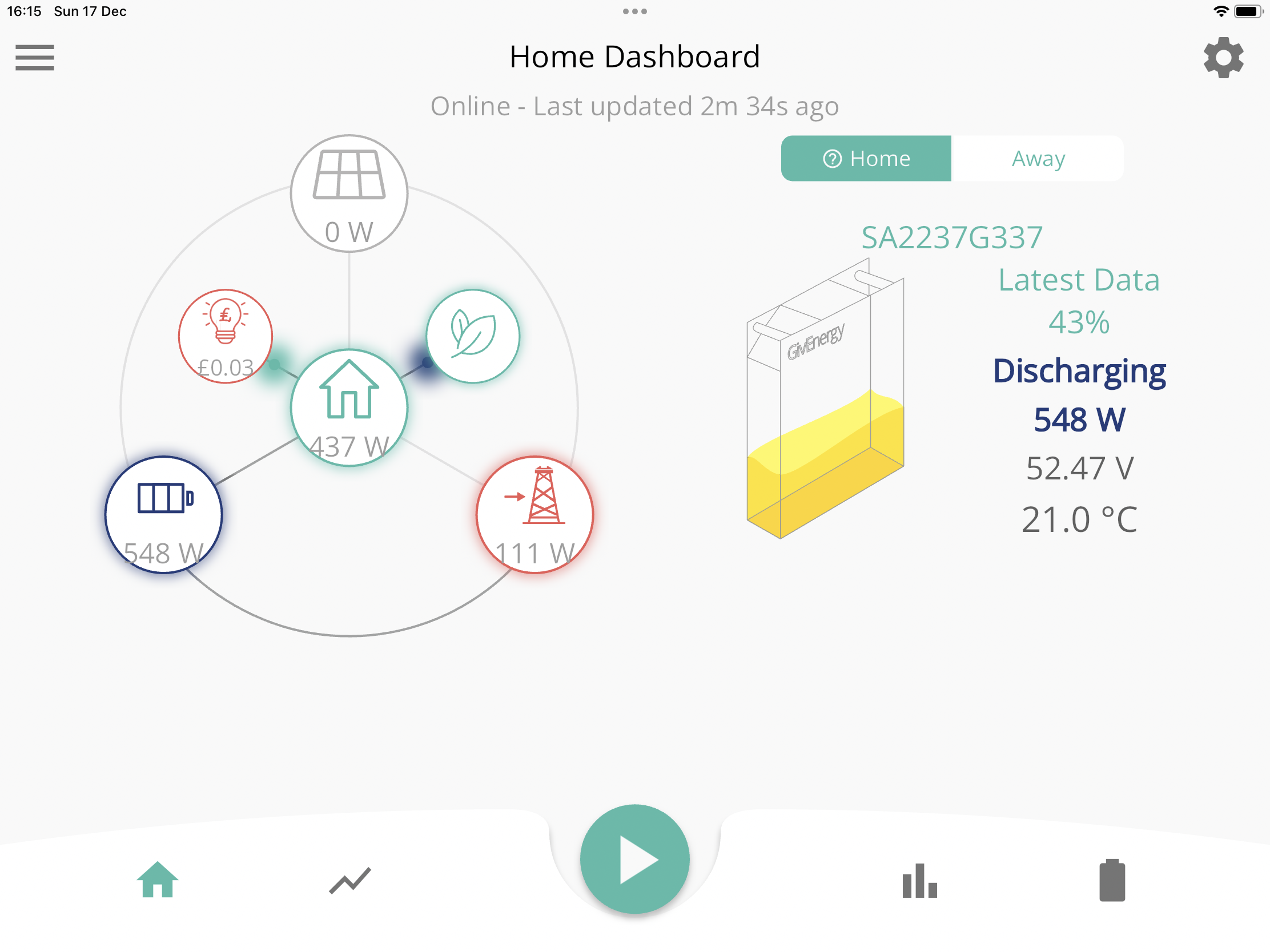

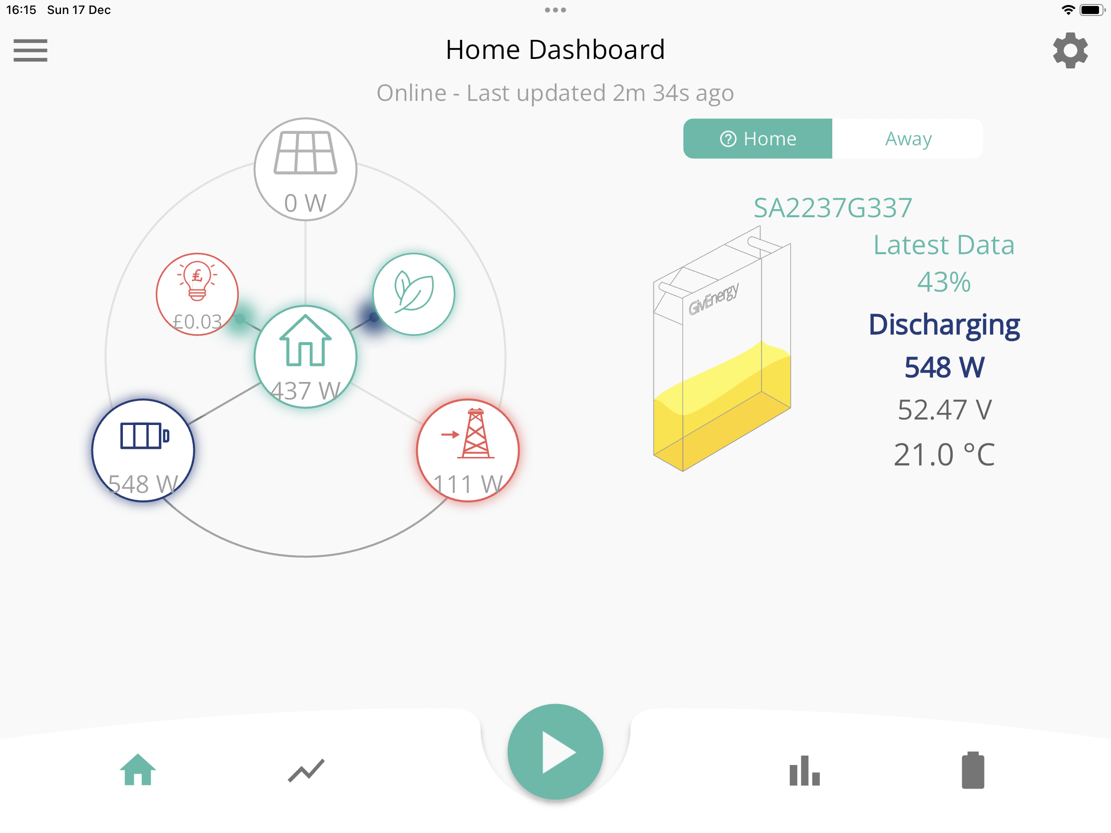

I am on a TOU Tariff (time of use) buy to charge my batteries at night cheap, and/or if the sun don’t shine (all winter! although I do still get some on cloudy days) then use a combination of battery and grid to run the house. In summer feed back to the grid for credit.
This is what is happening now ….

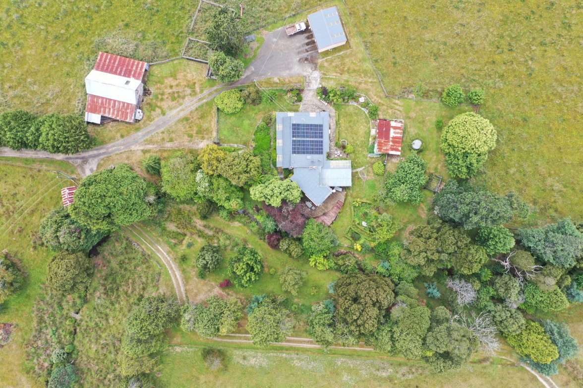

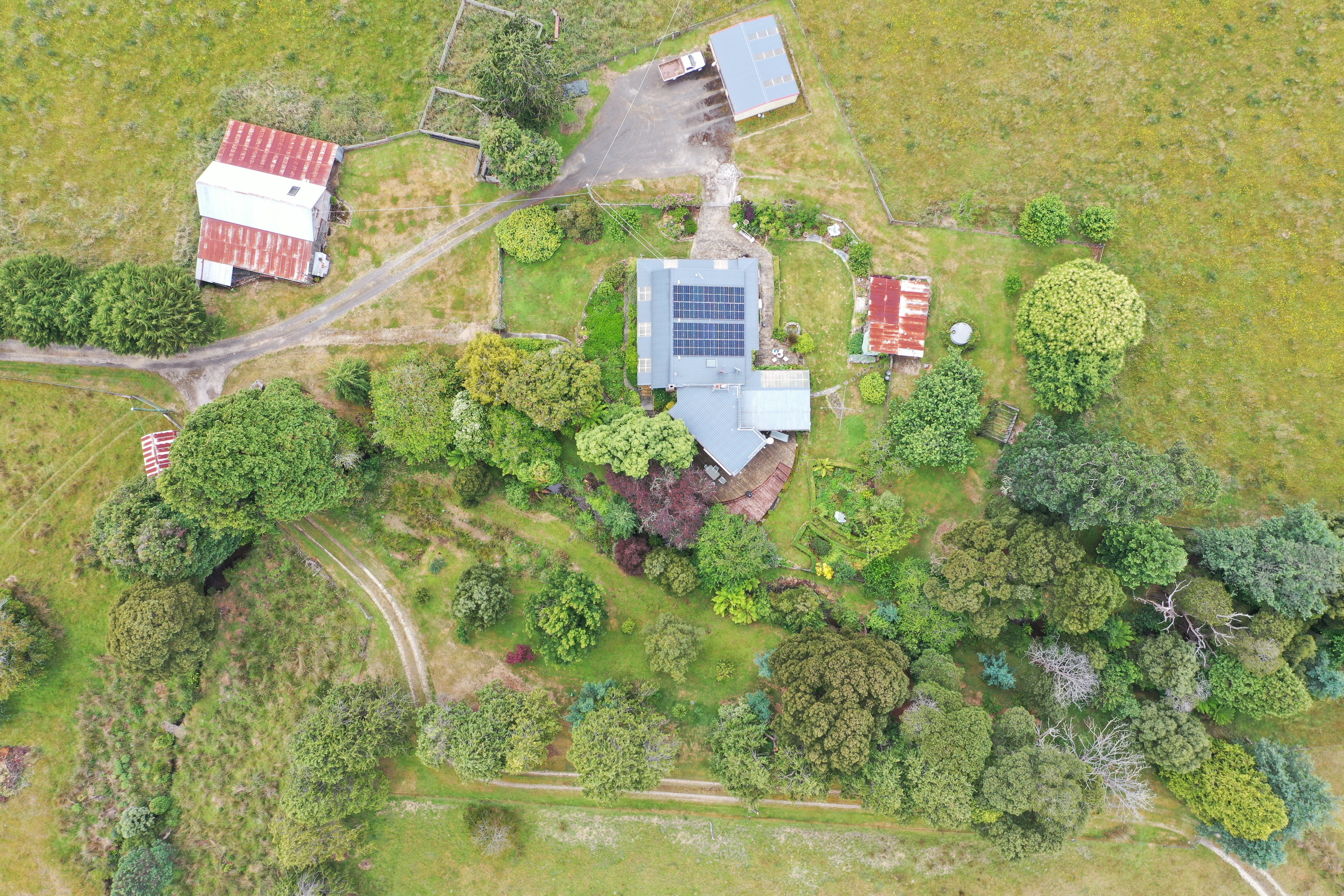

Ya, I was just thinking of the ability to run your house in a blackout. When the house was built it was connected to all utilities owners added electric generators and storage when they moved in. So I’m not talking about living wild and catching your food just energy. It’s quite a set up but it’s in the garage and behind the house besides the visible panels I took a picture of. I figured it’s a little weird to take too many photos
edit also only the wife was home (don’t ask) so the info I got from her about the system may not be 100% correct as the husband owns a pretty big electrician company that covers the state and gets state contracts so he could tell me more

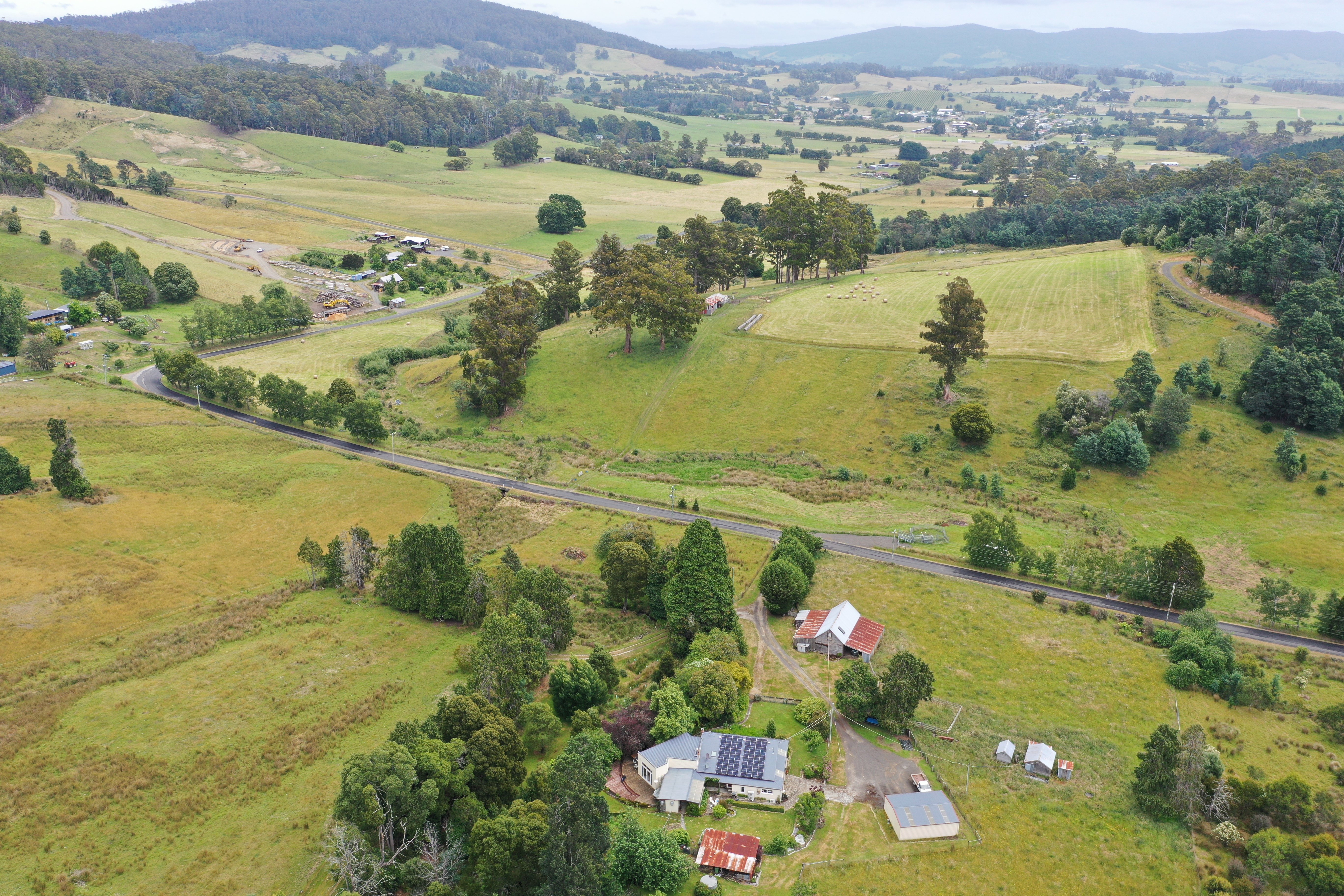

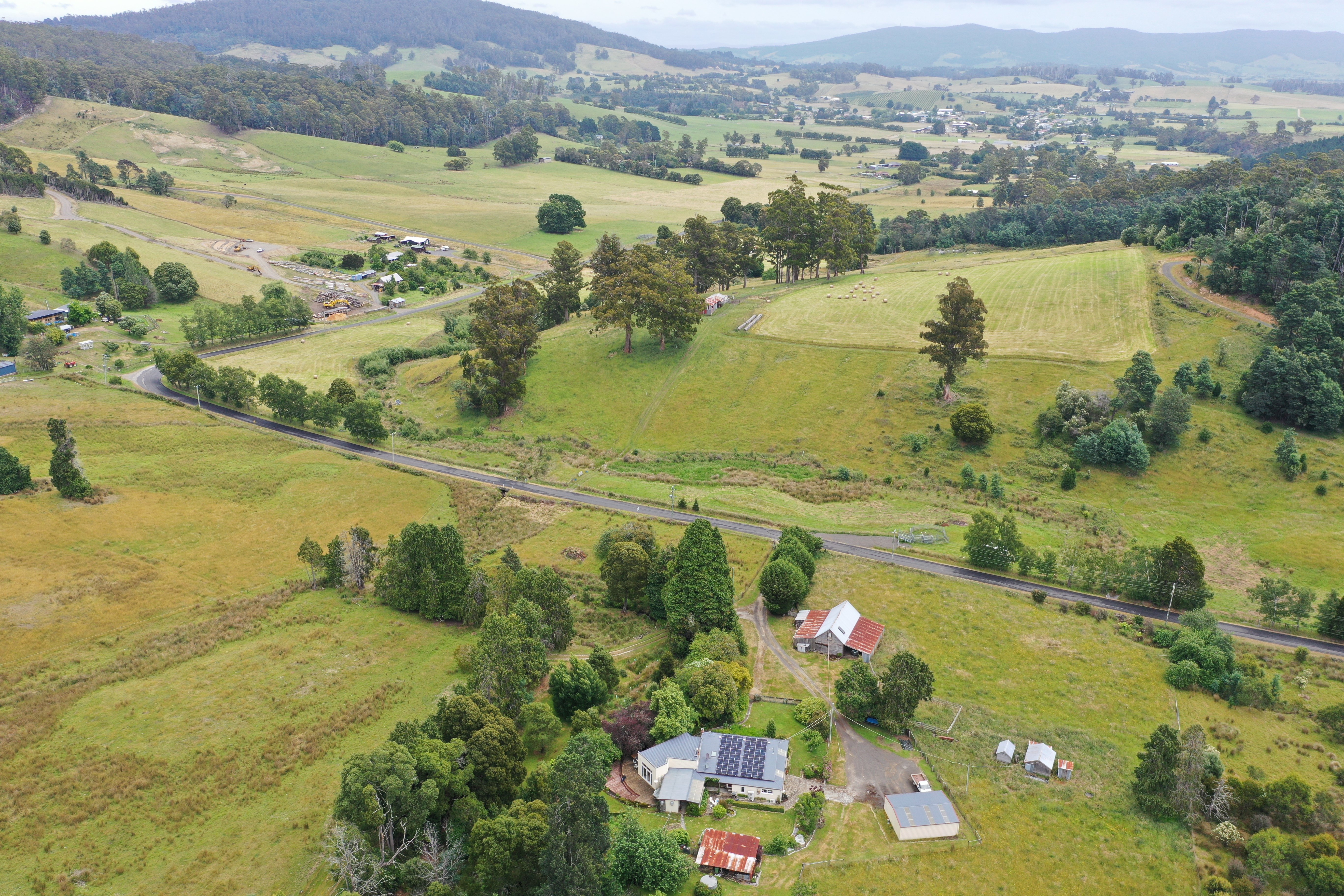

We're on grid only to dispose of excess power and to survive a couple of dark months in the depth of winter. We have an 11 kW solar array and a 13.5kWh Tesla Powerwall 2 battery, we have our own water supply from a reliable year round mountain spring fed creek. Other than a bit of grid power in the winter our only imported energy is gas from cylinders for cooking. Not only have we scrapped power bills, but being in the country, and on a dead-end branch line, our grid supply is unreliable especially during dodgy weather and power outages for us are now a thing of the past.

In the interim there is a large shed which needs to be built out at the farm and it's not cost effective to grid connect it from where the (SWER) power runs into the property. It may well become the first building on the property that's a stand alone off grid scenario but I don't envisage it having much of a w/shop unless I can feed a big enough 3 phase inverter but I would be hesitant to run a high quality welder off it and certainly not my 3 phase pulse GMAW. The inverter AC/DC stick welder is supposedly rated to run off a generator and I understand the US navy has them as standard equipment for shipboard use at a pinch for emergency repairs so that's going to be OK.
I have a 3 phase diesel generator to supply all the big stuff in the shed, it’s a bloody side cheaper than having 3 phase connected, only need to run it when using the big lathe, milling machine, surface grinder, balancer and the bigger welders. Oh and I forgot the serious pizza oven.
It’s also a handy power backup for power outages.
Such a set up would probably work for you too
