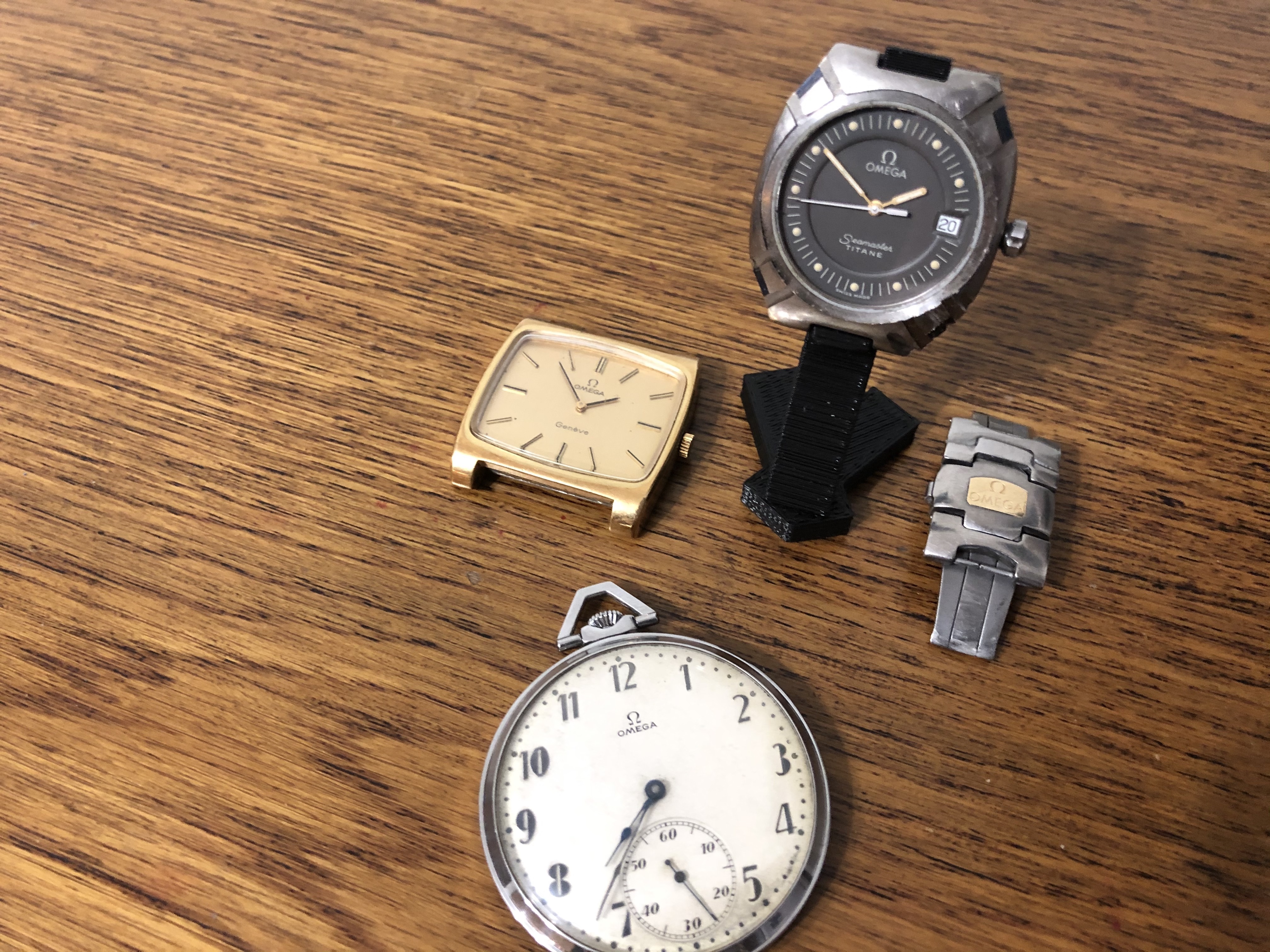

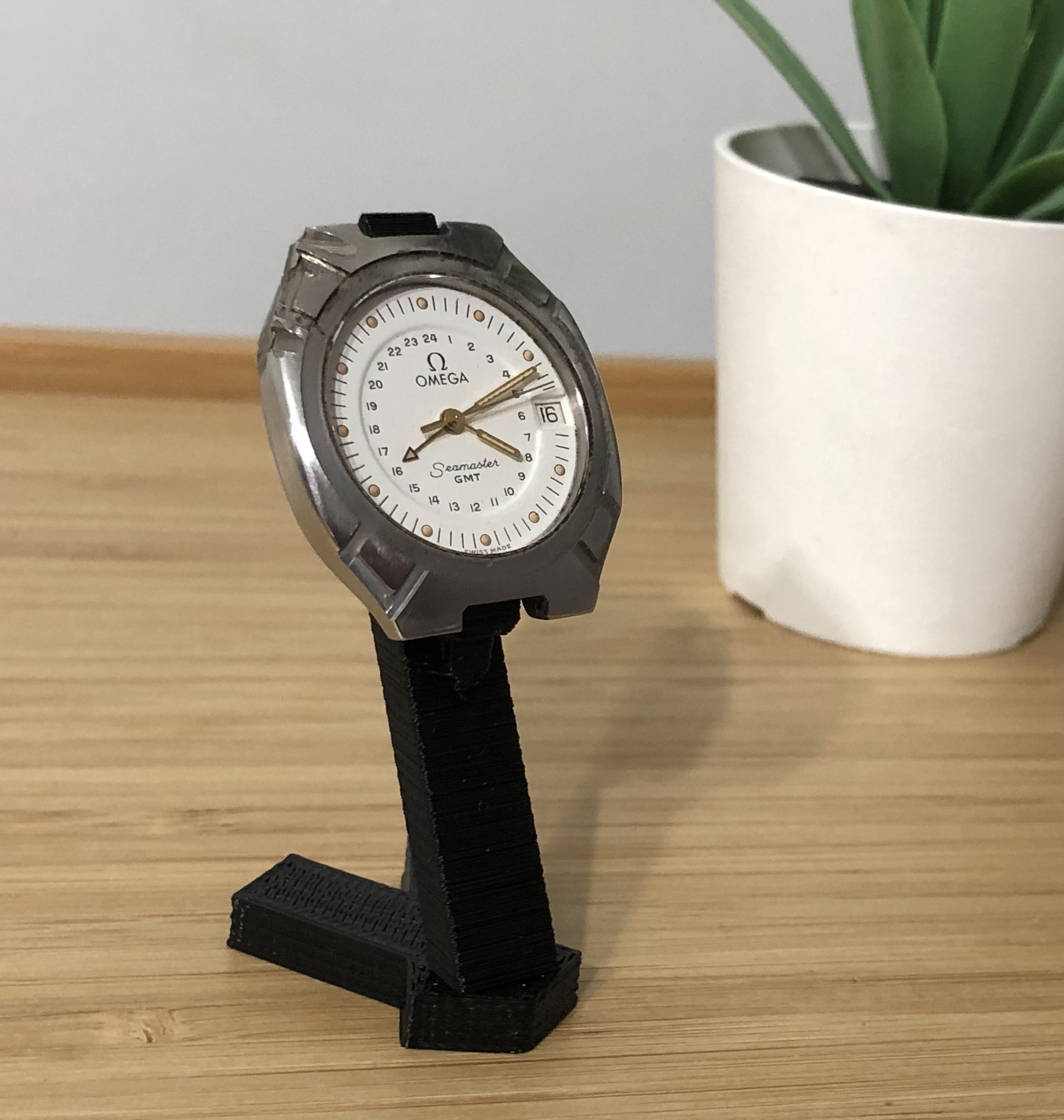

So some time ago I bought 2 abused Quartz Titane's - one had a GMT 1449 movement, the other had a 1432 movement
The 1432 Titane was luckily in good shape, but it wasn't ticking, the 1449 GMT was a goner, but it funnily ticked despite the water damage

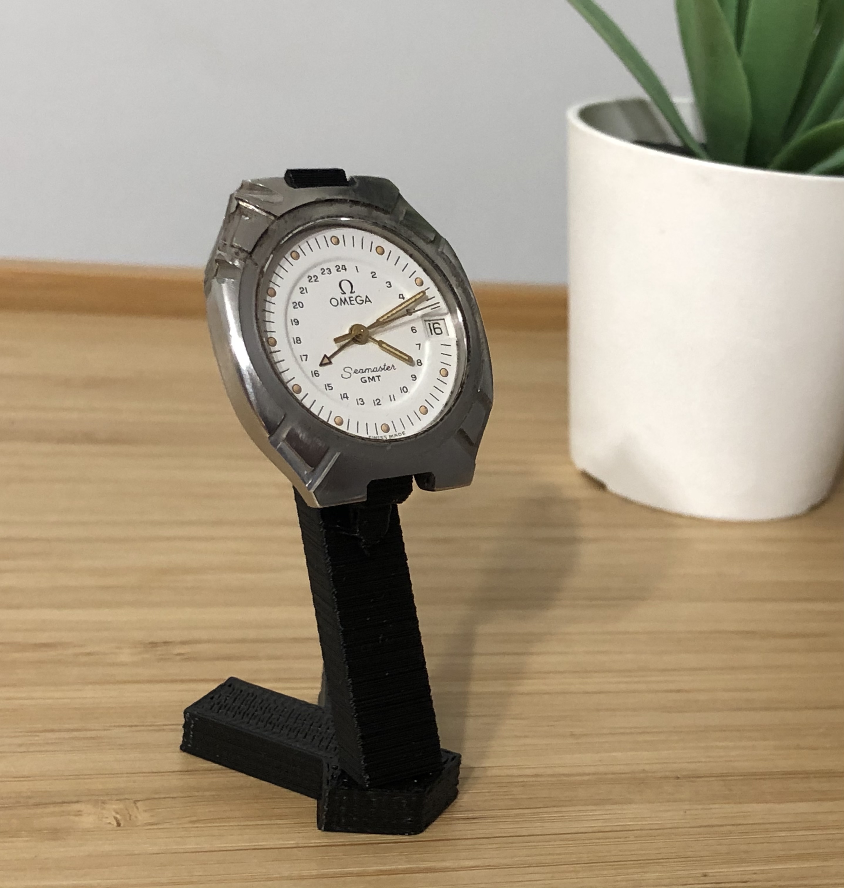

I converted them to decorative but non-working desk pieces:
I received this watch today, another gamble:

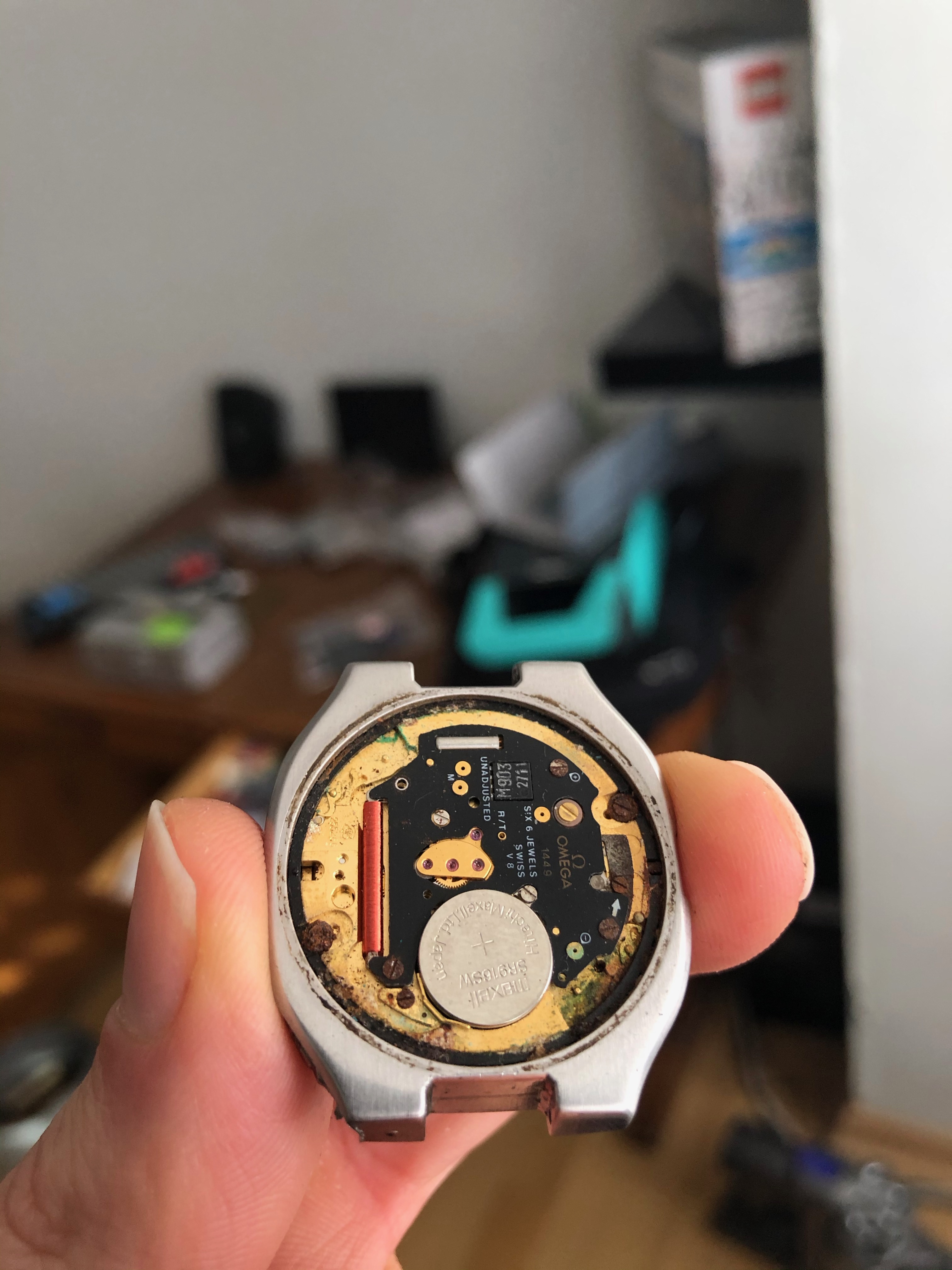

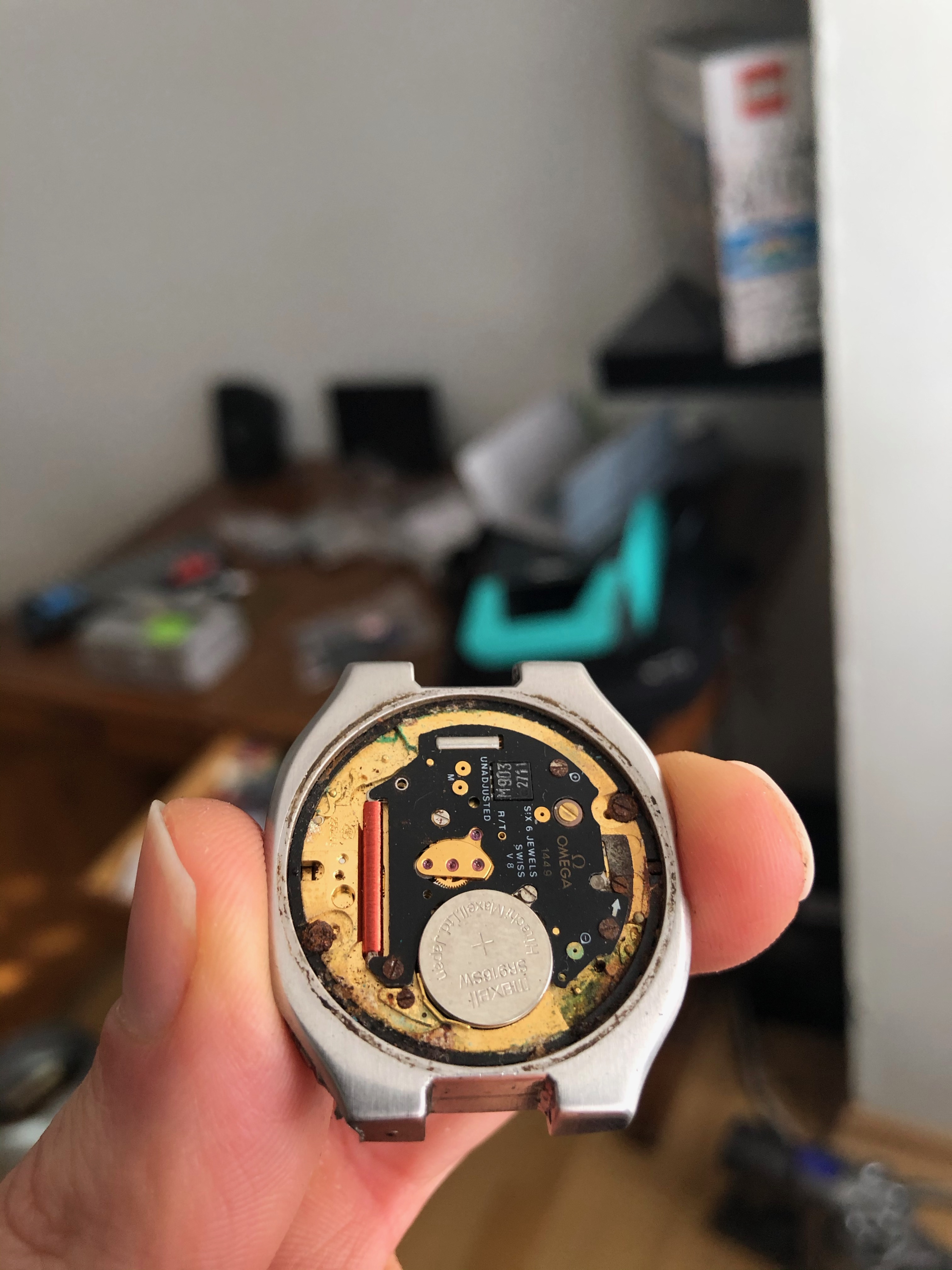

I realised it has a 1430 movement, and it was luckily working - I didn't like the watch, so I had the idea of swapping the movement with my 1432 Titane that was supposed to be a desk watch

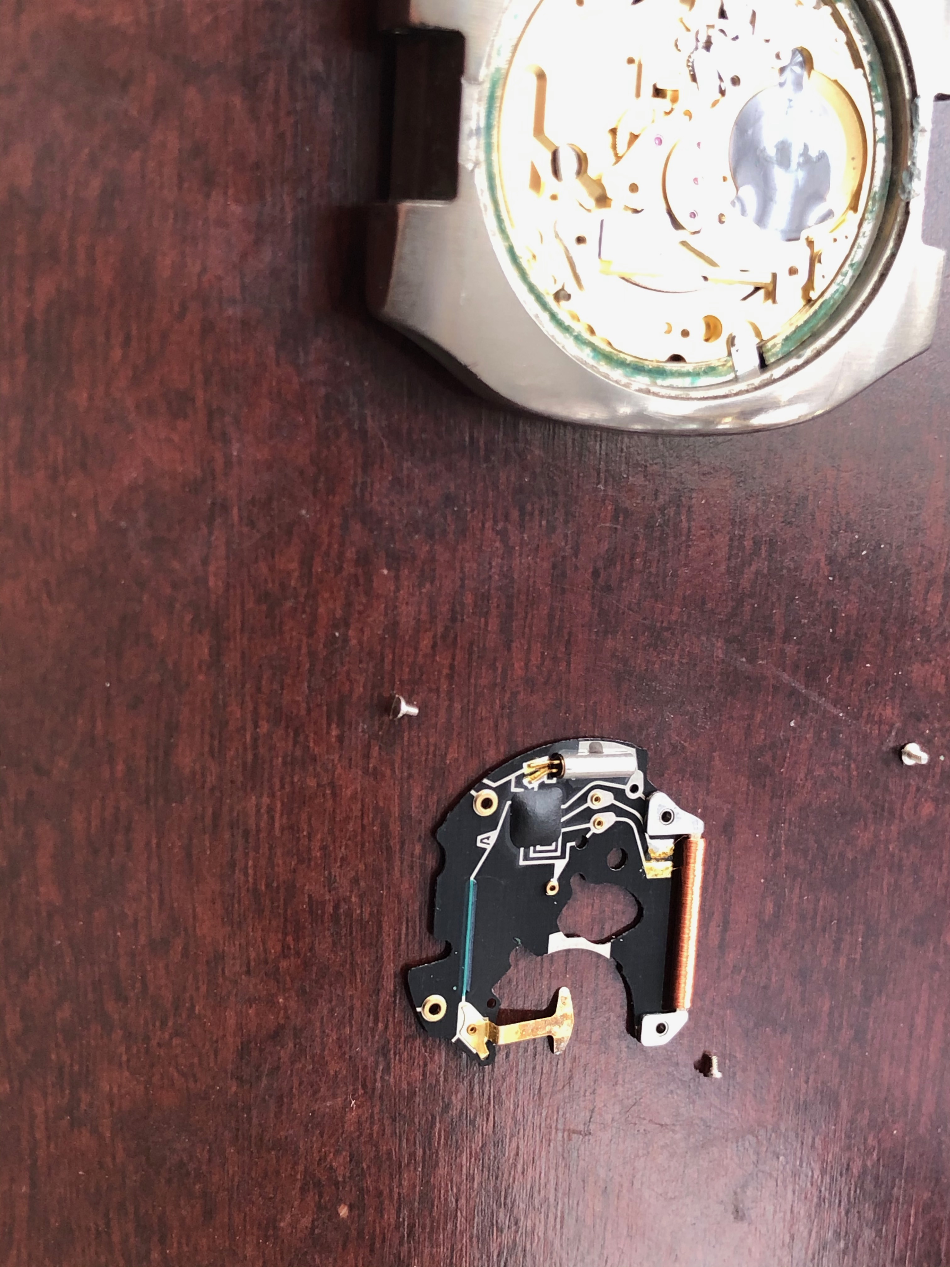

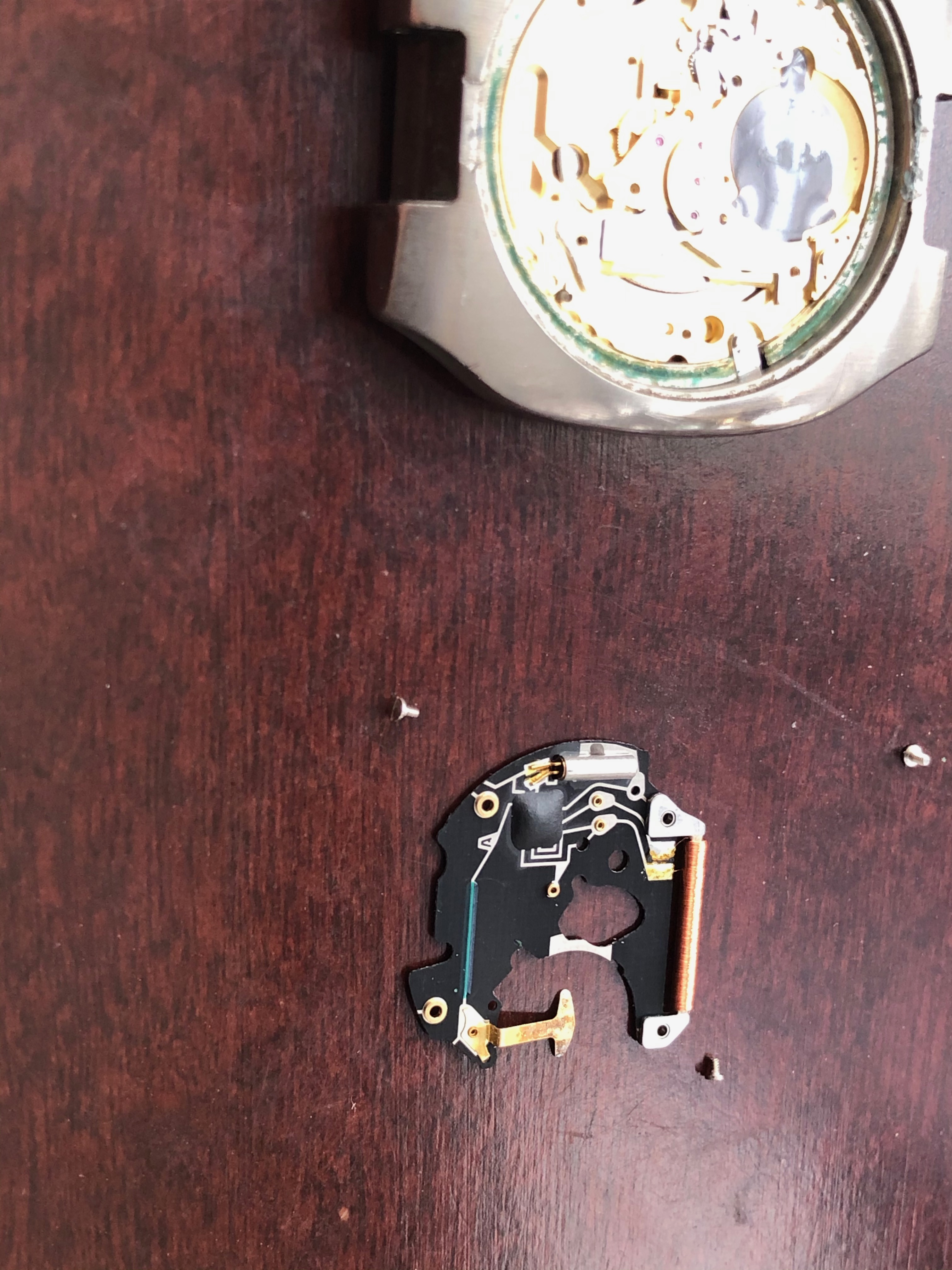

Looking at the charts, I realised a movement swap isn't necessary, the electronic part that didn't work was so practical and so easy to remove!
(Pardon the work environment, these are junk watches, so I didn't bother with a dust-free setup)
So I moved the 1430 movement's board to the 1432 movement, and it worked! (Quick info, I didn't try hard, but there's a small chance 1432 might not go into 1430 - maybe it got stuck somewhere, or the shape is different a bit - there's an exposed IC on one, but not on the other)

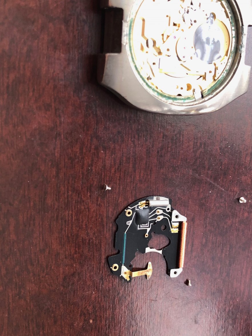

After this, a secondary idea emerged, moving the circuit from the corroded 1449 GMT to the new donor!

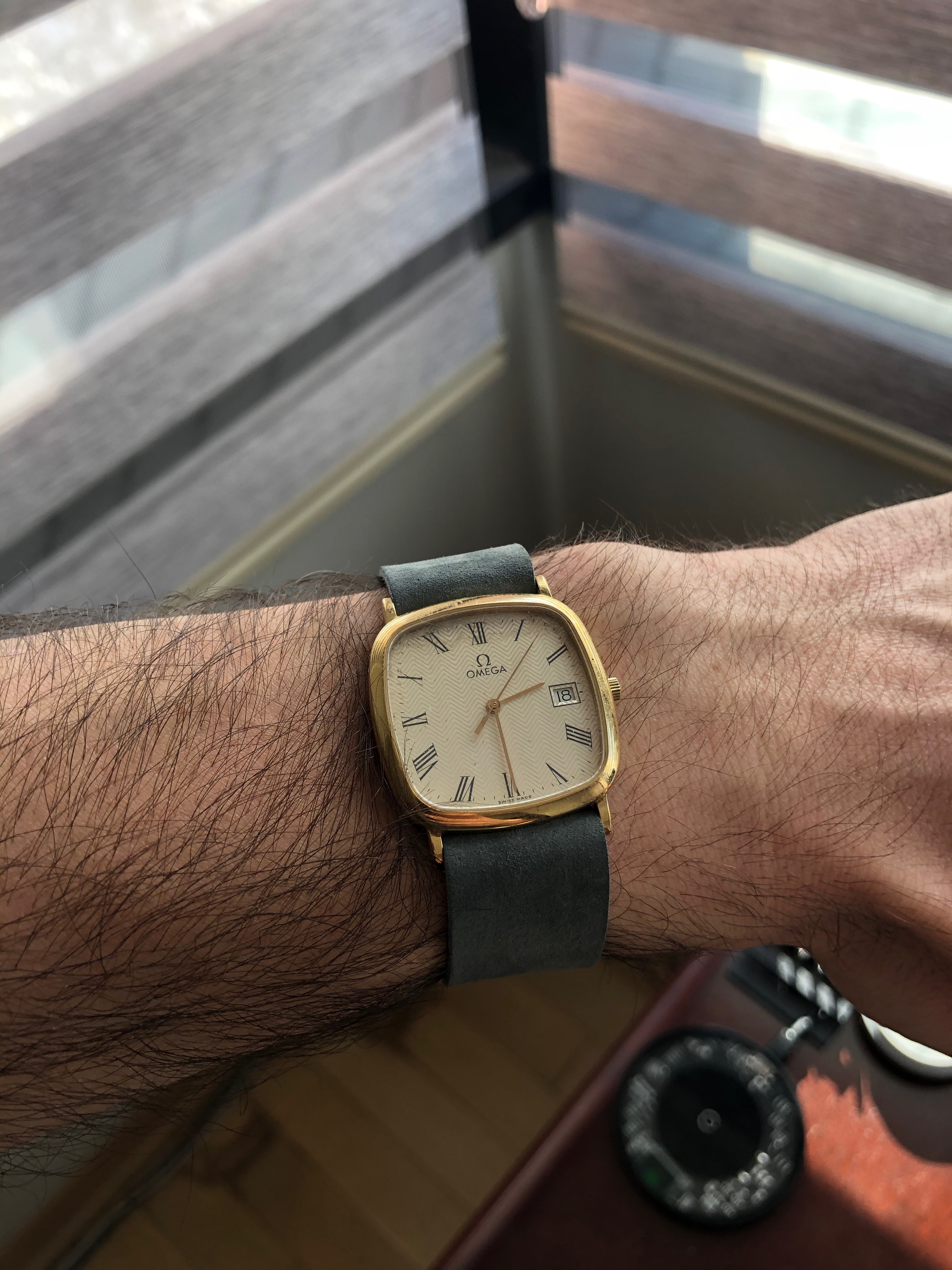

Well that worked too, so 1449 goes into 1430 as well!
Now you might've realised, when I got the 1432 and the 1449 initially, I could've just moved the electronics from 1449 to 1432 and made it work, and the new 1430 could've stayed original - I mean, yeah ๐Ÿ˜ (at the time, I didn't inspect the designs)
But honestly I value my grey desk clock Titane, so it got the best electronics
I gifted the paperweight GMT and the new gold quartz to my brother, he loves them both, I love my newly working desk clock - it was just such a happy day
