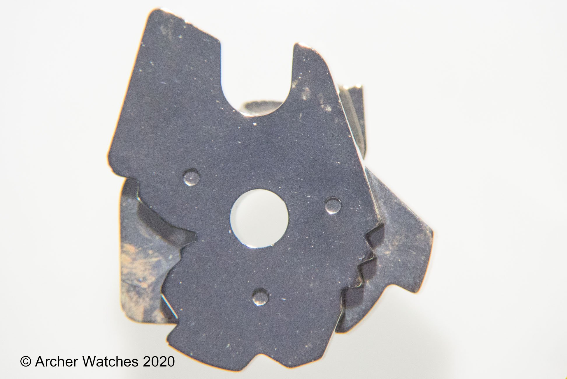

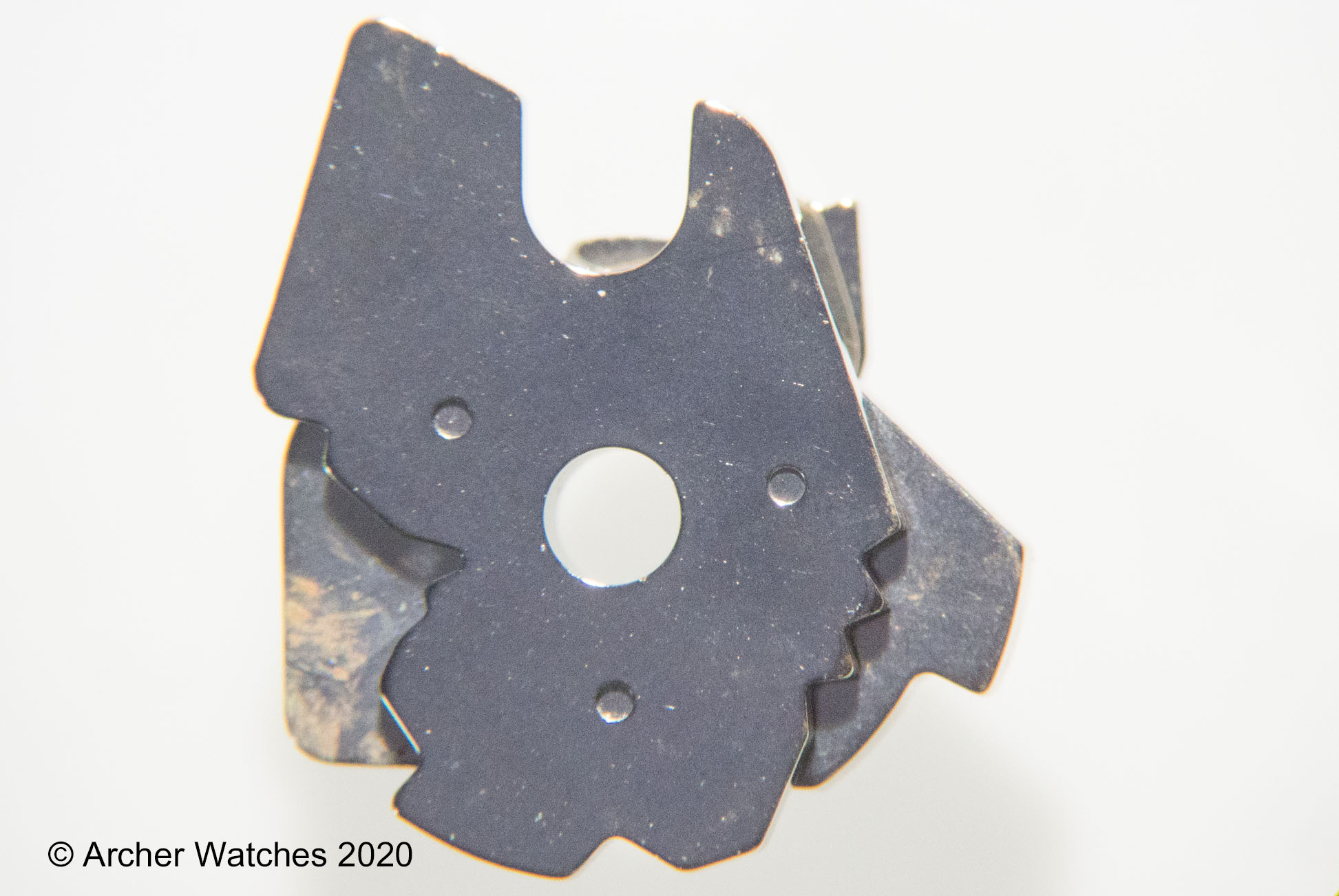

People have been lead to believe that cams are somehow inferior, and are less complex than column wheels. Like most good stories, there's a kernel of truth there from the past. The cam on the 861/1861/3861 is fairly simple, but here is probably the most ubiquitous cam there is, from a 7750:

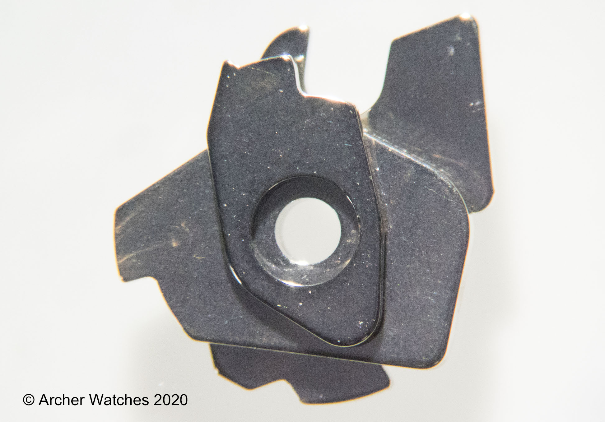

From the top shot above, what you would see on the movement if there weren't parts in the way, is that the cam is made in 3 layers, all with very different geometry. The underside is more complex:
Excuse the stains - I haven't cleaned this one up yet. But it's anything other than simple in design...
Cheers, Al
