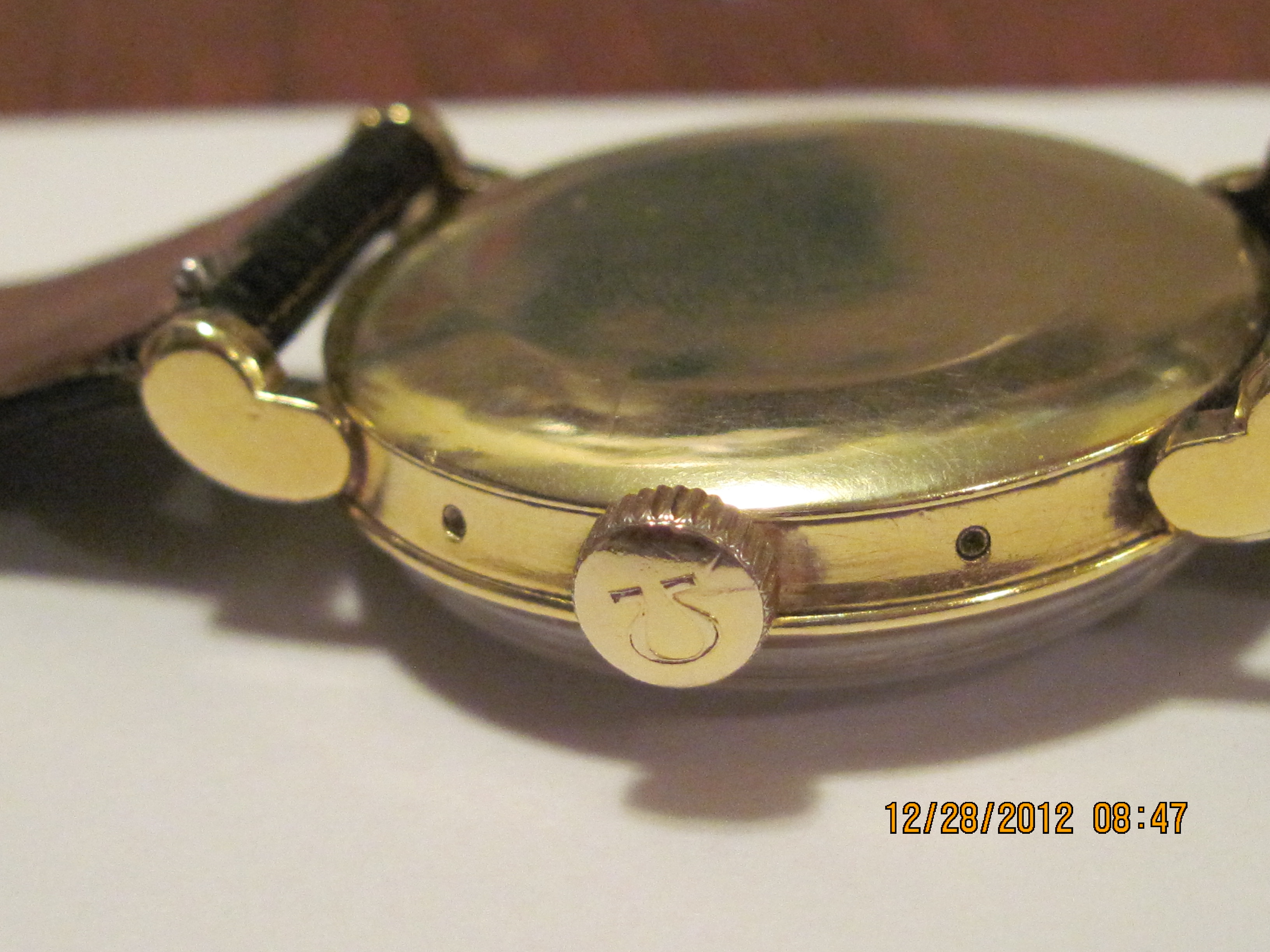

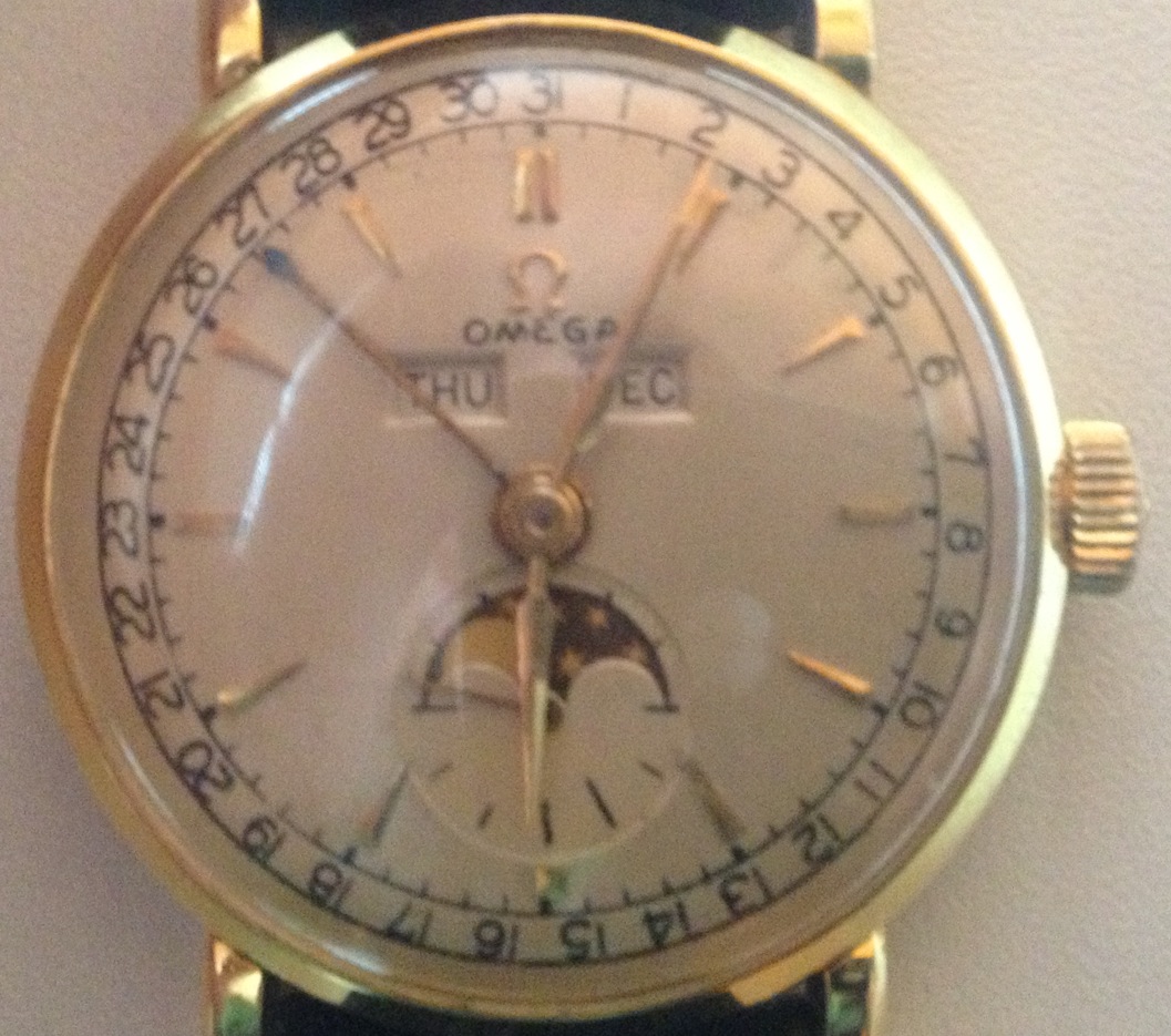

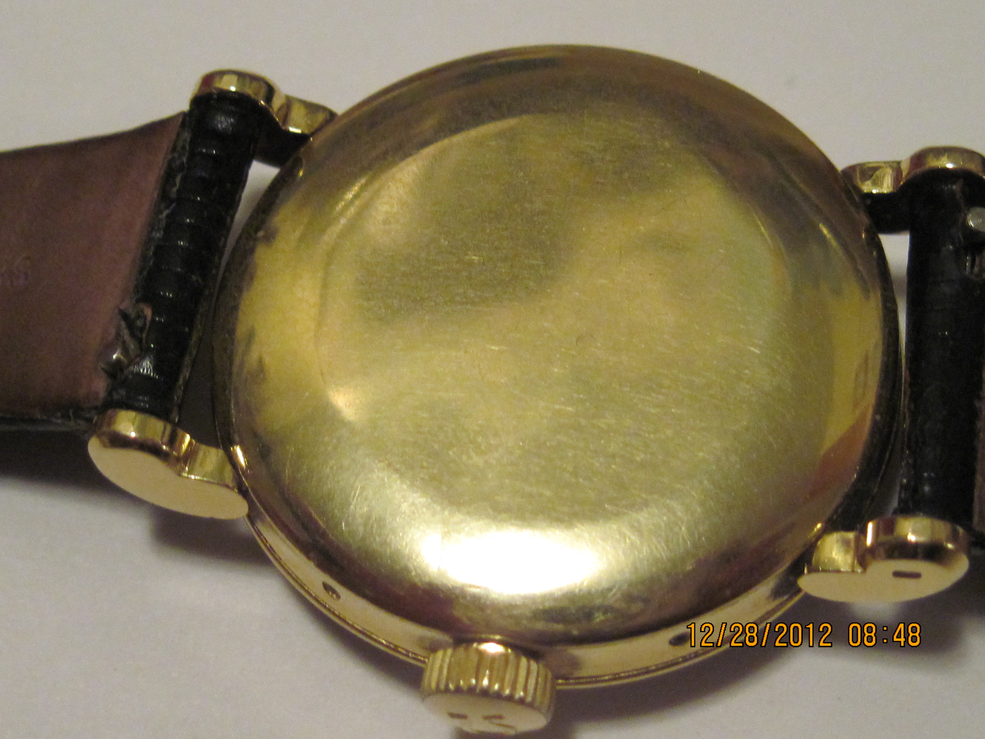

    Hi Folks,
    This is my first time posting to the Omega forums.
    Here's what brings me in to these neck of the woods...........I'm curious to know more about my great grandfathers watch.
    All I know is it was made before the 60's?.
    If anyone knows anything about the history of the watch or roughly how much it's worth - I would LOVE to hear!
    Thanks!
  2. dsio Ash @ ΩF Staff Member Dec 28, 2012
    26,999
    32,718
    Ok, can you do some more photos including of the caseback, and try to zoom out a little and get the dial in better focus? We need that clarity.
    At a glace, you've got a triple date moonphase, which is likely a redial (refinished dial). See if there are any stamps into the lugs (like indentations) that could be hallmarks if its a solid gold case (and photo that).

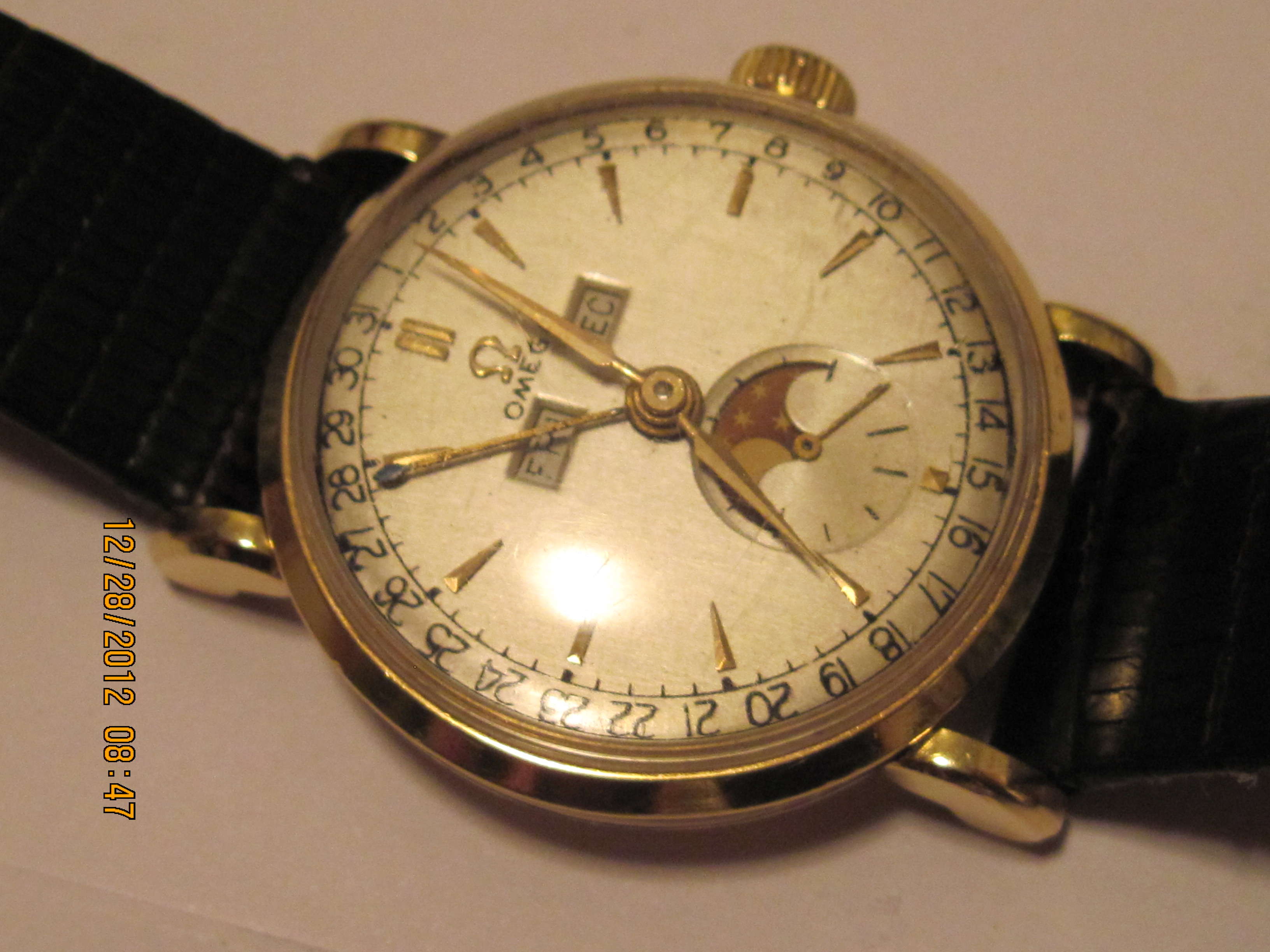

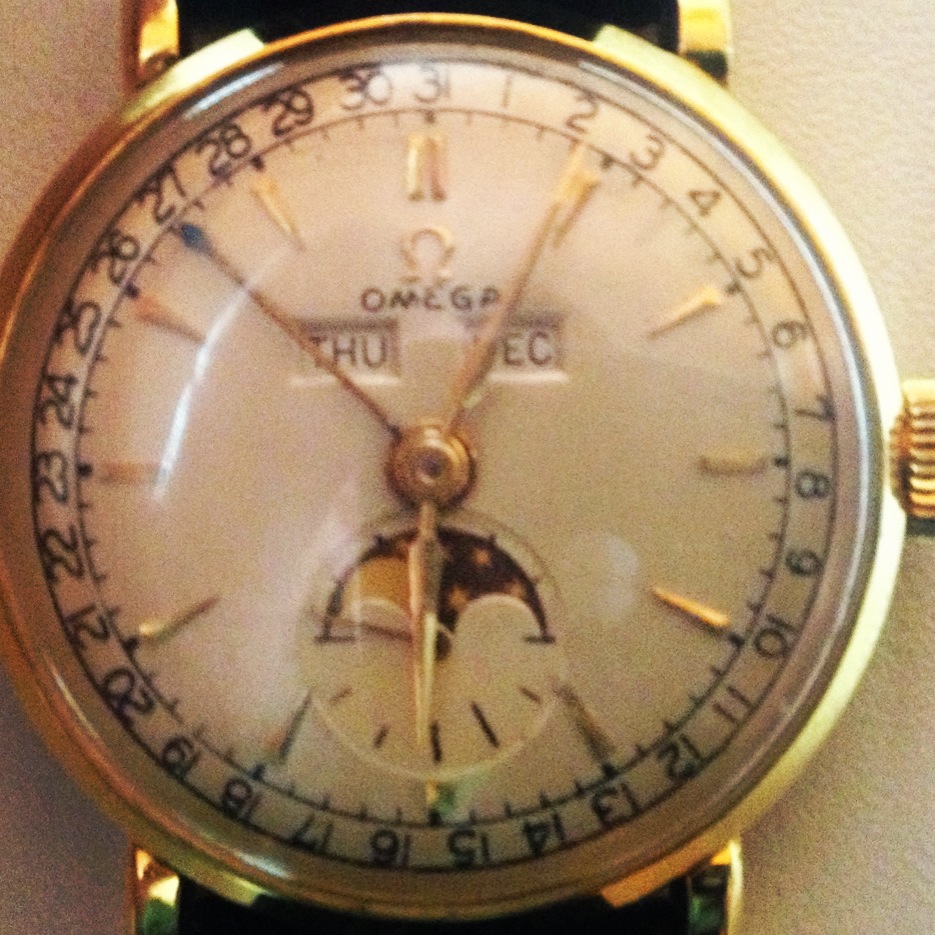

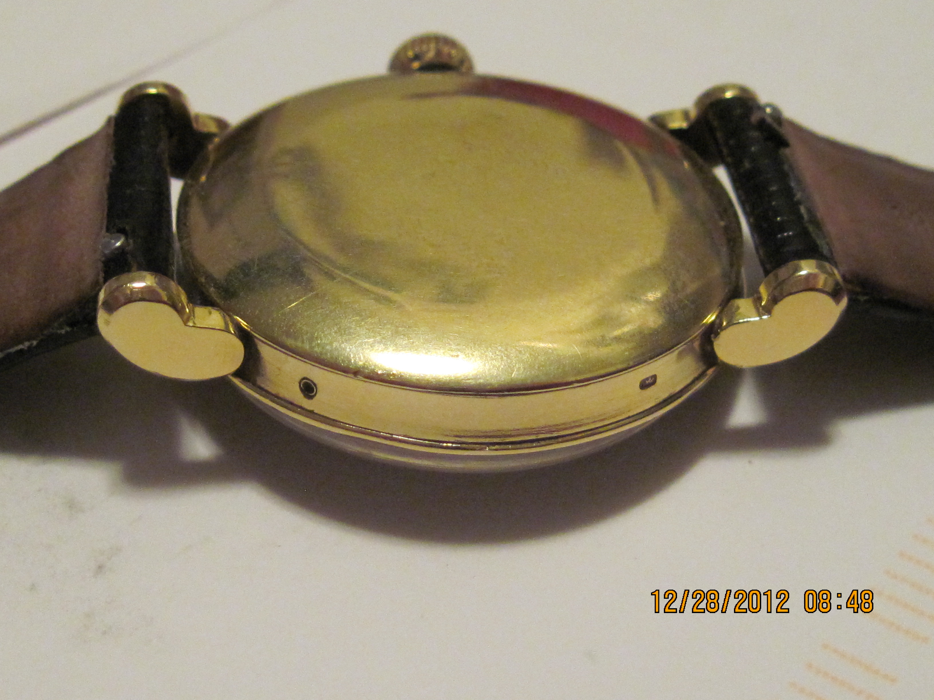

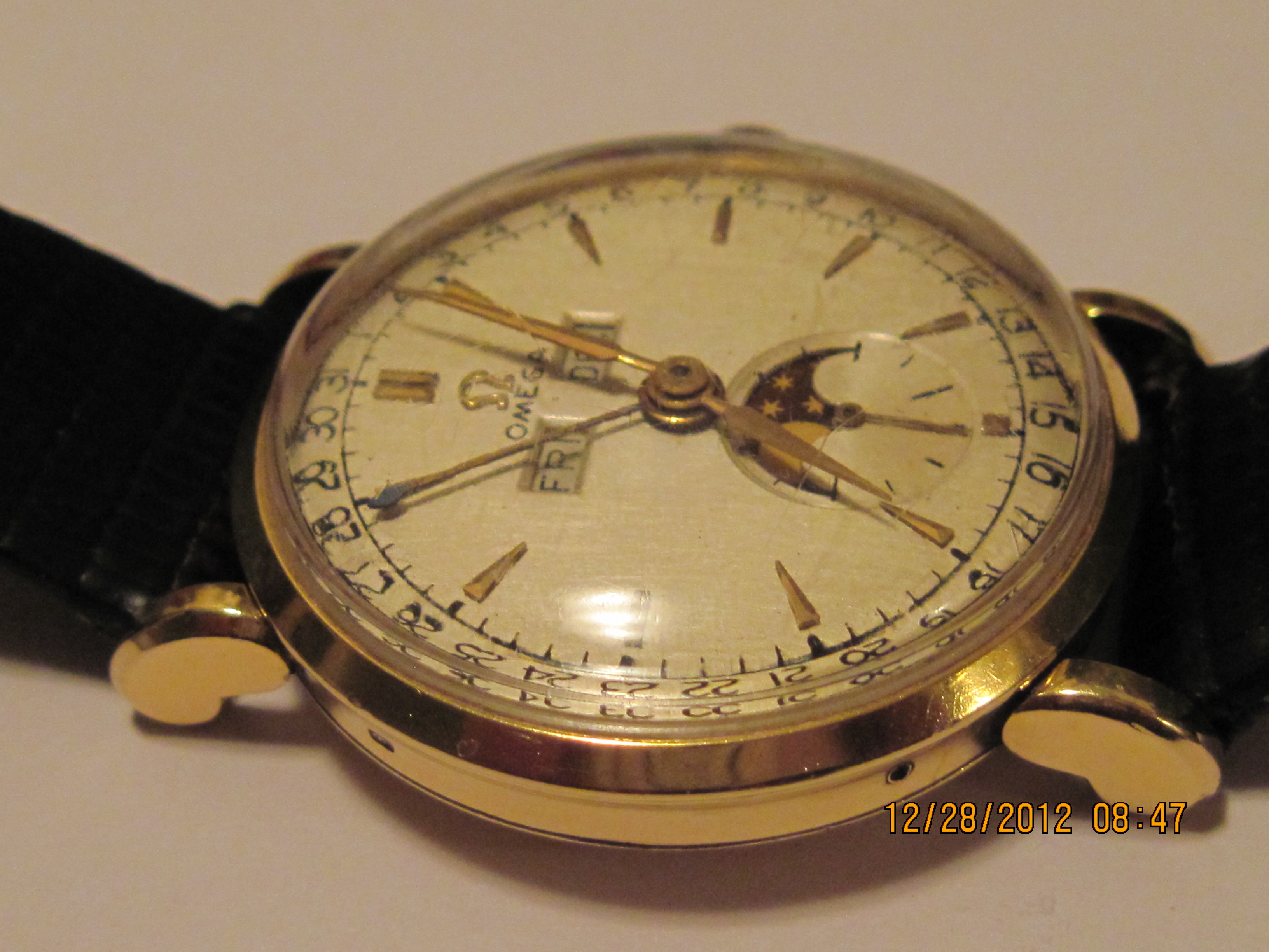

  4. bstoops Dec 28, 2012
    6
    Hi Dsio,
    Here are some more pics. Let me know if you need others.

  5. dsio Ash @ ΩF Staff Member Dec 28, 2012
    26,999
    32,718
    I'll have to wait on someone better versed to call whether its a redial or not, but I have to say, if its original I'd be interested in purchasing it if you were in the mood to sell it
  6. gatorcpa ΩF InvestiGator Staff Member Dec 28, 2012
    12,207
    15,726
    Definitely a redial, but I think I saw a solid gold hallmark on the case.

  8. dsio Ash @ ΩF Staff Member Dec 28, 2012
    26,999
    32,718
    These watches were never very waterproof, so the dials deteriorated rapidly. As a result, at some point, likely in the 60s, 70s or 80s, a watchmaker repainted the dial so it looked new-ish again. Its never quite the same, but in that era it was an acceptable practice.

  10. dsio Ash @ ΩF Staff Member Dec 28, 2012
    26,999
    32,718
    Does the watch run, and keep good time? If Gator's correct and I'm almost certain he is, its a solid gold watch, its definitely a genuine Omega, and the triple date moonphase is a good model. The fact that its a redial hurts it a lot, as if it were all original and clean, it would be a very valuable watch. Its still worth good money though.
  11. gatorcpa ΩF InvestiGator Staff Member Dec 28, 2012
    12,207
    15,726
    That the dial finish was stripped off and repainted at some time in the past. Yes, it hurts the collector value a lot. But a solid gold Omega Cosmic is still a valuable watch.
    You watch's dial probably looked like this before the redial:
    [​IMG]
    Sadly, for these watches, the above is very common, as the cases were not water resistant in any way.
    Here's what an nice, original Omega Cosmic dial should look like:
    [​IMG]
    Hope this helps,
    gatorcpa
