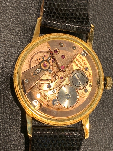

Hello guys,

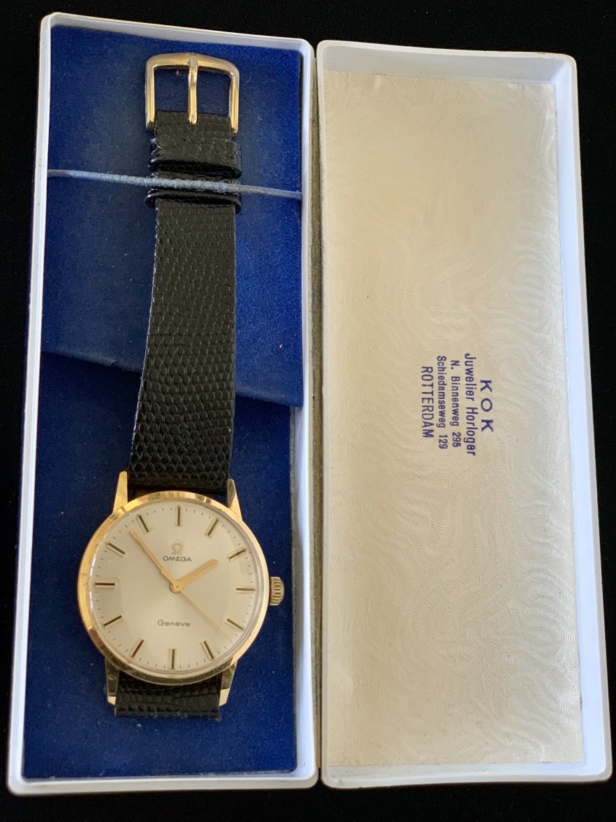

My name is Andy from the Netherlands. A few months ago my grandpa passed away at the age of 94. He left me 3 mechanic watches and one of them was his golden Omega Geneve. He bought this watch at 12-09-70 at a well known watch shop in Holland. I think he didn’t bought this as a ‘new’ watch as the strap is a ‘Hirsch’. He was only wearing this watch for special occasions and the watch is in a mint condition. I will never sell this watch and it isn’t important for me to know any value. I would love to wear it as a memory. I need some help of you guys to clear some things up and to get some information about this watch model. I started my search at a Dutch forum but I got some advise to visit this forum as this is the place to be for the Omega vintage fans. A short summary until now:
My grandpa bought this watch at 12-09-70. When looking in the Omega database I linked the watch to this model: https://www.omegawatches.com/watch-omega-geneve-omega-ba-131-0041

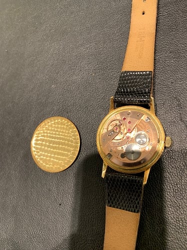

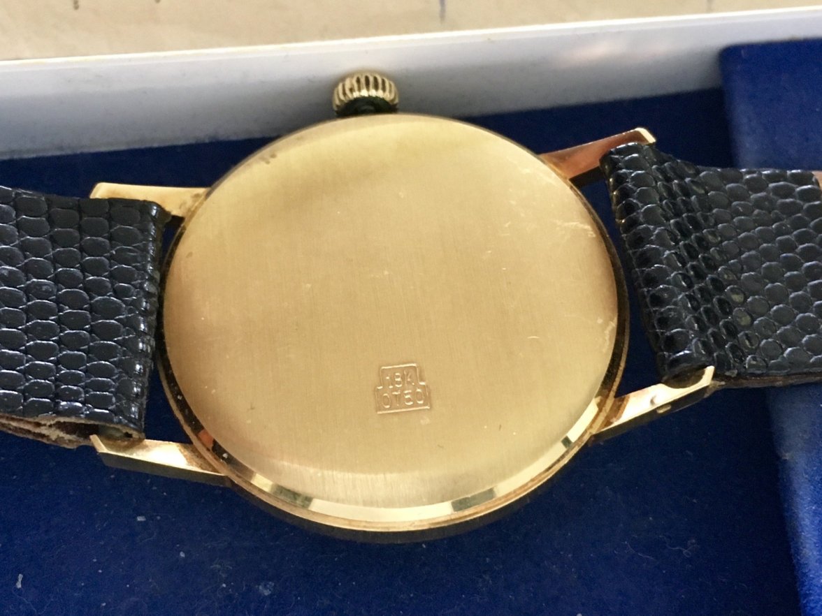

The thing I found out that it is strange it has de [18k, 0750] stamp on the outside of the caseback. I heard this is not usual for Omega so I needed to check out the inside of the caseback for a reference number. I went to a good local watch/jewelry shop to; check if the case is 100% 18K, which is confirmed, and to open the case to see the inside of the caseback. There are no numbers on the caseback. The movement and everything is correct for the model mentioned above; The movement is a 601 with the number 29651951 on it.
I have heard story’s about original Omega watches with changed gold cases. But when checking the model above, together with the purchase date (I got a bill with date back from 1970) and the number on the movement referring to 1970 should be correct. I also was reading some comments that back in 1960/70 the stamps and details at Omega were different sometimes.

Welcome Andy,
What you have is a superb example of an Omega Genève and to my eyes it's all genuine and original.
The serial of the caliber 601 dates the watch to approximately 1969 and the caliber 601 is one of Omega's most reliable and well designed manual wind movements.
The lack of markings inside the caseback is a bit unusual but not unheard of. It's even possible that the case was made in Holland, but more likely from a Swiss maker and may even have been made as a presentation watch.

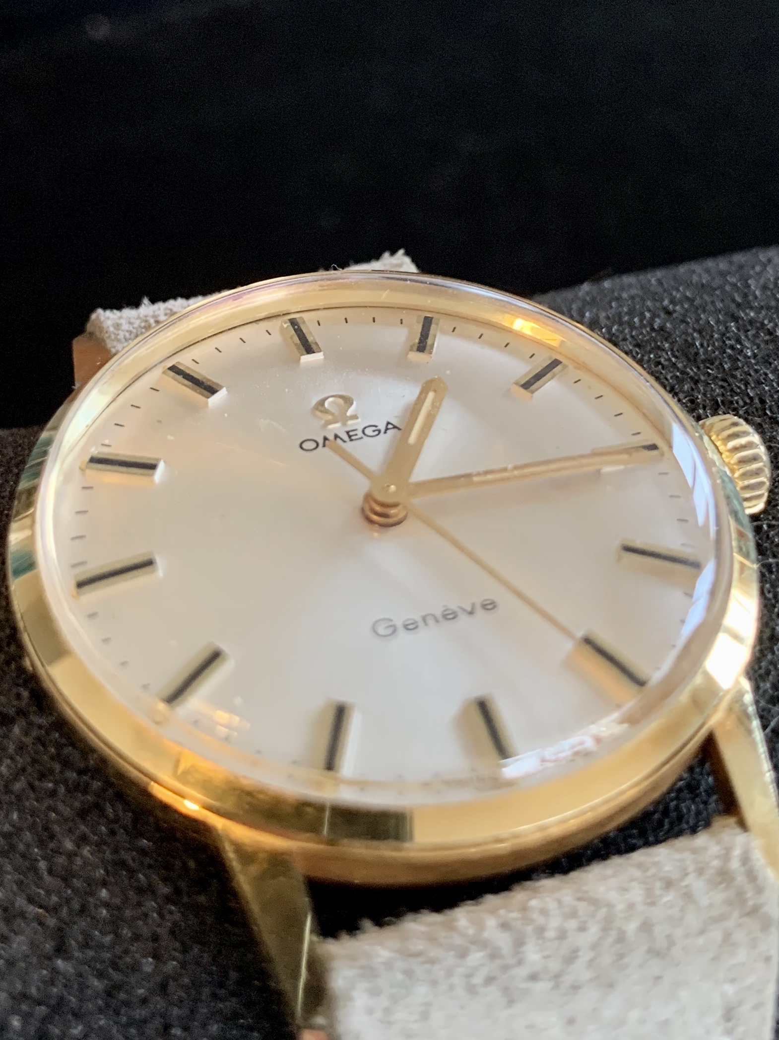

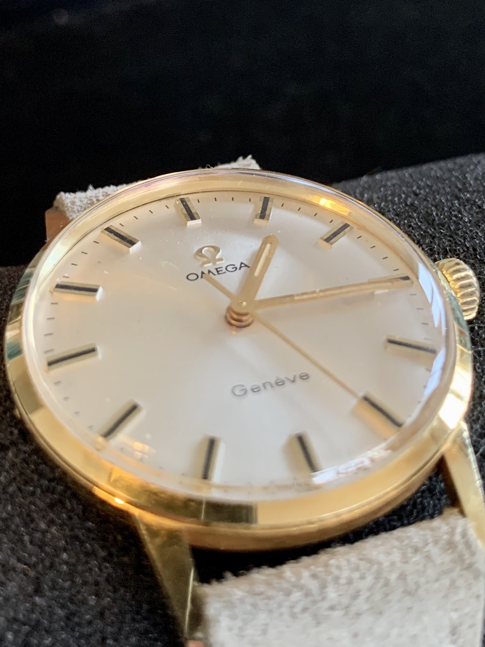

Are the black marks on the hour indexes painted or inlaid? I can't tell.

Hi Jim,
Thanks for the welcome and your post! Thanks good to hear this! On this website I found that the serial 29651951 on the caliber should be 1970 (close to what you said) which matches with the bill of purchase and the BA 131.0041 model on the Omega website - http://www.chronomaddox.com/omega_serial_numbers.html
About the marks on the hour index - They are not totally inlaid for what I see but 'on top' of the dail.. The black looks inlayed on the golden markers. Hard to see for what you looking for so here a picture.

No, I was hoping that they may have inlaid Onyx stone like some of the Constellation models, but many Constellations also had the black painted marker so no problems with that.
