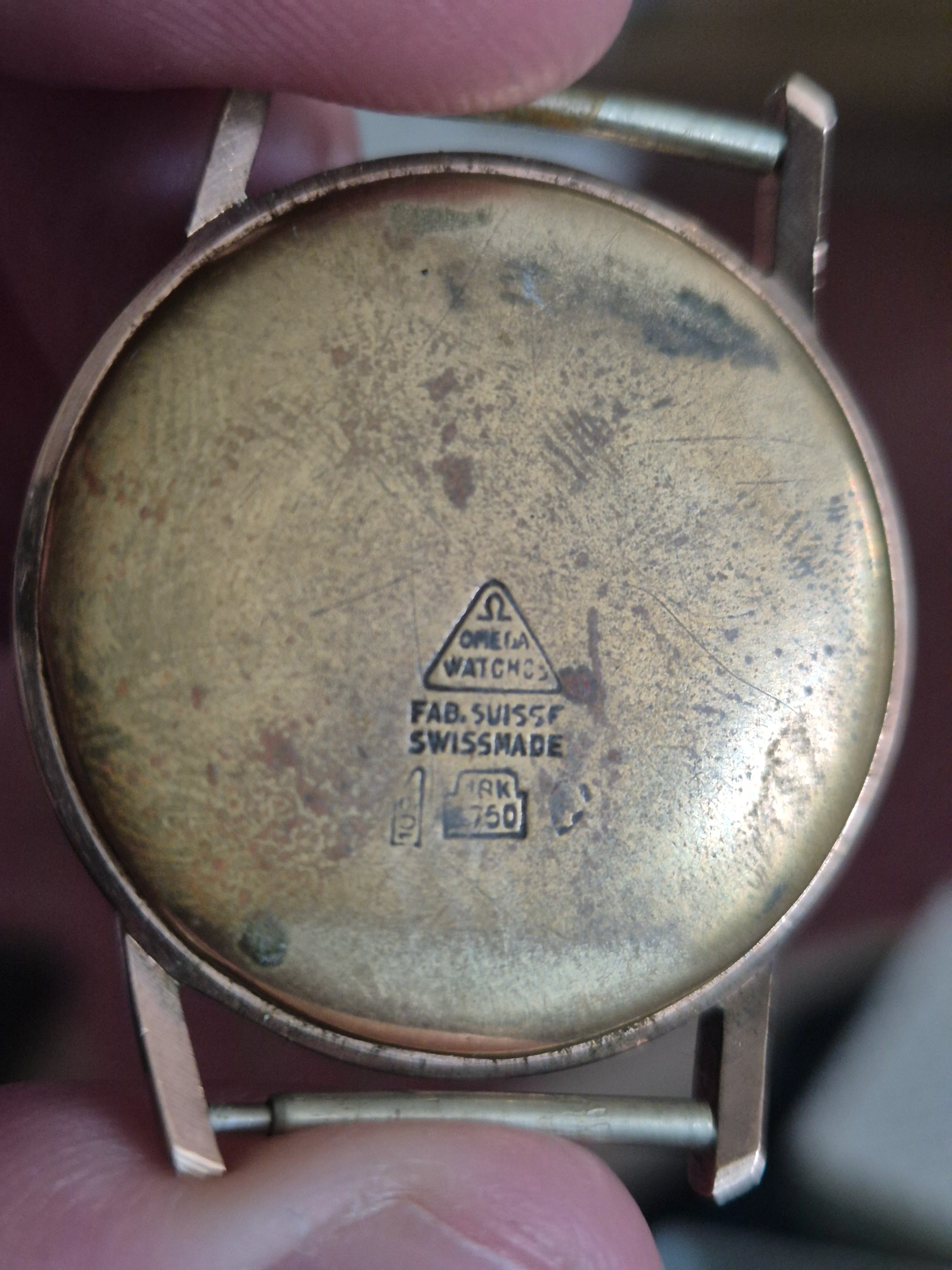

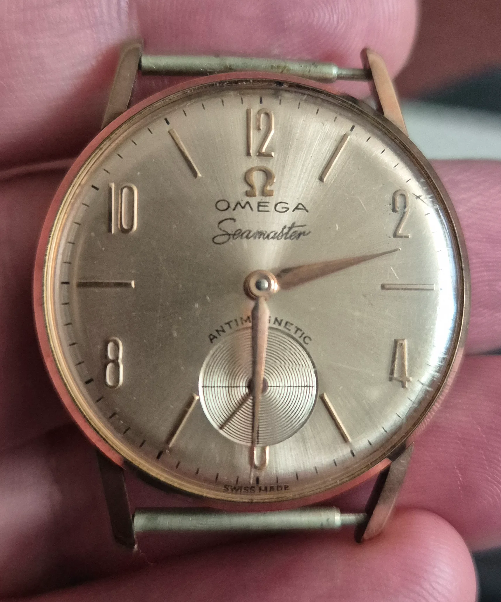

My mother gave me her fathers old watch and I am curious what this is. From 50's presumably from her knowledge. Backcover had no markings on the inside. Any info would help. Thanks!

Are you from Europe, or your grand father? Please google "Autobahngold" (Freeway Gold).

The watch is a fake, possibly using a generic ébauche movement that has been signed Omega. It isn't even made of gold. It could be any ordinary watch that someone tried to pass off as an Omega.
I would still keep it with affection.

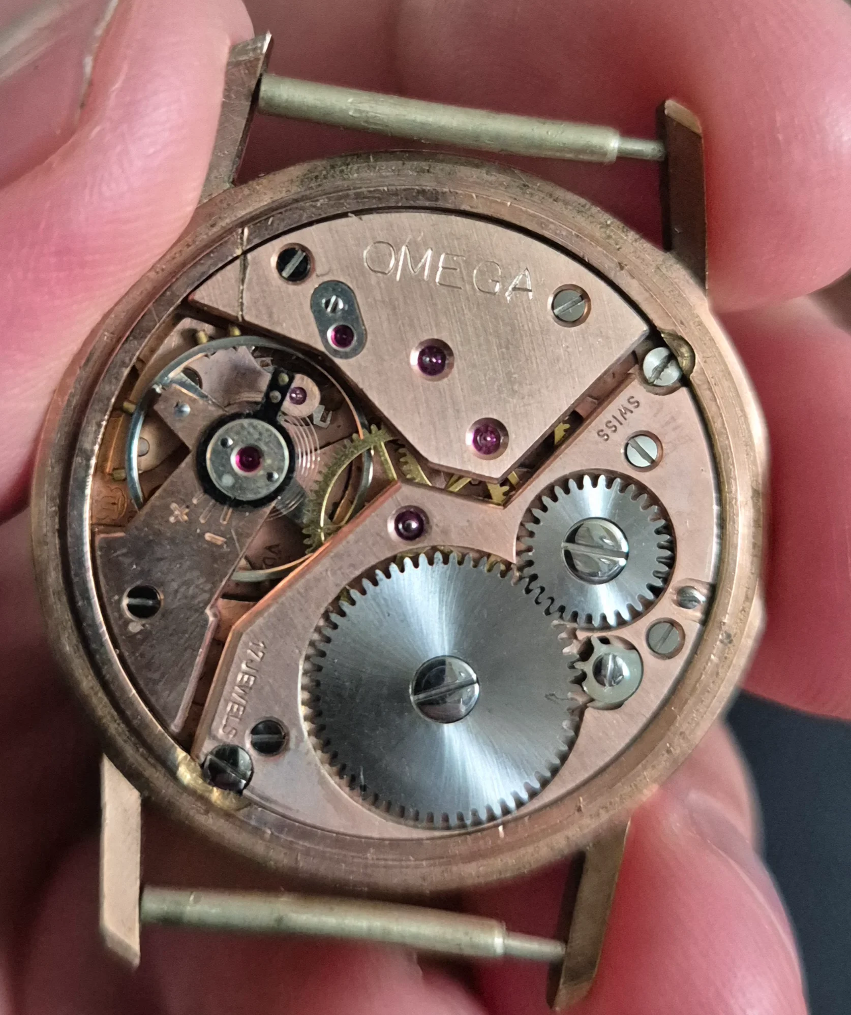

Looks like it is a franken too. The finish on the balance bridge does not match the other plates.

That appears to be a Unitas movement, but I can't place which one.
Definitely a Unitas caliber, it's marked under the balance but I don't think it's a 6310. The upper escape jewel for instance.
Decent movement, shame the fakers had to denigrate it.
Yep, that's how I figured out it was Unitas 😁 what am I missing on the upper escape jewel? It looks the same to me?
