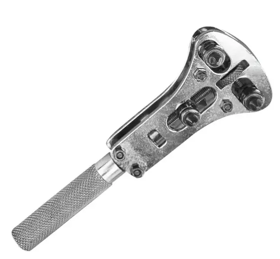

All you need to do is by a tool like that
It cost between $5 and $10

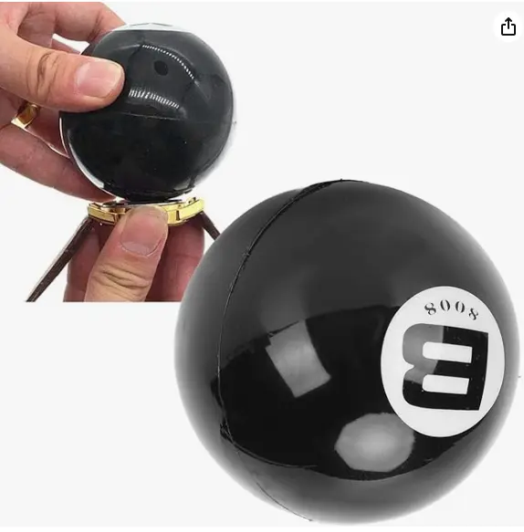

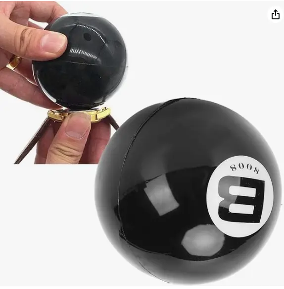

Would recommend against this style, in particular a cheap one as a beginner. The case opening rubber ball is what I would start with…
Awesome thank you, gonna get one.

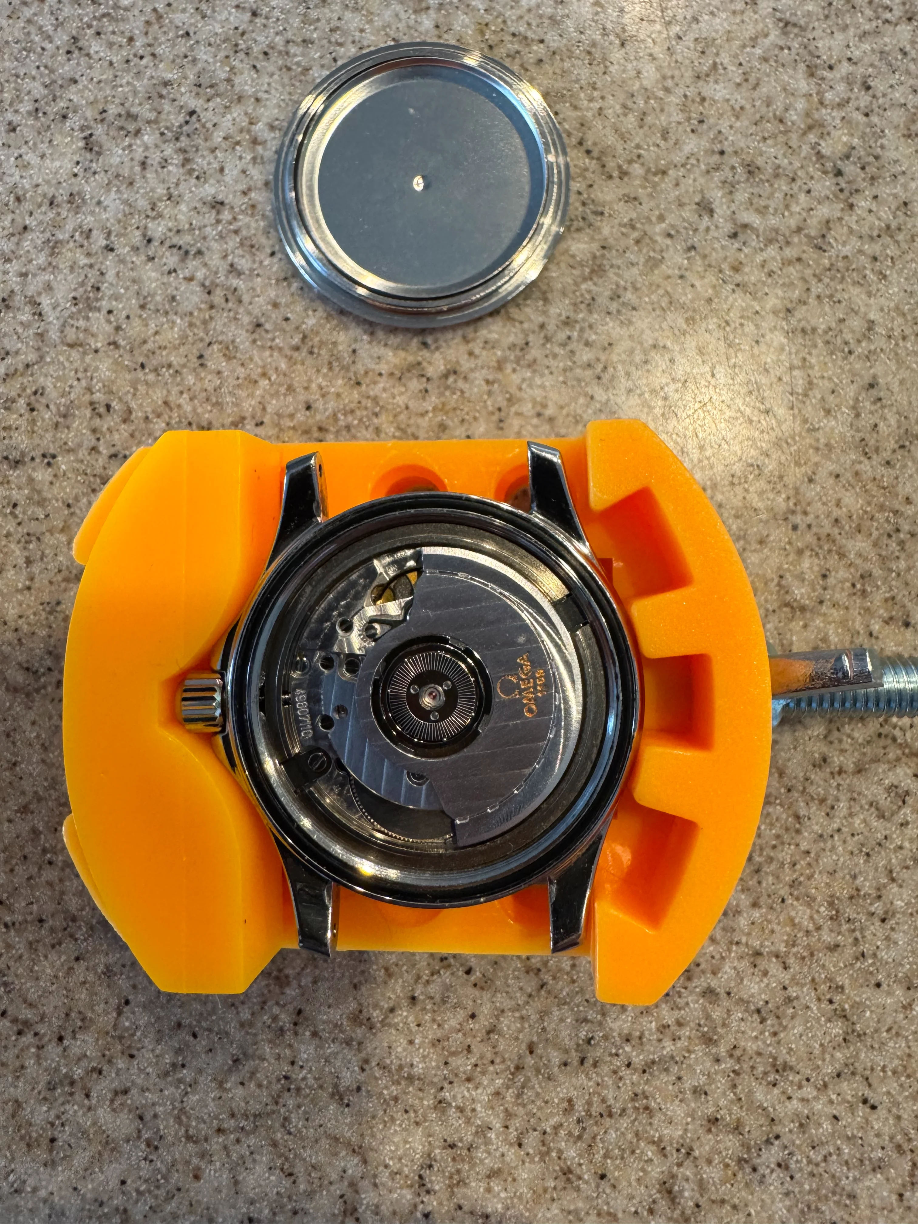

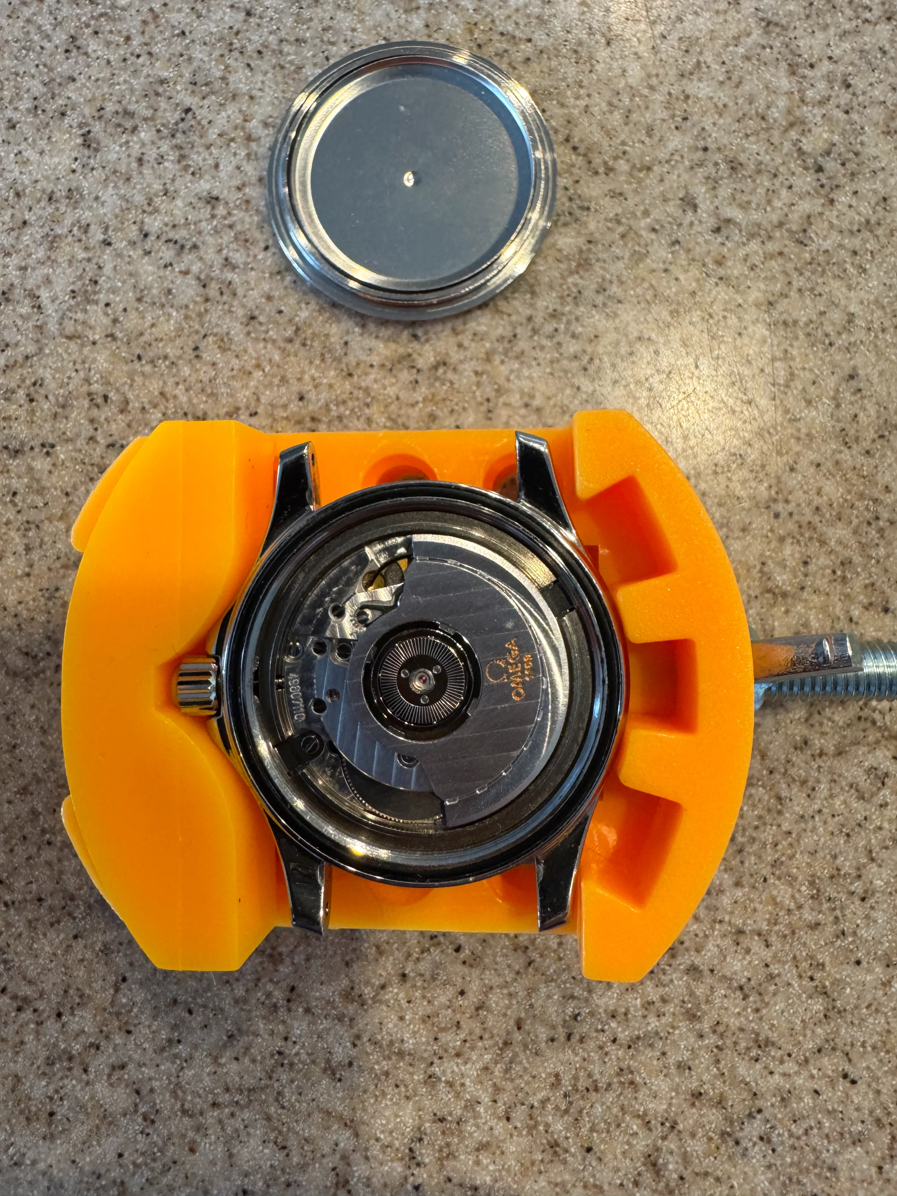

Well, I opened 'er up and I do see what looks like the serial number. Am I in the clear?
Yes! Looks good. It’s a mystery why the serial is gone from the outside. I don’t buy that’s it’s old enough to have not had one on a lug but that matters not a jot. It’s all good if it has one inside as far as I’m concerned. Probably a lazy grey dealer.
Awesome - big relief. Thank you.
