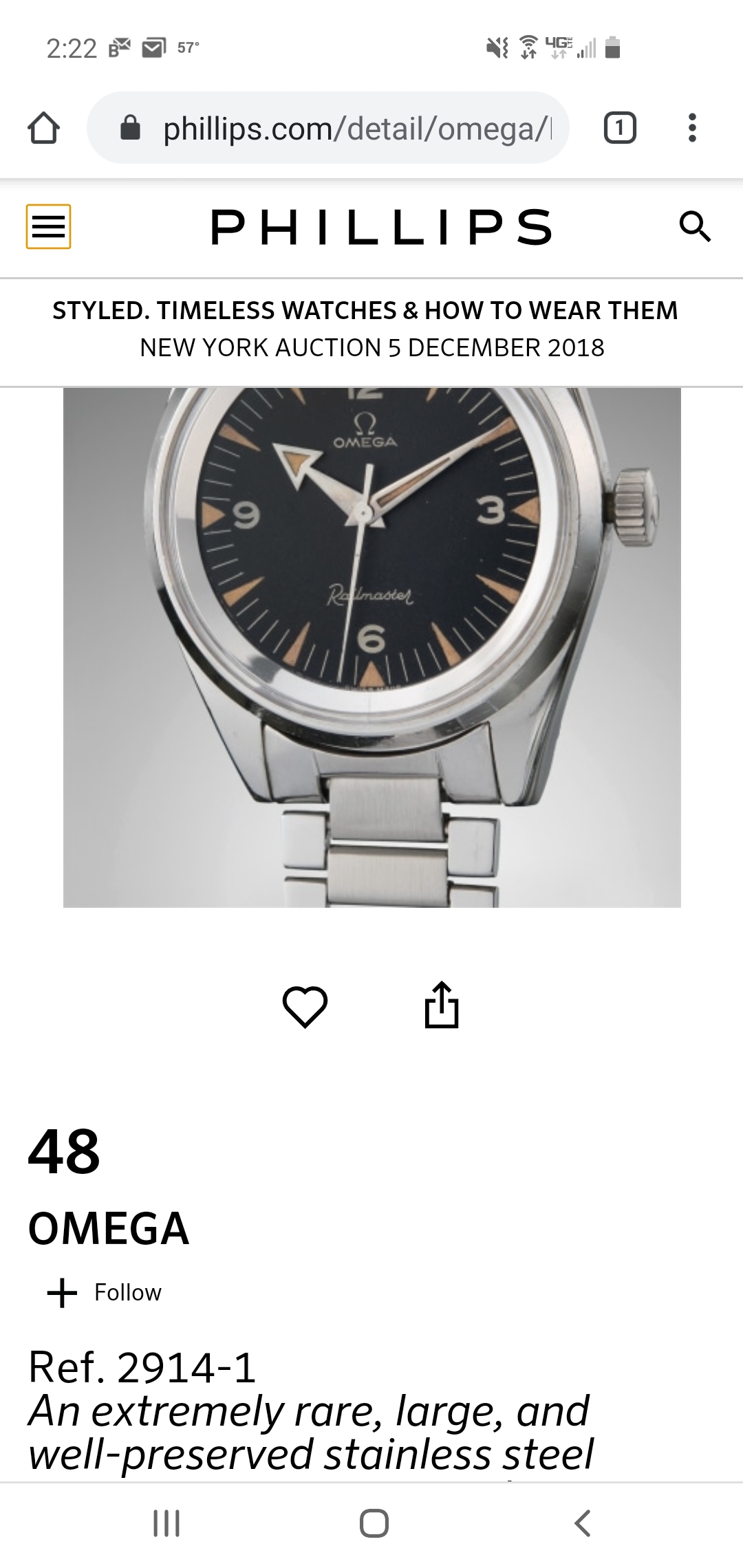

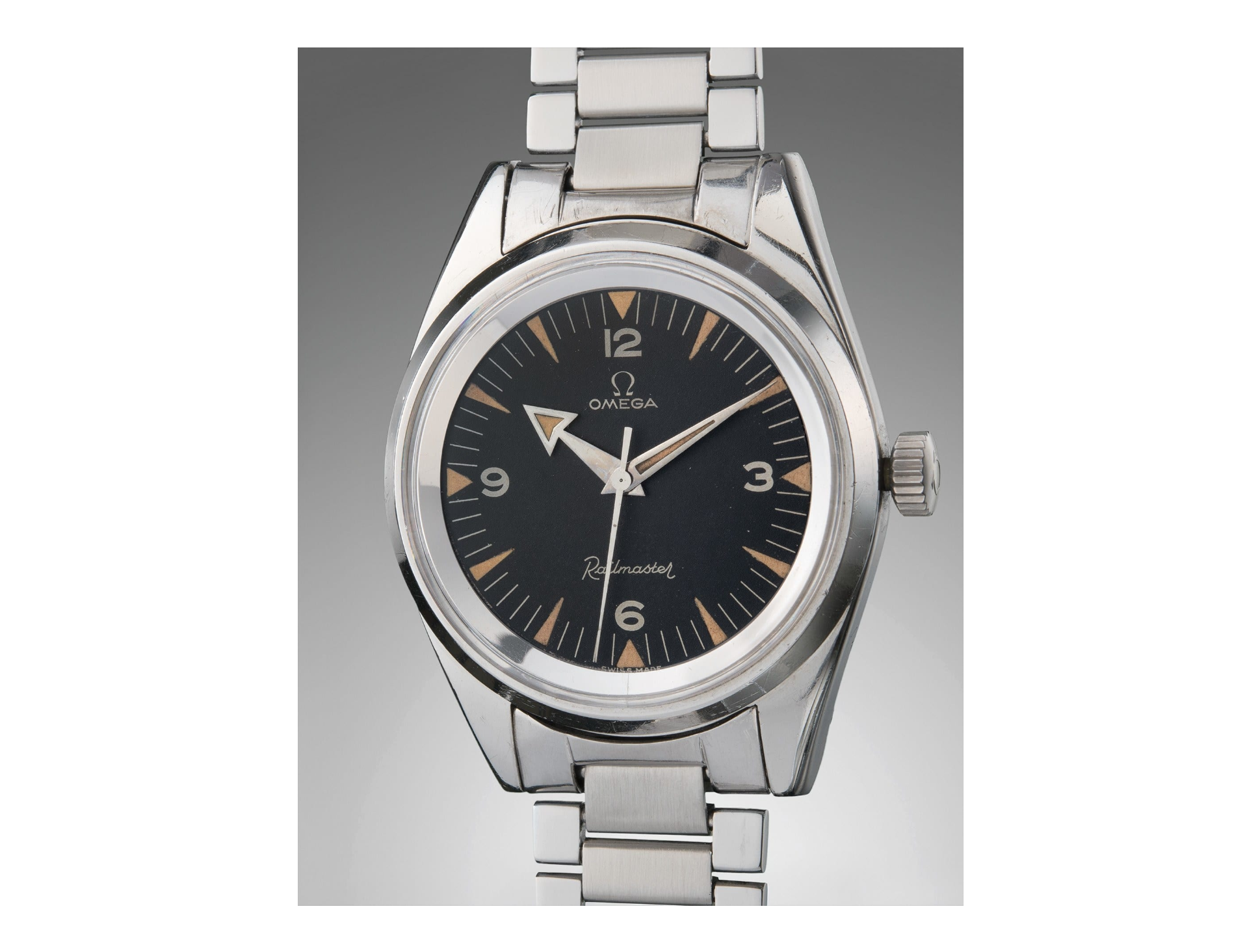

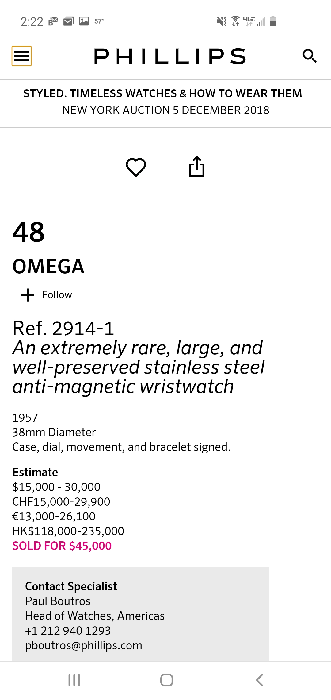

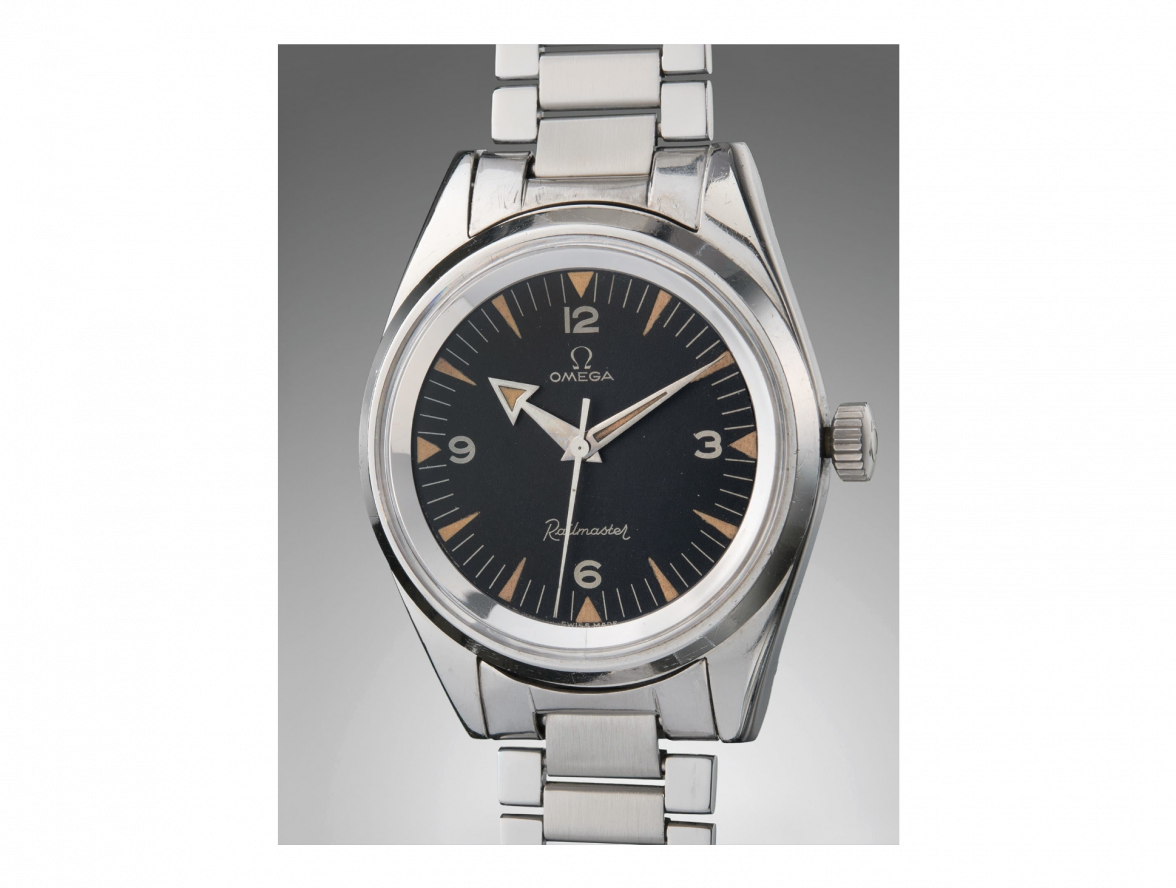

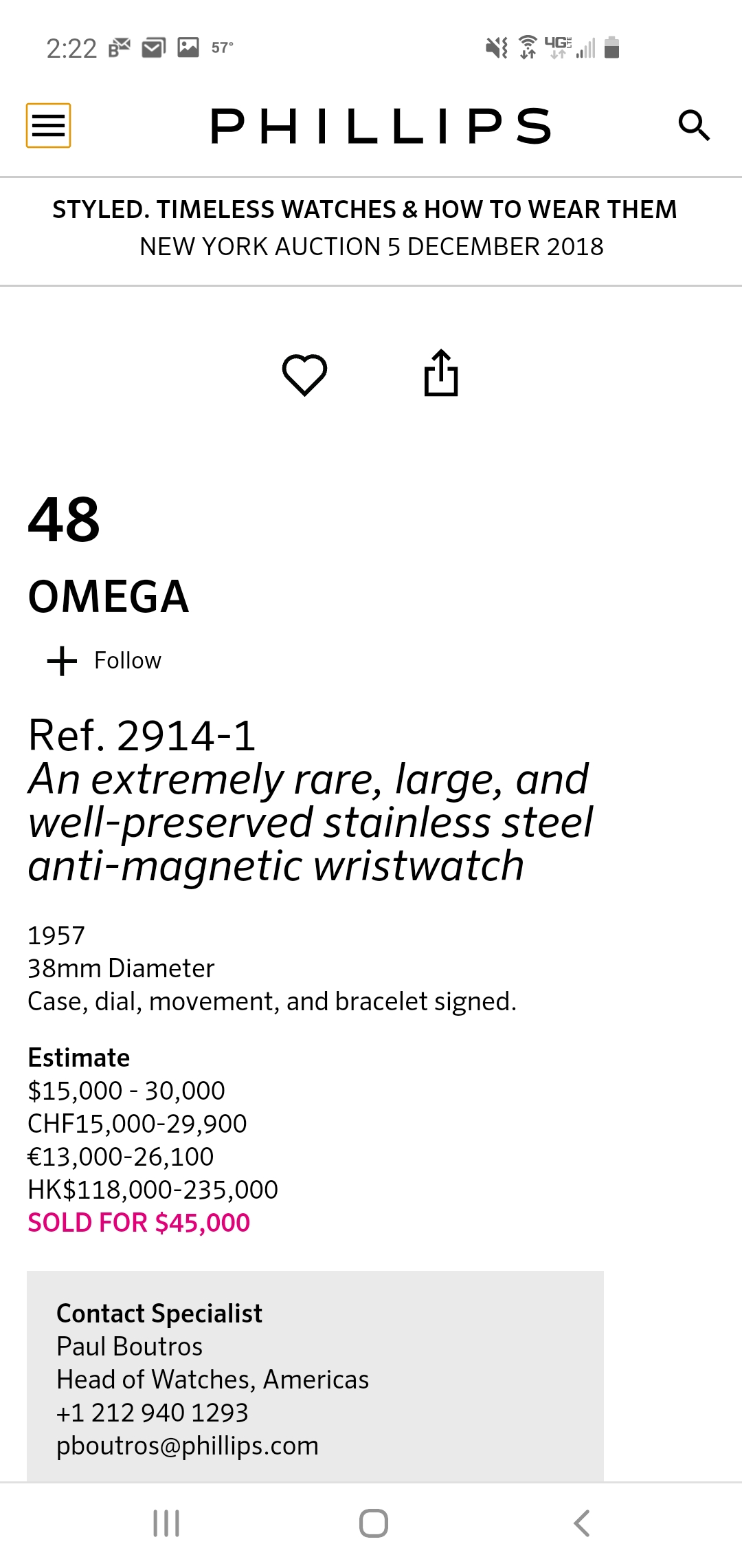

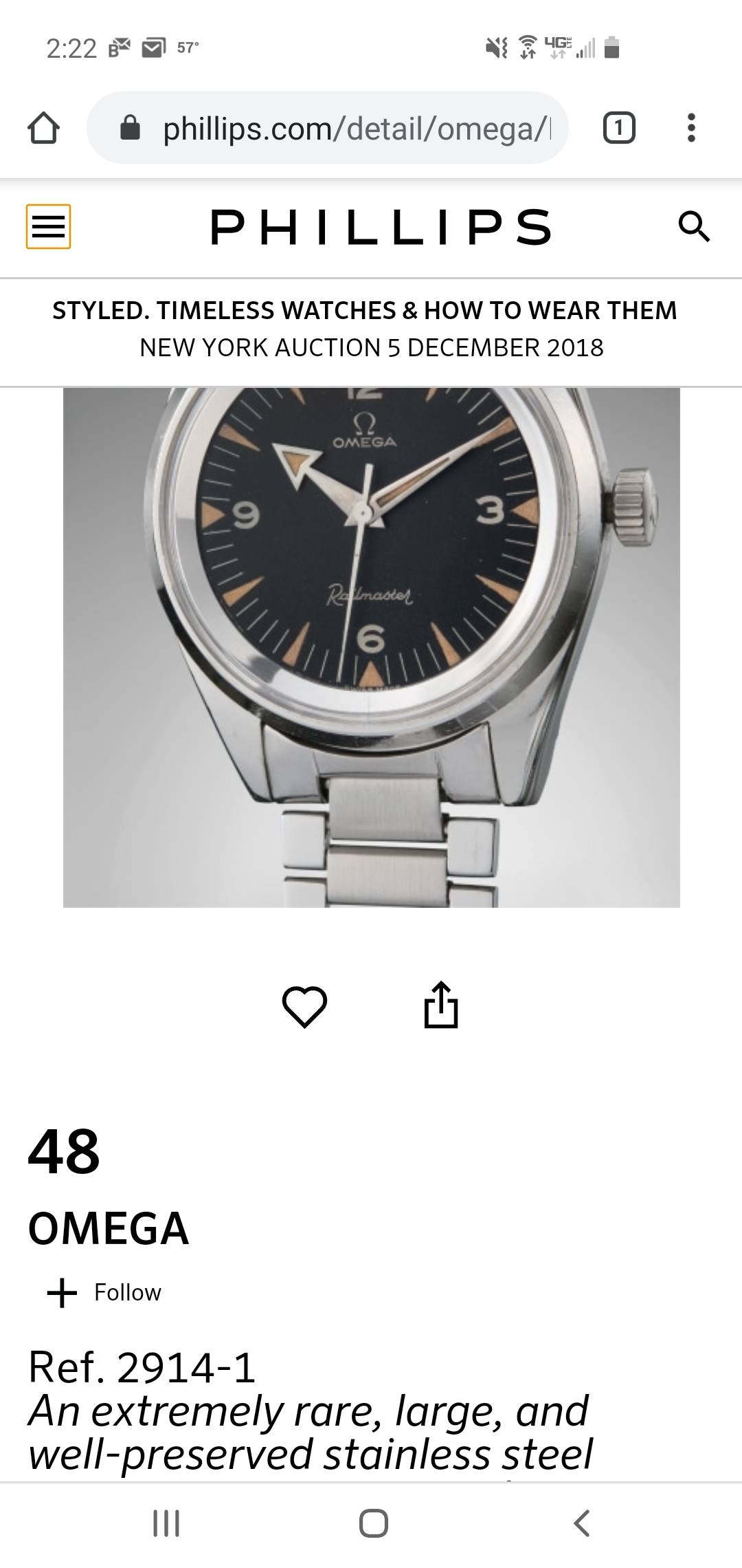

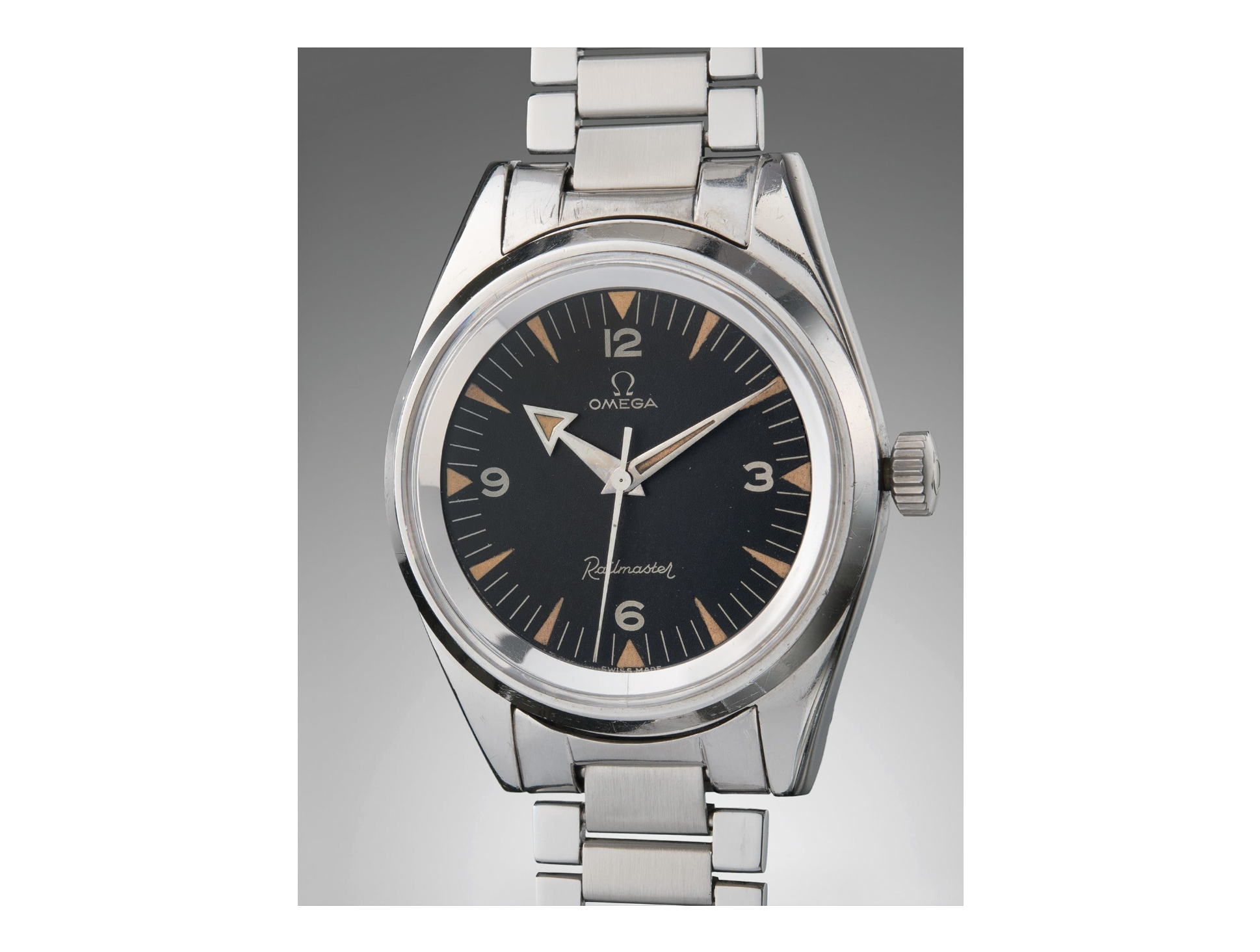

I owned a 2914-1 that sold at philips last year in ny. There definitely correct case backs of that model with seamonster and without

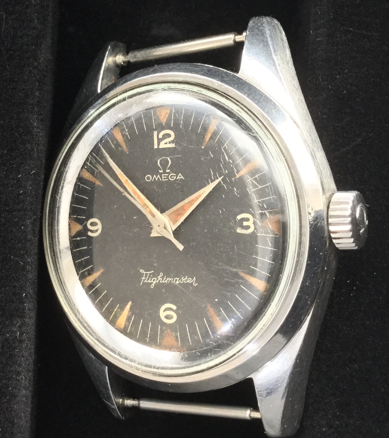

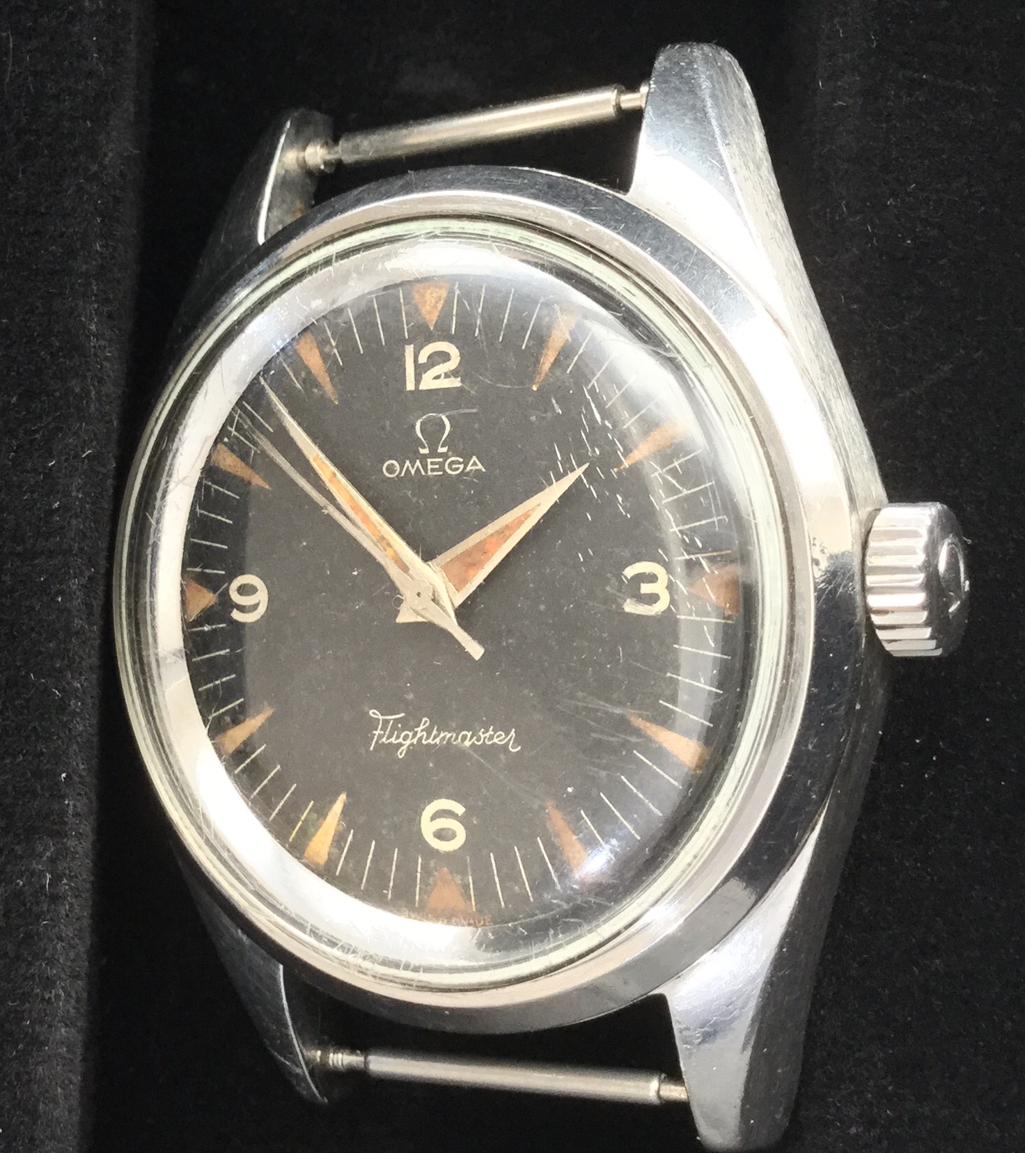

I have the same patination on one of my iron dialed amagnetics and the speckled pattern cannot be due to radium burn. If it was, we'd see it on a lot more dials across the entire vintage watch scene and not primarily with iron dialed watches. My guess is that it's due to moisture reacting to the dial material.
