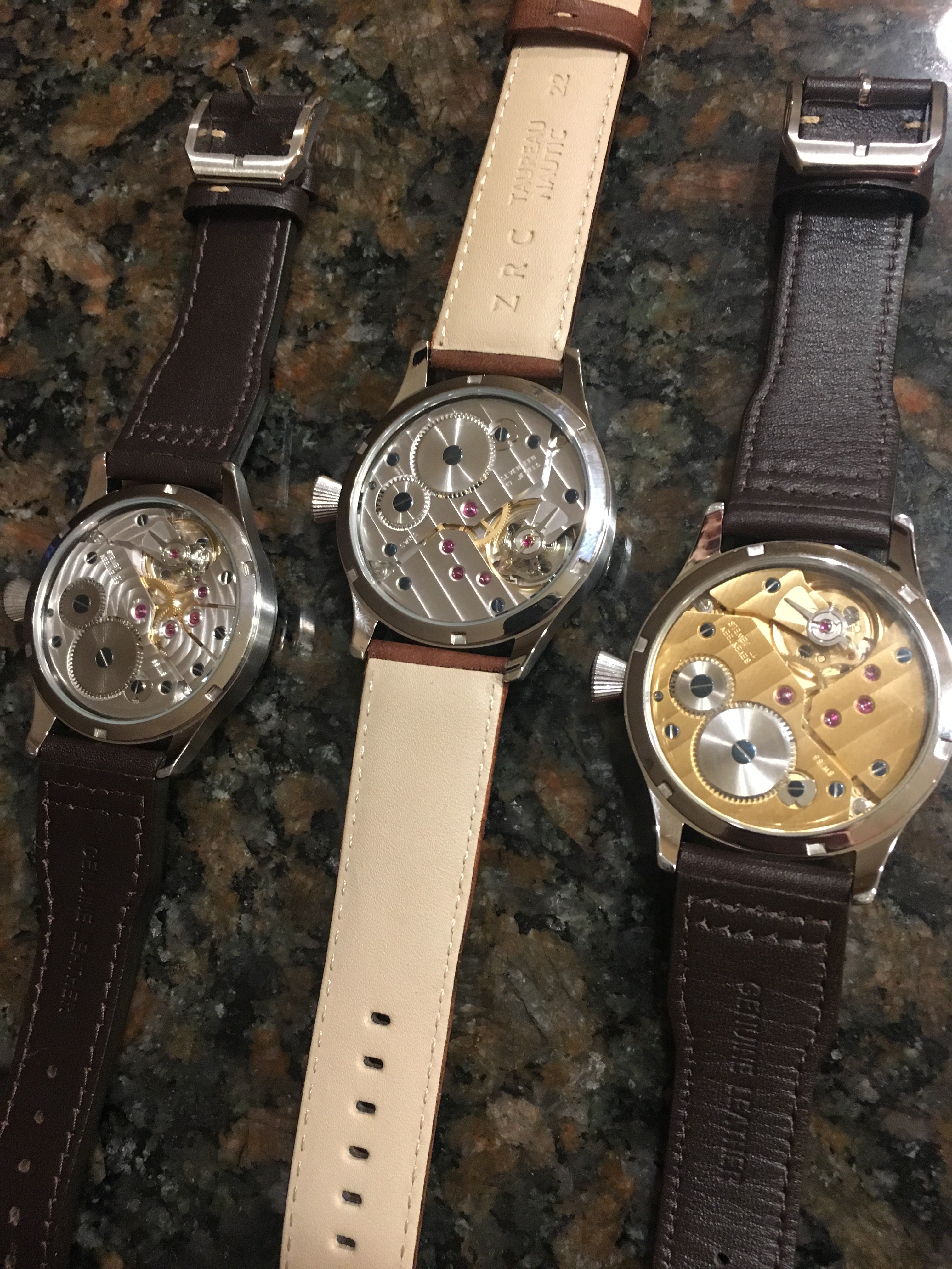

Unitas 6497/8. Big and not much parts to play for rookie.
Or maybe even manual wind alarm clock for starter. Even bigger parts
30,205
77,993
ETA 6497/6498 are used in watchmaking schools for a reason. If you can’t find a genuine one for a decent pric, then a Chinese clone will do to get started.
195
493

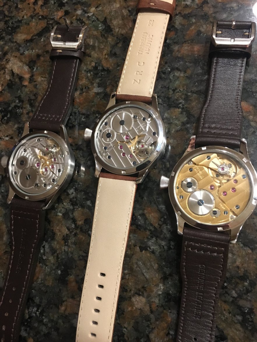

I agree on the ETA 6497/6498. That’s what we used in the first watchmaking class I took at the AWCI. After that class I built 5 watches using those movements. I fully serviced and adjusted them. I then gave them to family and friends. I even dynamically poised one of them.

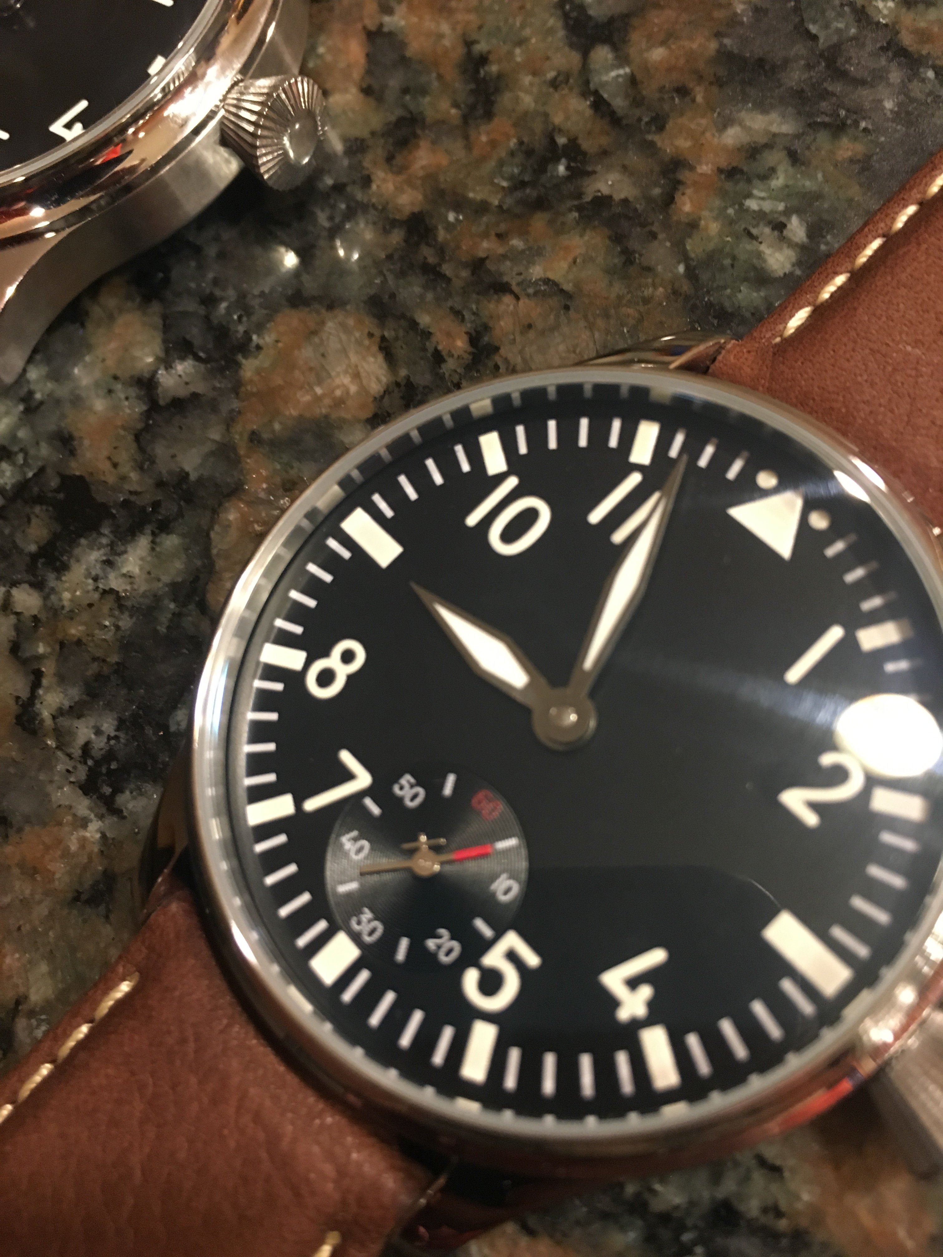

If you are looking for a '70s movement. The AS1187 was very common among the generic Swiss watch industry. Can't swing a dead cat in a room without hitting one 😉
I have hundreds sitting in a box. If you live in the US, I can send you some for practice. (You pick up shipping).

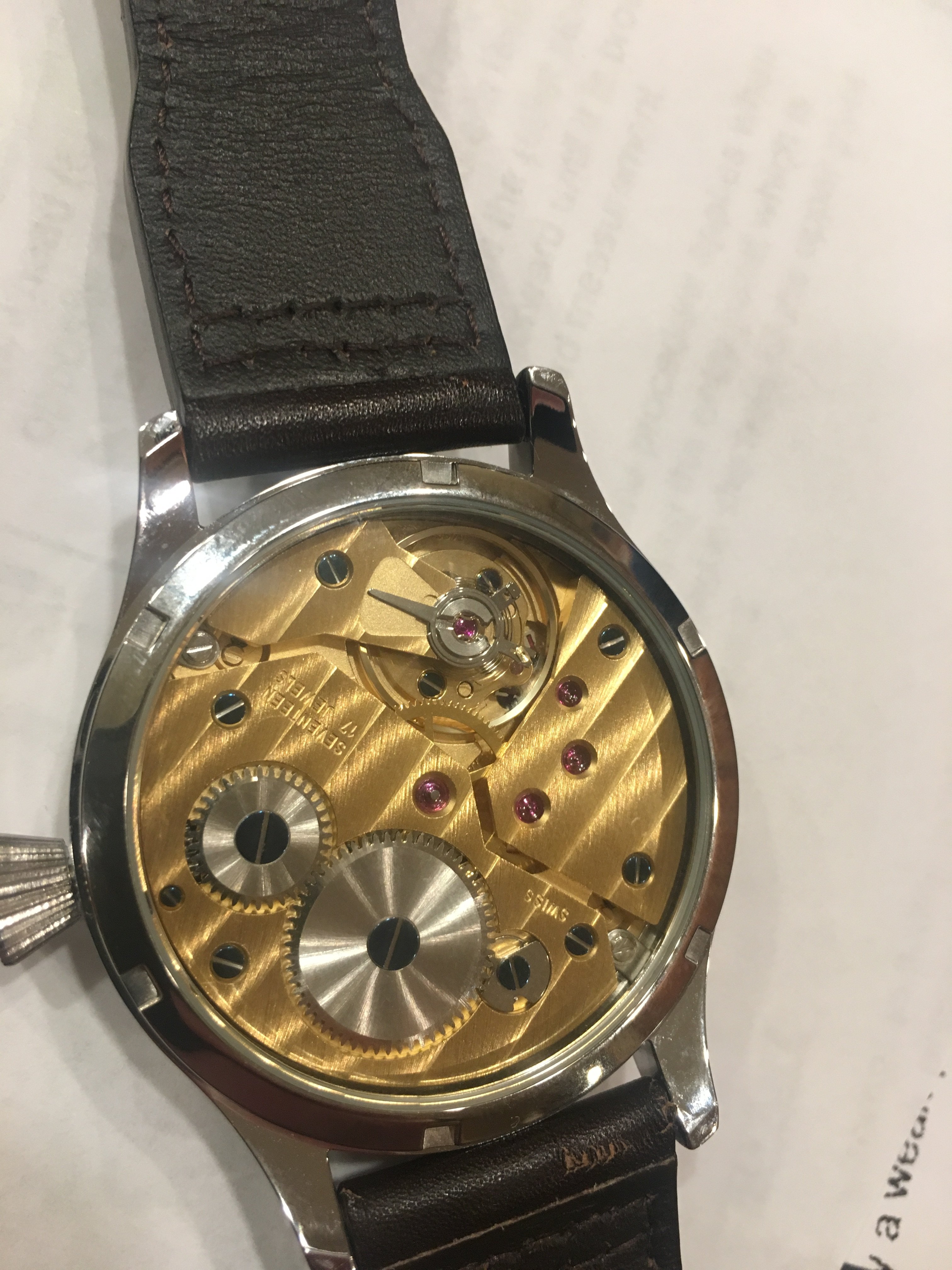

Finally i bought a two cheap ETA 6497/6498 clone watches and did some practising on these. Even though they are worse quality than the real ETA movements, i found working on these much easier then the two SEIKOS mentioned above.

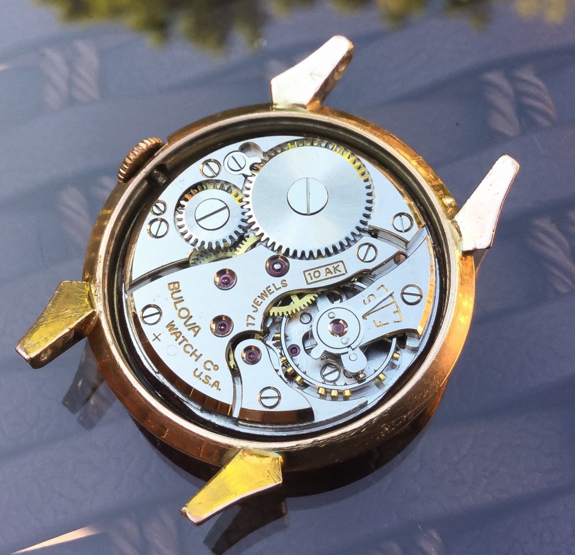

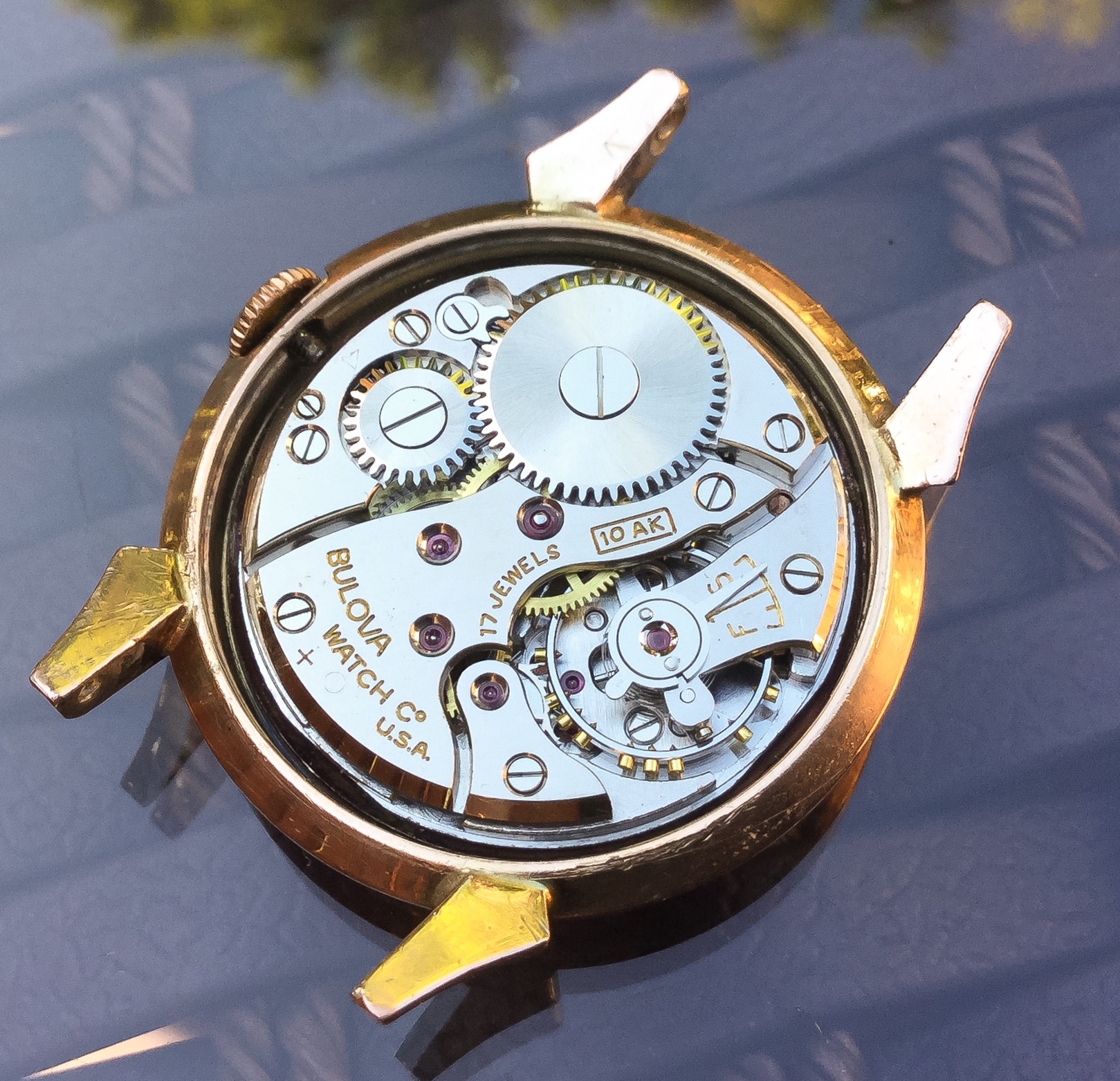

In the 20 or so vintage manual wind watches from 1900's to about 1970 that I serviced, I find in general that the older the watch the more challenging it becomes. I would stick with a watch made after 1950 as a starter movement. If you are in the US then Bulova movements is a good choice because they are inexpensive and work well.
Bulova 10AK
