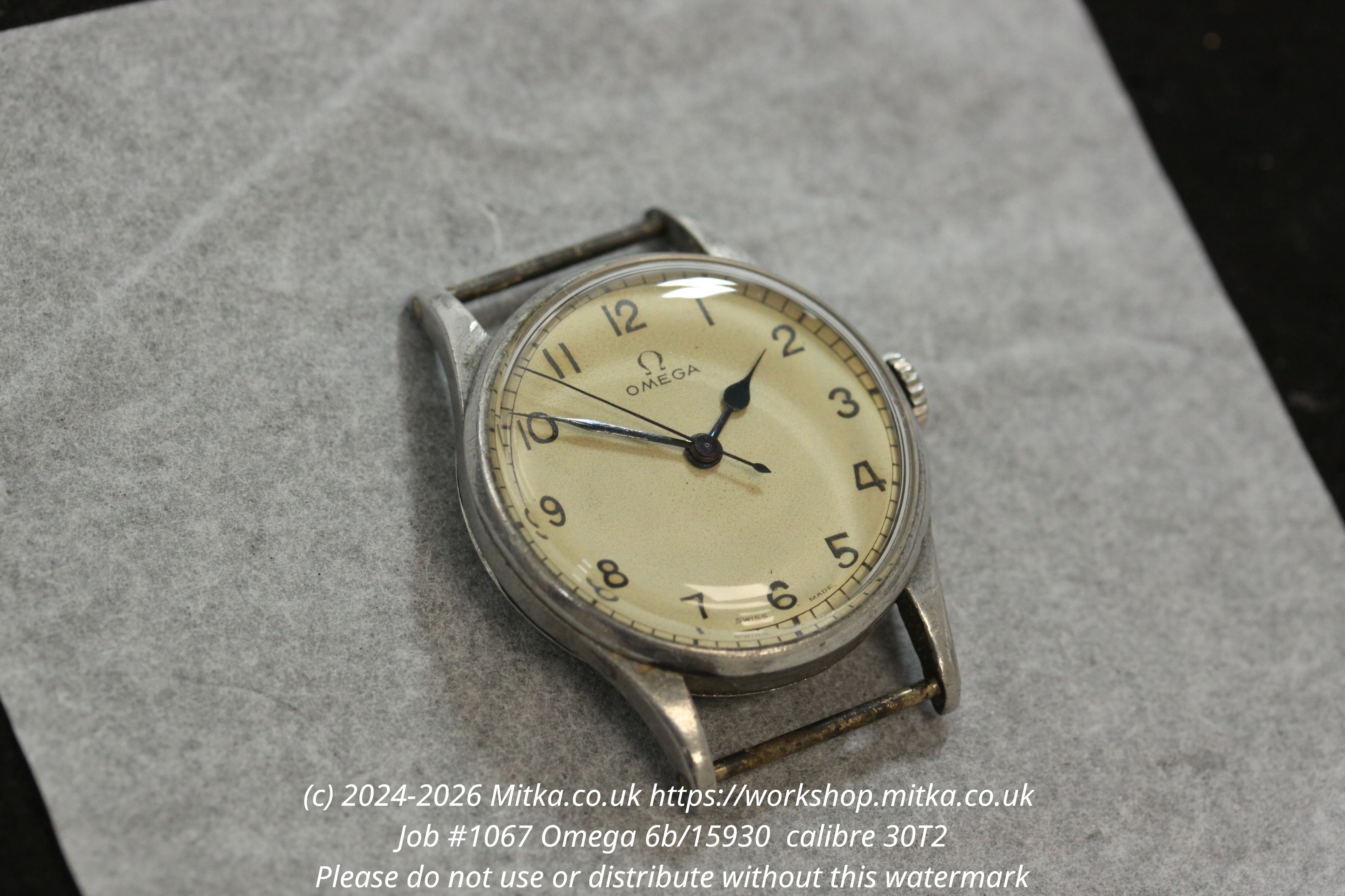

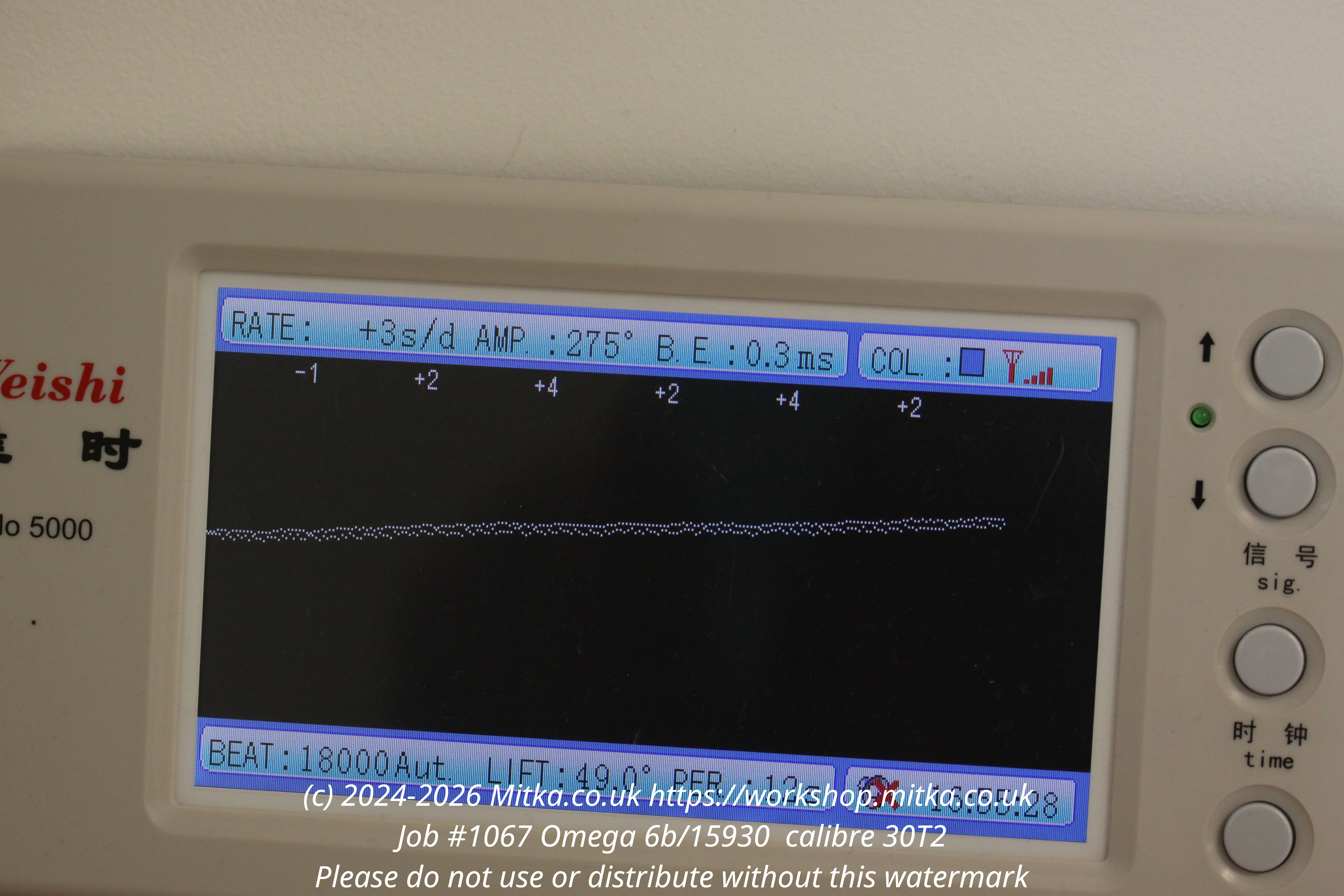

Gee I guess this 30T2 wartime Omega from 1943 was a fluke. Or maybe a decent watchmaker like Mitka of this parish can do a lot better than you suggest...

Quite honestly, this is bullshit plain and simple.
There is no "value" either from a watchmaking or collecting standpoint in keeping the position of the balance spring collet relative to the balance wheel "preserved" rather than turning the collet a miniscule amount to correct the beat error.
It is not an "invasive" watchmaking procedure, but a very basic part of doing a proper service, and any competent watchmaker would have corrected this.
You are in fact not "preserving" anything, as Omega requires that the beat error on this caliber should be 0.8 ms or less by their own specs, so it would not have left the factory with 3.5 times that value.
In addition, Omega requires that 24 hours after full winding, the balance amplitude in any position should not drop below 190 degrees. If you are starting at full wind horizontal with only 220 degrees, it is improbable that this will be above 190 in a vertical position after 24 hours. In fact it might already be below that at full wind...
You are using inane arguments to forgive a shoddy or incomplete service. Nothing more.
