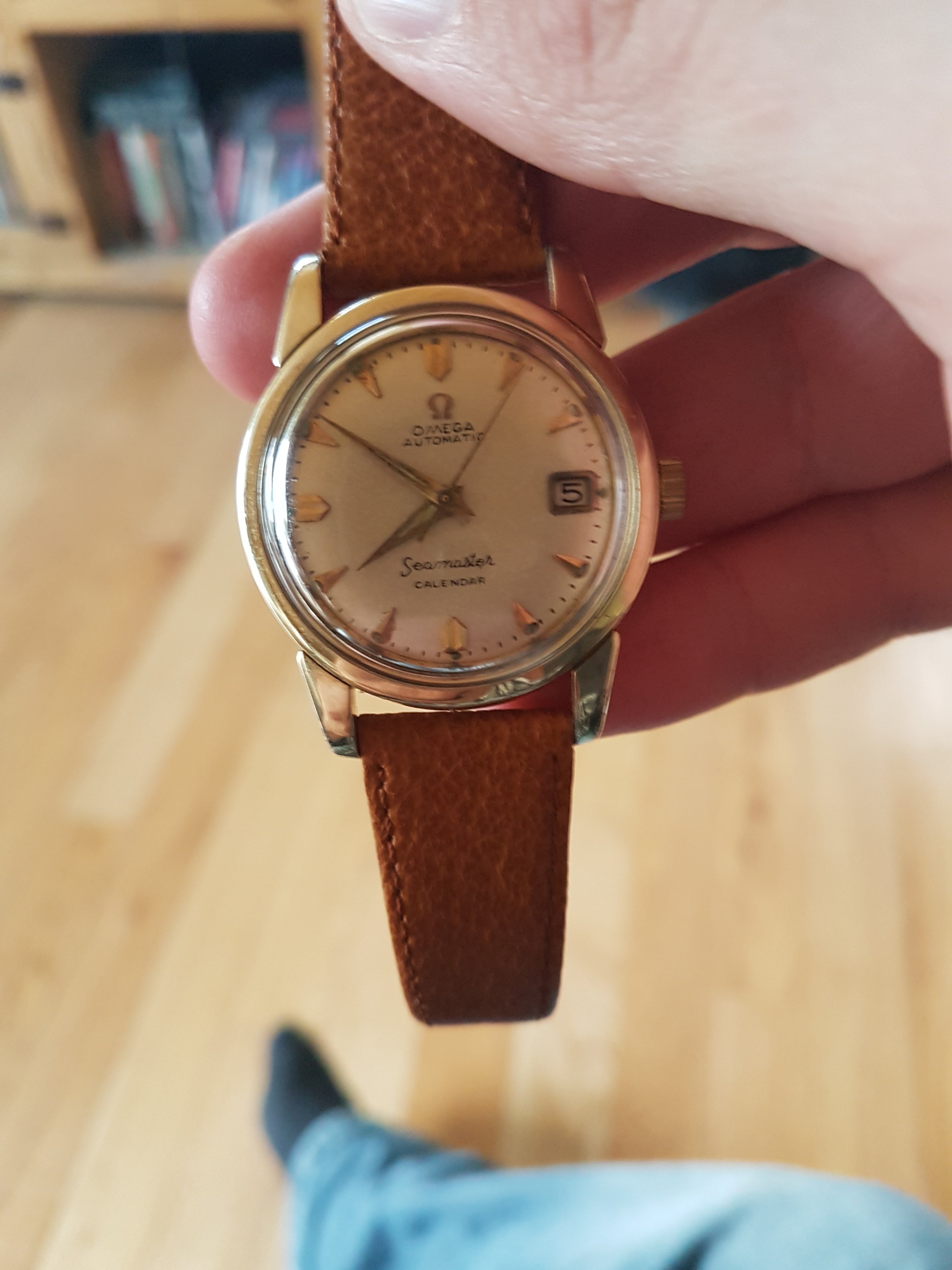

What about the 2849 Seamaster Calendar of the 50s I bought one that's yellow gold capped and I'm wondering if its 9k or 10k.

I paid $1,200 Canadian for it so if it is 18k gold capped I must have did ok

If it's a US import, it could be 14k, we would need to see the movement. But either way, the gold content in gold-capped watches is not high enough to really influence the price. It's still just a layer of gold on a SS base. The value is still mainly in the collectible value of the watch itself, which will depend on condition.

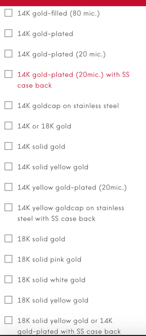

BTW, I looked at the "CASE MATERIAL" filter choices on the OVD, and it lists 14k gold-capped, but not 18k gold-capped, which proves the point.

According to the post above, gold-capped layers are at least 200 microns, while the CASE MATERIAL categories I posted show that gold-plated layers are 20 microns, and gold-filled layers are 80 microns. This is specific to Omega obviously. So it's a thicker layer than plated or filled, it is applied in a different way, and it is on a base of SS, instead of a "base metal". Notably, the gold caps don't extend over the bottom of the lugs, so you can see the stainless steel from the back side.

In all honesty from the photo I believe you overpaid as the dial is refinished and the case is quite soft (overpolished). For 1200cad you can have a very, very nice gold capped 50's Seamaster.
If it is possible to return, I would.
18,862
39,236
Gold capped cases will always look slightly softer than stainless or plated due to the capping being draped over the lugs etc and then bonded under pressure to the case.
It's hard to say how good this case is or isn't because of the poor quality of the photo.
I have to agree on the dial though.
