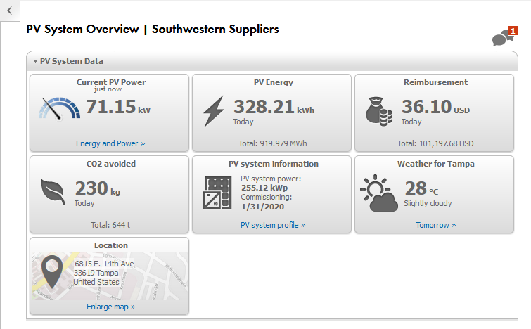

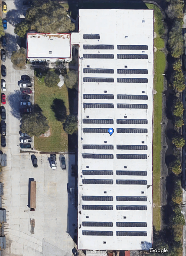

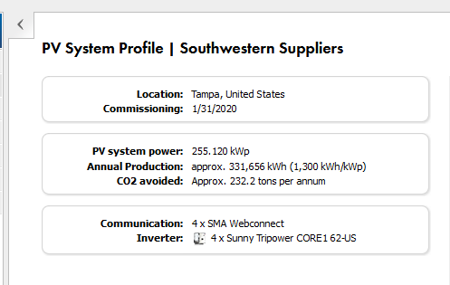

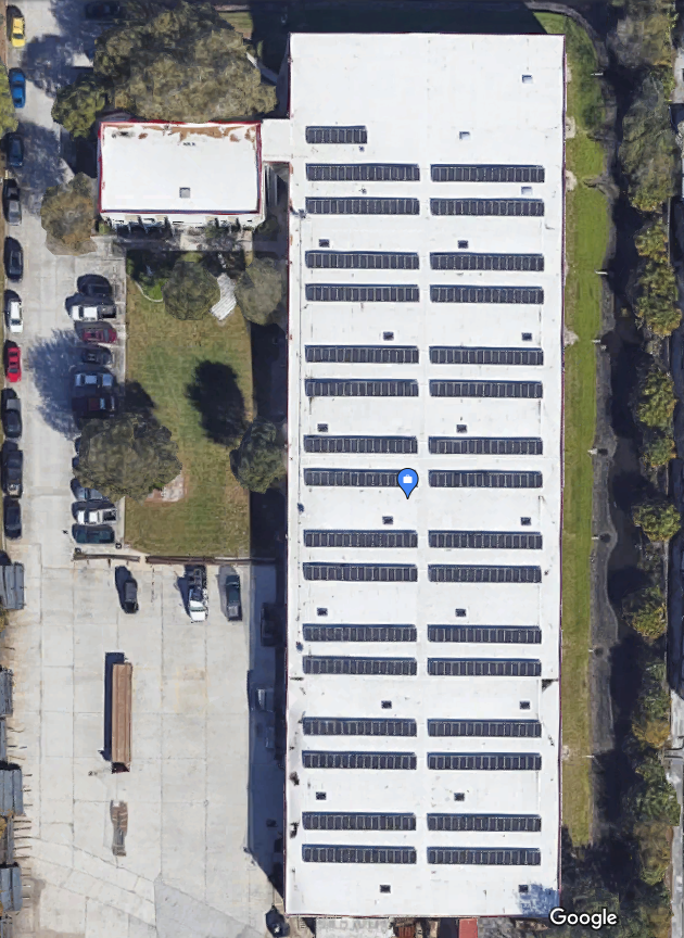

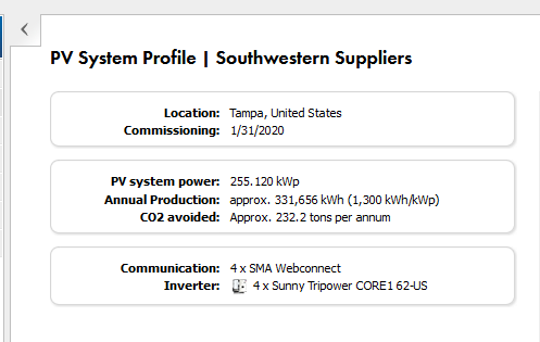

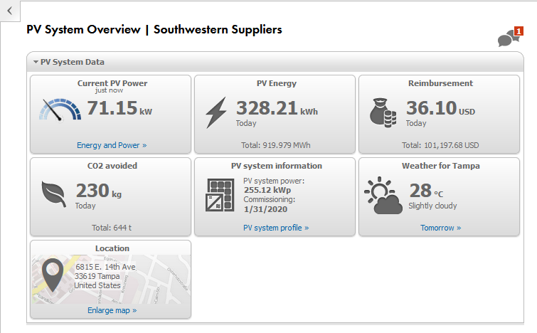

We did solar here at the office a few years ago.
That helps reinforce a very concrete solution. Do the wires mesh well with your operation?
You nailed it.

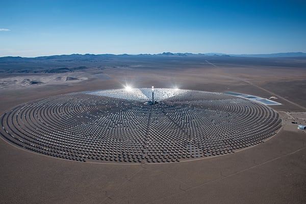

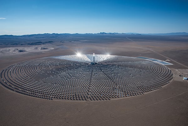

Certainly salt towers rule the cool factor.
When out ancestors discover those artifacts long after we have annialatetted ourselves they will say those 20 th century people built massive sundial clocks and monitored the celestial bodies in some cult religious ceremonies and how they transported those materials which were foreign to the area over vast distances to build these religious artifacts to perform pagan rituals.
What goes around comes around 😁
4,108
7,067
It’s a huge bird barbecue.

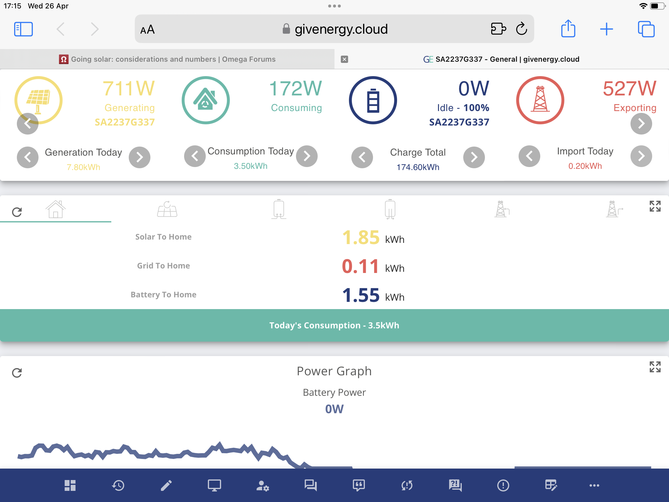

With you all the way! I installed 13 x .375kWh panels and 2 x 5.2 kWh batteries, this month, my electric will drop from £140 to £40 per month.

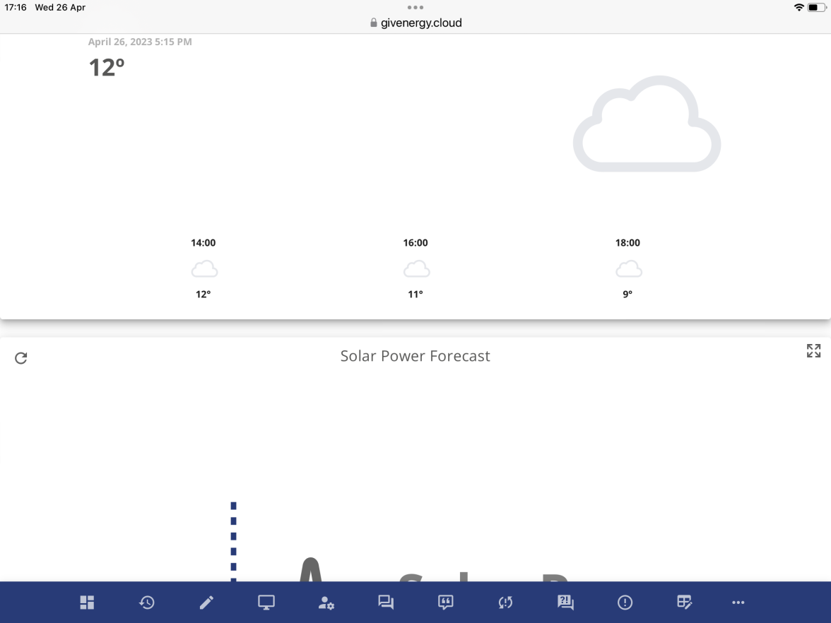

They are called solar panels but you don’t need full Sun cloud on mine today in South England.
Oh, and that is without the feed back tariff payments I will accrue for winter use.
If anyone wants to look into solar I recommend a look at Octopus Energy, UK based but going world wide.

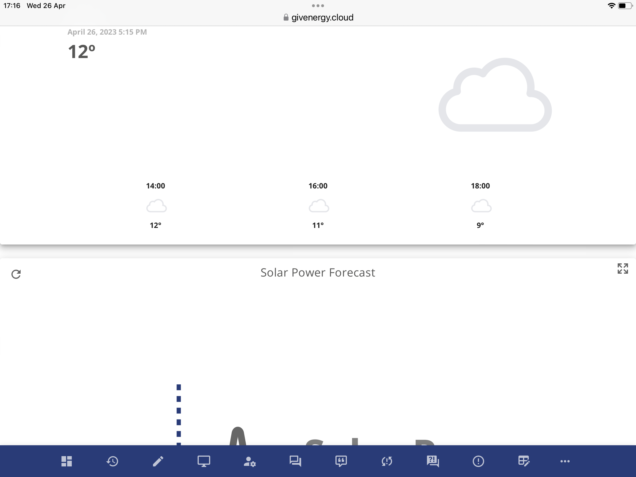

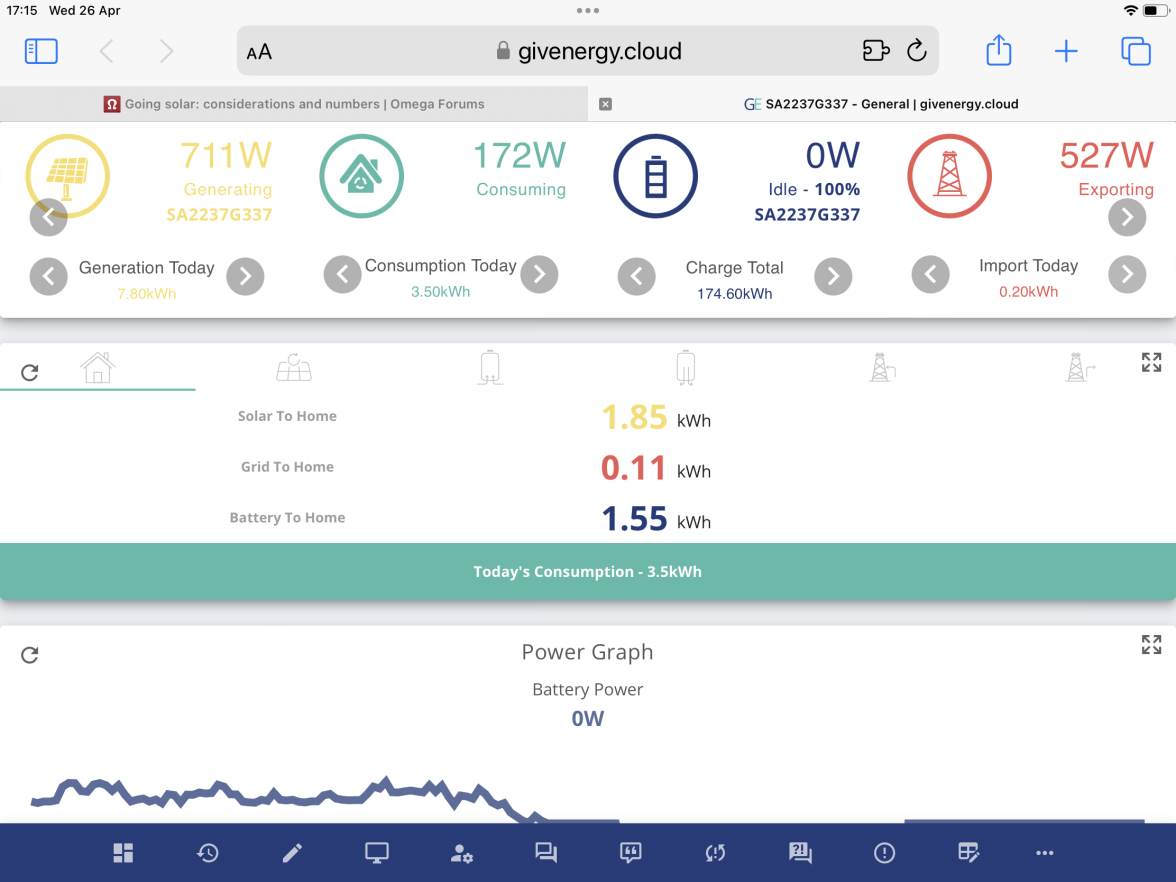

Well, October bill in today and since installation in April I have paid my electricity supplier………..nada, nothing, bugger all. In fact they have paid me a credit of £120 so my previous £140 downed to £40 a month estimate was wayyyy off.
The worst 3 months are coming but as I set up a £50 standing order payment in April expecting a bit back after a year my account stands over £500 so come spring I will cash in.
The summer in the UK was mixed, we had a really hot & sunny burst but also a lot of the usual grey, I am amazed at the amount of charge I get on a cold sunny day, they perform better when the air is cool.
How is yours performing @Shabbaz ?
