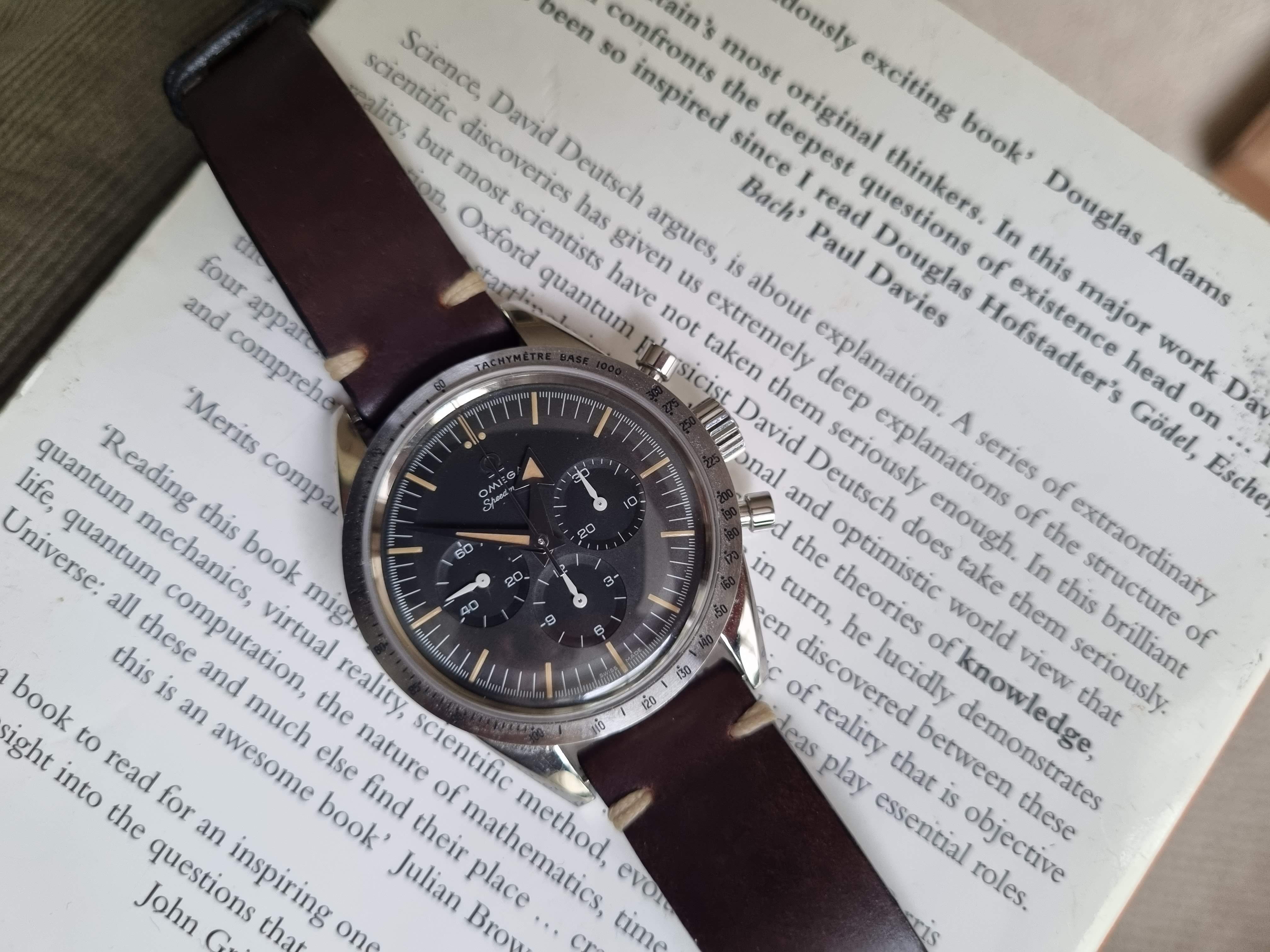

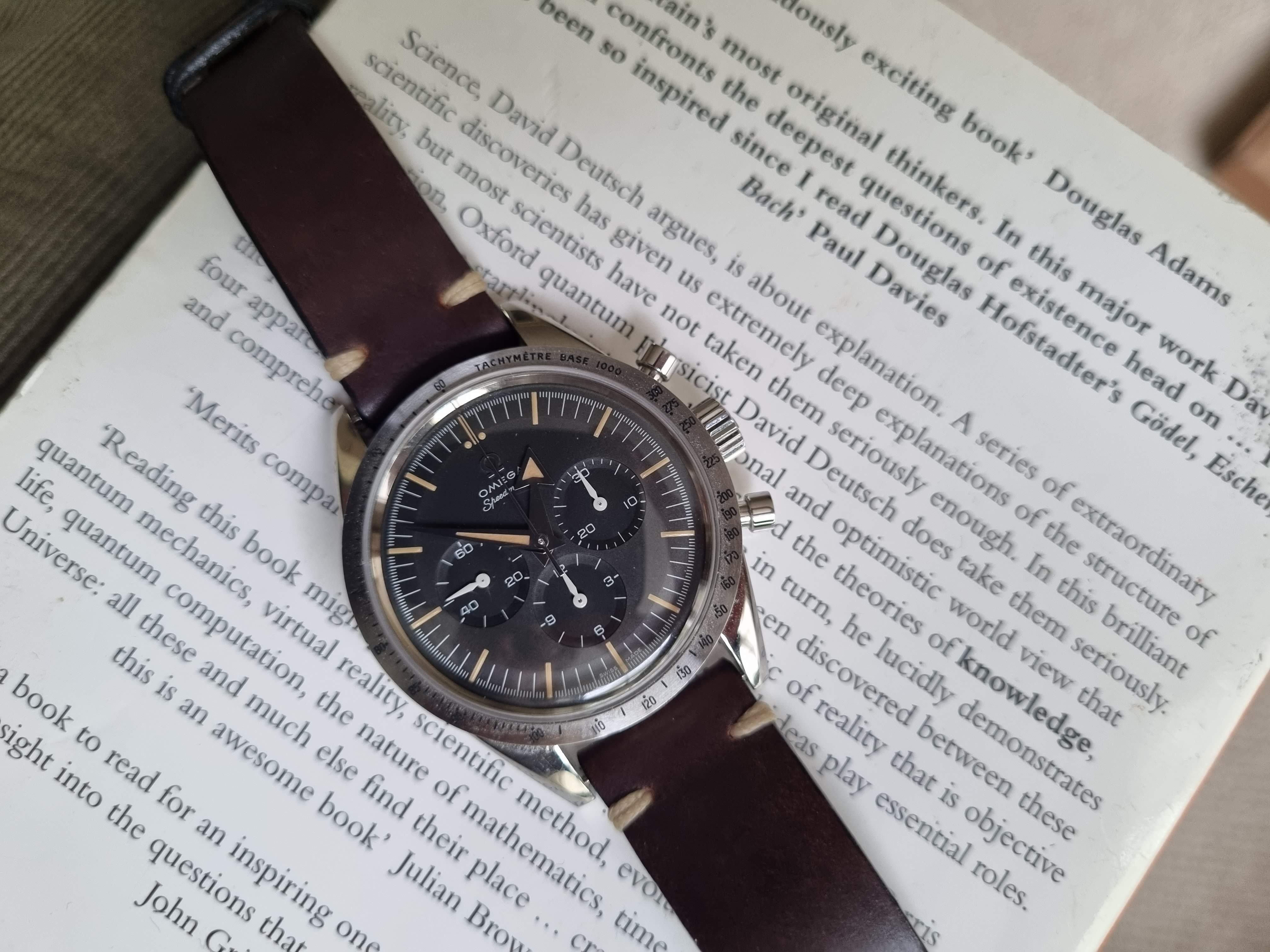

As i like to semi-continually switch straps, this one is really annoying me. For some reason, i can't remove the spring bars on my '57 Trilogy, and can't work out what i've done. There's a chance i put some 'fatter' bars in to stop a loose strap from dangling around too much (particuarly as this is an 18mm strap in a 19mm-wide lug width case), but that shouldn't affect things? i can get my spring bar tool on to the shoulders, (so i didn't make the mistake of putting shoulderless bars in there!) and can compress them, but seemingly not enough to get them out.
Did i put 20mm bars in there? if so, how did i get them in? and either way, if i got them in okay, why are they so difficult to get out?

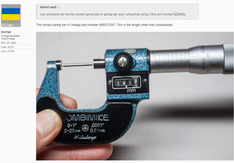

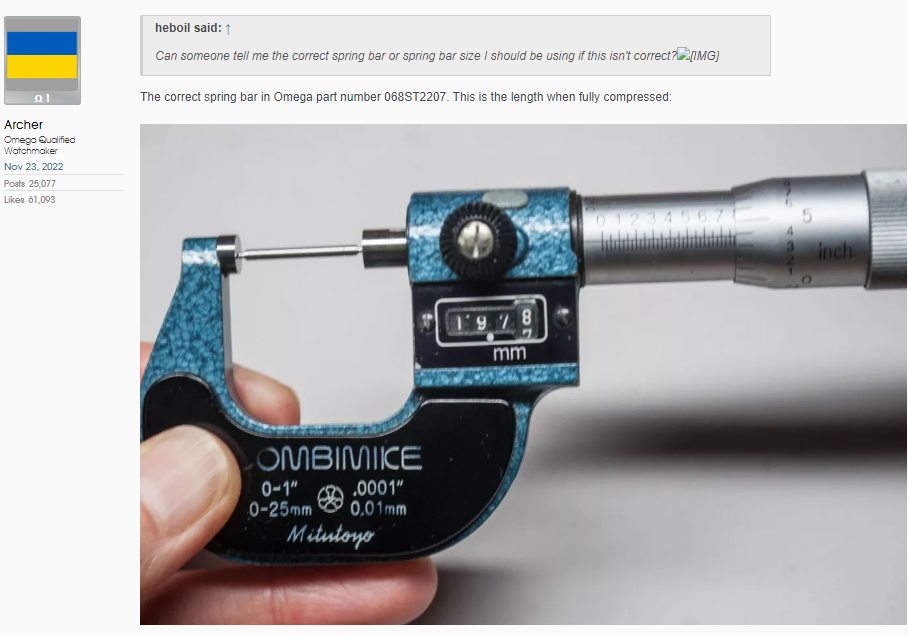

The 2207 (used for a 19mm lugwidth watch when on leather and 20mm lugwidth watch when on a bracelet) is 19,78mm fully compressed, free length is 22,428mm.

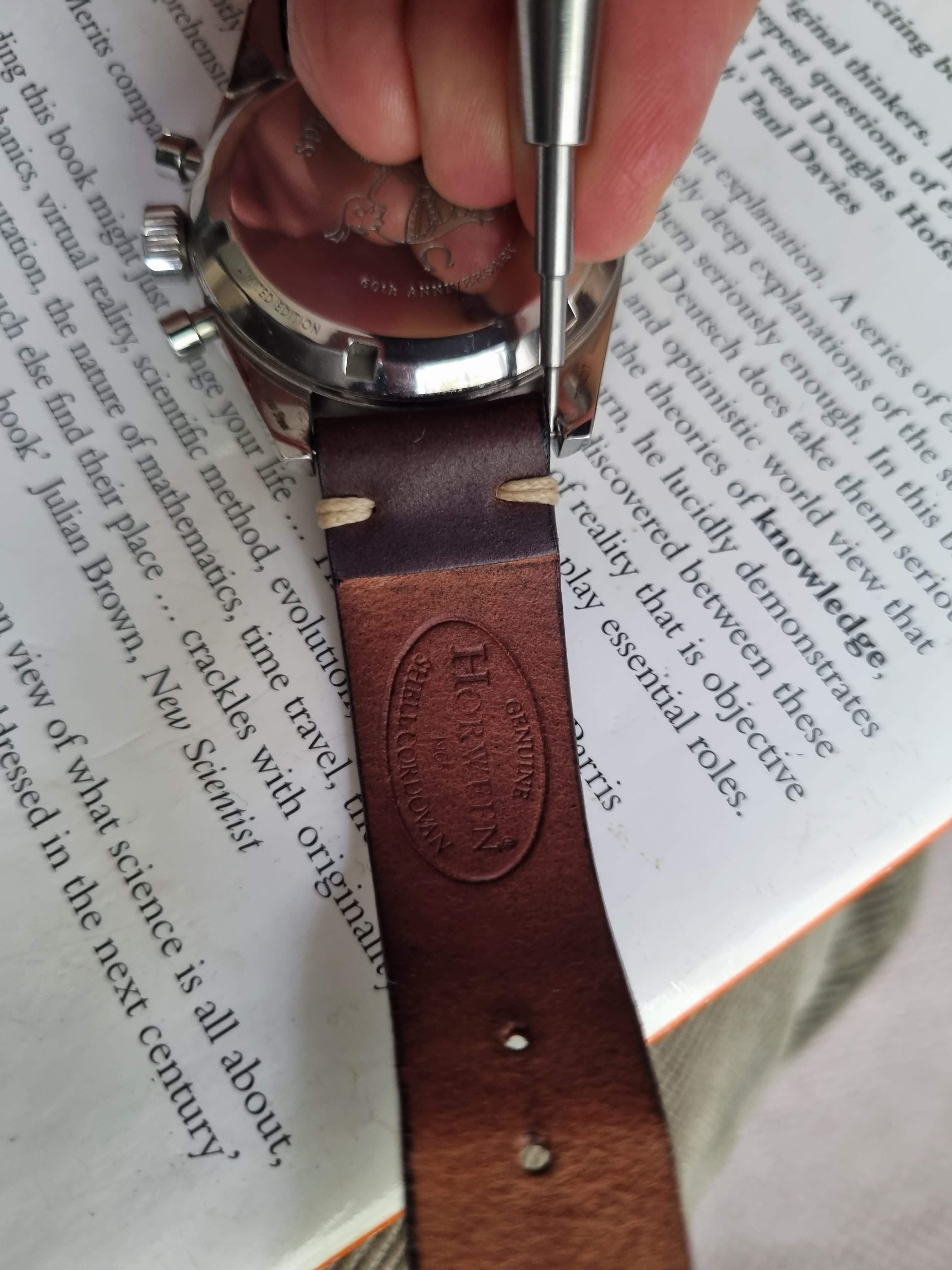

That's odd, if they went in ok they should come out with no problem. It's possible you used too long a bar and you were able to slide the bar across the lug's surface to allow it to drop in, but now you don't have the leverage to repeat the process. Are you pushing down on the strap from the top as you compress it?
215
305
Good shout! i wasn't. A little downward pressure and they snapped out. Thank you very much.

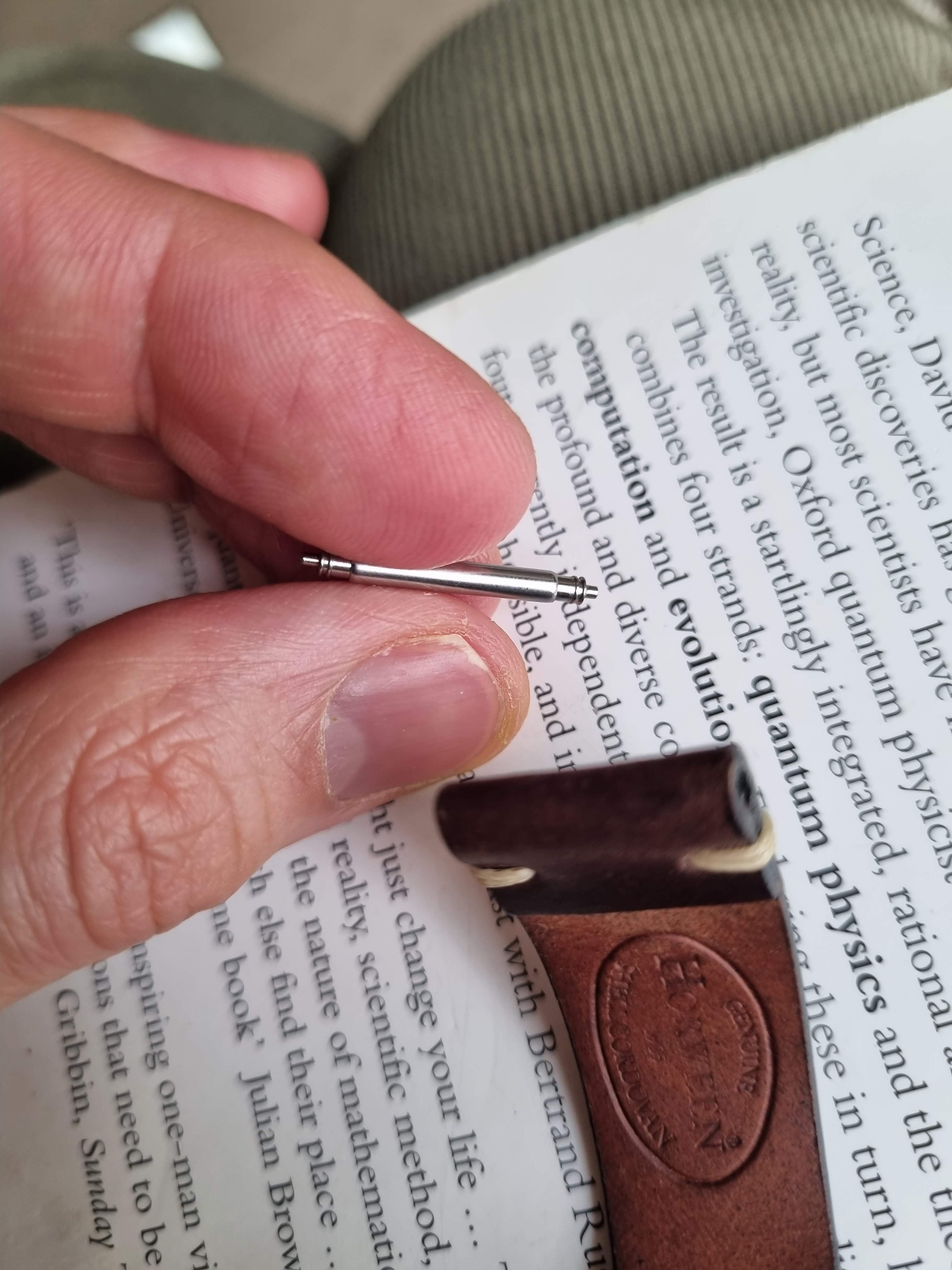

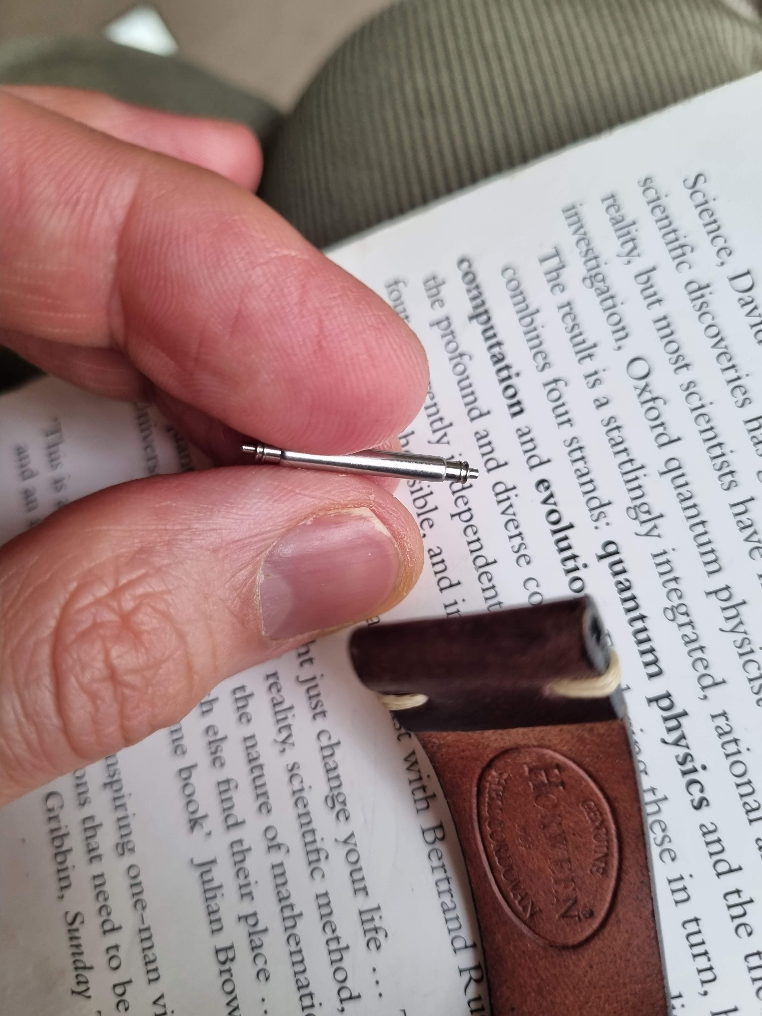

Attached a photo of the bar : 19.89mm fully compressed, 22.7mm uncompressed....so sounds like the wrong bar to me, but your note above suggests otherwise?

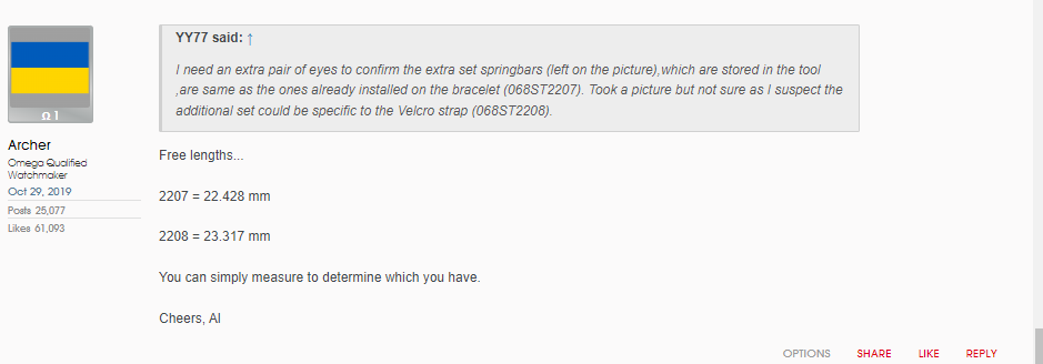

The 2208 is even longer;
Interesting. So what size spring bar should go in a 19mm lug-width watch? or is it more complicated than that? i have a range of 19 and 20mm lug width watches and have never struggled so hard to get a pair of bars out (except an OEM pair on an Ed White a few years ago..)
6,441
31,664
068ST2206 bracelet
068ST2207 strap/nato
7,780
14,376
For a 19 mm bracelet -- 068ST2206
For a 19 mm strap -- 068ST2207
