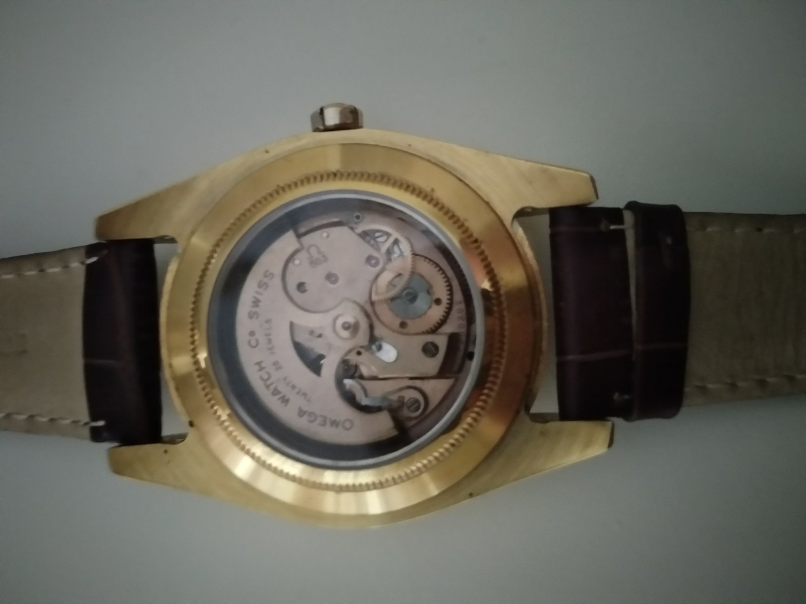

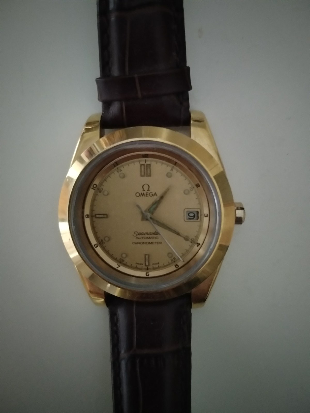

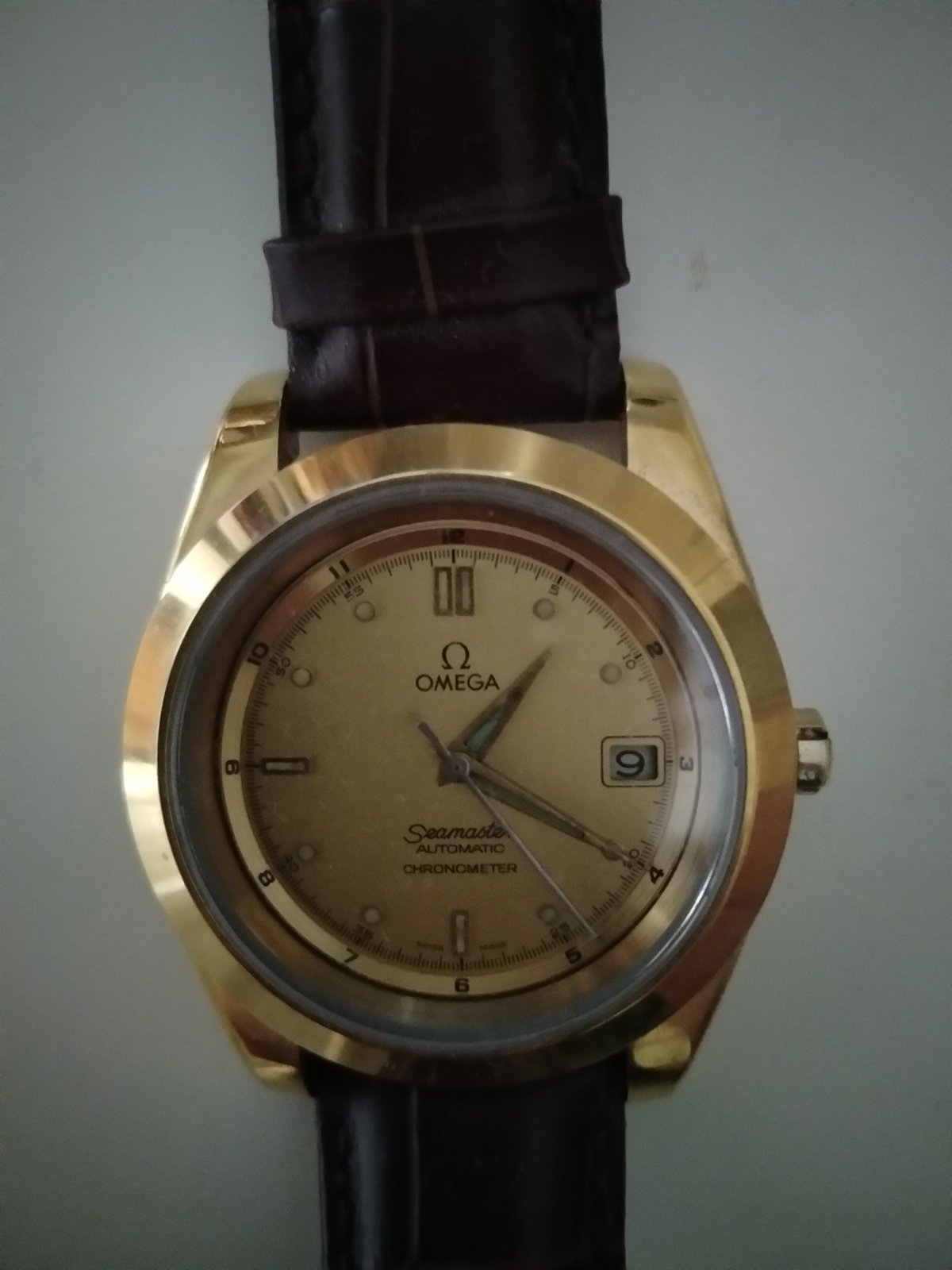

Hello to all, im new here...I want to buy this watch and I cannot tell if its replica or not...do you know this model I cant find it nowhere as it is..thank you for your help

The vintage movement appears to be genuine, but it has a dial on it that came along maybe 40 years later (and was never used on this movement obviously), and it's all in a suspect case. I'm not sure anyone would call this genuine.

It looks to me as if the movement is not really a chronometre, as opposed to what is stated on the dial, but in order to check that you will have to read the number under the omega sign and post it here. Granted, I'm kind of a newbie so let someone more experienced be the judge.

Possible to be a "franken" watch? ..waiting for replies to more experienced members..

Not sure what else you need to know tbh. I’m only replying because you asked again, my expertise is merely a fraction of what @Archer has to offer and I don’t think there’s much to add.
A cal 503 is no chronometer movement by the way, as @BroMega mentioned.
This is just a pile of parts.

What a bizarre combination that is…
