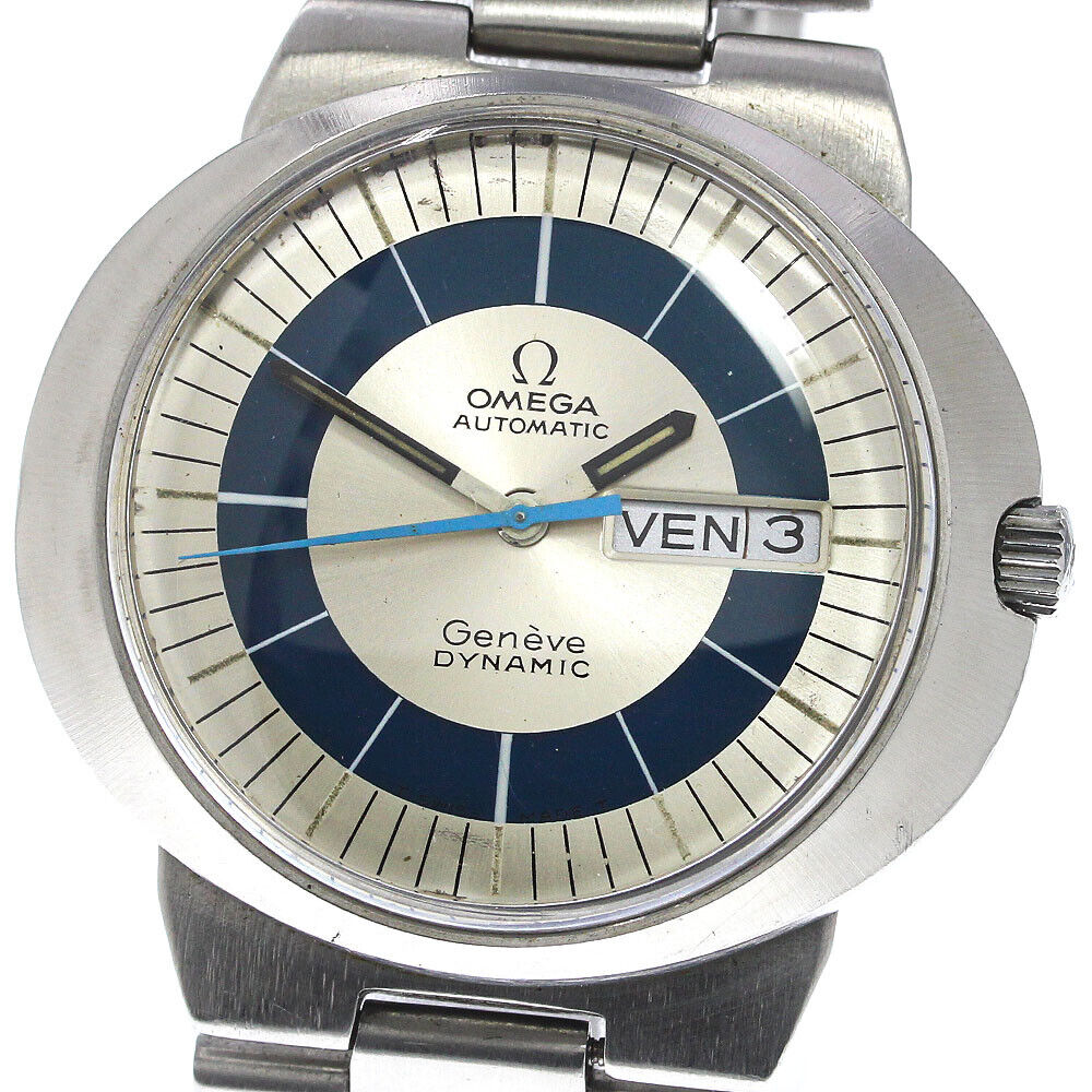

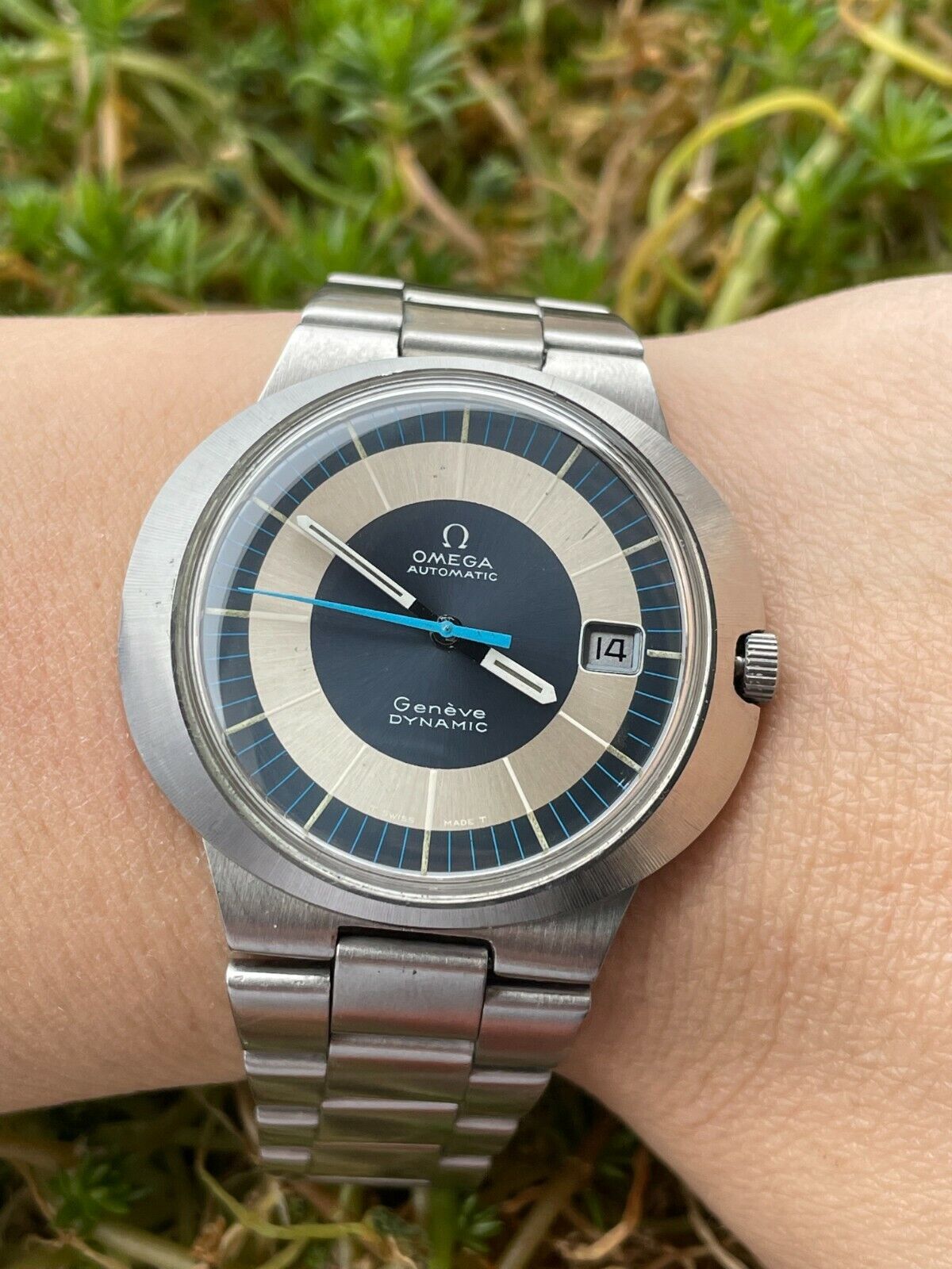

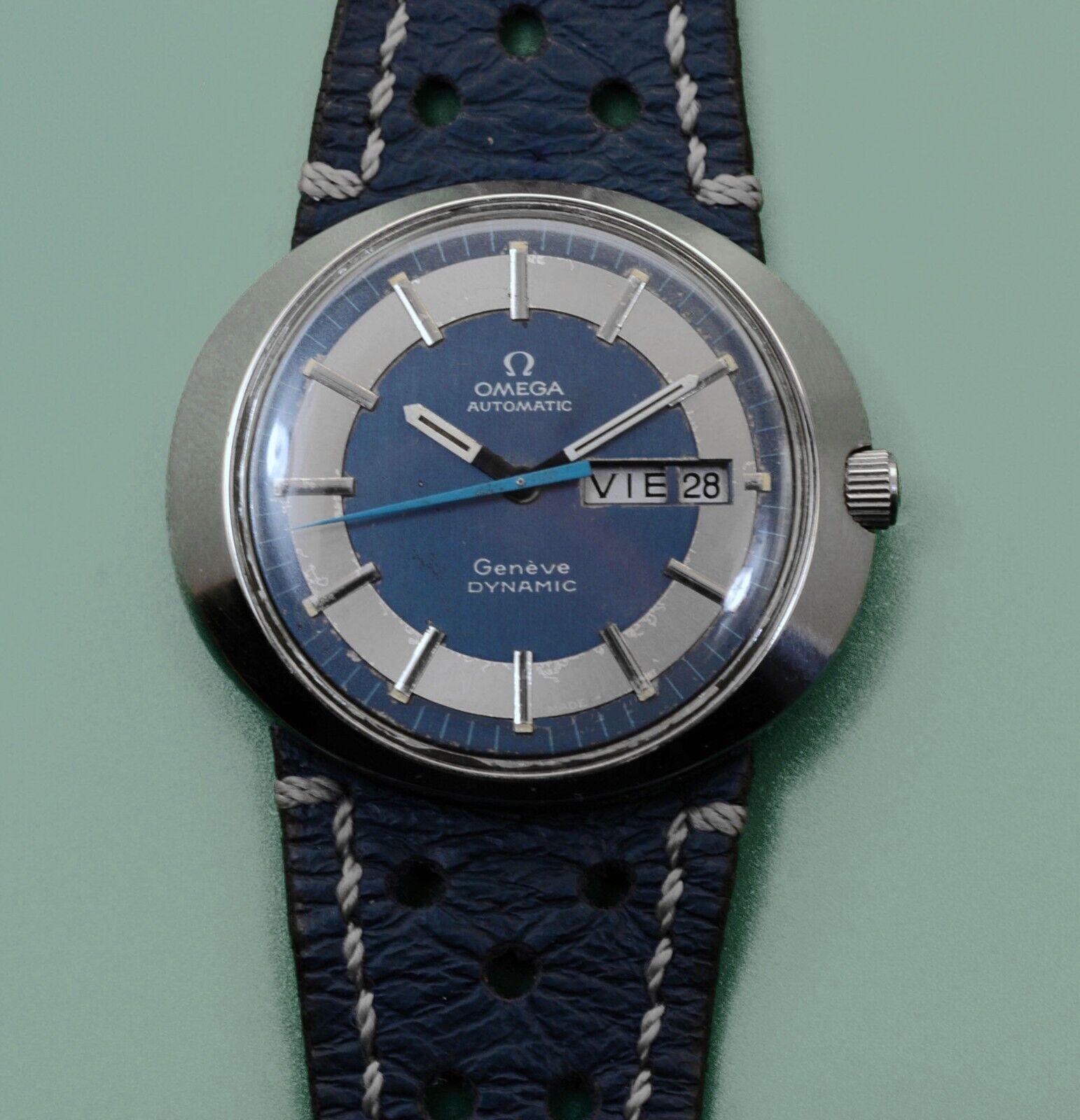

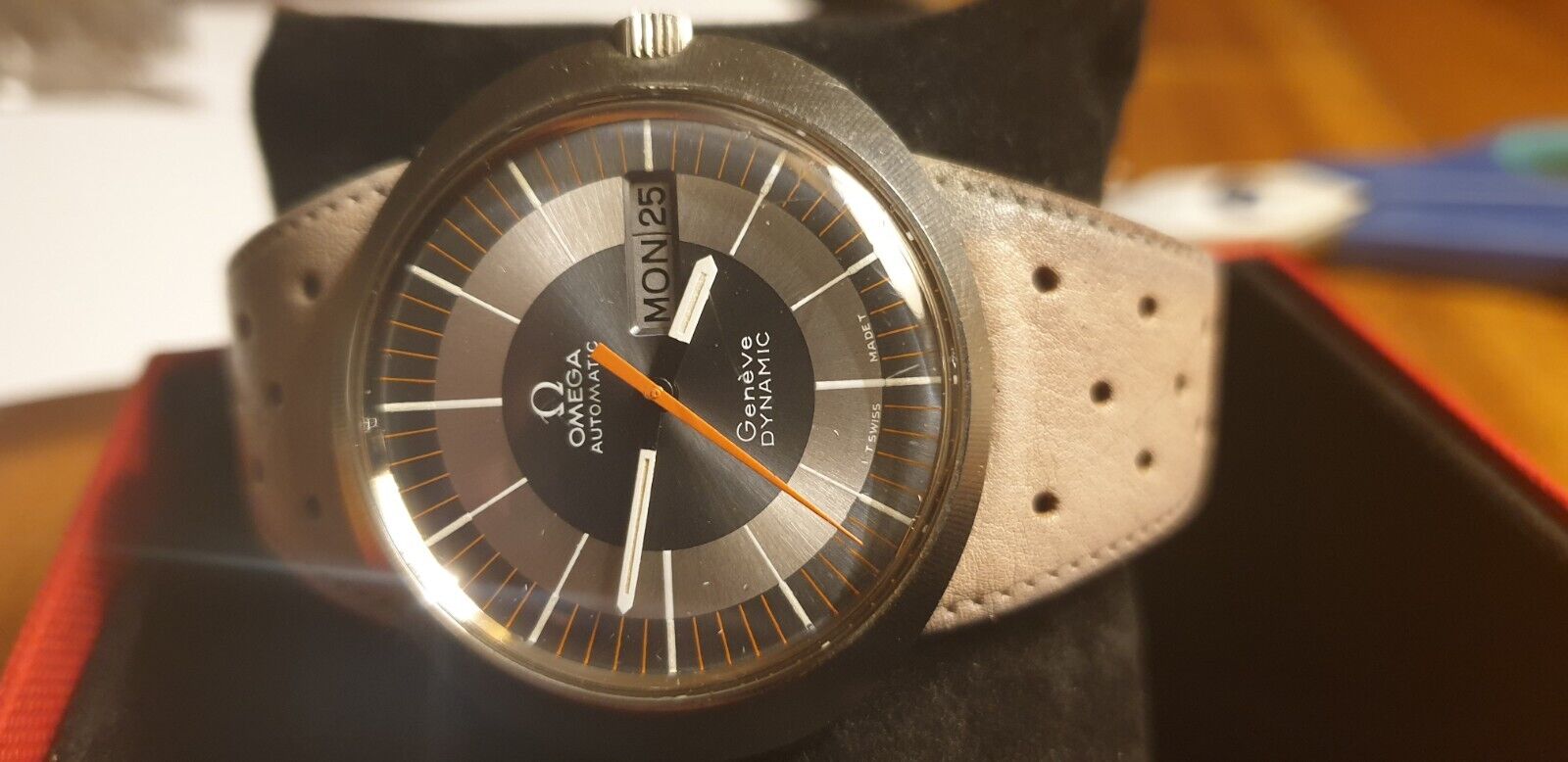

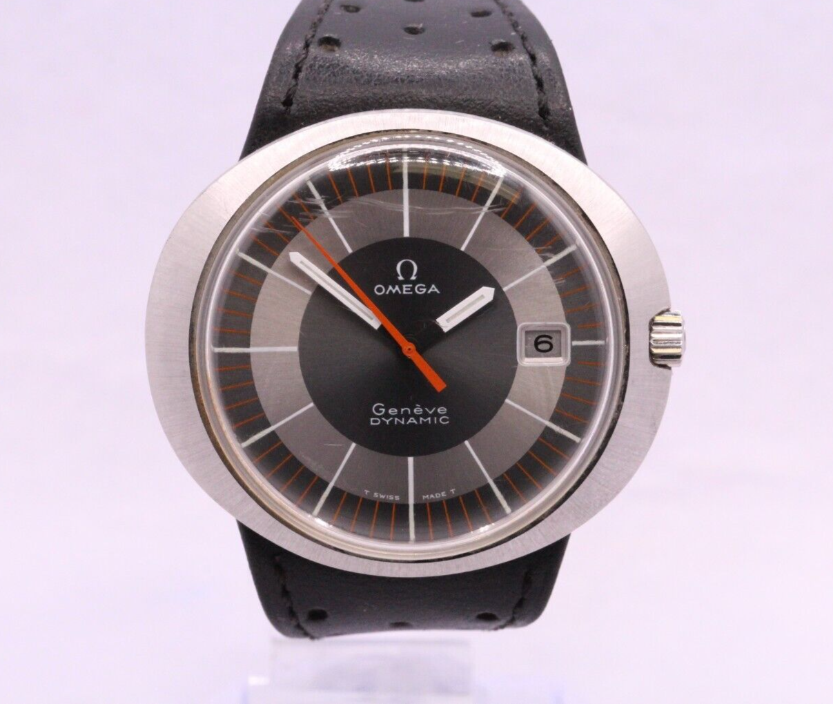

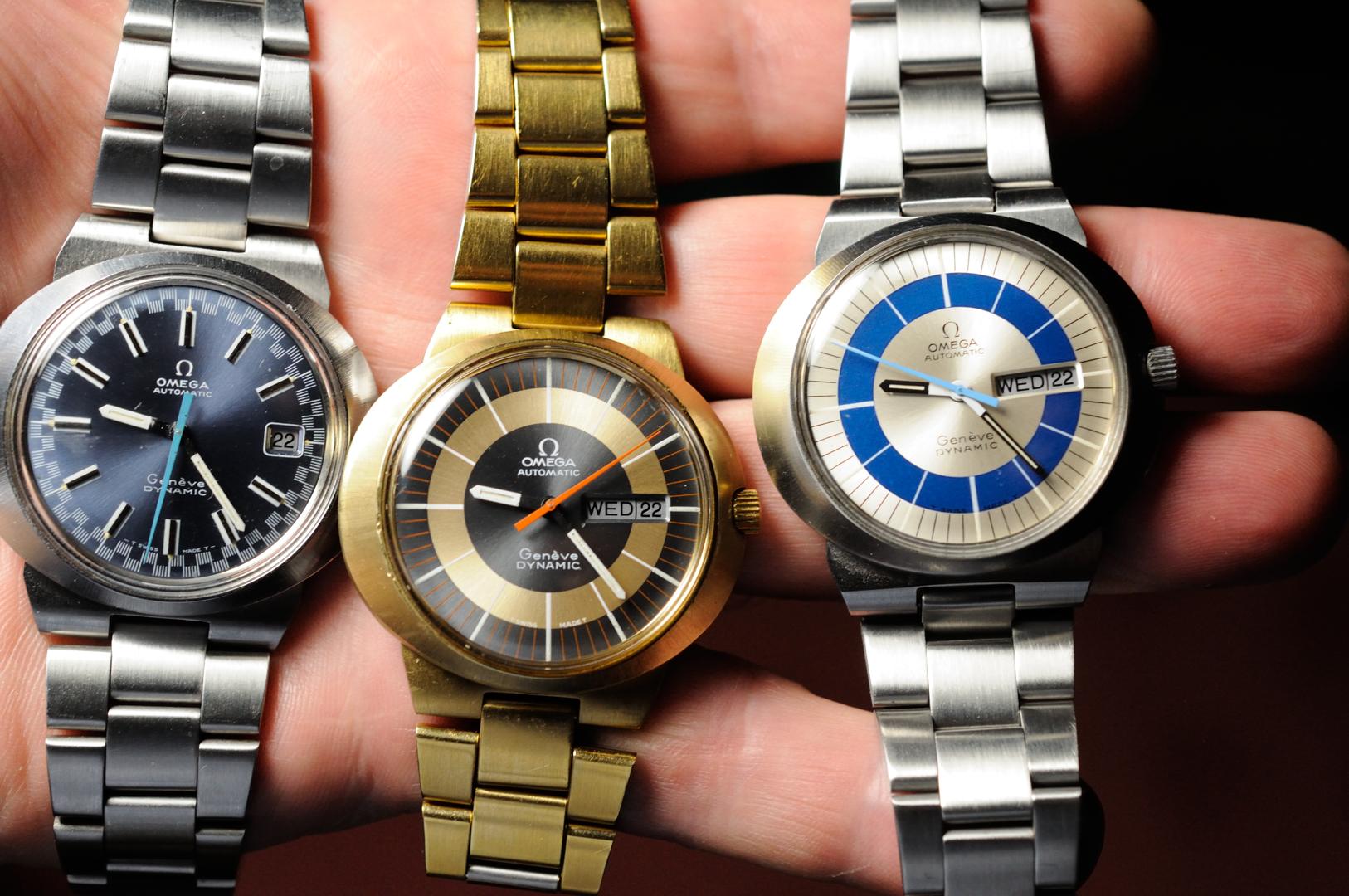

Here are photos of available Geneve Dynamics and whether I think they have been re-dialed or not:

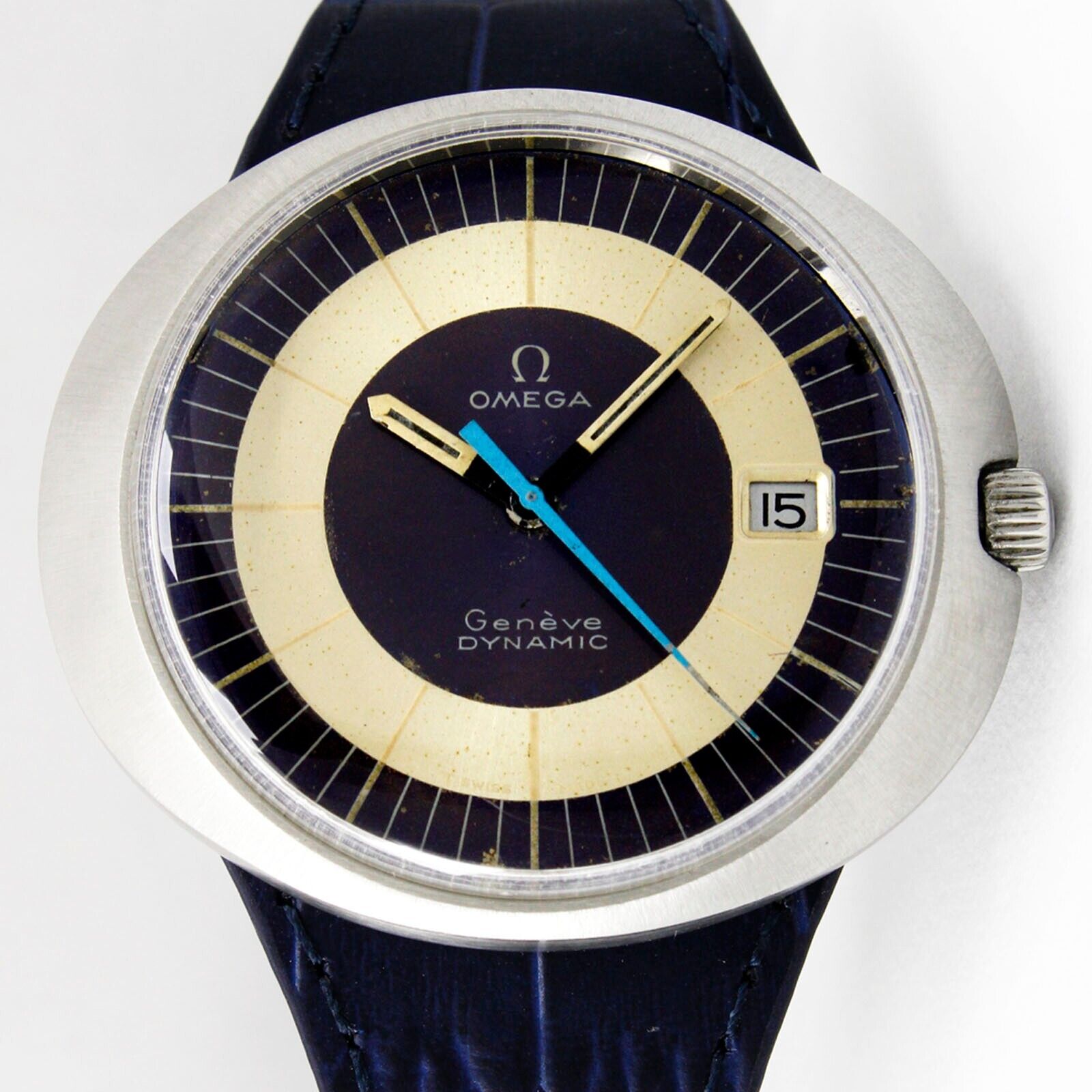

^ Dial looks repainted and the seconds hand is the wrong color for this dial

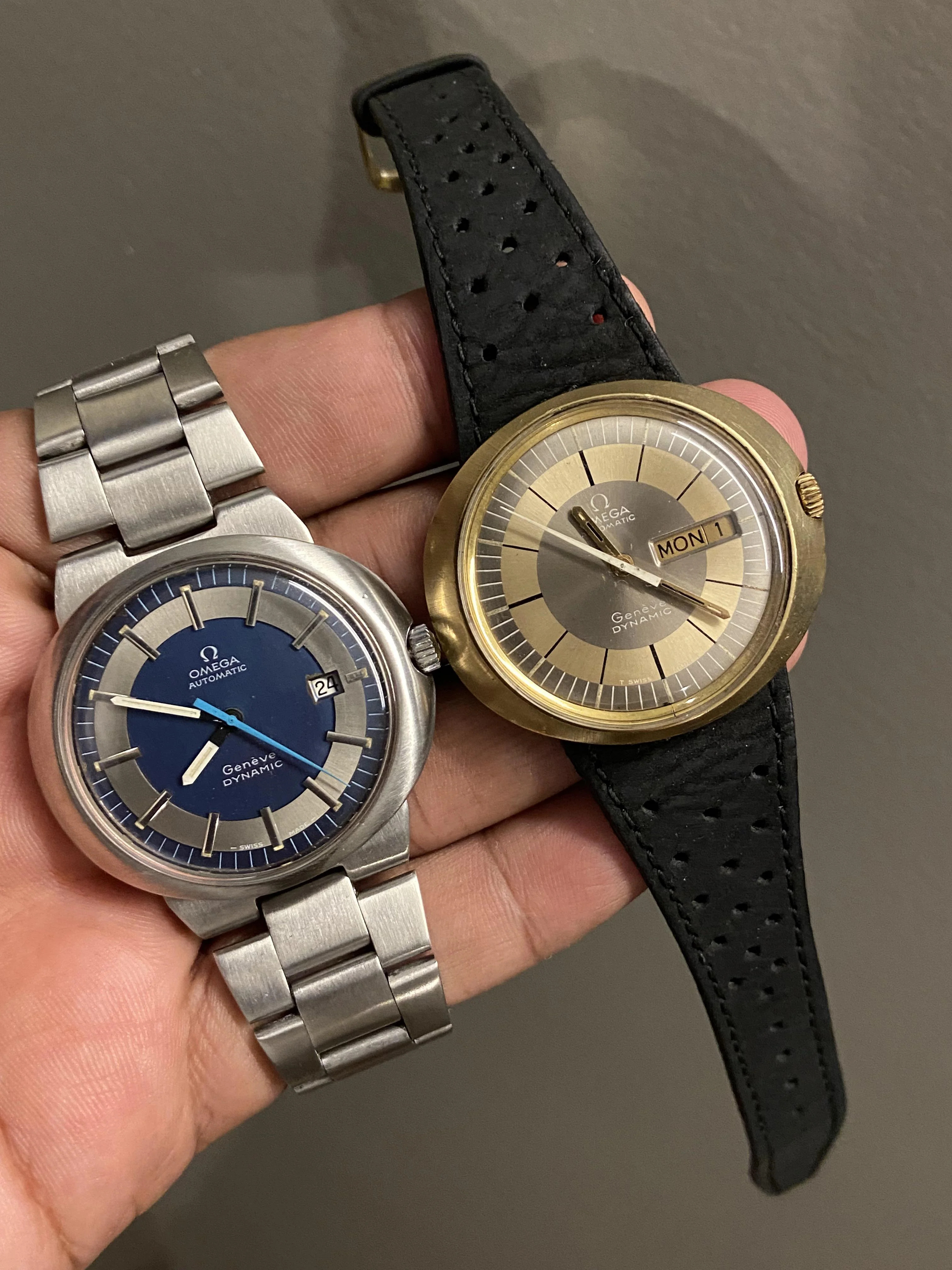

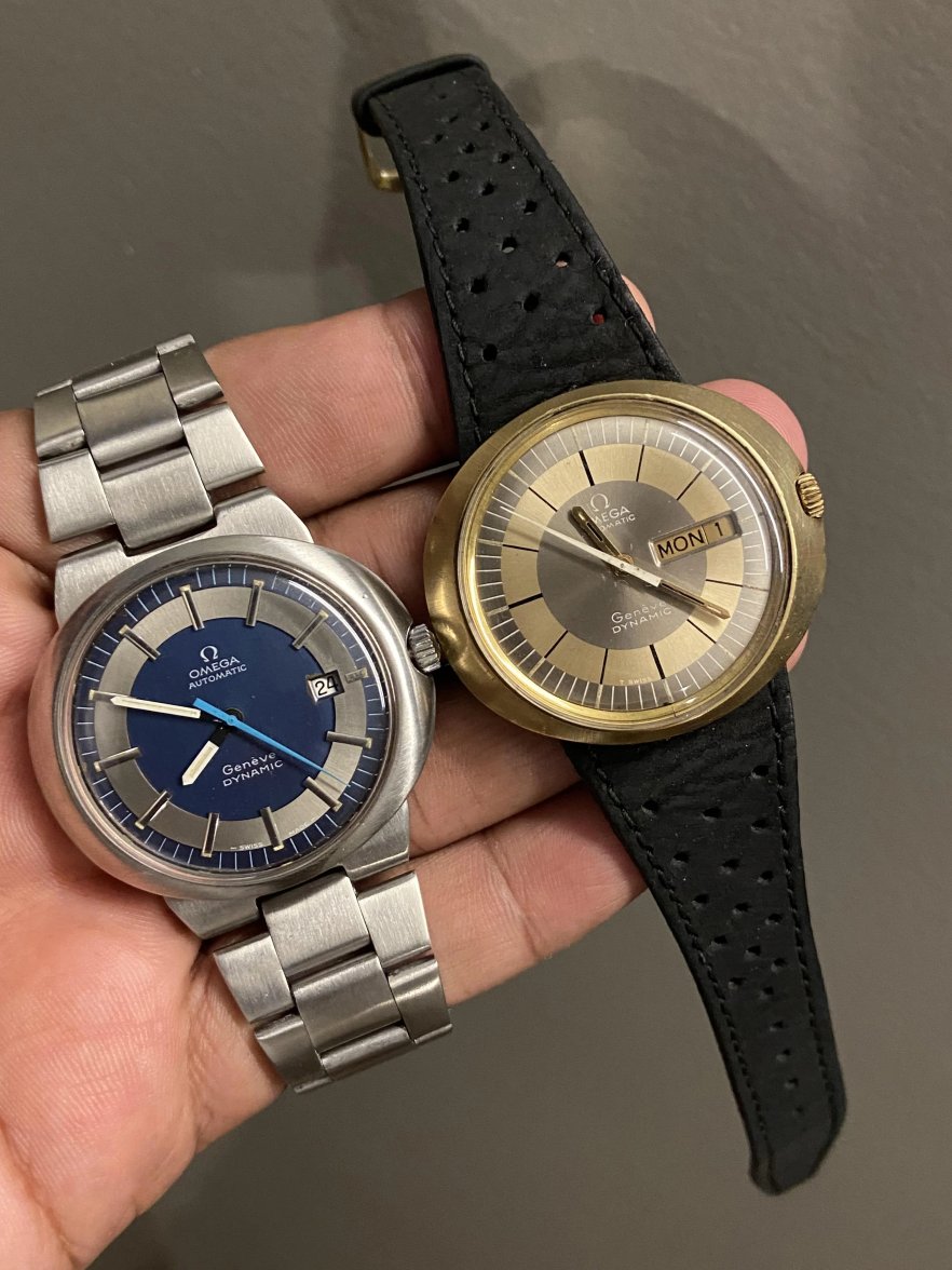

Right is badly redialed with wrong black coloring in inner ring. Left has riveted markers and date, which doesn't match any reference I've seen. Could be real but since one is redialed the other is suspect.

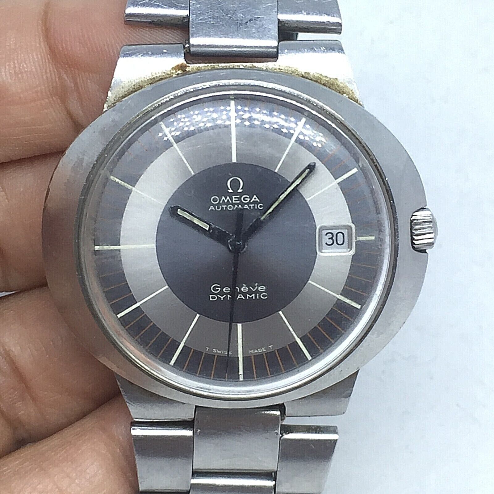

Omega logo looks too thick and is suspect, but rest of the dial looks correct.
Looks legit

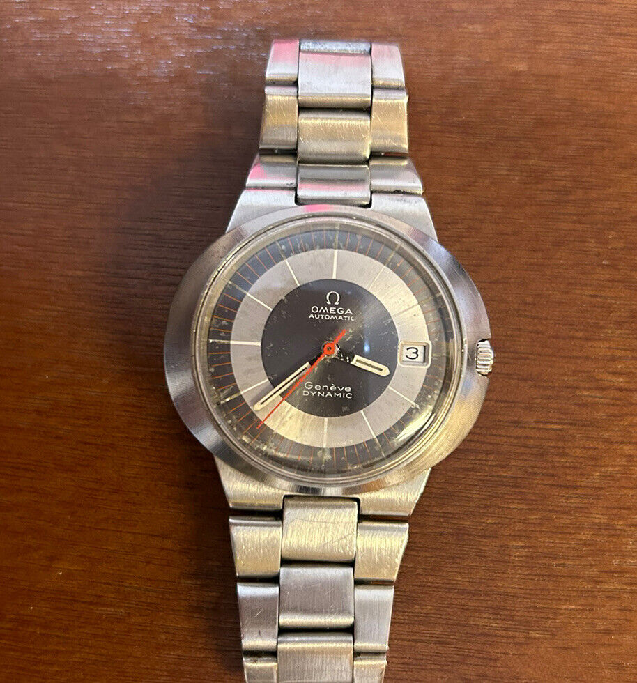

The inner ring lines seem much less thicker than the outer ring, but other than this the dial looks okay... I would say painted over...

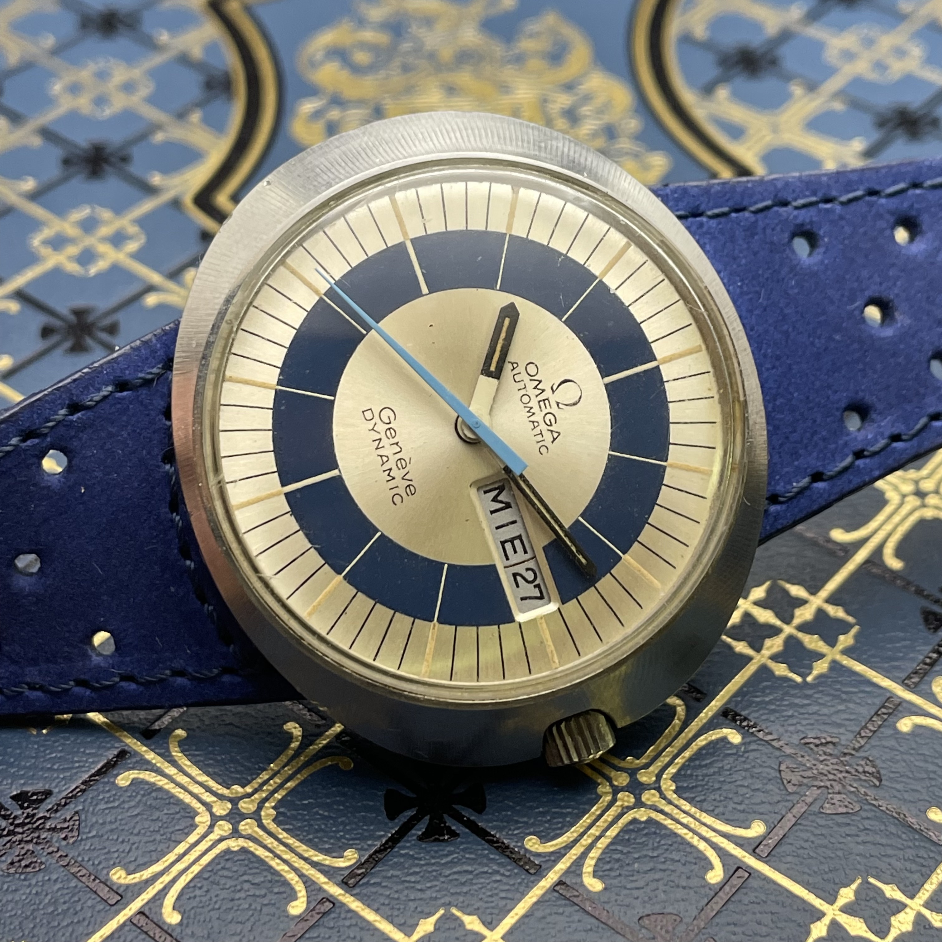

Has a Cal. 752 inside (movement pic was included), these did come with a rivetted marker option and with a day date complication, but the dial did not come with a blue division between the day and date, so this raises suspicion.
Looks legit
Omega logo looks like a redial
Looks legit

Overall, good work, but you might have to give a few of these a more closer look. All of these look like genuine dials...some of them are in obviously much worse condition than others. Most of these photos aren't that great, but I don't think there are any obvious redials here.
A few things to note:
1 - Dial seems fine, but could have had new lume added. Completely wrong hands. The second hand could be original and painted, but the minute/hour hands being wrong aren't a good sign.
2 - Both look right. I haven't seen the shade of blue on the one on the left before, but it wouldn't surprise me if it existed. That one is also notably a series II dynamic and that raised track is much more common in those models. The gold capped one also looks fine and correct, but the dial variant is an inverse pattern to the more common design.
3 - Looks completely fine. Might have new or NOS hands.
4 - Correct dial, but awful condition. Second hand is wrong.
5 - no apparent issues
6 - Cal. 752 is the wrong movement for that dial. However, the case looks correct. It looks like someone transplanted a genuine Series II dynamic dial onto a 752 in a 166.079 case (series I dynamic). Also has the wrong crown.
7 - looks correct, but the dial is in bad shape. Bad lighting, color correction, or patina has also darkened the dial.
8 - Poor shape but looks correct. Font looks a little wonky, but I think that is just due to the photo.
9 - Looks good.

The only thing I wonder is for #8 how can the "Geneve" font look so much different than every other dial and it's legit? All the letters look taller and the "e" have so much more space in the top loop than every other dial I've seen.
I think it's a variation in that dial style. As @Davidt said, the variation during this period was huge. Here is a similar one that I had:
