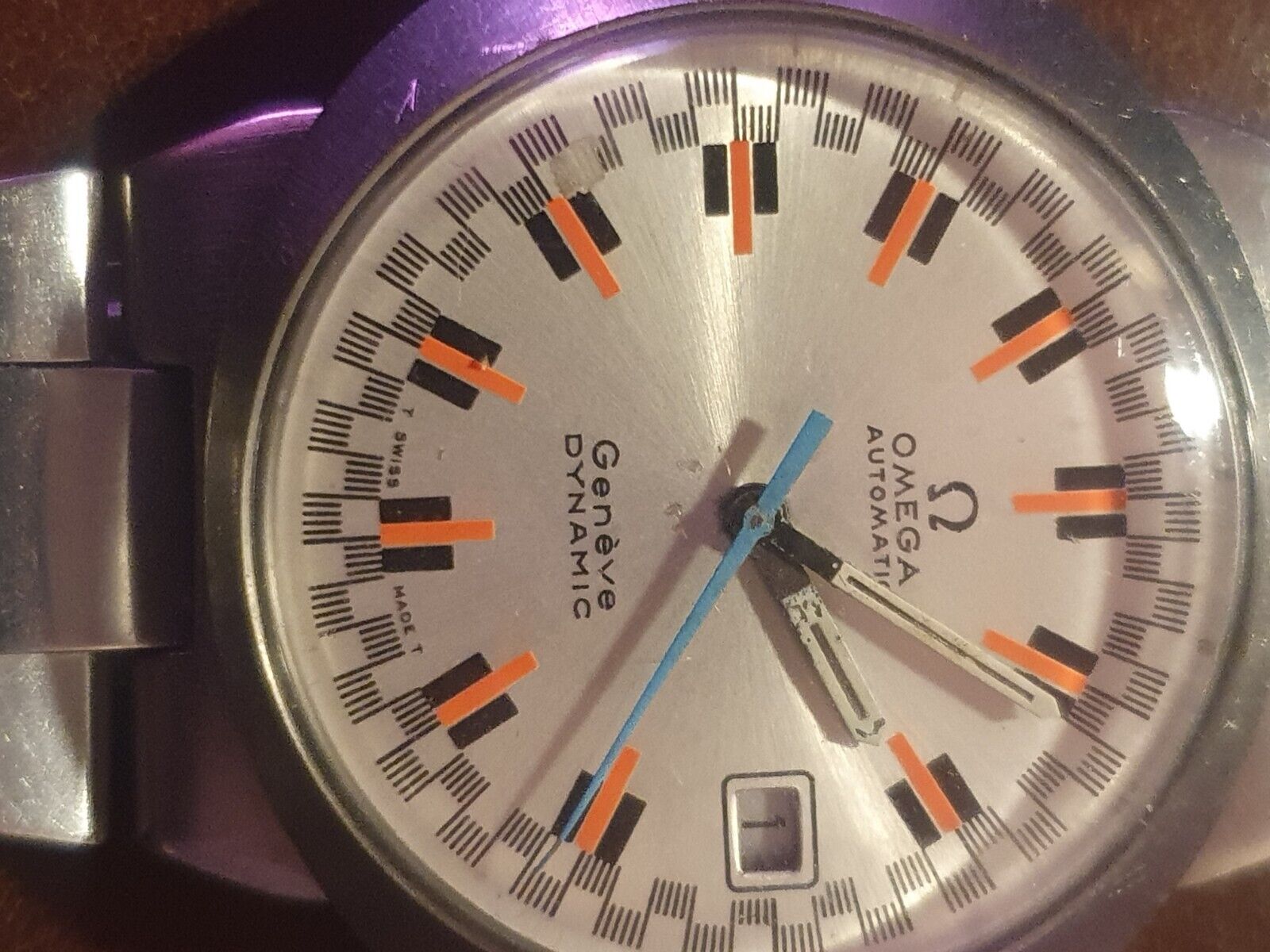

Hi All,
Hope you had a nice evening, I stumbled across a 'racing dial' Geneve which took my fancy although from knowledge and reading I am pretty positive the second hand should be orange. It is actually really bugging me as one of my dream watches is a white dial Rolex Milgauss with the Orange lightning bolt hand and this would be the same colour scheme. What we all thinking ?

I'm thinking the dial has been refinished.

Agree with Norman.

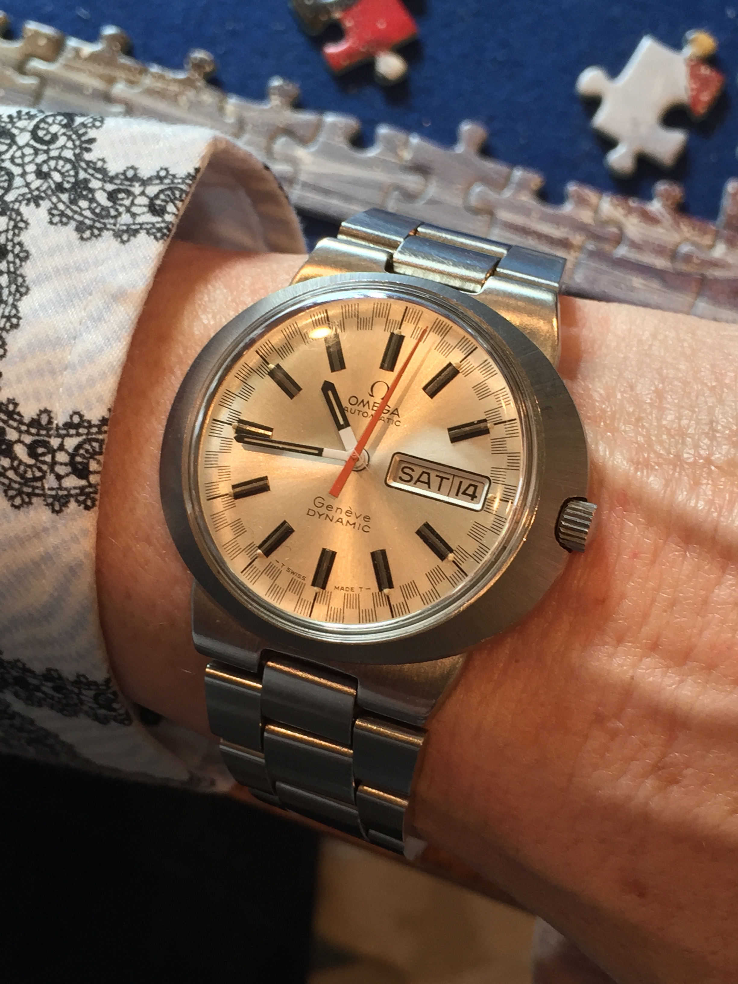

Dial is wonky, as likely are hands. Here's one my wife had for a while.

I've got the same watch. I think the dial and hands ( except the second hand) are fine.
I’m fairly certain the minute/hour hands are wrong. The colors should be inverted.
I think this dial is either refinished or fake. This is a commonly faked dial.
