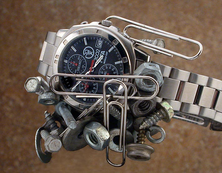

Would anyone know if a high-quality, hand-held Gauss meter would be an accurate way to assess whether a watch is magnetized? Thanks.

Not sure what type of Gauss meter you are referring to, but unless you have a specific need to confirm if the watch is magnetized, my advice would be to just demagnetize it if you think it’s magnetized.

The reason why I ask is because I happen to have the Gauss meter, but not yet the demagnetizer. Do you know if retreiving food from the microwave is enough magnetic field to cause a watch to become magnetized? The meter shows the innards of the oven register quite a high field.

Not something I’ve looked into, but you would think if it were we would see a lot of magnetized watches. Are there any symptoms? Running fast?

I would assume a demagnetizer would be cheaper then a gauss meter.
Meaning the best way to diagnose it is to demagnetize it.

I'm going to run it overnight and see. Thanks.

I’m actually curious what folks feel is the greatest/typical cause of watch magnetization. Here’s why: I always read that devices, like laptops, tablets and phones are a major source.
Just for fun, I checked the magnetic fields by scanning all sections of my iPad with the Gauss meter, and the highest level I could find was 4 milligauss, but in the microwave, where I reached for my food, the area read 45 milligauss.
Now, here’s the hole in my physics knowledge: do watches respond differently to actual exposure to magnets, vs magnetic fields?

Depends if the field is static or alternating. Static field will act as a permanent magnet would. An alternating field is what you demagnetize with...
Proximity is a big thing. Strength of the field of a permanent magnet goes up rapidly the closer you get.
