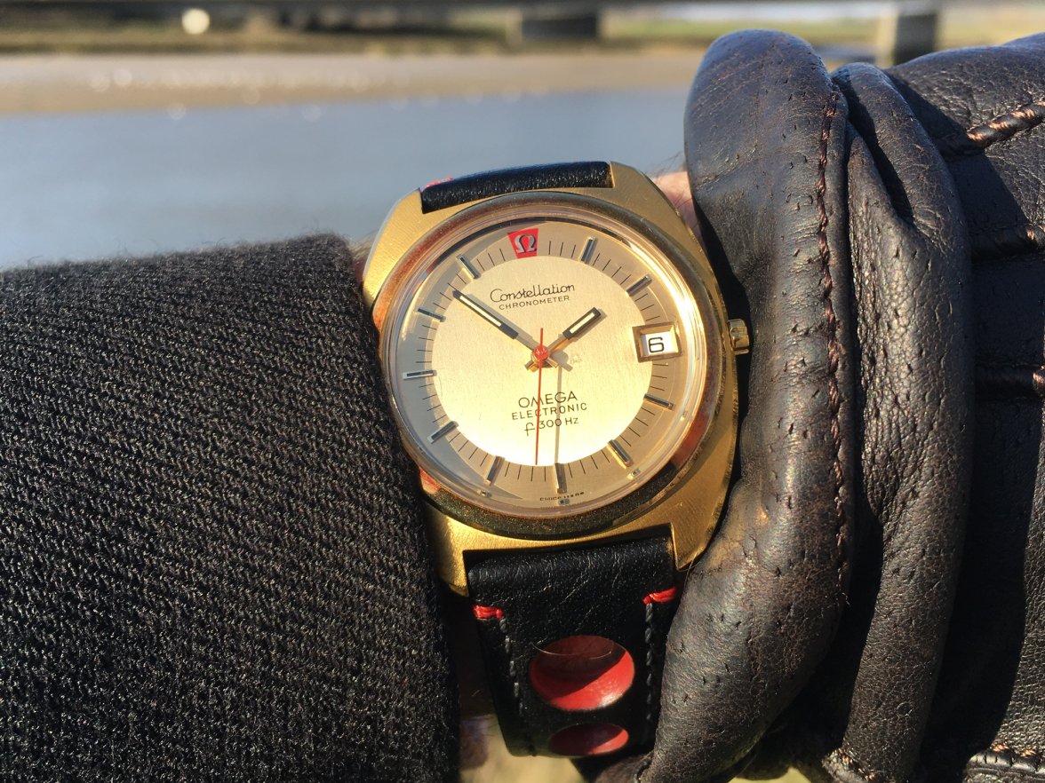

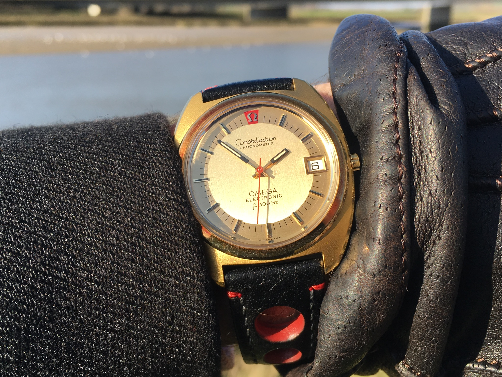

My recent acquisition says hello!
I was told about the old brittle plastic date rings are susceptible to damage if adjusted whilst the hands are near 12:00.
