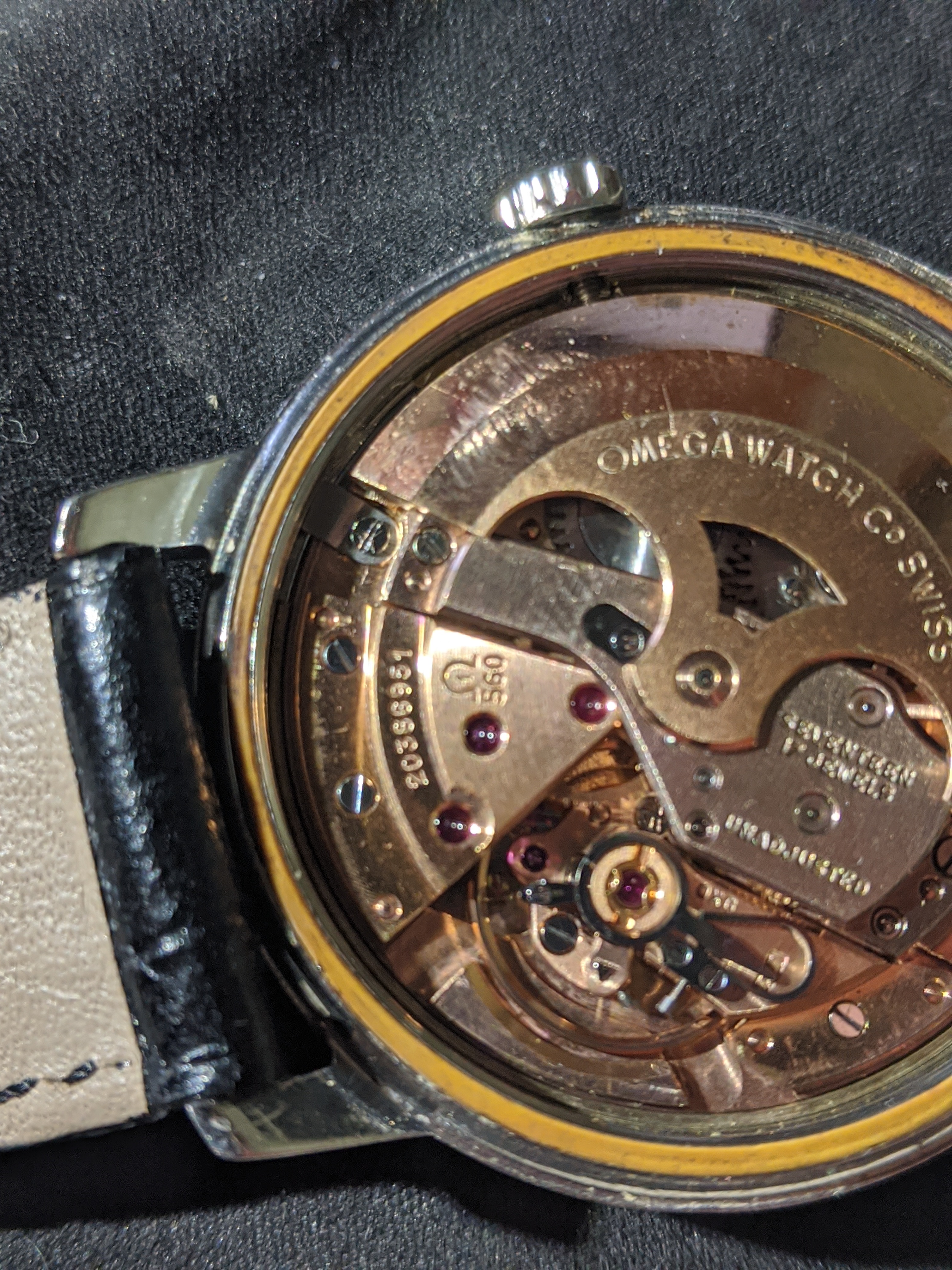

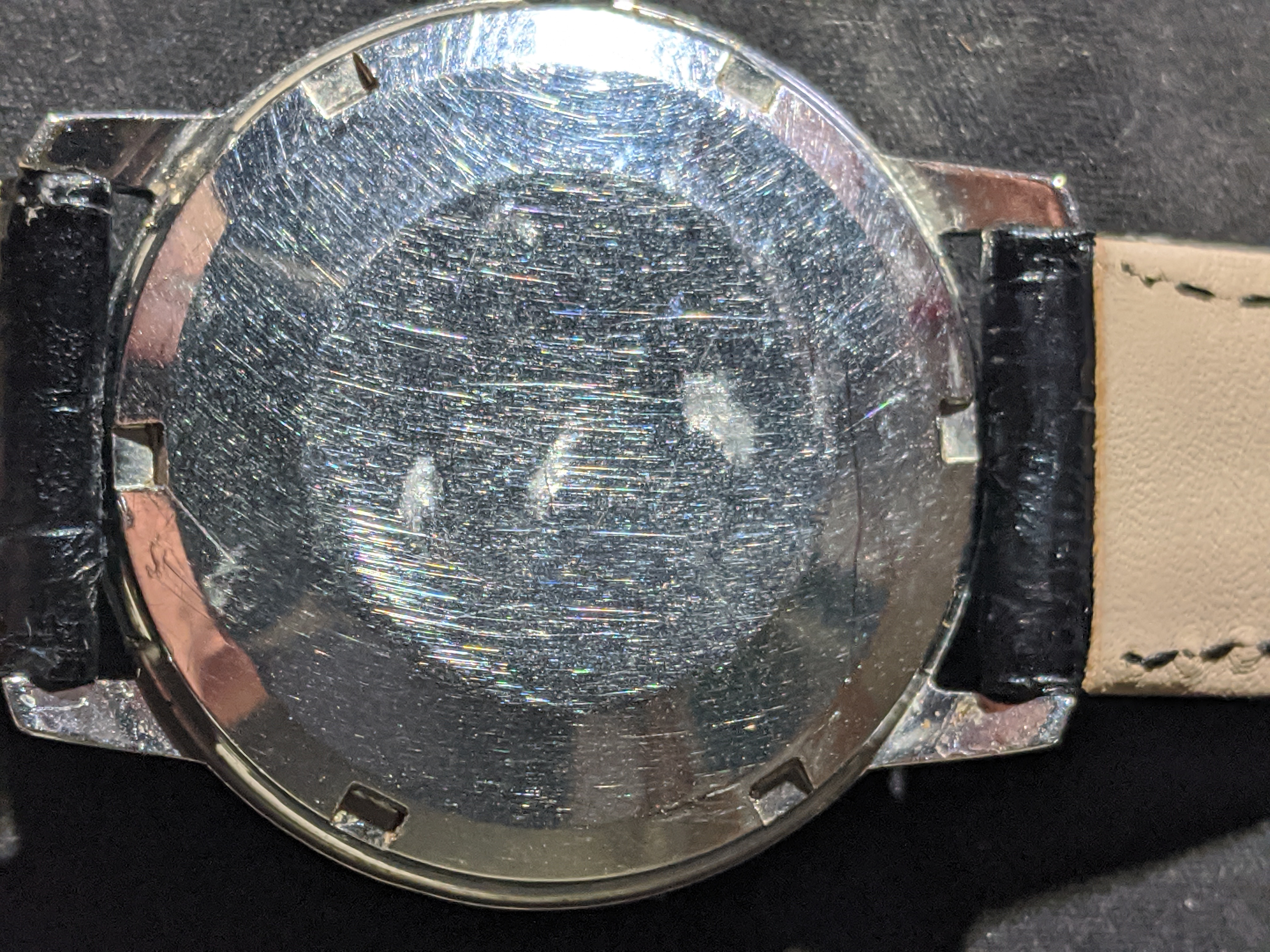

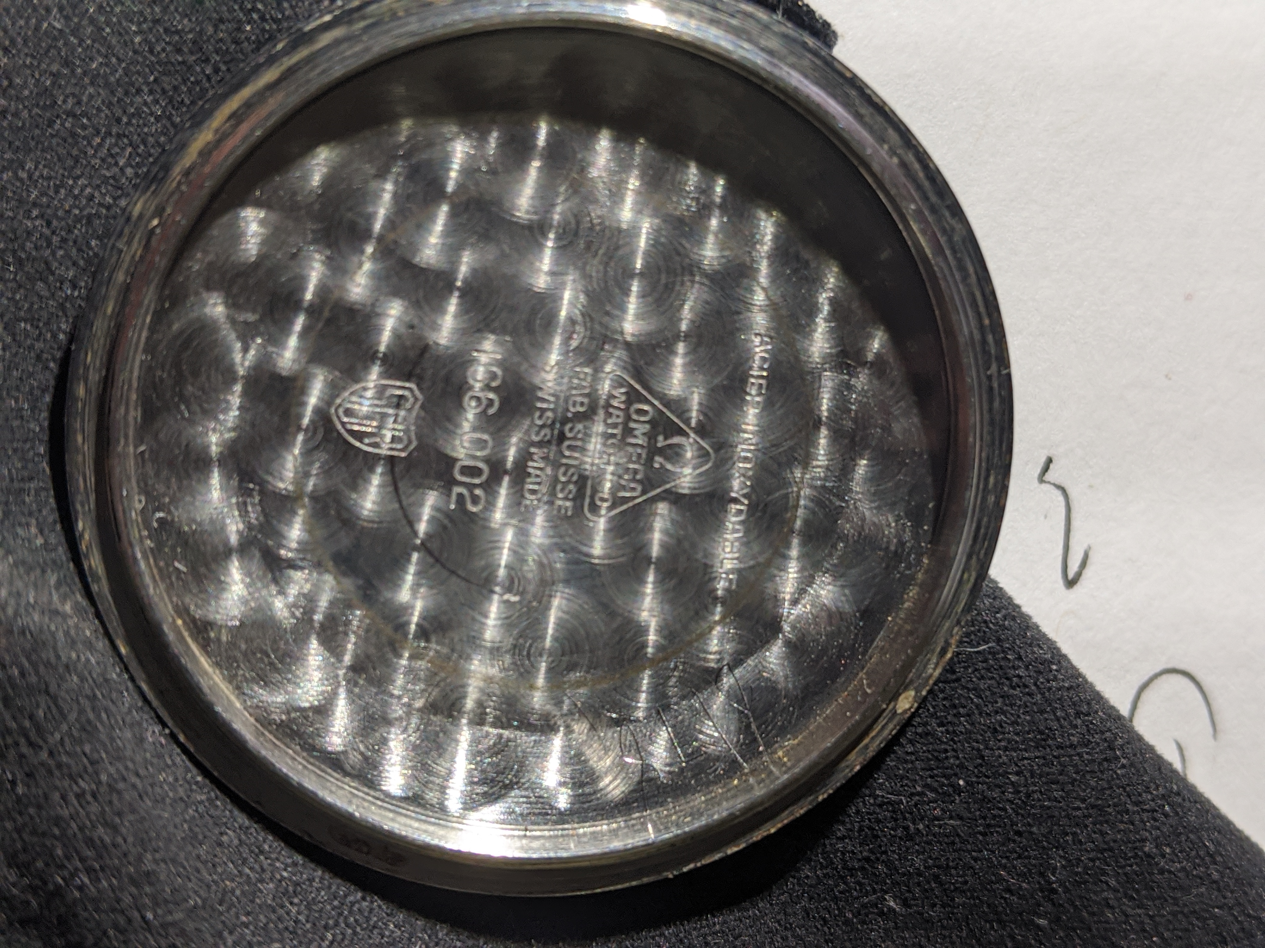

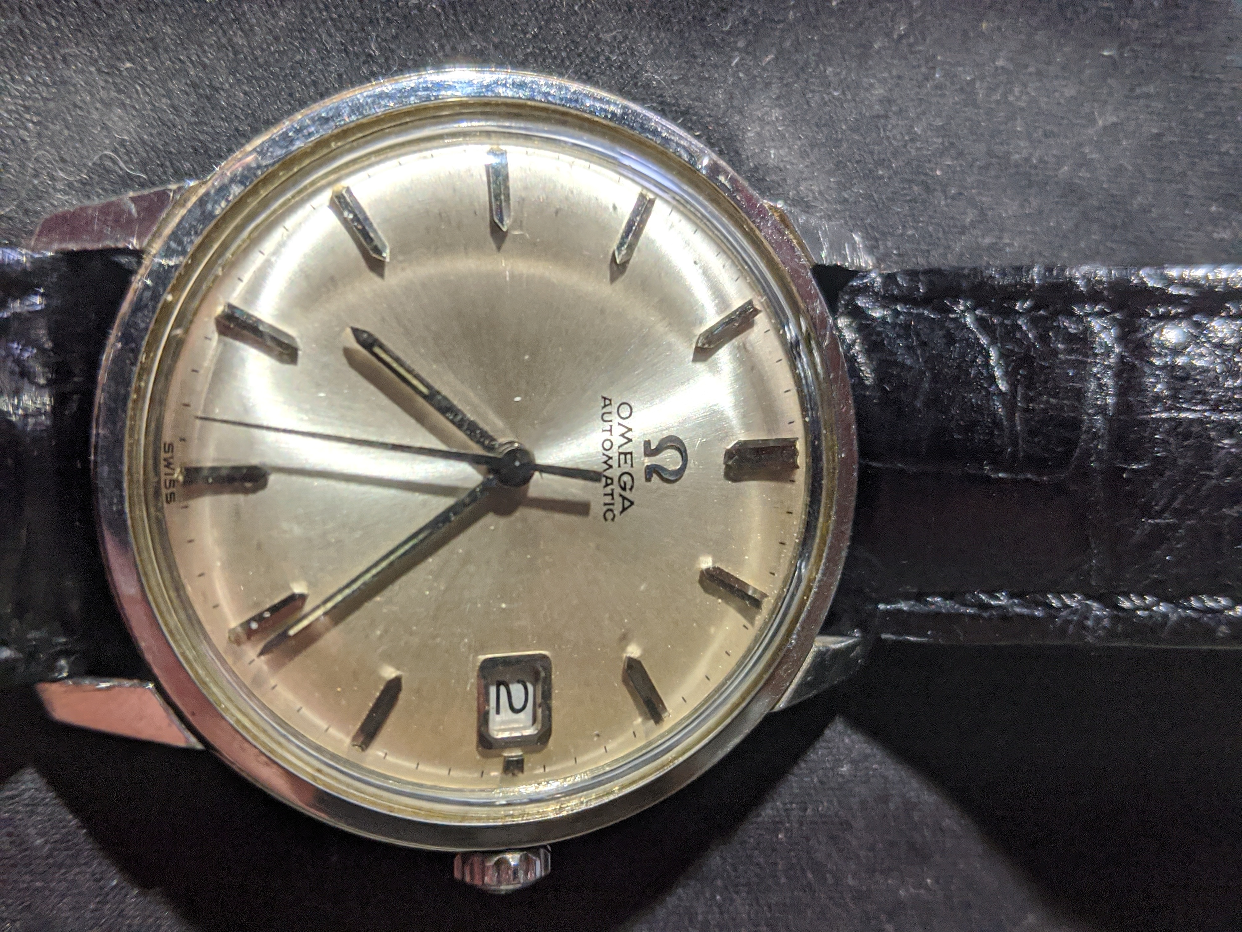

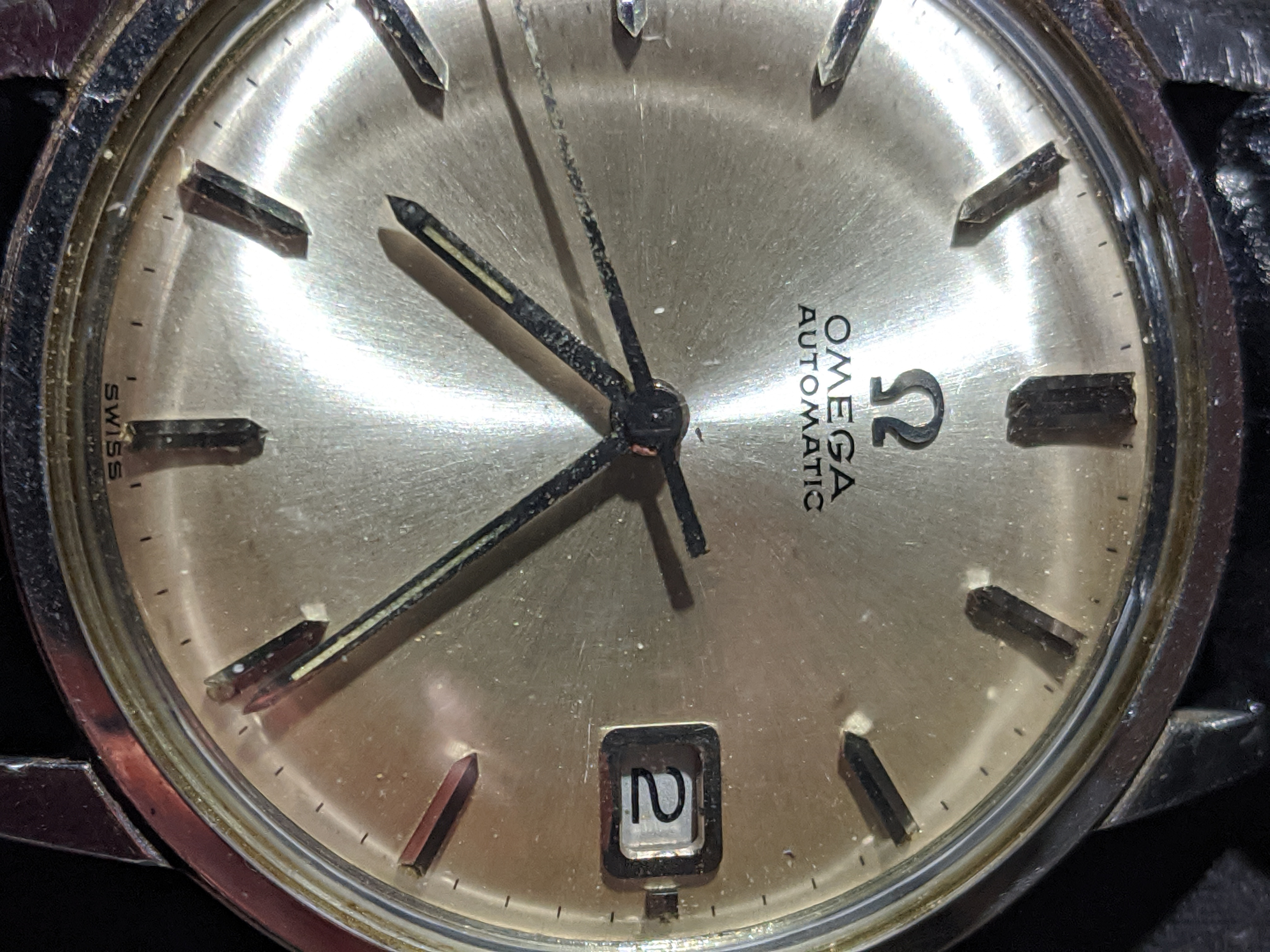

Please, someone, correct me if I'm wrong as I just jumped the gun and spent 400$ on this!
According to my research, this 560 automatic omega should be in a 10K gold case also, 166.002 should be Omega Seamaster, thanks for any and all info
24,836
55,255
With a picture of a Gèneve.
I noticed that too. 😁 This just seems to be one of the non-Seamaster Seamasters. No Seamaster on the dial or logo on the caseback. Low-jeweled movement for the US-market.
It wouldn't shock me if there's a Geneve version out there as well, or even a Seamaster-Geneve.
